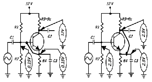

Nasdak, check voltage between bases of drivers on the two channels. The voltage on the good sounding channel is right. The voltage on the "no idle bias current" is wrong. Maybe a bias diode is shorted or a pot wiper has lost contact. Of course, OT's could still be leaking, or driver transistors.
Replacing random transistors is not a good idea.
You have to identify which transistor is not working - amplify.
If you short-circuit the base and emitter the voltage (VDC) in the collector should increase because you are canceling the base emitting diode. If it increases, it is OK, if it does not, the transistor is defective.
Be careful with the correct identification of the TR, if it is a PNP or an NPN.
https://www.diyaudio.com/forums/newreply.php?do=postreply&t=347917
And what exactly is E, B, and C
Find a link in English if you can't translate it,
("how to identify a defective transistor or something like that")

You don't have an audio generator and an oscilloscope?
The method is to inject audio signal from the circuit input to the output and observe what happens at the output of each TR
