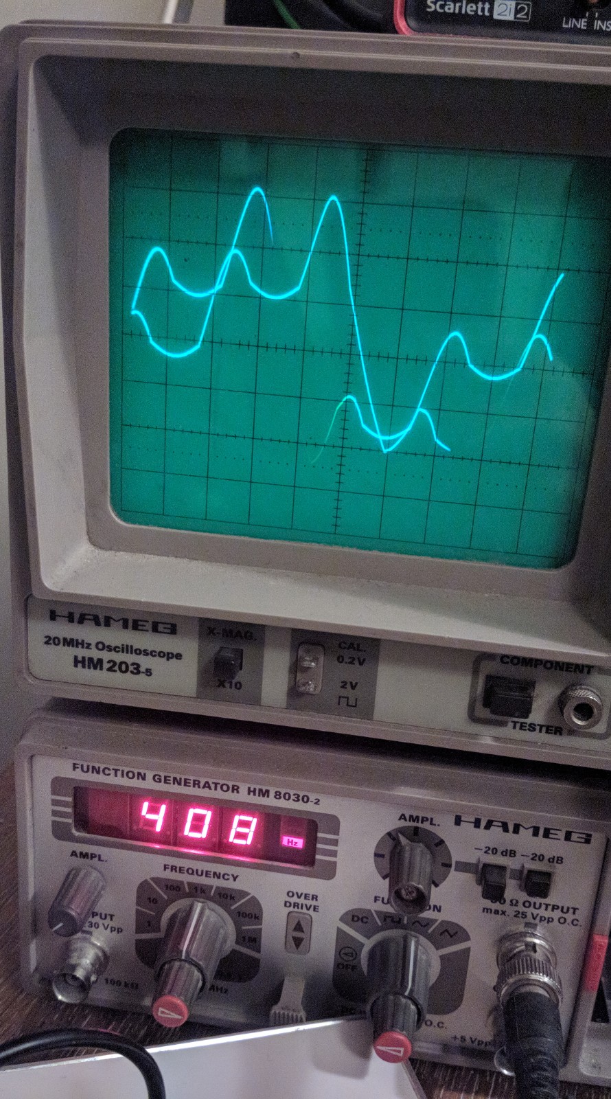

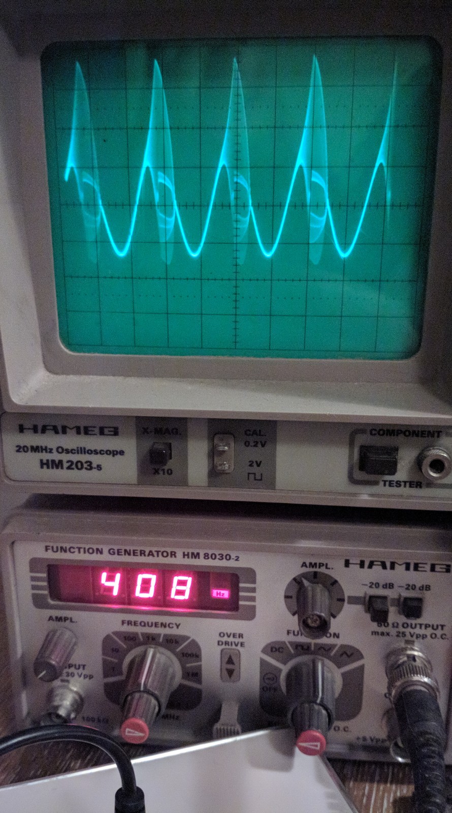

Waveforms posted after I posted #54.
Those waveforms are nasty. Flat bottom waves, half sines as I said earlier. Plus the points aren't sine wave at all, apparently happen sometimes since they are faint.
Loose solder joint? Excess high frequencies (the points) can be caused by capacitors used as a differentiator in the feedback path. If the electrolytic caps are all new, I'd take a meter to, or change out, C2, c3, c4.
See if Q1 has same thing or nice sinewaves.
& look at Q2 & Q4 to see if you have whole sine waveforms there. Half waveforms might be okay for only the upper half of the wave. Not the points on top.

the waveforms are Q1's
any chance q1 is malfunctioning?
i already tried to replace the cerami caps... might try again
Thought the waveforms were Q6. Feedback differentiator Q6 to Q1 could cause the pointy peaks in Q6, but Q1 has no local feedback.

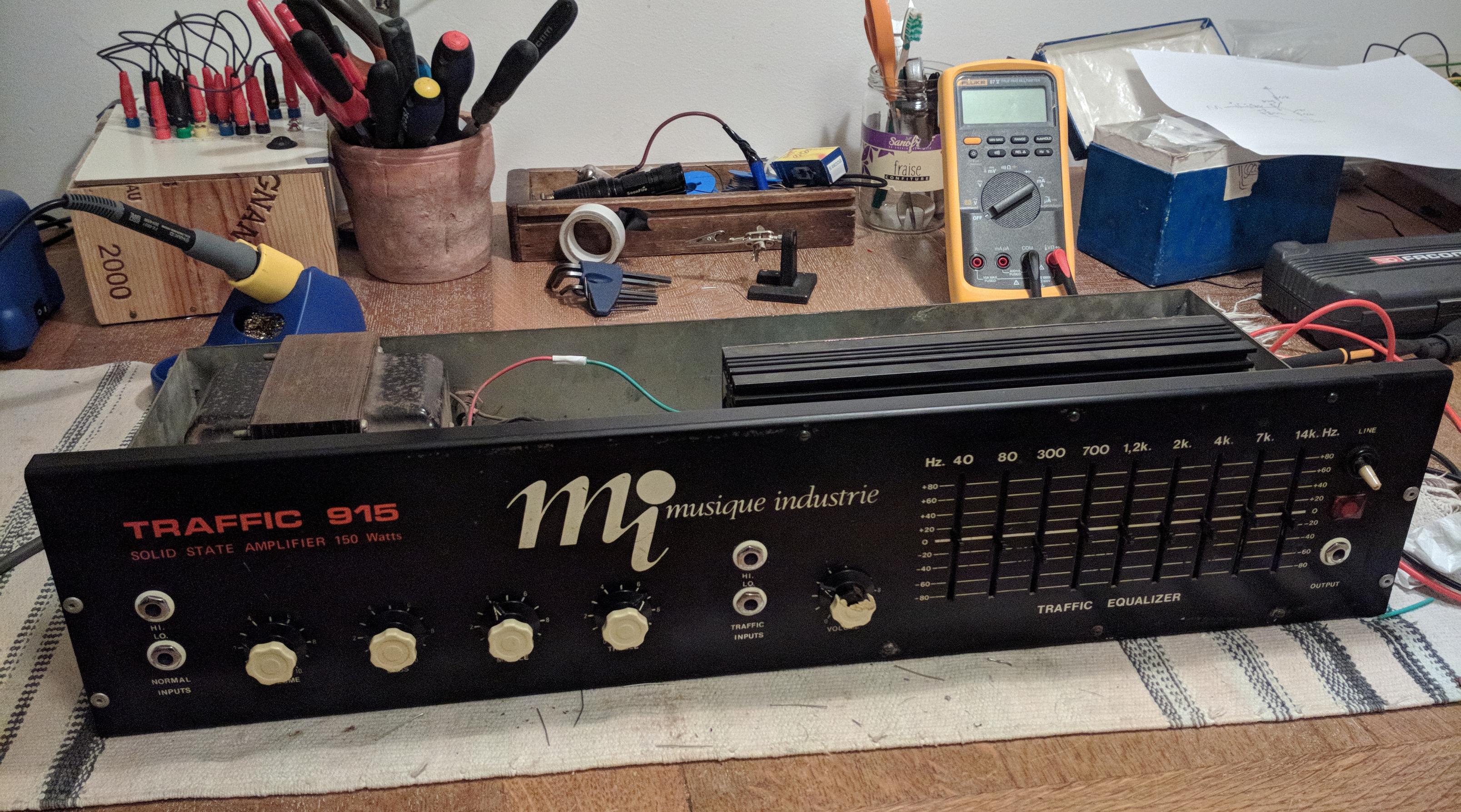

"Some day", after this problem is sorted, it would be nice to have a full frontal picture of this amp, I vaguely remember ads in the "Sono" magazine.
We are talking mid 70´s or so.
Also remember the "French Marshall" amps, 😱 , although not the brand. 🙁
