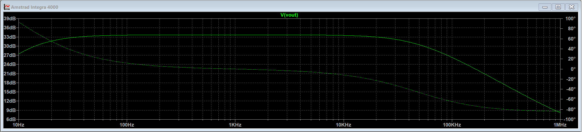

This shows the Miller cap connected for each possibility and finally omitted altogether.
OK, let's see what happens when the configuration is put back as was. With the 100pF capacitor connected C-B rather than C-gnd.
It wasn't clear whether this was originally connected or not from the two diagrams posted - the one with 100nF base shunt omitted it.
My simulations ran to 100MHz, by the way. Stopping at 1MHz does not reveal some of the quirks.

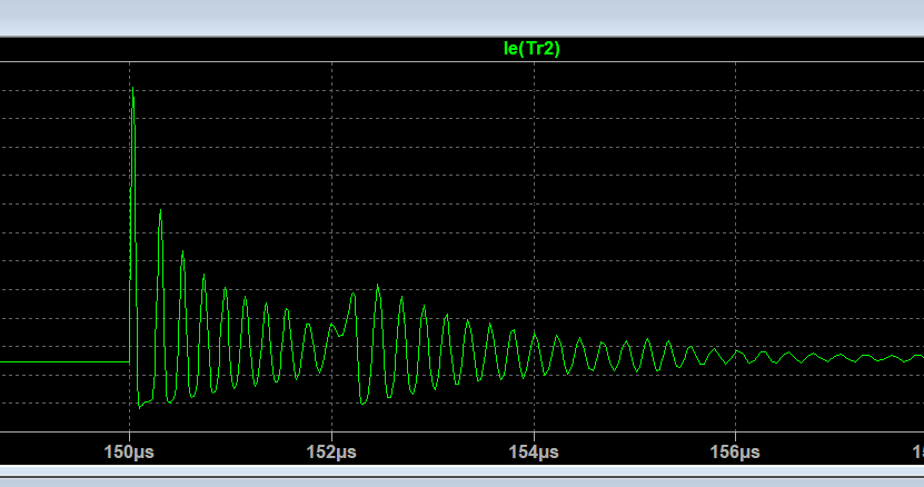

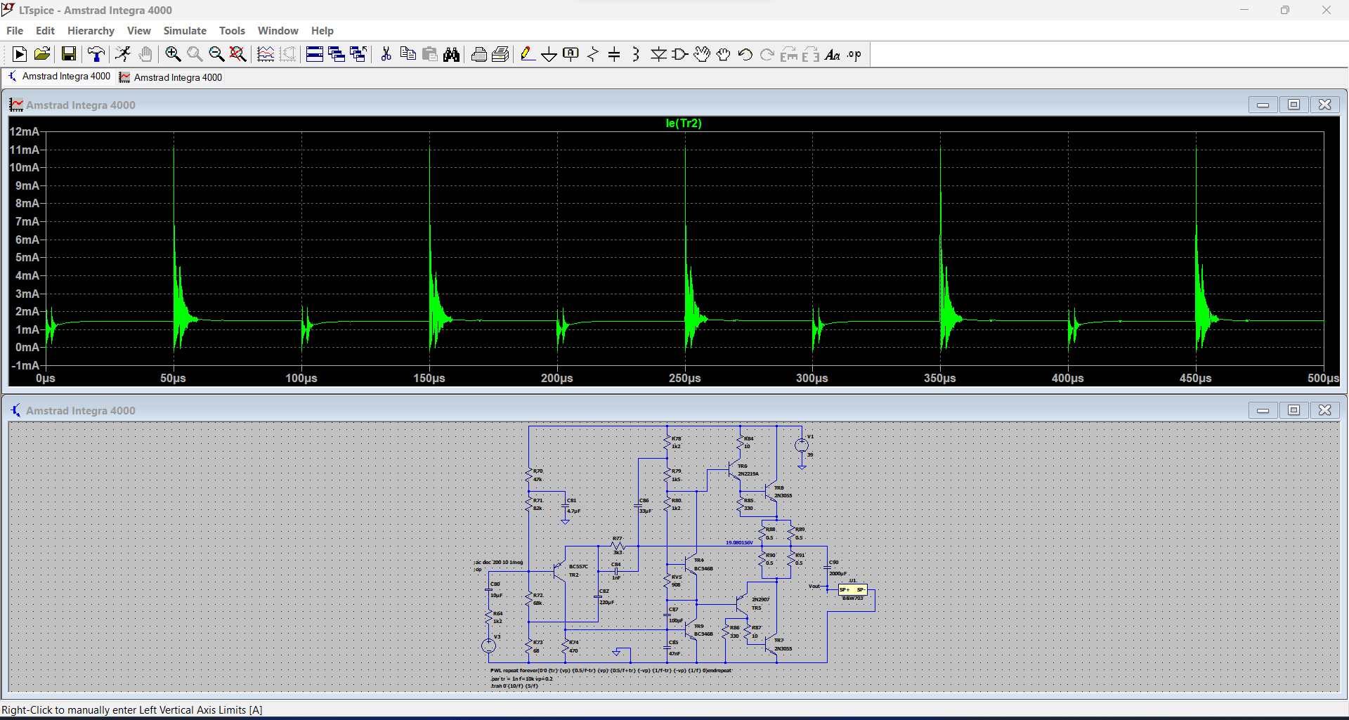

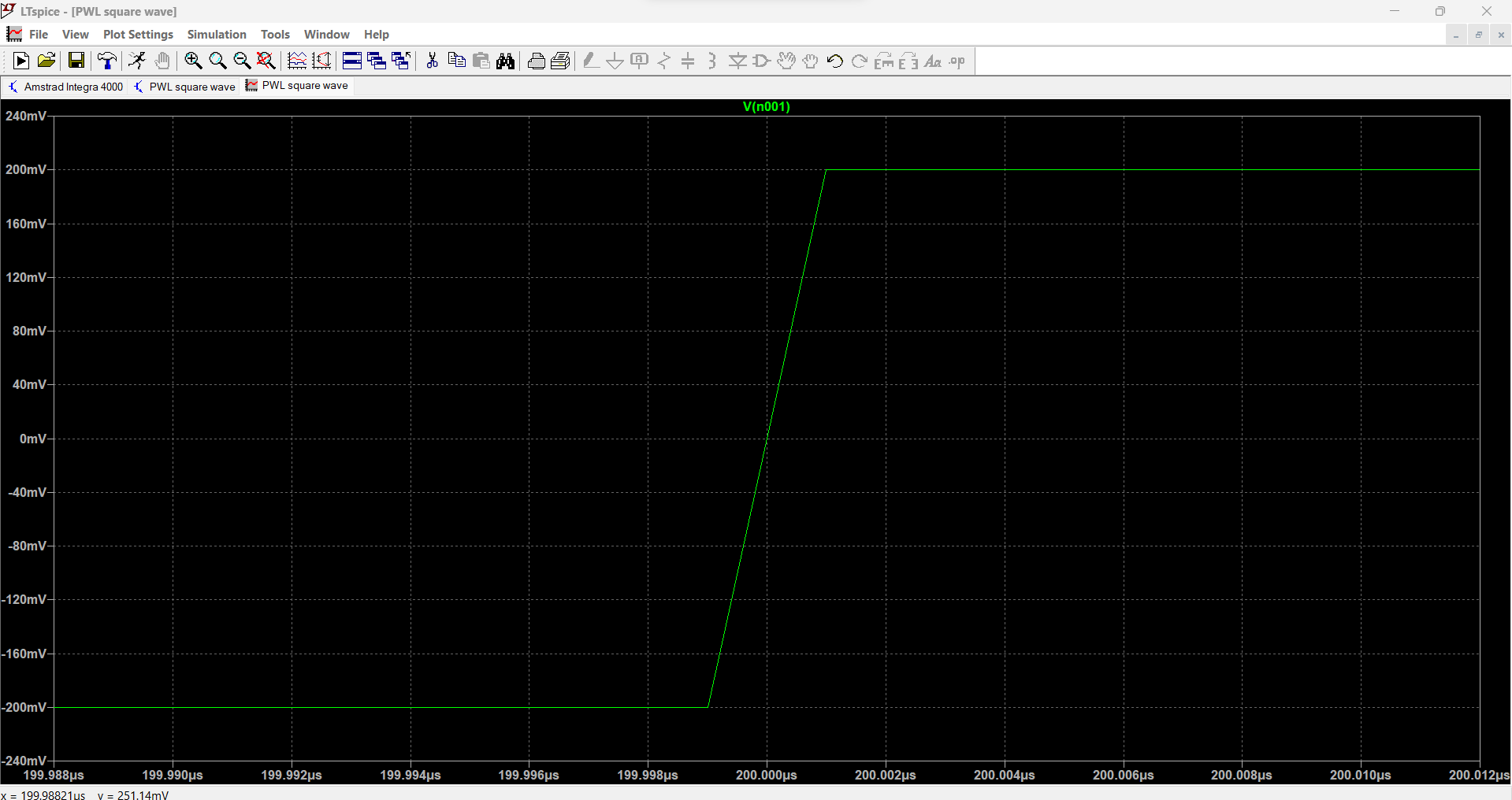

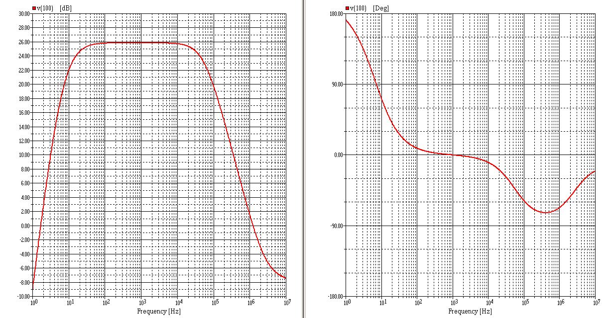

I think this is quite revealing of stability. 10kHz square driving simulated B&W703. I bet that power amp could sound really good you know. Peak current is -/+2A in the load here.
Hi Mooly
The configuration is stable, I agree. But take a look at the emitter current in the PNP input transistor with your 10kHz square wave input. I can't comment on the accuracy or otherwise of LT Spice versus SIMetrix (which I use), except to say that in my simulations the emitter current exhibits some ringing on the edges. At 3.3MHz where the AC analysis showed a slight peak.
I haven't run a Tian simulation to investigate the gain/phase margins but this type of compenation was widely used in the 1970's as I posted above, typically in Mullard publications too. So yes, in those days it seemed to be "acceptable sound".

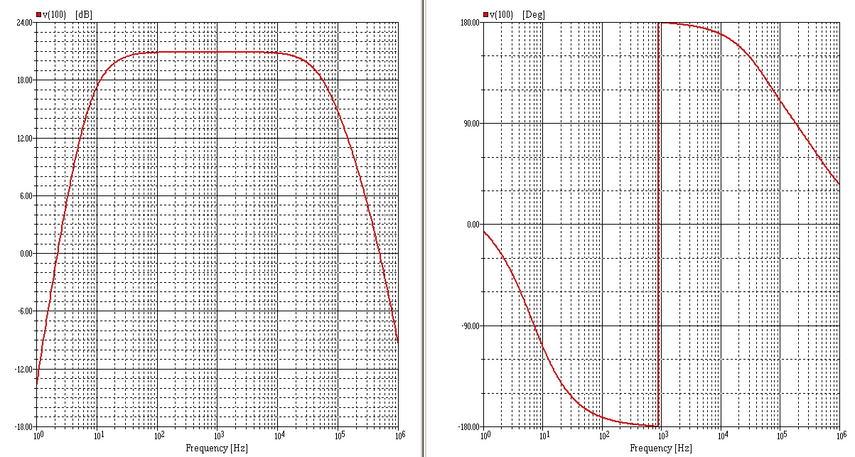

@citizeN - try running your sims without the additional transistor, as Mooly's circuit. In my sims the additional transistor cuts the response down (due to its own frequency limitations) which does suppress the spike.
John,
My old limited Spice simulator cannot reveal such spikes alas.
But the phaseplot reveals a pole in the MHz-region.
I guess my models are not accurate enough either.
I use BC107, BC157, BC349A, BC161, 2SC734, SD234.
Better have them synchronised with Mooly's?

At least that seems to confirm a similar result to the sims I ran!
Notice that the first period in the ringing cuts the input transistor off for a fraction of a microsecond. That is of course the basis of Otala's "TIM" concerns, but if the input is bandwidth limited, such as by the transistor ahead of the power amp, this may be of no significance.
It is possible to design an amplifier which exhibits only a single differential spike without clipping in such tests.

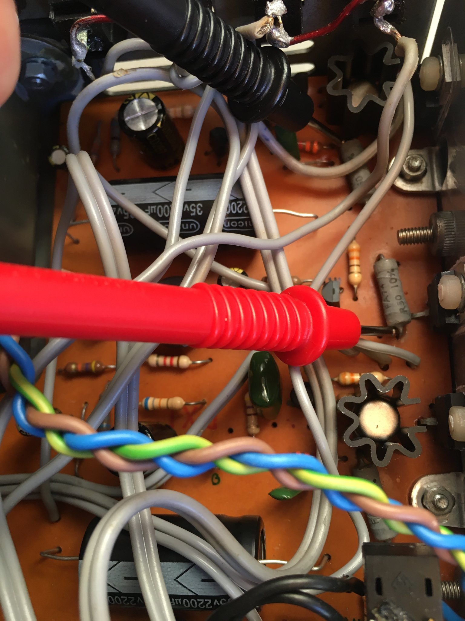

I had some time to start again, one channel at a time. Starting with the left channel I put back the BC237B for TR6 and TR4 and removed the BD139. I can only think that there must have been a microscopic bit of swarf which blew the fuse. Checked everything again thoroughly, switched on, and.....
it worked fine!
I then checked the right channel, leaving the substitute BD109 on the heat sink, after checking and measuring that there was no short, and the 2N2219A with its own heat sink. Still nothing, but, when I switched it off using the On/Off switch rather than unplugging the mains plug, there was just enough movement in the body of the switch to move down so that one of the connections underneath made contact with the heat sink of the 2N2219A. A tiny blue flash, a flat pop, and a red face followed. Both TIP41s blew apart, and there was a small black hole in the side of the 2N2219A.
I had spare TIP41s and a 237B for TR4 and TR6, as well as a 2SC734 for TR3. I left off the heat sinks from the 2N2905As in order for it to be as close to original as possible, switched on, and...... it worked fine too! Just as well, since I've now run out of 1A fuses and it's a Bank Holiday weekend.
It currently sounds great, runs quite hot but not excessively so, and I'm going to leave it playing for a good long time while I think about making some enclosures for some Eminence ME12 1008LEs which probably suit it more than the B&C units. The trimmer pot for the right channel doesn't seem to change the sound in the same way as the left does although it measures the same, but I'm inclined to leave it for the moment as it sounds fine.
Many, many thanks for all the help and support - I think I would have given up without it! I will report back after longer testing (with appropriate period music...)

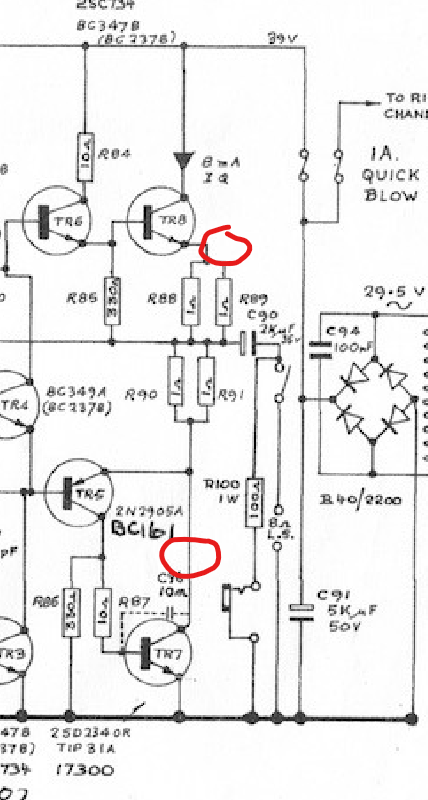

You will find in practice that a bias setting of even a milliamp or less removes audible distortion. Ideally set it to the 8 milliamps on the diagram by measuring the voltage between these two points. You should see 8 millivolts DC . A very small voltage. Readjust when the amp is hot as the current will alter.

I'm still puzzled. I checked everything that I could again, and the only difference between the left and right circuits now is that TR3 is BC237B on the left, and 2SC734 on the right. Turned it on again, and the right channel fuse blew (my last one)
Left channel is still fine. My board has single 0.5 ohm emitter resistors instead of two 1 ohm as on the diagram, but otherwise the same. I get 50 mV immediately on start up, rising to 150 mV when warmed up. Measurement taken with no source connected, and no speaker connected. I double checked with another DMM, and got the same results. After 3 sides of records the heat sink is warm but probably not more than 35 - 40 C. When the right channel was working it was almost too hot to touch - I'd say maybe 60 C
If I lower the bias using the trim pot the sound distorts - it is just above the threshold, and at the point at which the sound does not improve if raised further. It sounds good and doesn't get hot (why not, if the bias is too high?) so I'm inclined to try and replicate it on the right channel by changing TR3 to a BC237B
What else could I have damaged with the mains short? The electrolytics look ok, but it's no big deal to change them if they are faulty - I'd just like to know.... All the resistors read the same on both channels (within tolerances) and I'm still baffled by the fact that the trim pot did not change the bias on the right channel although it still measures ok.
Are you measuring the bias between the two points I circled above?
That bit doesn't compute 🙂 Recheck the reading across the two test points. 150mv across 1 ohm is 150 milliamps. Power dissipated in both output transistors would be supply voltage multiplied by that current, so a @ 39 volts it would be nearly 6 watts. It doesn't sound a lot but its enough to heat a transistor up, particularly on a small heatsink.
