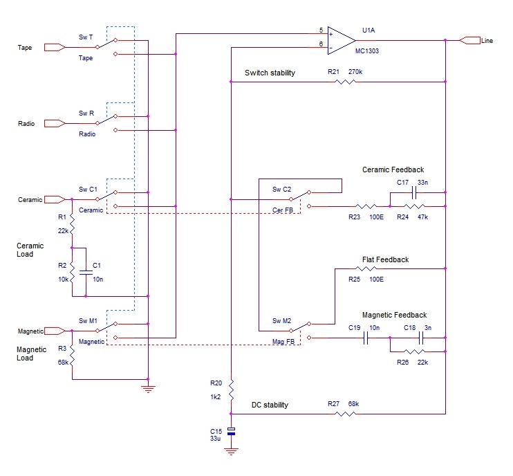

Sorry for the delay, and thank you for all the help! I hope these images are a bit clearer, although some of the markings are a bit blurry and I think there are some mistakes (R10 appears twice)
R24 is indeed 47k, and all resistors that I have tested have been within tolerance. I have replaced a few so that they are as close as possible to design spec (R25 R26)
I replaced R20 with a 680R and the level was higher, so I tried 470R - testing by ear, it still sounded good and better level. I don't have any lower values in my box at the moment, but it may be worth trying even lower?
I don't remember my old amp needing time to warm up (but it was a while ago...) but at the moment setting bias is proving rather delicate. If it is set to sound good from cold, the heat sink (basically an aluminium plate attached to the steel chassis base) gets very hot. If I adjust bias down it then sounds good and runs cooler, but starts off distorted from cold again. I can probably live with that if nothing is being damaged!

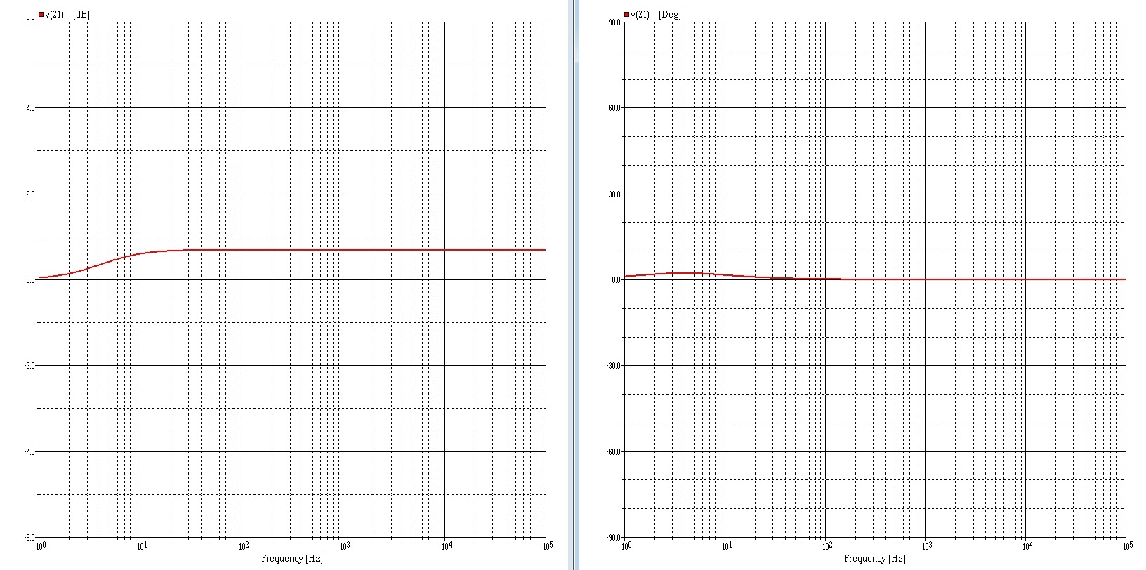

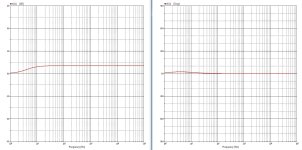

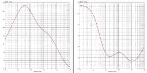

Ceramic response is without input filter!

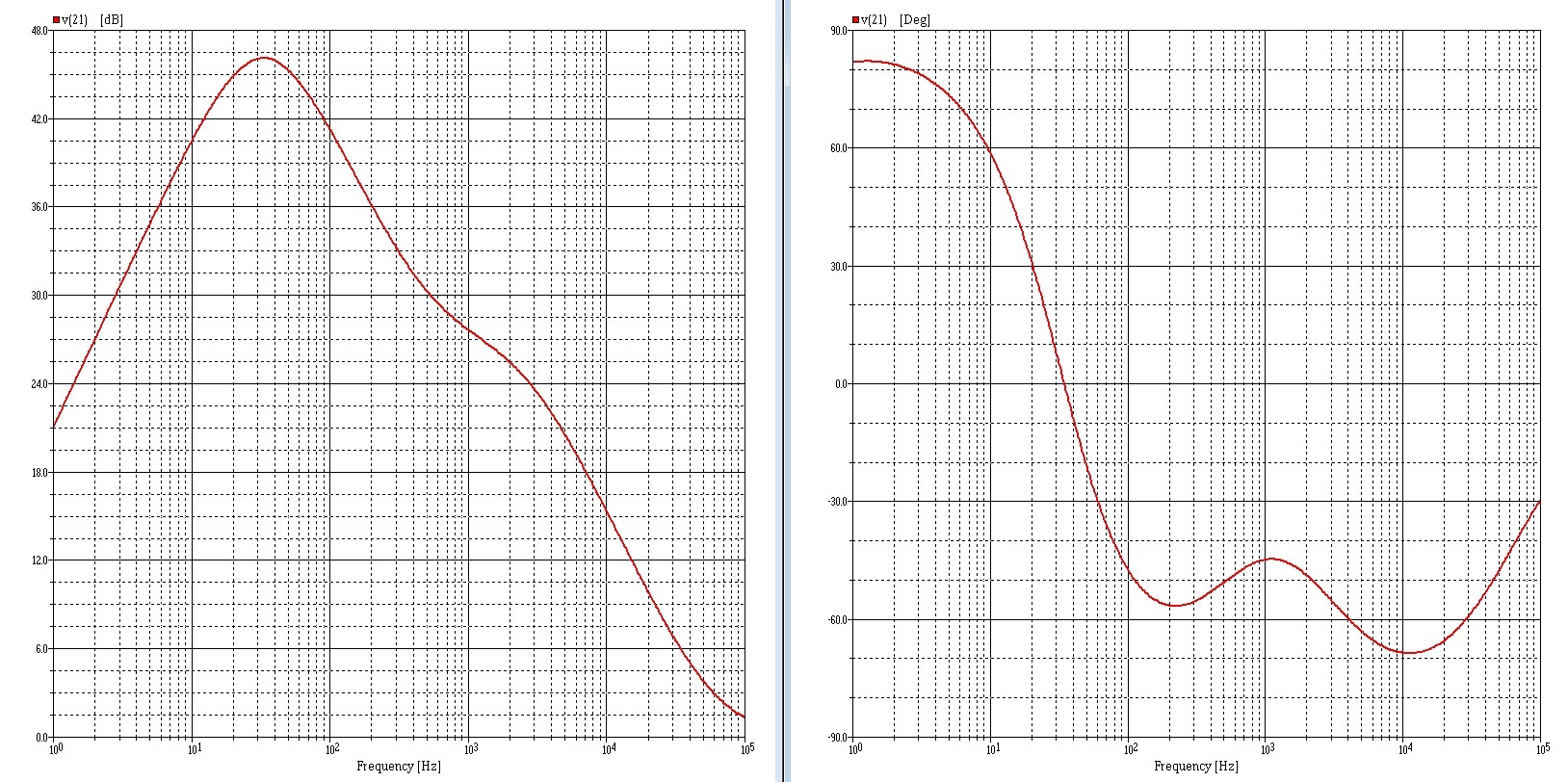

The (original) MC1303L does not give a GBW-plot, a VCVS is assumed in the simulations.

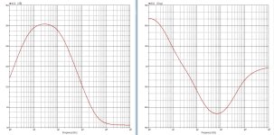

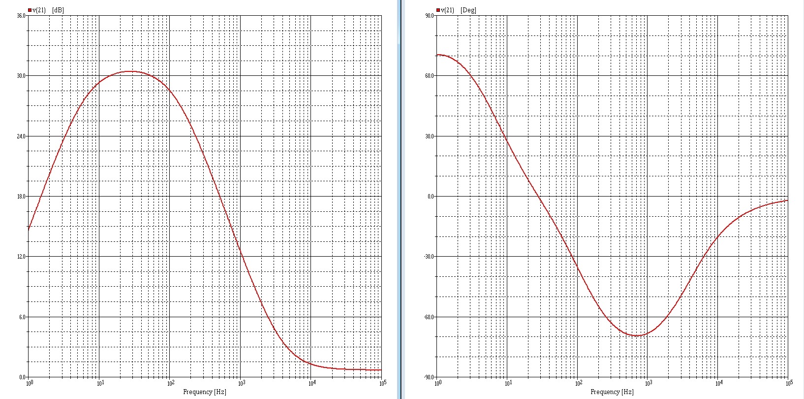

Magnetic gain will increase with a lower R20, but the open loop gain is limited!
Lower then 470Ω might cause distortion then.
You can use the ceramic input as a line input when R1 is disconnected and C17-R24 is bridged by a wire.

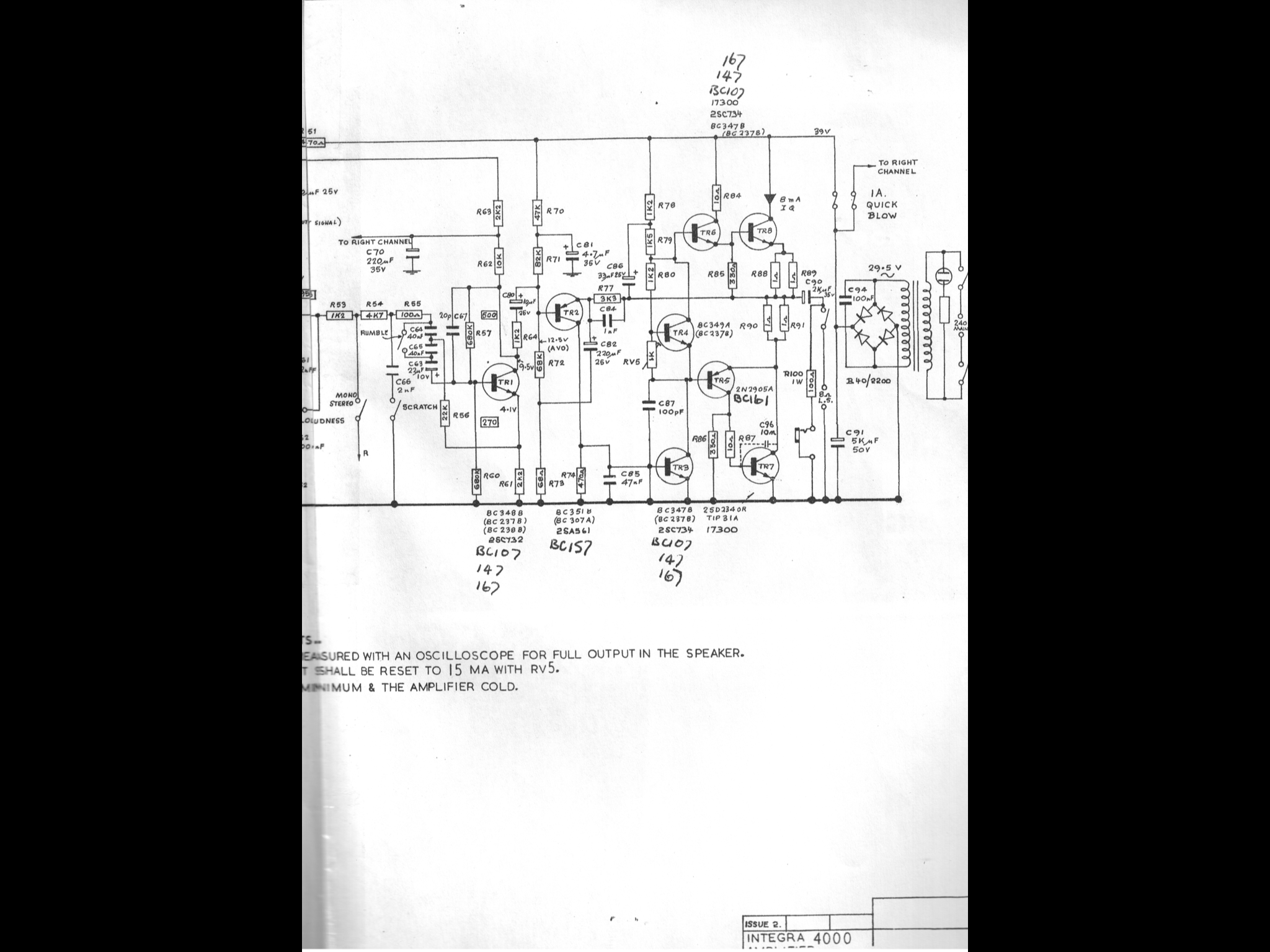

Oh sorry, now I understand. As I've already mentioned, the drawing lacks to follow some conventions. But which resistor is named with the decimal dot instead of the k in the middle?
Btw, I just spotted some severe error: Please have a look at TR3. Why is it's BC junction short circuited? And, if it weren't, what does the 'lytic C85 in parallel with this junction? How would TR3, the VAS, be driven despite of this capacitor?

I had to post the diagram in two parts, and they happened to span two pages of the thread, so the note at the bottom are not too clear.
Note 3 reads: 'If components are changed in the power amplifier the quiescent current shall be reset to 15 mA with RV5. The current is measured through the fuse with the volume control at minimum & the amplifier cold'
Below, it reads: 'Some sets will have the following changes - '

Looking at the dc biasing is the junctions of the 1R emiter resistors close to 1/2 supply? I'd assume they would want it to be. It's basicaly set by TR2 and 3 and not sure how much the RV can adjust it.

Surprising that C85 has doubled. At 47nF it was already "too high", but I suppose the designer did so in order to eliminate C87. The fault in this old style design is the use of large feedback capacitor (c84) without a limiting resistor causing a lot of phase shift which needs a large dose of compensation to stop oscillation.
Still, it seems a commonmethod back in those days.
... and RV5 without a series limit resistor is dangerous. Penny pinching (commercially driven) no doubt. Since the bias voltage needed is about 3 Vbe's then the lowest value of the base resistor should be about 600 ohms so I would have used a 470 ohm resistor in series with RV5. Could still generate a large quiescent current but better than a shorted RV5 if it were inadvertently started at the "wrong" end.
Also, regarding the short circuit in the diagram, I suspect C87 was intended to be grounded, not connected to the base of Tr3. That would have been the classic Miller technique of stabilisation which is not required when using a large base bypass capacitor.
1k2 definitely is 1.2kΩ per European conventions!
We have already stated the comparatively huge gain of 35.3 dB in the power stage.
Best regards!
The supply rail is 39 V. Even accounting for output saturation you are going to need 600-700 mV on the input to drive it to full output power. The MM gain is inadequate whichever way you look at it and the legacy inputs require a fan of circa 5.
So quite what is going on here I don’t know. I can only assume the values shown in the diagram are not correct and would be needed to be reworked so sort this amp out.
Well spotted! I completely missed that.
Me too, previously 😉! Is it R24 (47k) you were referring to?
So we may say the difference in loudness between CD and phono inputs indeed can be traced back to the much higher ouptput level of a CD player, compared to a tuner or tape device.
