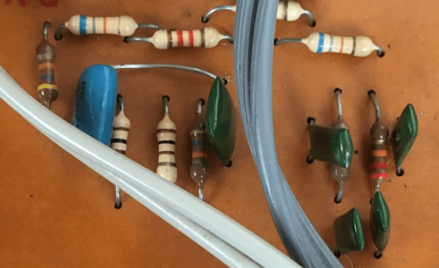

I doubt. Yellow, purple, orange, twice....So I think the 47 k is 4.7 k...
The left 33N has been repleaced.

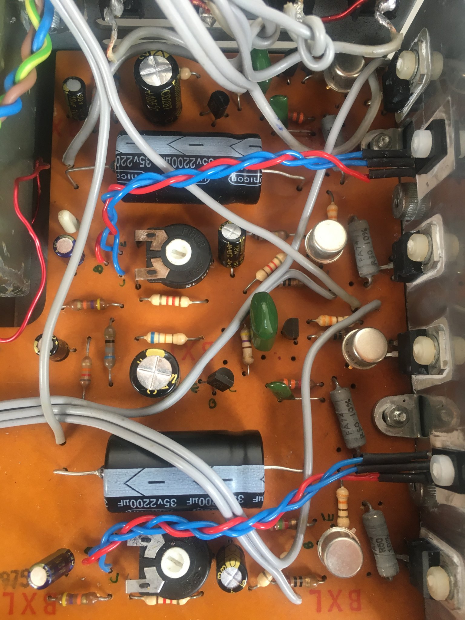

I'll get 2N2219As to go with the existing 2N2905As and fit heat sinks, and I'll try using BD139s instead of BC237Bs for TR4 and mount them on the heat sink in between the output TIP41Cs. I'm not fixed on complete originality, but I don't really want to stray too far - I'm not going for a silk purse, just a fair representation of the original design.

I fitted the 2N2219As and changed TR4 to BD139 and moved them to the heat sink. Now the left channel fuse has blown, and there is -600 mV DC at the left speaker output and 1.2 v DC at the right. No idea what I have done wrong...
I have removed the left channel fuse in order to do one channel at a time. I removed the replacement transistors BD139 and 2N2219A and they tested ok. Put them back again and I now read -77 mV at the output. Connected MM source to Magnetic input and a speaker to the output and nothing, not even a faint hum. Tried with CD on Radio input and still nothing. There was always a bit of a thump from the speakers at turn-on (there was on my old one) but now nothing.
I have checked all the traces with a magnifying glass, and will check all connections again, remaining baffled for the moment....

I did clean the edges of the holes with a larger drill bit, so I don't think there was any scarf left. I also used the little plastic washers with a shoulder and plastic bolts and nuts, so there shouldn't be any contact. I removed the BD139s then put them back, but I didn't test for a short before doing that. There isn't one now, at least!
I left the bias pots at around 2/3, so around 600 ohms
I didn't have a third colour wire to hand, but I did check and re-check several times that I got C and E the right way round. The braids are actually short enough to follow the wires visually as well as a continuity test, and I checked and double-checked the connections before marking the circuit board.
I am getting around -400 mV DC across the output, and around 1.2 v AC between output + and - , and the same 1.2 v AC between + or - and chassis.

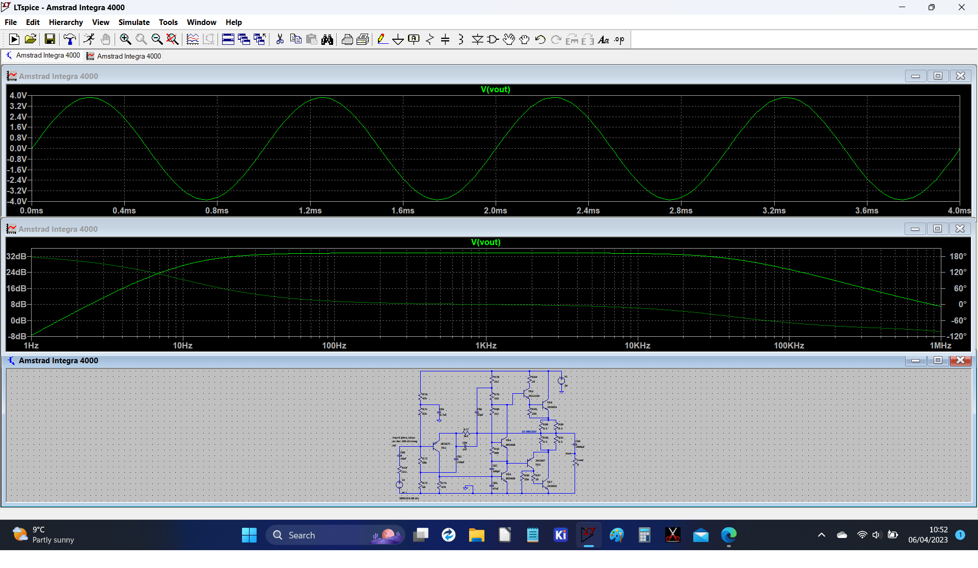

As I had a quasi circuit already in sim I ran a quick AC analysis using the components you showed in post #1 (1nF feedback cap, 47nF base bypass and a 100pF on the collector (to ground)on the VAS transistor ). There is a nasty spike (as I have always seen with improperly compensated amplifiers like this) at about 3MHz. It is actually worse if the capacitor on the base of the VAS is 100nF when the 100pF is removed. I assume you have the version you posted the circuit of (post #1) with 47nF and 100pF? The spike is controlled if the base capacitor is increased to 100nF but the 100pF is still required.
This compensation scheme was often used and Mullard published several designs with it in their 1970's era books. It needs all three capacitors (feedback, base, collector) to work.
Bailey showed a much better scheme which is surprising that this has not become more widely used, although that really applied to a complementary output stage (which if you are adventurous could be implemented using a TIP42A !)
My recommendation is that if this appears to be oscillation then if your capacitor is 47nF increase it to 100nF, if your circuit omits the 100pF, add it preferably with 100 or 220 ohm resistor in series. I would not recommend this as a hifi solution by any means, but it is one which should apply to your circuit if you want it to remain close to the original.
So first things first - what are the voltages and can you detect any signs of oscillation?

The standard classic Miller compensation seems to work better! Not perfect, but if, as your AC reading suggests, it is oscillation, then rather than any of the existing capacitors, you could remove the 1nF feedback, the 100nF (or 47nF) base shunt and reroute the 100pF from the collector of the VAS transistor to its base. That could be an interpretation of the shorted wiring in your original post, but with that 100pF Miller none of the other capacitors should have been required. But take this step by step. Try connecting the 100pF across the collector of the VAS to its base while leaving the 47nf or 100nf in place and see if that stops the strange output.

If anyone wants a play with a sim of the power amp...
All default models, click and run.
