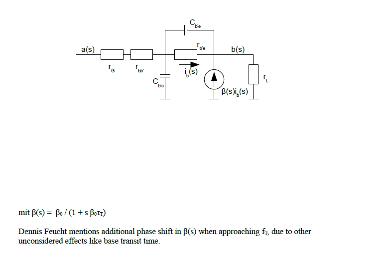

Is this the circuit we are discussing? (BTW, how does one include such a nice thumbnail that does not need an additonal browser tab?)
Only beta depends on frequency (but see remark from Dennis Feucht in the text below the schematic). Generator and load impedances are supposed to be known. For the load r_L, this might be realistic, e.g. the usual conductor parallel with resistor, and behind a capacitor of, say, 10nF to ground (assuming an ULGF of 10MHz, the speaker cannot change very much). The generator impedance r_G (driver output) is probably more difficult to estimate, especially without Miller capacitor around the VAS.
If this is the circuit: are we wondering whether G(s)=b(s)/a(s) describes a minimum phase system?

Even if we consider and operate the stage at an ULGF around or larger than Ft, the r_be and c_be changes due to the low-frequency load currents have to be taken into account. So, the analysis would have to be done for different output currents and also voltages (c_cb).

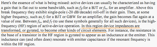

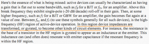

Dave Zan in Post # 105 mentioned Dennis L Feucht
I'd never heard of him, so Thanks DZ 🙂 & what a clever guy he is.
In analogZONE Columnist Dennis Feucht: Why Circuits Oscillate Spuriously, Part 1: BJT Circuits Dennis L Feucht discusses & shows examples of HFG, amonst other things
Interesting, & it's noteworthy that a Lot of his references date Way back to the 60's ! So not new info, but "apparently still not well known.

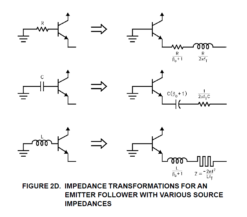

Yes, BJT could transform circuit to another forms due to beta changing with frequency.
Here is the example for Emitter Follower.
PS: The inductance from input will transform to a small inductor plus a "super inductor". The reason call it super inductor is because the impedance is proportion to the square of frequency

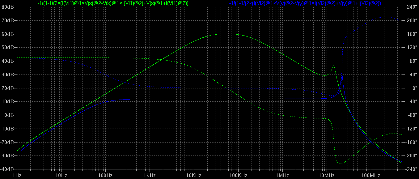

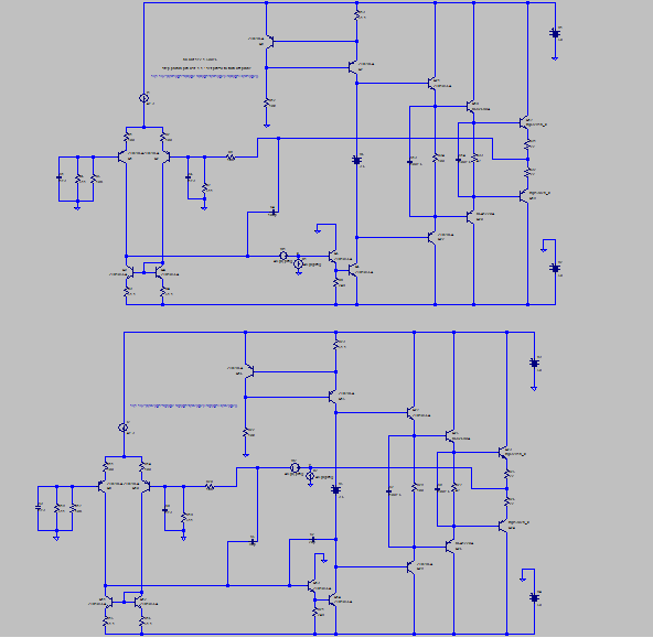

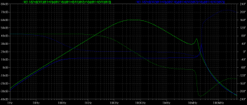

Nested Miller Compensation?
I have run a sim. of two amps with one using simple OIC (green trace, which is unstable) and one in which the 100p Miller capacitor is split into an 80p capacitor around the output stage and a 20p capacitor about the second stage.
The loop gain about the output stage (blue trace) is now negligible and still appears unstable. :scratch2:

I have run a sim....
Still with two-transistor VAS/TIS and triple output, and still without the VAS/TIS emitter resistor. Even the proponents of OIC seem to agree that your circuits shouldn't work.
Why continue to ignore these points? I don't know whether they will make a difference to your sim results, but it starts to look insincere after a while, and it certainly won't put the issue to bed.
Where did you get the idea that I've ignored those points? :scratch:
I've pointed out several times in this thread that the TIS emitter resistor makes an insignificant difference to the result.
Moreover, it doesn't make any difference whether a double or triple output stage is used: the OIC loop remains unstable because it's the output transistor poles that are the issue here not those of the drivers.
Similarly, using a single transistor TIS makes no difference: instability is the result of OIC.
So, read my posts in this thread thoroughly and/or do your own sims before spouting nonsense.🙁
