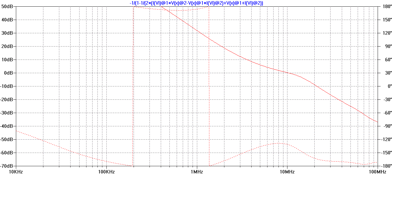

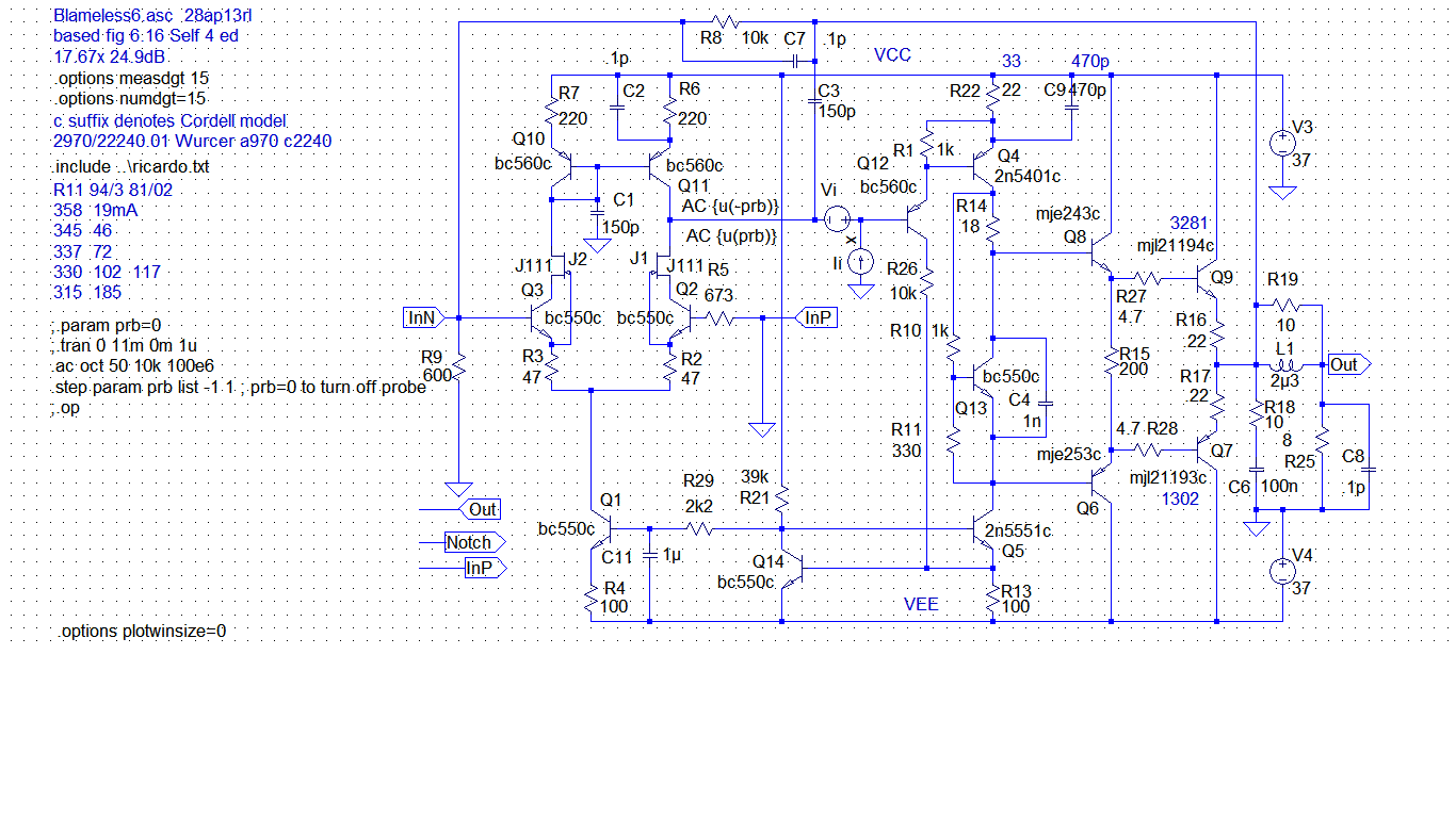

Stability of 'pure Cherry'
However, the amps in post #4 and #58 are very close to 'real life' stuff I tried circa 1990 and are most certainly stable .. even with funky loads, overload, bla bla .. 🙂
They certainly don't need shunt capacitance on the VAS collector .. which as you rightly point out .. is truly evil. In fact, even TMC or TPC networks sully the Holy HiZ heretical nature of that point and IMHO, are nearly as evil 😱
If its OK with you, I'll use the amp from #58 (which is just #4 with C1/3 150p and C9 470p. I've moved the Tian probe to the base of Q12, the VAS input, like Michael suggests, so we can look at the inner 'pure Cherry' loop.
This is Cherry.gif. Remember, this is something which is known to work well in real life.

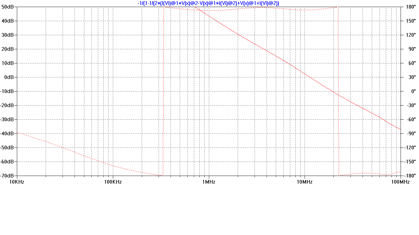

First we short the VAS emitter resistor R22 out to get noR22.gif We see the phase toodles along and crosses the 180 line on either side of the 0dB freq. so its almost certain this amp is unstable. .TRANS confirms this ... as does real life.
Next we restore R22 to 22 to get R22.gif The phase still does it's high wire act around 180 as before .. BUT .. as it nears the 0dB, it rises so that the 'Phase Margin' is some 50 degrees.

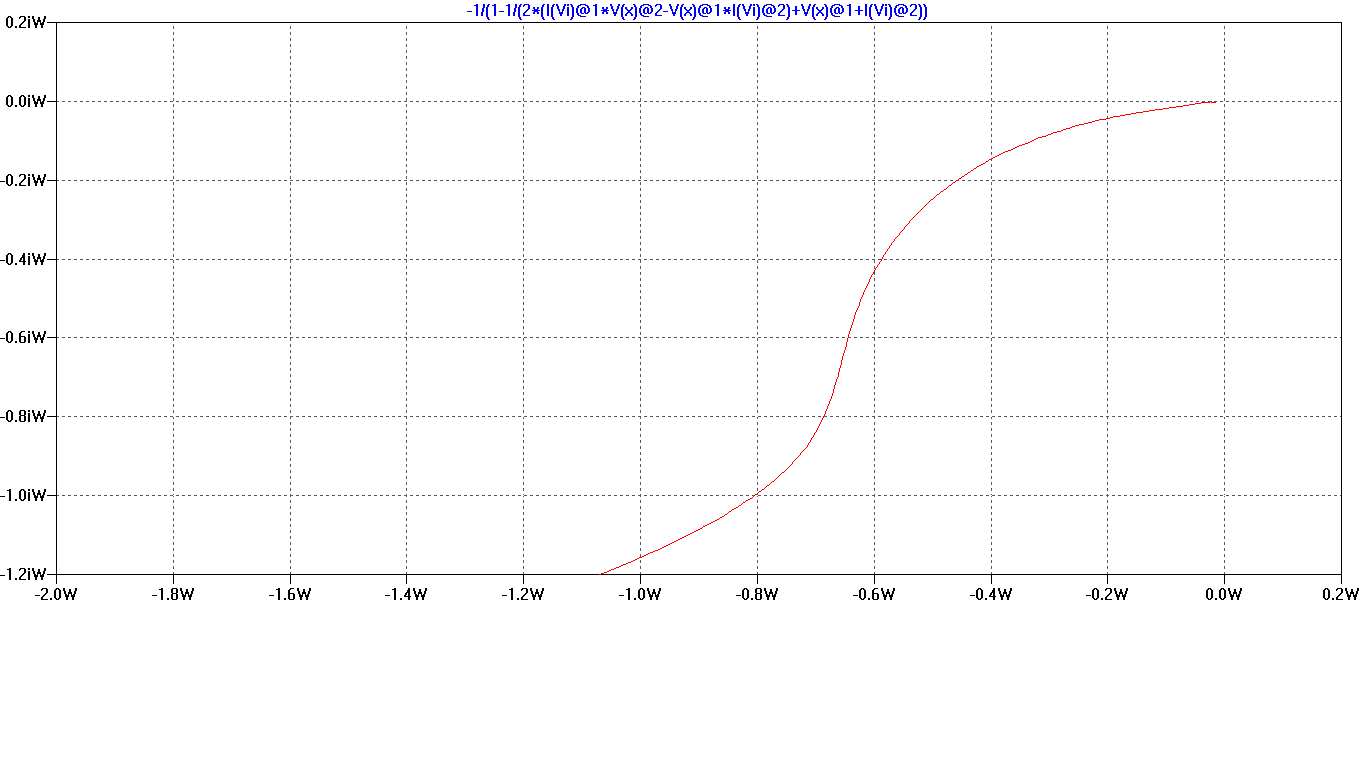

'pure Cherry' stability II
"But what about the 'Gain Margin?" you might ask. It's 180 @ 1.2MHz where the gain is 26dB.
To answer this, we need to look at the true 'linear' test of stability, the Nyquist plot. (see eg bob-cordells-power-amplifier-book post #2761) These are NyquistNoR22.gif & NyquistR22.gif But both of these plots converge on (0, 0) from 180 so must be unstable .. or are they?
Both indeed move across the 180 line .. BUT ITS WHAT HAPPENS WHEN THE PLOT NEARS (-1, 0) which is important. To see this, we have to expand the area near the origin by a zillion times.

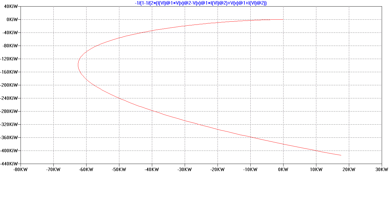

ExpNyquistNoR22.gif shows that the plot indeed encircles (-1,0) Without R22, the amp is unstable.

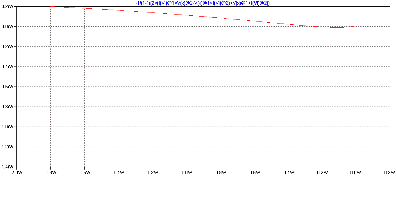

ExpNyquistR22.gif shows that R22 has kinked the Nyquist plot so that it no longer encircles (-1, 0). The amplifier is stable according to this 'linear' model ... and also according to .TRANS with various loads ... and most important of all, it is stable in 'real life'.
But please download the .ASC files and models from posts #4 & 5 and try for yourself.
Its very instructive to look at Nyquist plots with different magnifications. Shows very clearly what dem Phase & Gain margins are ... and why excursions across 180 far from (-1, 0) dun matter ... and wat dis 'conditional stability' is .. and what happens with different loads ...

Hi kgrlee,This is Cherry.gif. Remember, this is something which is known to work well in real life.
this looks nice! And for somebody not having practical experience with such a beast, it might be really surprising.
(I'm sorry,) but:
- With these slow output devices (MJL2119x), an ULGF of 10MHz is really brave. Do you know how good the models are that far away from expected usage, and how large device parameter fluctuations are?
- Adding a small *purely* capacitive load may cost some precious degress in phase margin. I once built an amplifier with ambitios ULGF, and put fuses into the OPS collector connections. I could blow them by connecting only a speaker cable, having no problem with speakers and cables together.

I humbly submit that if you have a 'linear' unstable inner loop, LTspice will ALWAYS show an unstable encompassing loop. Dis depends a lot on how SPICE handles 'linear unstable' (.. bloody oxymorons ..
But I'm certain that .TRANS will show this as unstable.
Anyone have a circuit example either way?

Hi kgrlee,Matze, you are perfectly correct to question my choice of rotten MJL21193/4 outputs. I chose them as the worst of Cordell's models. I actually used 2sd1046/2sb816 outputs and 2sc2238/2sa979 drivers. I wanted to be as close to what I did in 'real life' circa 1990 but with trusted device models.
post #93 was not meant as joke. I'm really wondering whether slow output devices that essentially go out of the picture at the ULGF may in fact improve the robustness of the system.
These are the devices operating in class B, leading to all nasty effects with highly changing Ft and so on. But if they have effective unity current gain at the critical point, they can't cause any trouble.
Thank you for the pointer.(The high ULGF in the main loop does cos the resulting amp is wide open .. as I say in post #4.) Baxandall pontificates at length on this in the Baxandall Papers on Doug Self's website when he first proposed the scheme now erroneously called TMC
