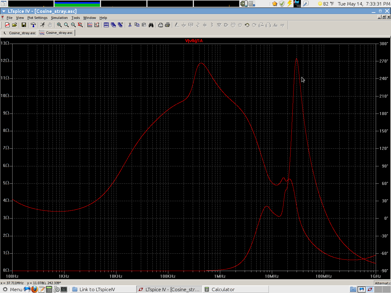

As for Zo, in almost all advanced amps, it is anything but inductive at any place other than the ULGF. I define inductive as an impedance rising at 6db/oct with a 90 degree phase shift. Anything else is not inductance and behaves totally different although you may not notice if you don't pay attention to these things.
As an example. This is the LTSpice Zout of one of my ideas. Hardly any inductance there. Phase reaches all the way back to 270 degrees! This is an indication that feedback is more fully utilized. It is more common to have a phase of 180 degrees or less, but not usually less than 90 degrees.
I wish LTSpice had a polar+logarithmic Nyquist plot feature (with projected cartesian rulers). That would be so much more useful than the Cartesian nyquist plot.

I'm going to call, 'Foul' and guess its not a PA or maybe has the evil Zobels & other stuff still connected.As an example. This is the LTSpice Zout of one of my ideas. Hardly any inductance there. Phase reaches all the way back to 270 degrees! This is an indication that feedback is more fully utilized. It is more common to have a phase of 180 degrees or less, but not usually less than 90 degrees.
Further cheats are the use of Linear axis for the impedance to astound & amaze us unwashed masses.
You gonna come clean?
I stand corrected. There appears to no part of the frequency spectrum where Zout of my poor efforts are even remotely Inductive. I grovel at Guru keantoken's feet.Why don't you just plot the Zout of your own amps? It's quite easy to verify what I said.
The evil effects in fig 2D of Intersil AN1092 http://www.intersil.com/content/dam/...n10/an1092.pdf appear to be rife. My excuse is that I only pretended to read it.
