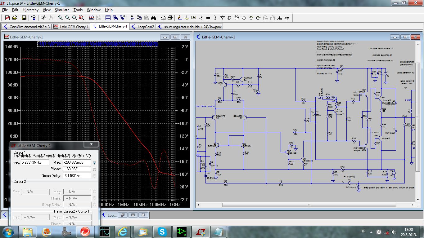

Here is my attempt with pure Cherry. I used my amp Little-GEM for this test. It looks stable but with quite small PHM and good GM. If I connect Tian probe directly to the output it looks much better. Improvement suggestions welcome.

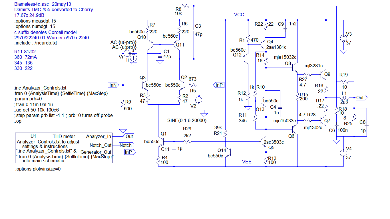

Damir (dadod)'s recommendations for TMC

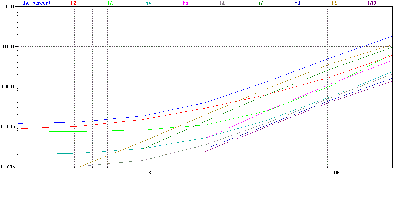

I've incorporated Damir's recommendations for TMC from #55 which are very similar to his 'Little Gem' amplifier. The result was unstable which was cured by increasing his C3/5 from 100p/330p to 220p/680p. I didn't do my usual full stability analysis; just a quick one to see if this is viable.
THD is about the same as with Michael's recommendations which I simulated in posts #56 & 57 but the 20kHz residual is less spiky .. less high order harmonics.

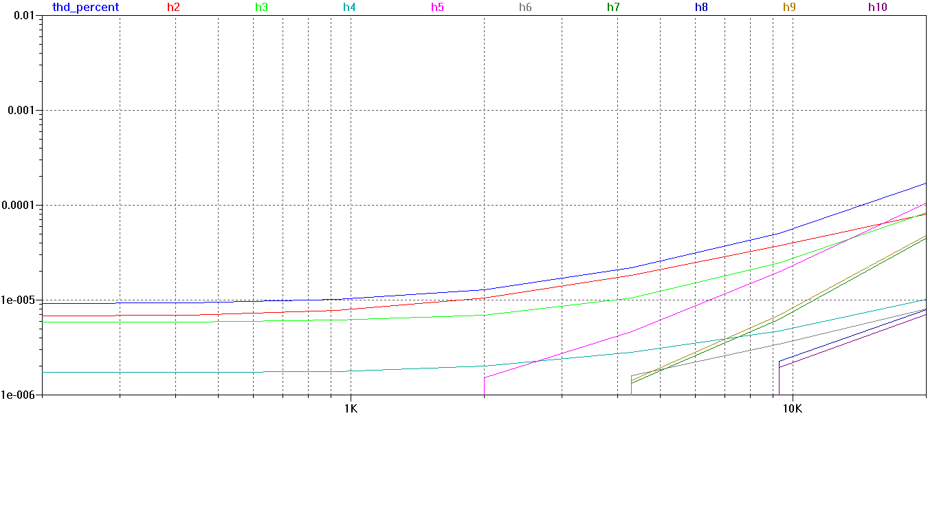

Damir 's 'circuit' converted to 'pure Cherry'
I converted this to a 'pure Cherry' amp using the same devices & topology. I reduced currents and changed resistors to what I like.
THD is still nearly 10x better than TPC. Again, only a very quick stability test was done but with 20dB better THD, we can afford to lose some of that for better stability.
Again, only a very quick stability check has been done.
I'm hoping some people will try 'pure Cherry'. 10x better distortion is worth a little (OK a LOT 😀) extra care and attention to layout.

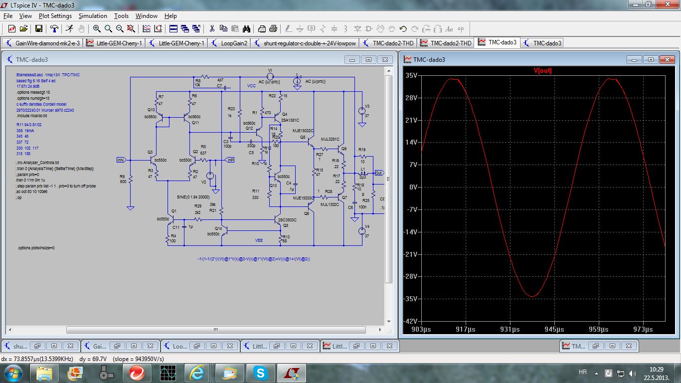

It looks strange that you've got instability with my TMC values, it was stable in my simulation. Could you show the Loop Gain?
By the way, Little GEM is stable, I changed my previous amp to get it close to the Little Gem and it is stable and quite good sounding, actualy excellent sounding for that simple circuit.
BR Damir
P.S. I repeated .tran sim with THD meter as the input generator and it was oscillating. When I used standard input generator there was no oscillation. Way???
Check how the source impedance influences stability, and what is the output impedance of the THD rig?

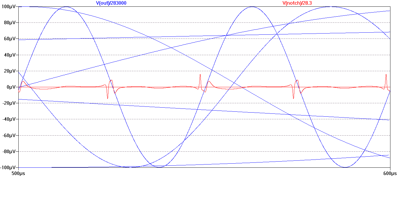

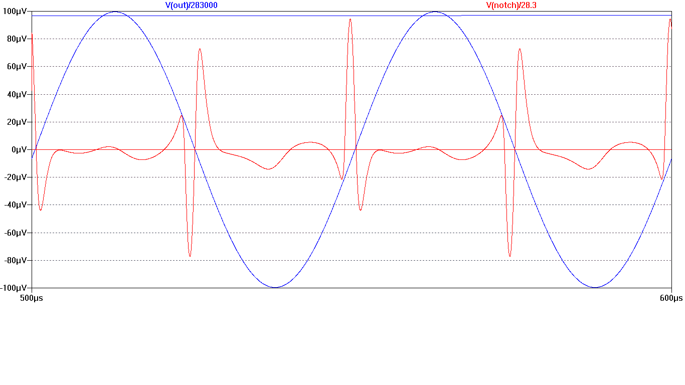

If youI repeated .tran sim with THD meter as the input generator and it was oscillating. When I used standard input generator there was no oscillation. Way???
- use my Blameless4.asc from #173
- change C3/5 back to your 100p/330p
- remove U1 the THD meter
- connect V2 to InP
- edit the SPICE directive to just say
.tran 0 11m 0m 1u
you'll find oscillation on only some of the negative peaks.
This type of instability may come & go in 'real life'. It often doesn't show up in 'linear' stability measures like PM, GM, Bode, Nyquist etc.
If you change C3/5 to 220p/680p, the amplifier is stable according to all, linear & non-linear, SPICE methods.

In my simulation I've had some oscillation only on the verge of clipping, and when I simulated as you suggested I had oscillation on some negative peaks. This should not be provoked by non adequate TMC but somewhere else. By increasing C4(parallel to the Vbe multiplier) from 1nF to 0.1uF oscillation disappeared and remained some clipping oscillation(on positipe peaks). With lower VAS degeneration(R22) from 22 ohm to 15 ohm or even 10 ohm all oscillation desappeared.

You have C4 across Q13 and the driver bases.
What if you moved it to between Q4 & Q5 collectors?
Then investigate whether the two values (1n & 100n) give similar results.
Yes, D. Self use it that way, but here I've got less oscillation if connected across Q13. The same way I used it in my other amps.
