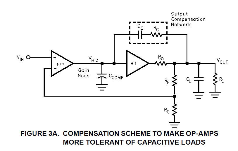

The side effect of the 1 nF shunt CAP is reducing slew rate dramatically.
However, there is another way to make every thing stable without that shunt CAP.
I find this paper which may give us a hint. Please see figure 3A in this paper.
http://www.intersil.com/content/dam/Intersil/documents/an10/an1092.pdf
The key is to make output pole more dominant.
I suggest the Gm of the VAS should not be greater than 1/RC in Figure 3A. Degenerating VAS should be required.
That scheme gives the amp an output impedance like a damped inductor. IE you are getting the amp to perform the function of the output series L/R network. The problem is that when you emulate this function with the amp, you increase distortion because the virtual impedance is generated by nonlinear transistors. This is something I would only do when I could not use an output network.
Zo only causes distortion if the load is nonlinear. The Zo of that compensation scheme itself will be nonlinear because it is a virtual impedance derived from nonlinear transimpedances, and this will cause distortion even with a linear load. The implication is that using a discrete impedance network (output series L/R) instead of a virtual one (caused by compensation) will distort less in both cases.
You're absolutely right but I felt compelled to insert a distinction. 🙂
Also, the comment about monstrous output Cbe dominating at BW extremes for very fast amps is true. For this your frontend has to be much faster than the Fc of Rm*Cbe (Rm=transresistance). However it is important to note that at the frequencies in question your entire amp will be in the throes of slewing with any significant signal. So is this really healthy? Such an amp will be relatively highly susceptible to RF intermodulation effects.
ALL opamps and Power Amps have an output Z with is inductive at HF. Just have a look at OPA datasheets which show Zo. eg Fig 2B in Intersil AN1092 that jxdking quotes.
You can measure this on a PA but you'll have to remove the Zobels and output inductors. Some amps may not be stable without these.
The Zo is also affected by feedback and usually to the same degree as THD ... both for linearity and value. For the usual high FB amp, Zo will be both small and 'linear'.
One could model the complete THD behaviour of an amp by considering all the THD is due to 'non-linear Zo'. I'm not sure there is any advantage wrt to the usual ways of looking at things.

As for Zo, in almost all advanced amps, it is anything but inductive at any place other than the ULGF. I define inductive as an impedance rising at 6db/oct with a 90 degree phase shift. Anything else is not inductance and behaves totally different although you may not notice if you don't pay attention to these things.
As an example. This is the LTSpice Zout of one of my ideas. Hardly any inductance there. Phase reaches all the way back to 270 degrees! This is an indication that feedback is more fully utilized. It is more common to have a phase of 180 degrees or less, but not usually less than 90 degrees.
I wish LTSpice had a polar+logarithmic Nyquist plot feature (with projected cartesian rulers). That would be so much more useful than the Cartesian nyquist plot.
I'm going to call, 'Foul' and guess its not a PA or maybe has the evil Zobels & other stuff still connected. 🙂
Further cheats are the use of Linear axis for the impedance to astound & amaze us unwashed masses. 😱
You gonna come clean?
Why don't you just plot the Zout of your own amps? It's quite easy to verify what I said.
I stand corrected. There appears to no part of the frequency spectrum where Zout of my poor efforts are even remotely Inductive. I grovel at Guru keantoken's feet. 😱
The evil effects in fig 2D of Intersil AN1092 http://www.intersil.com/content/dam/...n10/an1092.pdf appear to be rife. My excuse is that I only pretended to read it. 😡
