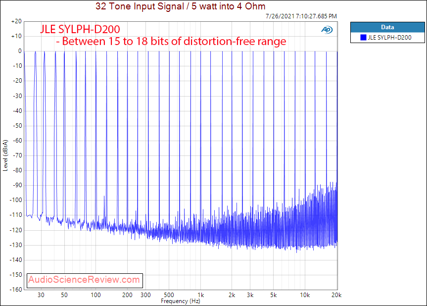

You recommend here and distribute (ALIEXPRESS) LOF350-20B48-C and LOF500-20B48-C power supplies.
Can you provide us with measurements concerning the noise of these, a bit like those made by LESTER (SYLPH AUDIO) on AUDIO SCIENCE REVIEW
(thread "JL ELectronics Sylph-D200 Amplifier Module Review", post #193) ?
This would allow us to have a better view of the quality of these power supplies and would indirectly impact your sales
Thank you in advance
Cordially.

Can you use the same scales like AMIRM on ASR ->
It is not easy for everyone to convert µVrms to dBrA of your measurements : it would be better understood by all readers
( original link -> https://www.audiosciencereview.com/...ics-sylph-d200-amplifier-module-review.25295/ )

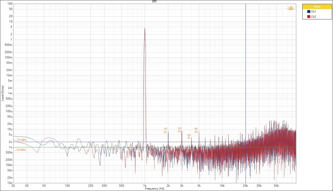

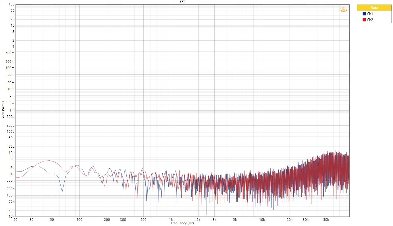

Hi TNT
FFT of the power unit.
