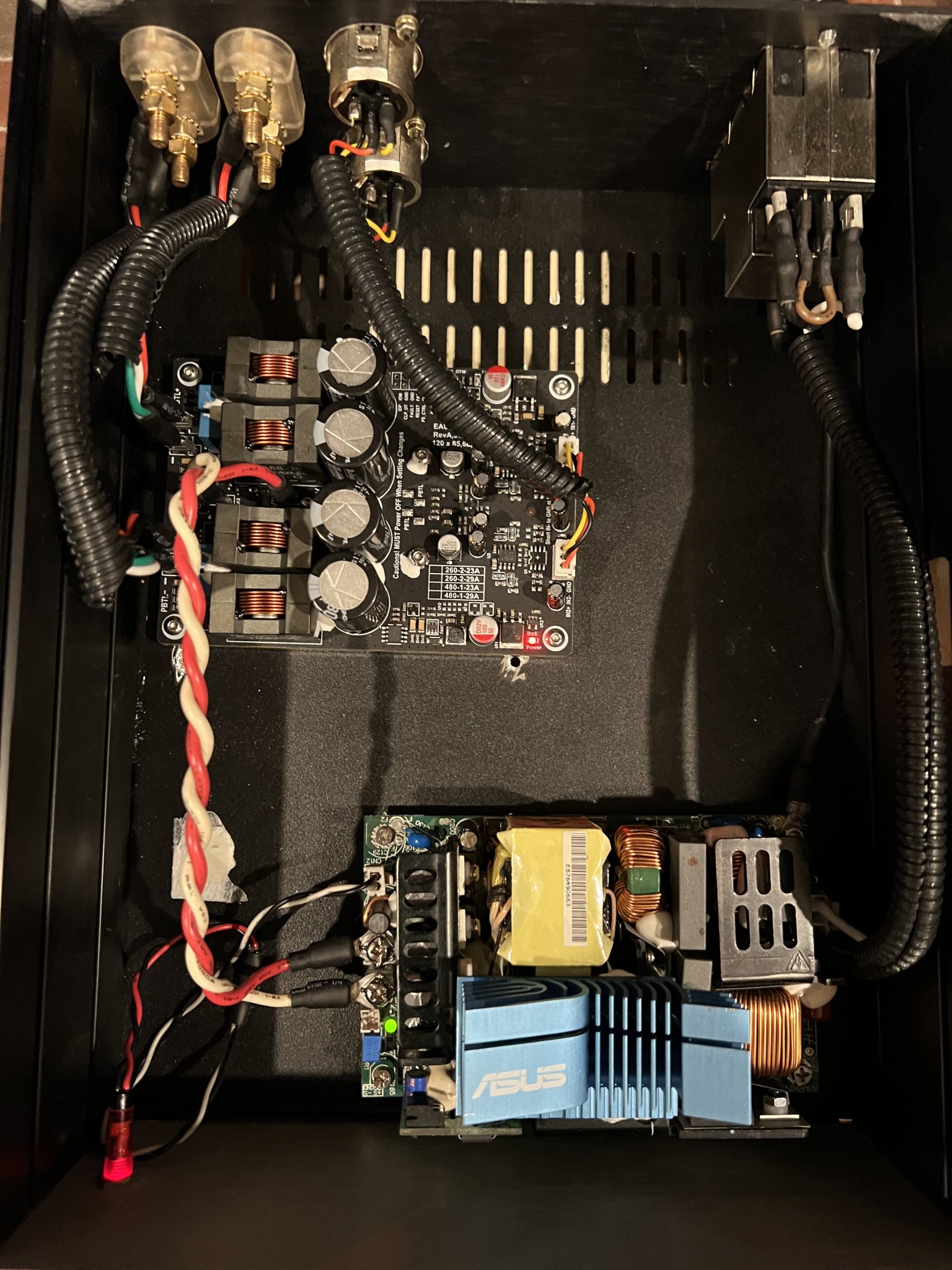

I have both the new and old 3e Audio amp boards and the new one is a clear step up in every way. My only complaint about thenew amp with PFFB is that the gain is a bit low.

People hi 🙂
@ Fsatsil:
You are very lucky to have already obtained this new version 😎
(What operational amplifiers are used ?)
It is a beautiful assembly that you have made 👍
However, I have two questions for you:
1> you seem to have used a MEANWELL open frame EPP series power supply (EPP 400-48 ?).
Some say that it is not really efficient or even noisy:
can you give us your impressions please ?
2> You added a 10000µF capacitor (?) in parallel with the power supply (a diagram would have been welcome):
what is the purpose and/or the interest of this assembly ?
Thank you in advance for your answers 😉
Cordially.

1>
The Meanwell power supply I used is the RPS-400 and I don’t find it to be noisy at all in fact I was very impressed with how quiet it is since I’ve had noise issues with the cheaper Meanwell Eps series.
2>
As for the 10000uf/63V capacitor, it was originally used because it was in my parts bin and I figured it couldn’t hurt to add some power storage to the power supply. The cap has since been removed since I couldn’t hear any difference with/without it.
I hope this answers some of your questions. Enjoy the weekend!
Good evening (I'm from France) Fsatsil.
Thank you for your answers 👍
I think they will be very informative for everyone regarding MEANWELL power supply models and the use or not of an additional reservoir capacitor.
For the latter, I think it can even be counterproductive for different reasons 🙄
It's a pity that you couldn't make measurements with and without this capacitor...
I also wish you a good and pleasant weekend 😉
