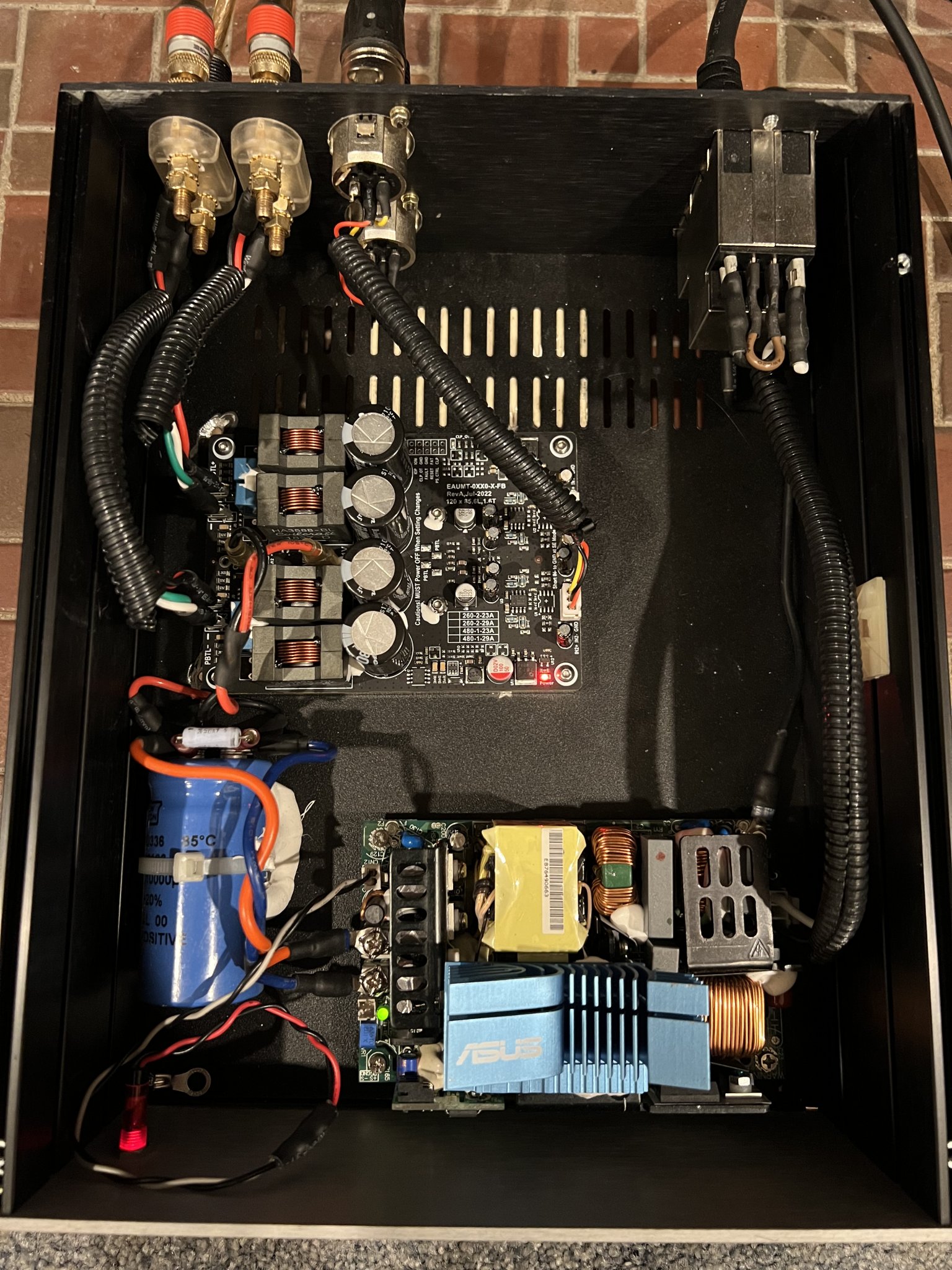

I got mine in the mail the other day, it looks really nice, I plan on getting it into a chassis and tested this week, I'll be updating the thread with my feedback.

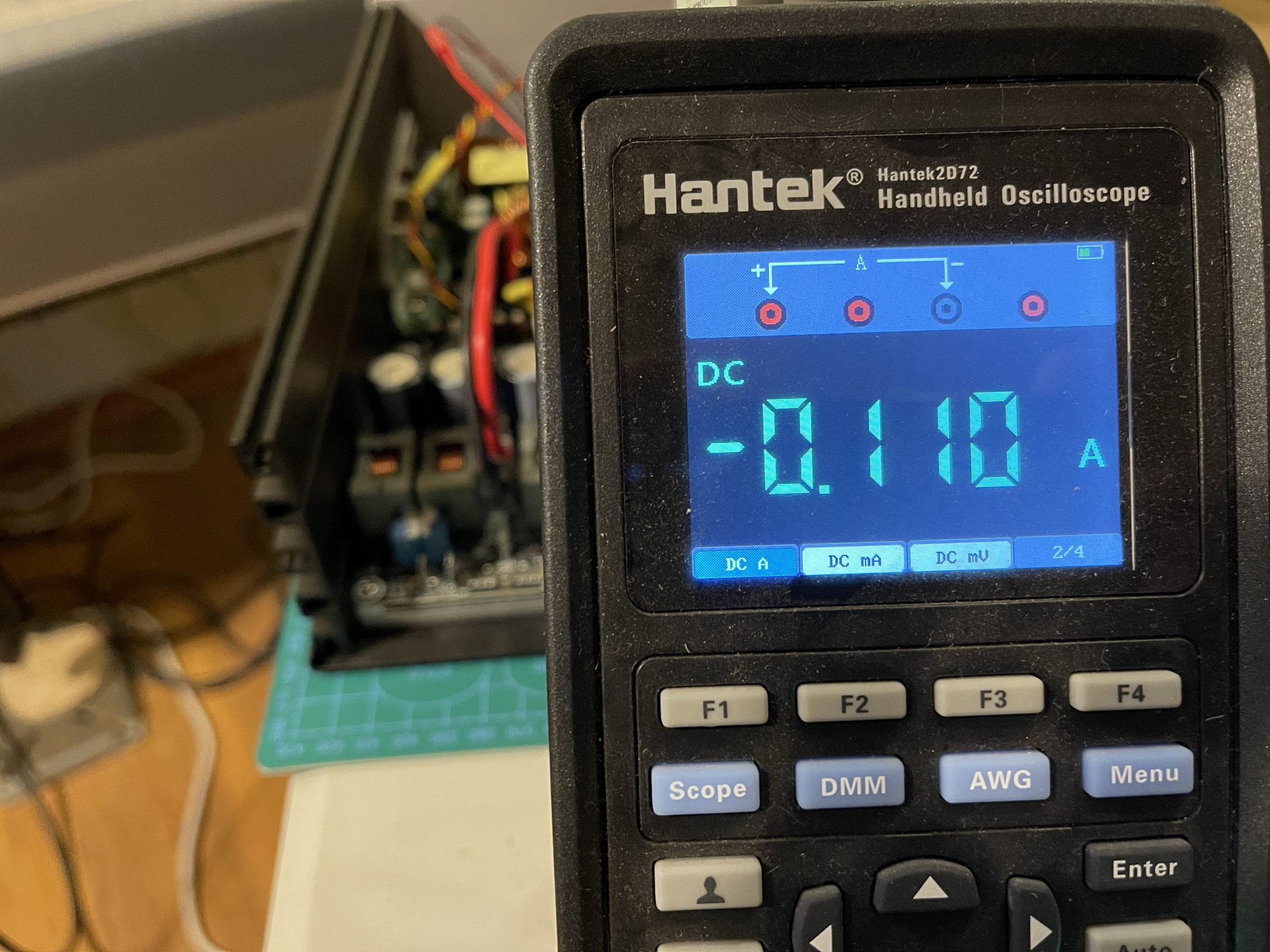

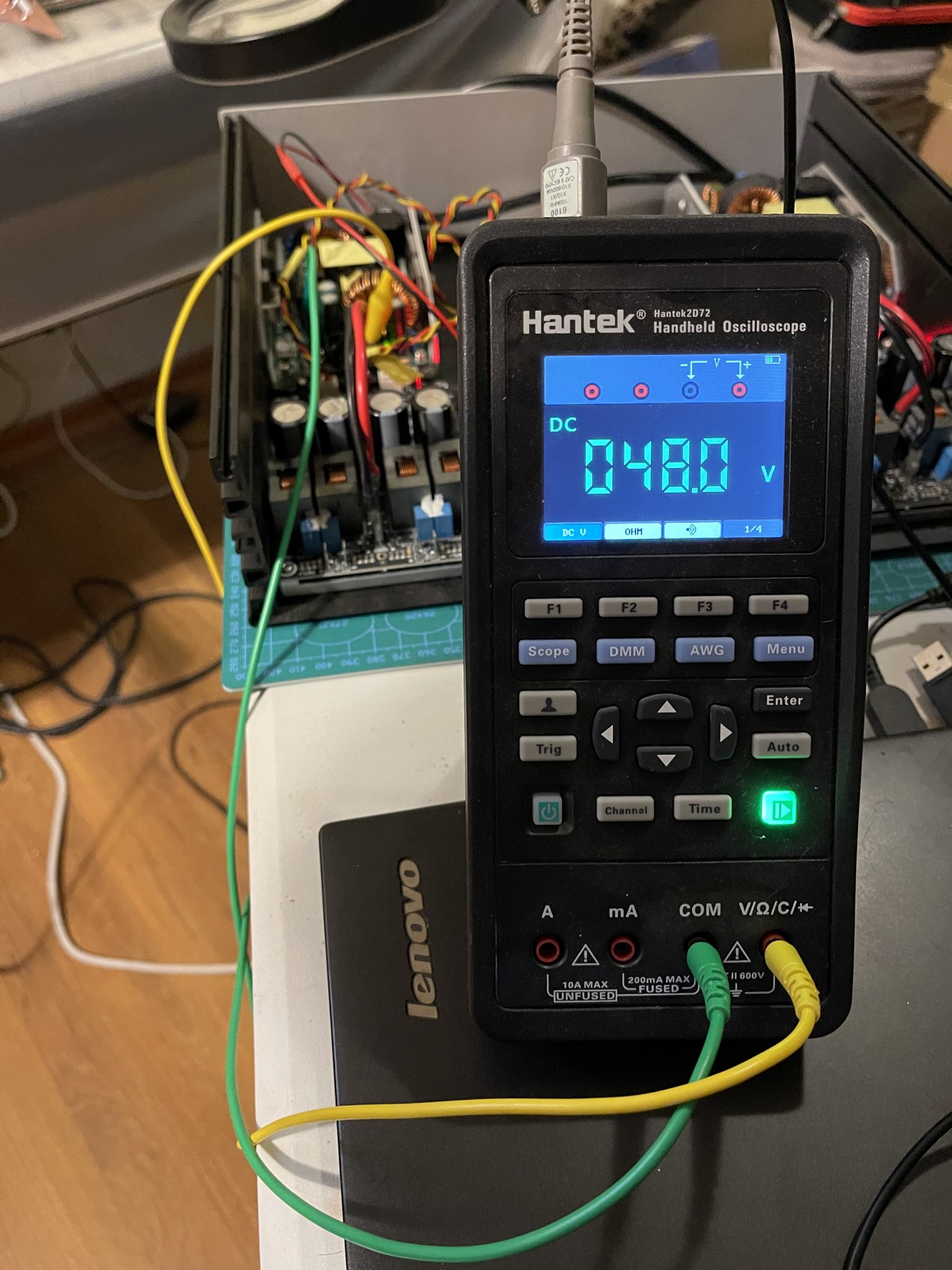

Running two amps for several hours at 48V. A bit of heat coming off the coils and the caps, nowhere near the heat buildup from the previous amp. The massive heat sink works as expected decoupling thermals from the passive components. Idle current hovers at 110mA and I expect it to remain pretty flat given the coils do not heat up.
Driving a pair of Purifi PTT6.5X4 & T25B active xo, I cannot hear anything resembling a hiss with no input to the amp.
I briefly compared sound to the (more powerful) Audiophonics HPA-S400ET on the same speakers and frankly I can’t hear a difference with various music types after setting both amps at reference output of 2.83V.
It’s a step up from the previous non PFFB amps IMHO.
Disclaimer - I’m past 50 and certainly not equipped with “golden ears” 😂
I also don’t have sensitive gear to measure stuff beyond 90dB
The only thing I miss out is the AUX 12V supply present in the non-PFFB, I used it to drive the DSP stage.
