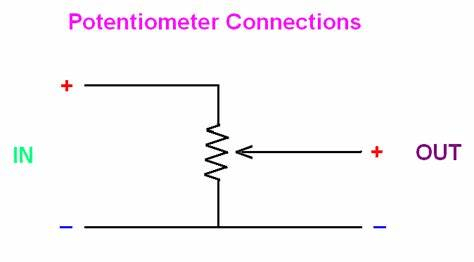

Limited electronics experience and I would really appreciate some guidance. If I were to add a potentiometer in front of the 3E BTL (2 channel boards) What value of the potentiometer would I choose? I can see that the unbalanced input of the board is 10K Ohms. The pre-out going into the amplifier boards is 2v, 200 Ohms?

the better case is your source(DAC) has volume control,
otherwise you may refer this one, typically 10Kohm,50Kohm or 100Kohm POT can be used(the lower resistor the lower noise)
please note, if you are talking about the not-PFFB AMP,you don't need modify, but if PFFB-AMP, then you need modify(see user manual)

Building a couple of multi-channel amps for multi-zone usage. The DAC in front does have VC. But, for multi-zone usage individual controls are desirable. Most of the 3E boards (4 total) are not-PFFB (B version I believe). But, I was planning on ordering one of the new PFFB units as well. I see that I will have to modify this board for single ended input. Thank you for pointing this out to me! If 10Kohm potentiometer will do the job I'll look for a volume taper version from ALPS as this seems to be a popular choice. Thank you for the response!
