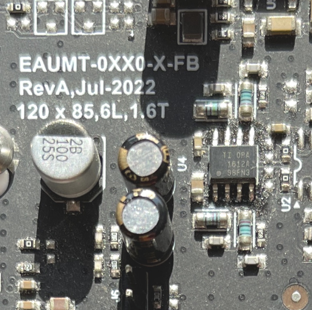

due to feedback design ,it is not allow to change op-amp as it will degrade the performance.Hello!

it use opa1612 for best low noise and distortion, so it is very limited chance to change some components for improvement in diy point of view.

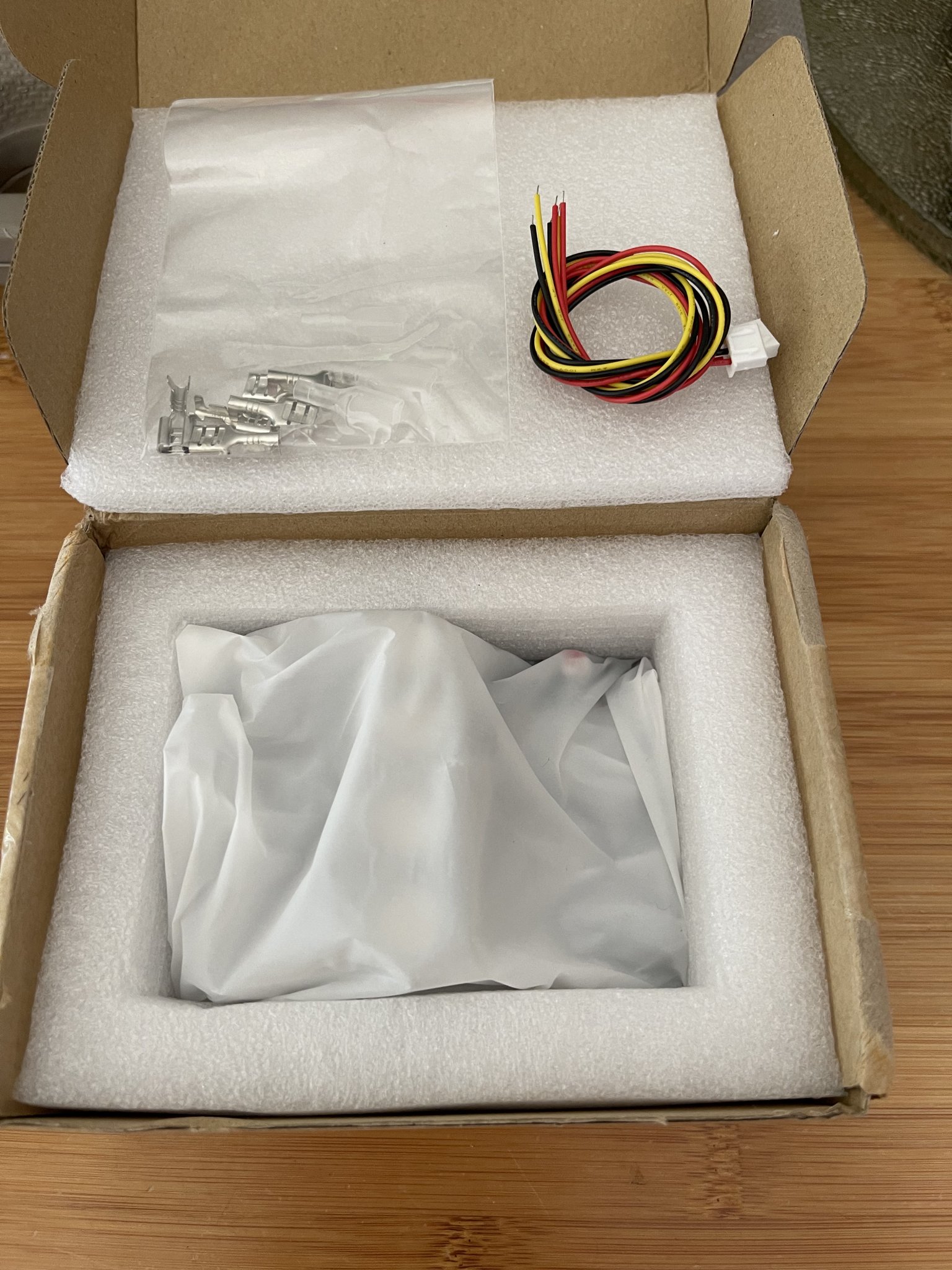

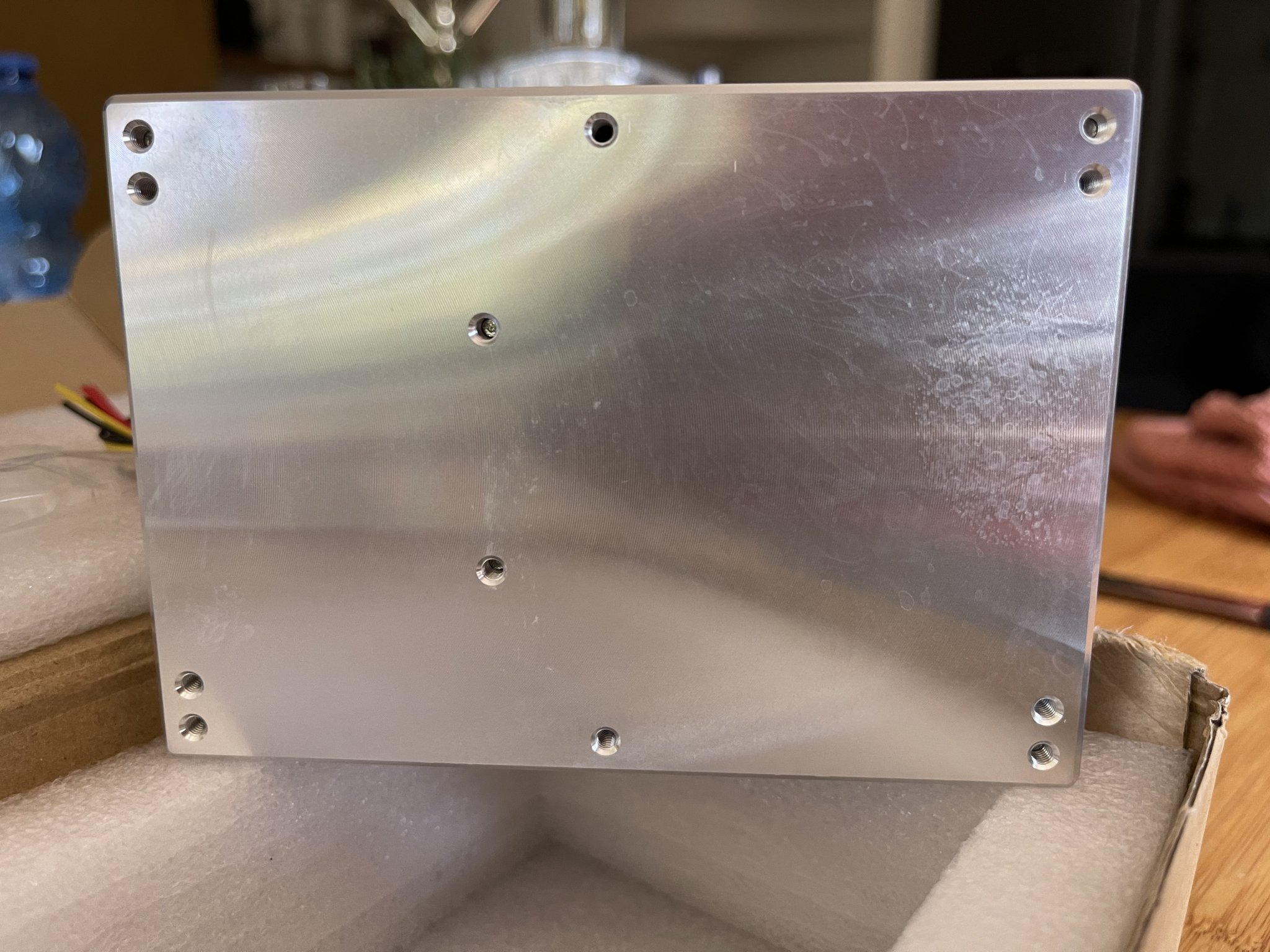

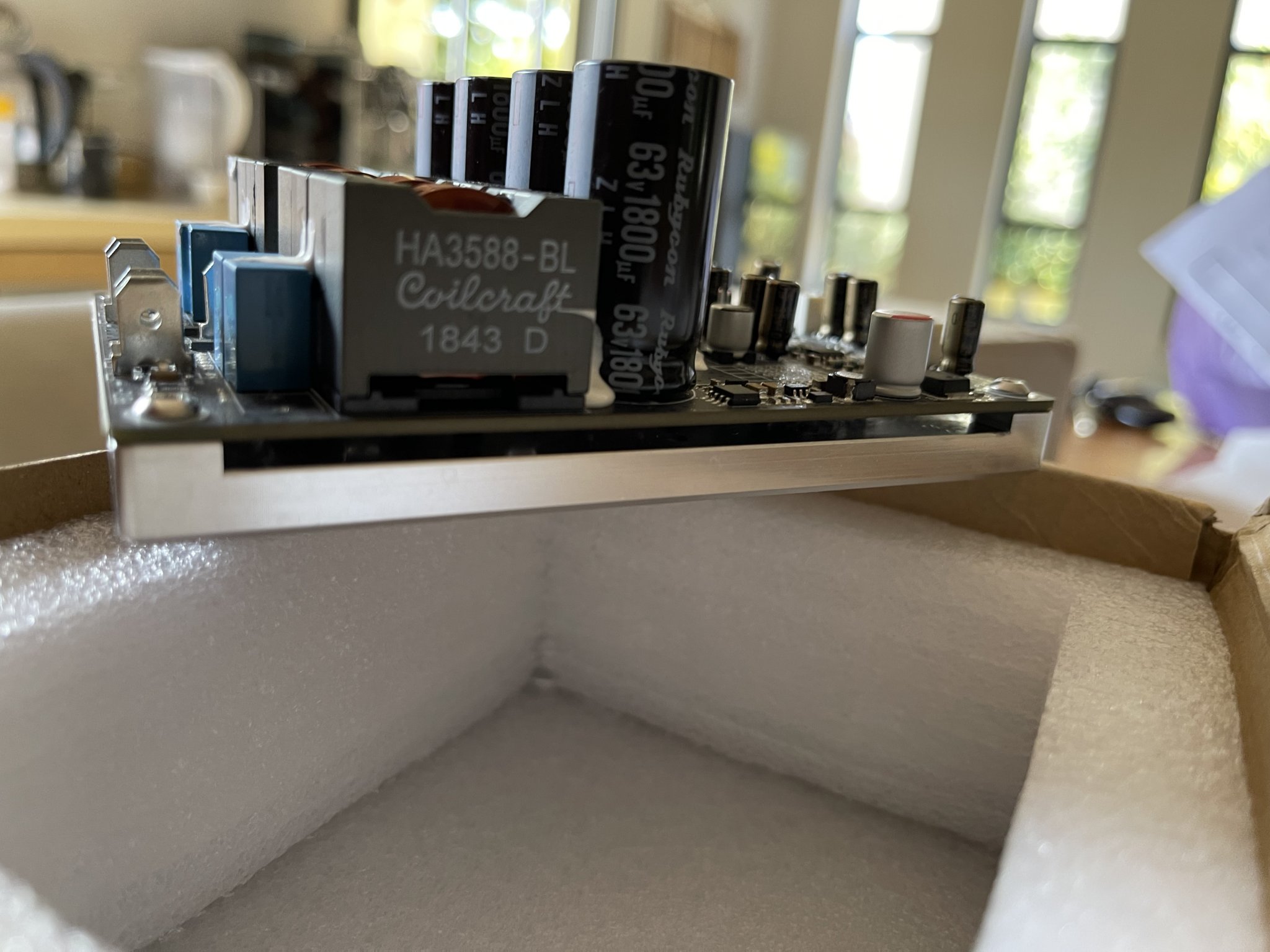

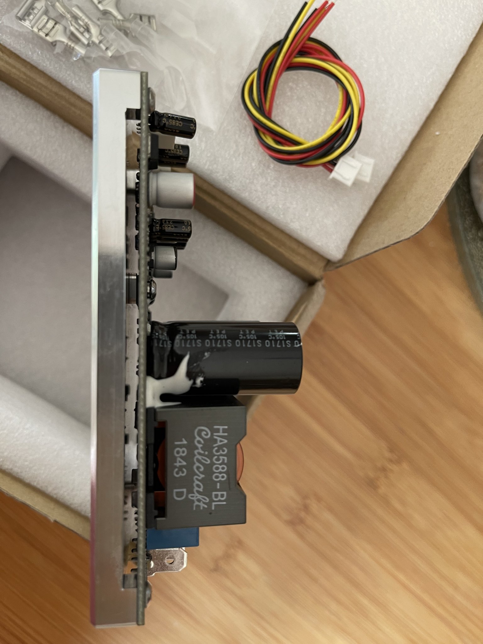

Got 2 amps delivered this morning. I can say that I’m positively surprised- assembly and attention to details is top notch. It’s a smaller amplifier compared to other versions with top heat sink. It’s built like a tank, relatively massive CNC machined aluminum heat sink. Soldered OPA1612 with high quality passives. Post soldering could be a bit cleaner, other than that no complaints. Beautiful piece of tech, shame it will be hidden in a case. Planning to run 2x amps, separate 48V, fed through a ADSP21489 with CS4398 DACs. Hoping to connect all pieces together in a month. Great job 3e!

Looks very nice, share your experience about sound quality when you test it please.Got 2 amps delivered this morning. I can say that I’m positively surprised- assembly and attention to details is top notch. It’s a smaller amplifier compared to other versions with top heat sink. It’s built like a tank, relatively massive CNC machined aluminum heat sink. Soldered OPA1612 with high quality passives. Post soldering could be a bit cleaner, other than that no complaints. Beautiful piece of tech, shame it will be hidden in a case. Planning to run 2x amps, separate 48V, fed through a ADSP21489 with CS4398 DACs. Hoping to connect all pieces together in a month. Great job 3e!

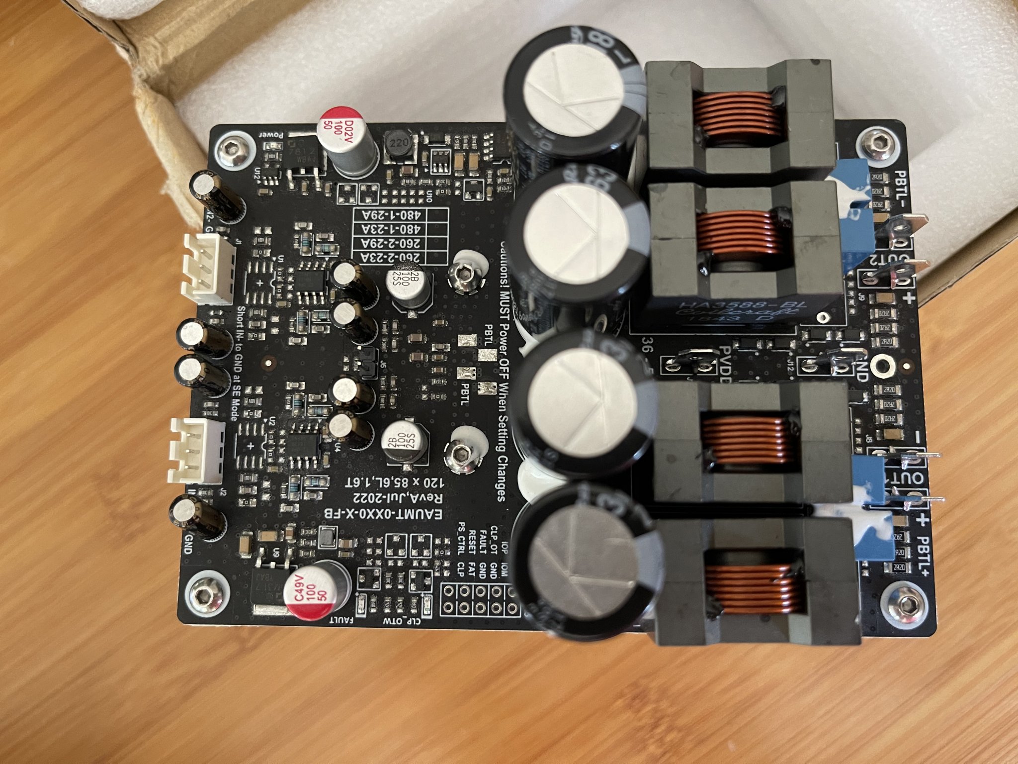

@3eaudio Audio, what is J5 and J6 used for?
Got mine this morning, 13 days to US and arrived earlier than expected. Very well packaged considering the weather right now, package was literally waterproof and sat outside in the rain a bit, no water got inside. I can concur, very well built and heavy with the coilcraft inductors and solid machined aluminum heatsink.Got 2 amps delivered this morning. I can say that I’m positively surprised- assembly and attention to details is top notch. It’s a smaller amplifier compared to other versions with top heat sink. It’s built like a tank, relatively massive CNC machined aluminum heat sink. Soldered OPA1612 with high quality passives. Post soldering could be a bit cleaner, other than that no complaints. Beautiful piece of tech, shame it will be hidden in a case. Planning to run 2x amps, separate 48V, fed through a ADSP21489 with CS4398 DACs. Hoping to connect all pieces together in a month. Great job 3e!
It's documented on their site...
To change the master or slave config of the board, in case of multi-board use.
