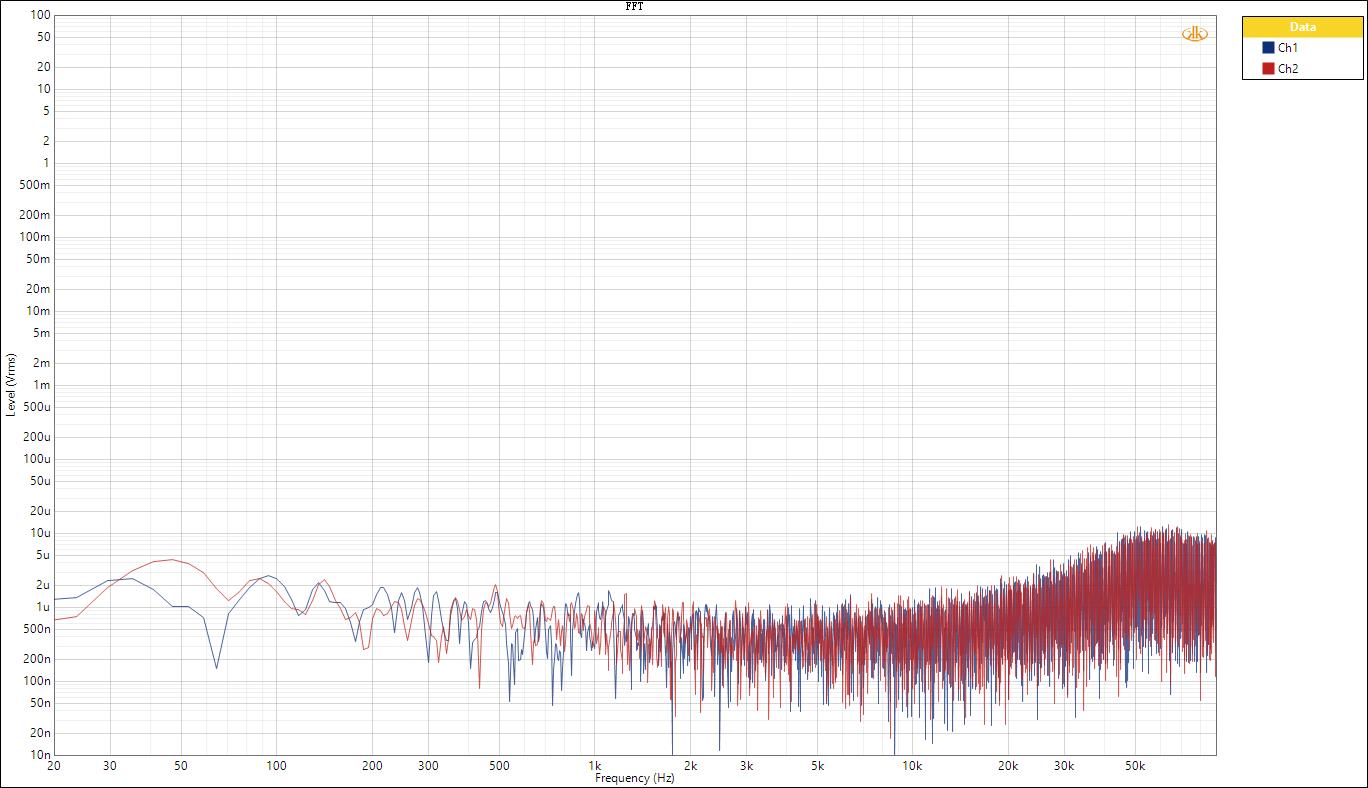

Hi 'people' from 3eaudio 🙂
Have you ever heard of power supply issues (MORNSUN SMPS) with the SABAJ A20a amplifier when it switches to energy-saving mode ?
I suggest you look here ->
https://www.audiosciencereview.com/...0-fully-balanced-pictures-inside.23311/page-7

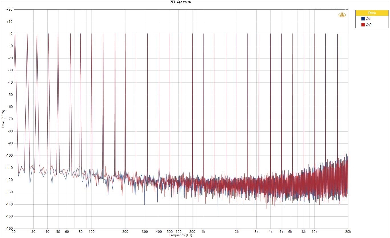

Thank you for changing the values and scales on your curve: it's much better this way and it allows you to compare what is comparable 👍
However, you do not indicate which device it is also this curve does not mean anything as it stands...
It's a shame because the curve is very good 👈
As a reminder, users generally use speakers either in 4 Ohms or in 8 Ohms: there should be two curves so that it is more representative for everyone.
Don't take my remarks the wrong way, I hope, it's just so that you are more precise in your presentation and that at the same time you will be the only ones to propose this type of measure in complete transparency, which will no doubt have an impact on your sales positively 😉
This is a very positive point for you, because MEANWELL does not (maybe they have a reason ?)
Regards.

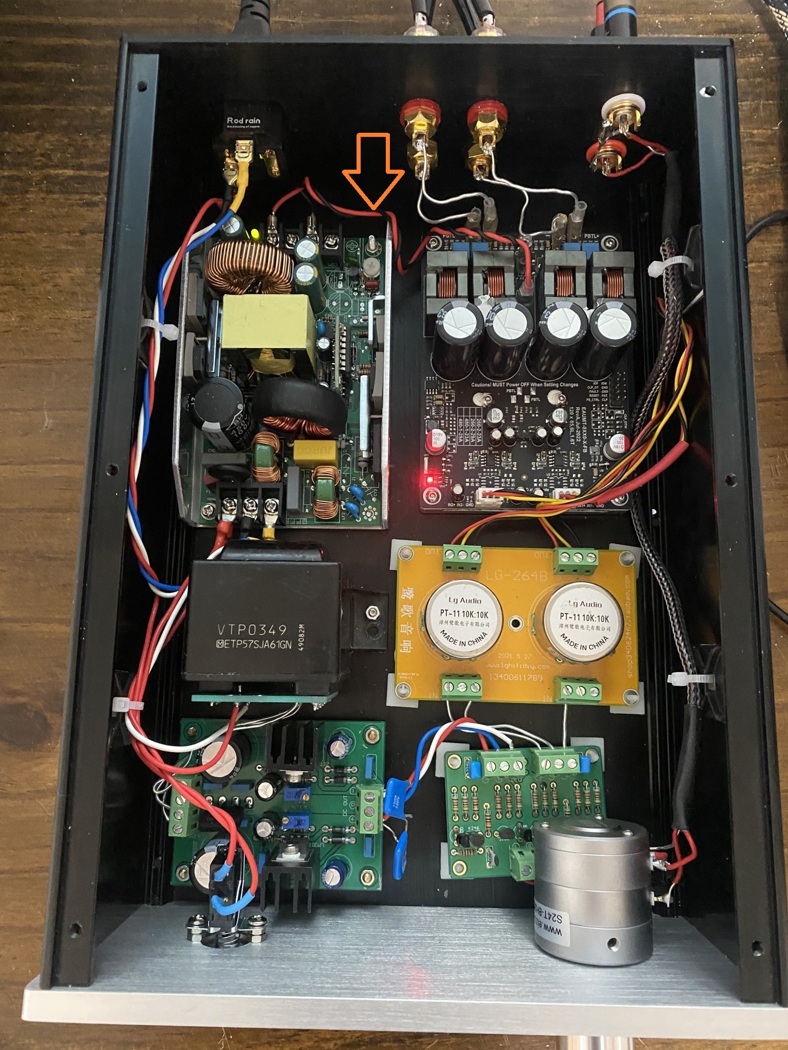

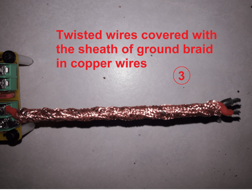

People hi 🙂

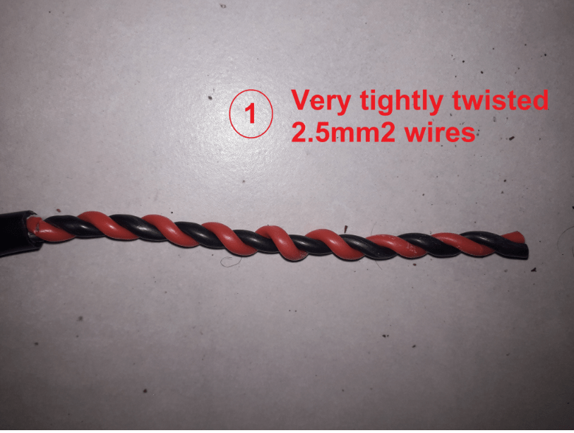

I agree with 3eAudio: I would even add that you can twist ALL the cables 😉

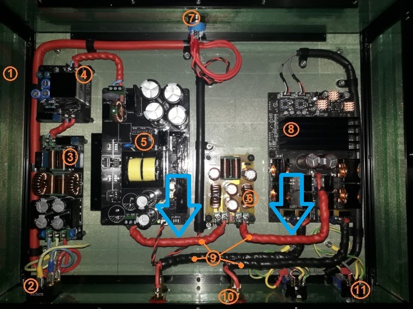

For your DC voltage cable between your power supply and your amplifier PCB, you can also take inspiration from what I did with my amp ->
As you will notice: the cables are covered with heat-shrink sheath for finishing and to avoid possible false contacts.

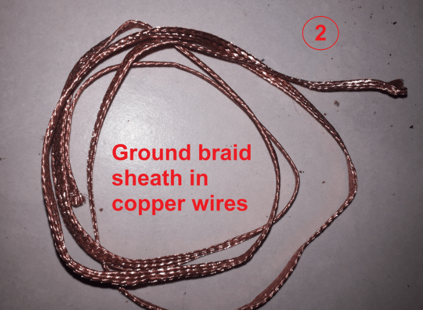

Just for information, my chassis was covered inside with anti-EMI tape (FARADAY cage style) then covered with another tape this time electrical insulation for the same reason as before.
Who can do more, can do less 😎
PS:
As for the diameter of your speaker output wires, you must think about the diameter of your woofer coil wires:
I doubt they'll even be 1 millimeter in diameter, which might give you an idea of the advantage of using large diameter wire unless you use your amplifier more than 100 meters from your speakers to avoid linear losses... 🙄
Also, the use of 'silver wire' (or other 'precious' or 'magic' material) will also have a significant influence on your wallet but certainly not on the quality of reproduction of your hi-fi system.😒
I say that but I said nothing...
Finally, we can do even better, other members surely have good ideas to offer you 👍
See you soon
