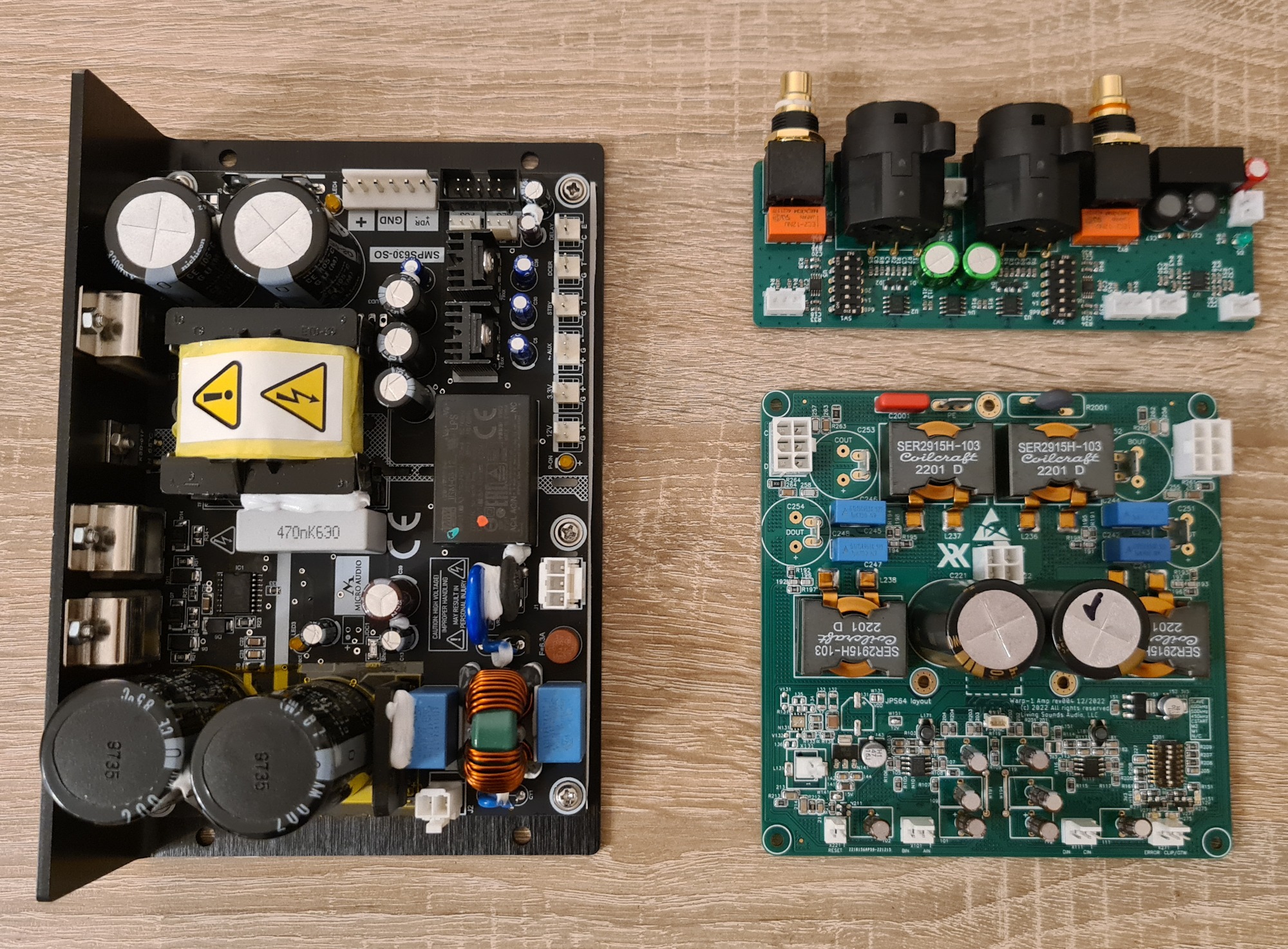

Did Sami give an explanation why the SMPS wasn’t 100% assembled?
The reason for sending the PSU & the heatsink separately is that I don't have the heatsinks here.
So, I had to ship the heatsink separately from the factory and the SMPS from the lab.
The assembly job is pretty easy and takes 10 minutes.
Thanks Sami again! One thing... I did it in 8 minutes 😀The reason for sending the PSU & the heatsink separately is that I don't have the heatsinks here.
Ignore that thermal pad and just attach the thermal switch directly.Curious what you did with the double-sides blue tape that came with the SMPS. Sami tried to describe where to apply it, but his explanation made no sense to me.

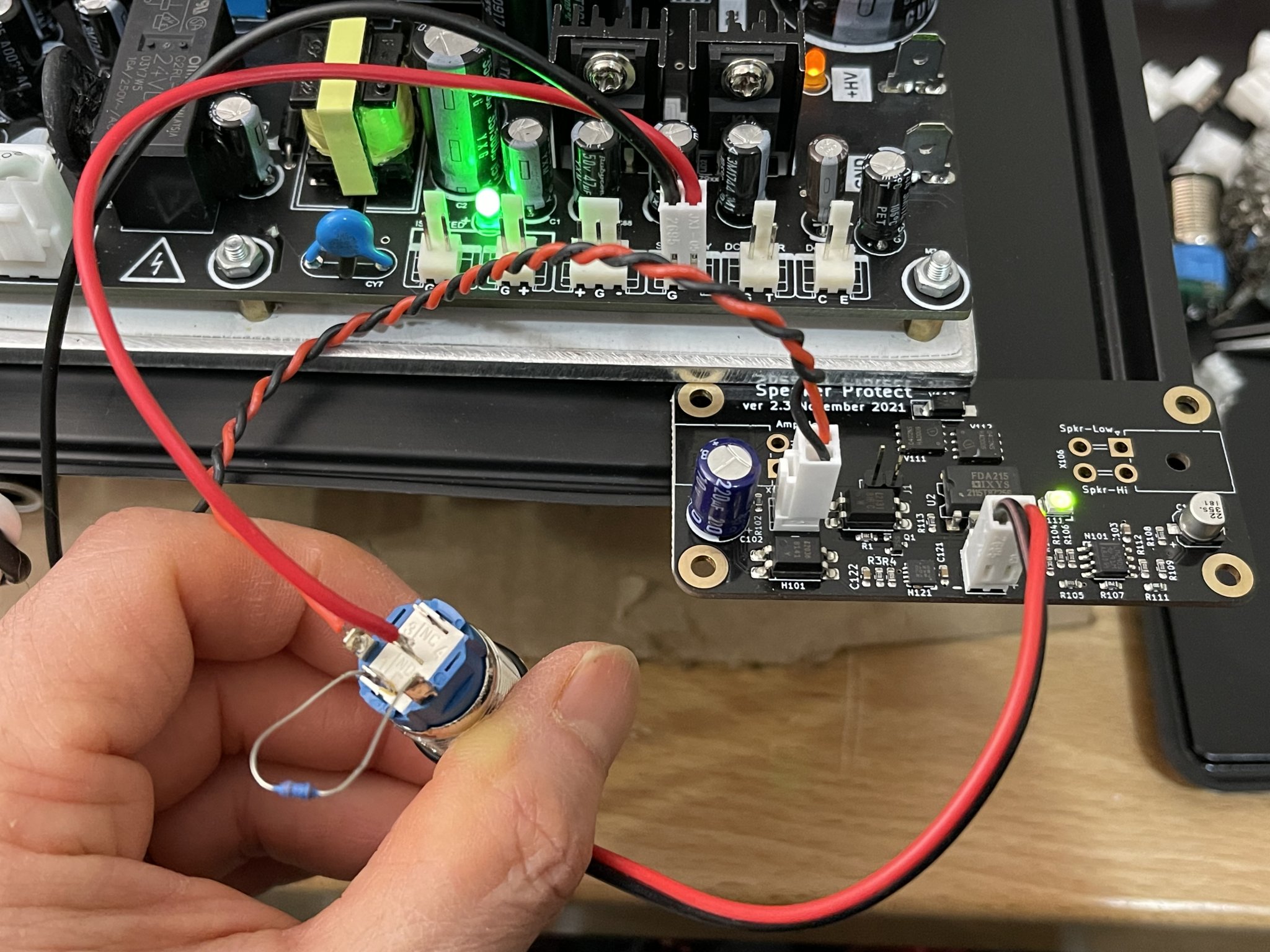

Hi X,
could you please check and correct (if needed) the following wiring plan for the psu?
- Main voltage output with the big connectors: to the amp board, it's clear 🙂
- 12 vdc output to the buffer
Yes, always on 12vdc if IEC mains switched on.
- 3.3 vdc output can be used for an LED on the front with a resistor in series
Yes, choose for 1-2mA current. 2mA might be bright.
Yes, to prevent turn off thump. Allows opamps to stay on longer than power amp. Use 2200uF 16v.
- AUX (15 vdc) to the amp board - but in your build (and in the picture above) I see a cap on the top of the connector; is it against turn on bump? If so, which value/voltage is needed?
- How/where to wire the further contacts (STDBY, DCER, DELAY?)
- PSU input is J1, whit the left contact live and the right contact neutral? Middle contact not in use?
The STDBY goes to switch common. n/o on switch goes to switch LED anode using circa 470R resistor. LED cathode goes the STDBY GND.
Delay provides 2 sec delay and then open collector logic to drive your accessories logic like an output SSR. Etc.
DCER is a warning light to show PSU has error and needs to be reset. Use appropriate resistor and LED circa 1k I think.
- J2 has in your build (and in the above too) a jumper - what is it for?
J2 is jumper for 110-120vac mains. If you are 220-240vac remove it! Or it will blow the amp since PSU will make 2x designed voltage (100v!). It will kill the amp.
- Where can I set the input voltage to 240vac?
See above. Do not install J2.
- mains fuse value at 230vac?
I use 5A to allow for inrush.
- Is the turn on button a locking one or just a push button without locking?
Locking one or latching one.

Only the push button is not clear, sorry. Should the switch stay closed after turn on, or does it only give an impulse and remains open?
Thanks @Vunce Sami also sent it short time ago. But the explanation of X (based on his experience) is priceless.
Latching switch. Not momentary. Because the STDBY connection expects a constant connection to keep amp on.Many thanks X! I'm really looking forward to complete this amp 🙂
Connect like this but replace the connection where SSR X1 is with solid connection. The drawing shows how to connect a speaker protect SSR in series. If you remove the SSR it still works as power standby switch. Make the resistor 470ohms though.
