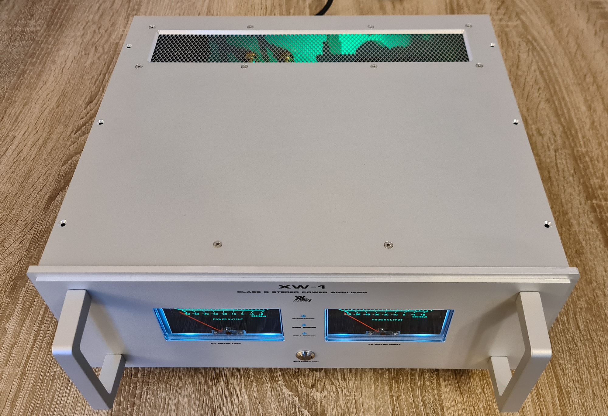

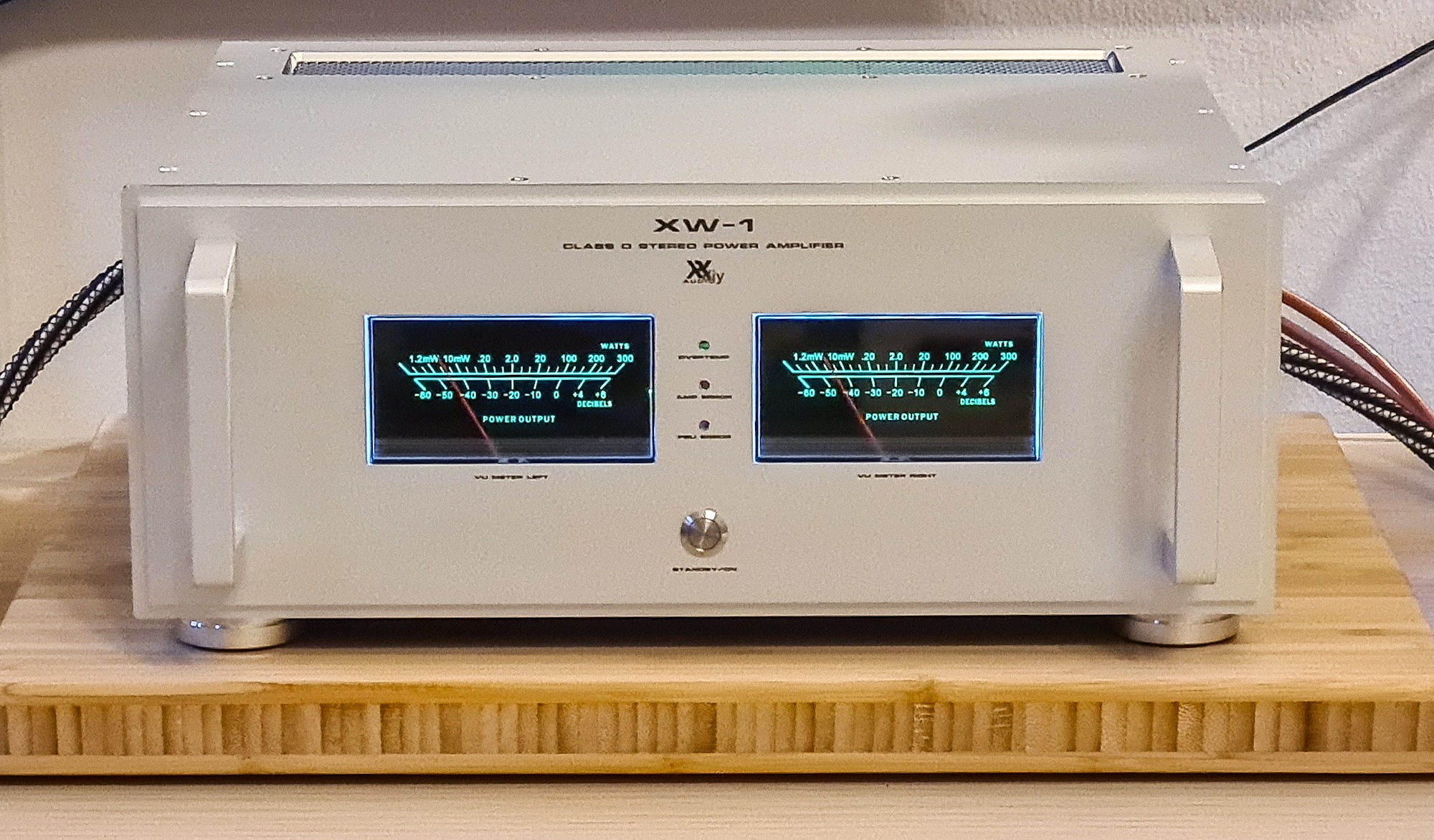

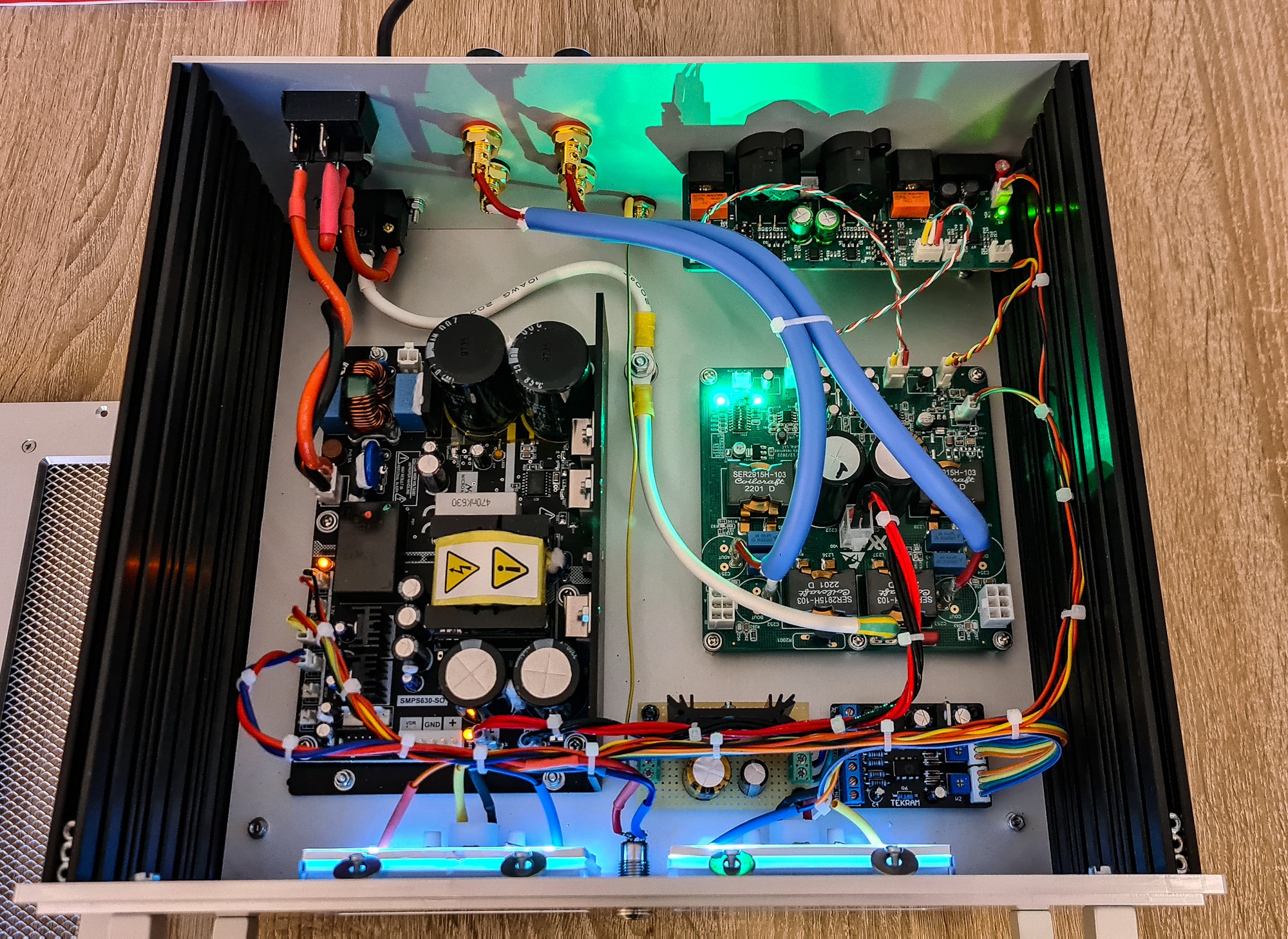

I would like to show you my newborn XW-1 amp 😀
X stands for X - thank you for making this amp possible to build, W stands for Warp as a little indication of the lineage 🙂 🖖
I wanted to go "a lot in" even if not all in, so...
The internal wiring is silver-plated OFC copper, from Elecaudio, with different strengths, for the small signals I used pure OFC copper cable. The blue output cable is a Furutech Alpha-S14 speaker cable with µ-OFC copper alpha treatment. The power connector is a Furutech NFC, the fuse is a Synergistic Research Purple. The speaker terminals are Viborg BP604(G).
I've always wanted an amp with a retro VU meter - now I've made it happen, using two TEK indicators including a driver board. The chassis started life as a Modushop Galaxy, in the end only the base plate and side plates remained. An 8 mm aluminum plate was mounted on the base plate, which serves as a heat sink for the amp board and also the MicroAudio SMPS. As always, I ordered the two piece front panel, back panel and cover panel from Schaeffer AG in Germany, and I created the design with their front panel designer.
Well, there he is.

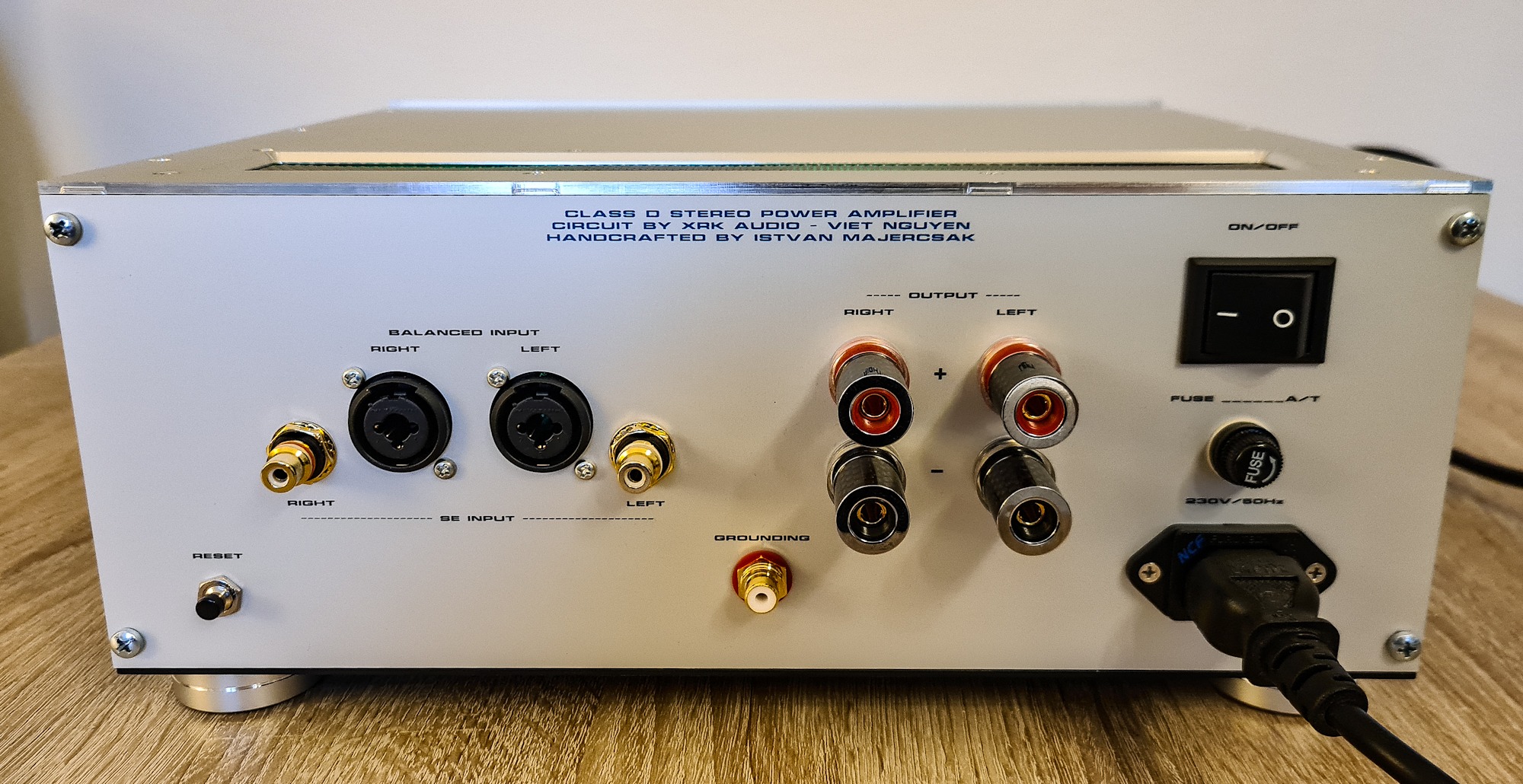

Looks fantastic, I was not expecting that! I typically use silicone 12awg/4.0mm2 wire in my amps, never thought about using some furutech I may have to try it. I use Furtech FS-a36 speaker cable on my main system, and all my interconnects are FA-aS22, I love their cables. I tried to follow your wiring but got lost in the twists, where are the VU meters getting signal from? What's the grounding jack on the back connecting to internally? I would have assumed the main grounding bolt but it looks like you terminated it elsewhere.

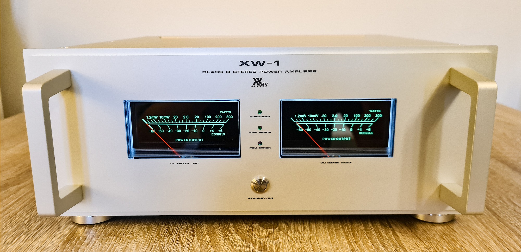

Huhh... the listening test started with a scare, there was a distinct beep... fortunately I quickly determined that it was caused by the Korg B1 preamp, for whatever reason. Switched to the Iron Pumpkin, the amp is incredibly silent, wow, I hadn't experienced anything like that with any other amp.How does he sound?
The sound... although the amp is new and the whole system is cold, the first thing that strikes me is the incredible detailing. No, the amp is not analytical, it just represents everything that the recording contains. He doesn't add anything either, although I'm now hearing/discovering details that I was previously unaware of - especially with acoustic instruments.
The second thing I notice is the bass richness, very deep but at the same time very controlled and not bloated - it gives me goosebumps, which is a good sign. The amp is very fast, impulses, transients - as far as I can tell - are reproduced extremely quickly and accurately.
The mids are beautifully open and present without being overdone or fatiguing. Allan Taylor is standing in front of me, the vocals are clear and not lost in the music like I've sometimes experienced.
The highs are crystal clear and become clearer with increasing playing time (= temperature), age, etc. of the amp. They are very nicely defined, great. Not a trace of exaggeration, overemphasis, they are never tiring or harsh.
The stage is wide, deep and high, I'm thrilled.
The overall sound character is on the more neutral or natural side, the amp does not offer warmth or sugar sweetness, but does not lack them at all. If you still need warmth, you should operate the amp with the tube preamp 🙂 (kit available soon 😀). I was able to listen to a top-of-the-line system on Tuesday with friends (with Spectral monos for 65,000 dollars with M.I.T. cable for 45,000, Wilson Audio... and so on) and the behavior of the amp reminds me a little of what I heard there, as far as the neutral and incredibly pleasant music-making is concerned.
Comparison with Class A? Tedious, it's more a matter of taste. I like Class A, but when listening to this Class D amp I don't miss anything. And that speaks for this amp.
Overall - great! I'm going to try different preamps and speakers now - if that's not fun!

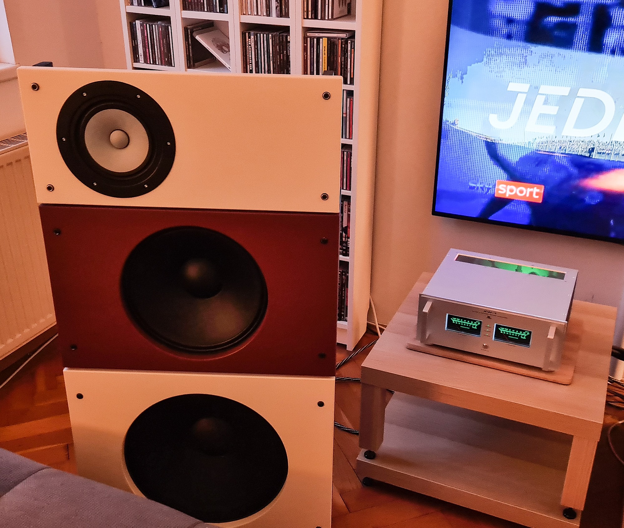

Here a picture with my self-developed open baffle 🙂

The VU meters driver will get the signal from the speaker terminals (but it's also possible to feed it with low signals) - they are not connected yet, I wanted to try the amp first 🙂
The grounding jack is connected to the PSU's gnd, which is the common gnd of the whole amp. Externally it is connected to a Synergistic Research grounding block.
Thank you for the kind words, Istvan. Your open baffle speakers look superb - nicely done. I’m sure the sound is amazing and glad that the XW-1 delivers the goods.
The quietness of this amp is something I worked very hard to achieve, and as you say, there isn’t another amp I have heard that’s as quiet with no music playing.
The noise floor FFT shows about -125dB = silence.
Many thanks, glad you like the speaker 🙂

The XW took his central place on my system and now the VU meters are working too 😀
I'm sitting here since hours and can't stop listening to this amp😀
It's such a relaxed listen, yet full of emotion, great. The amp is evolving but still in the burn in phase, still so good.
