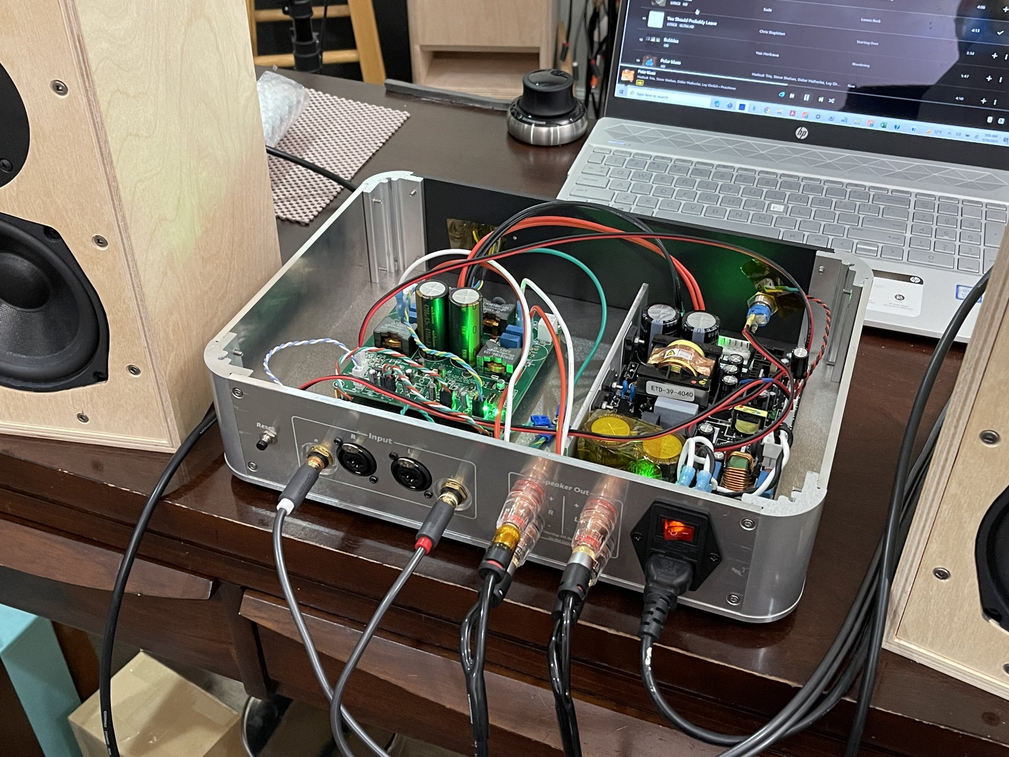

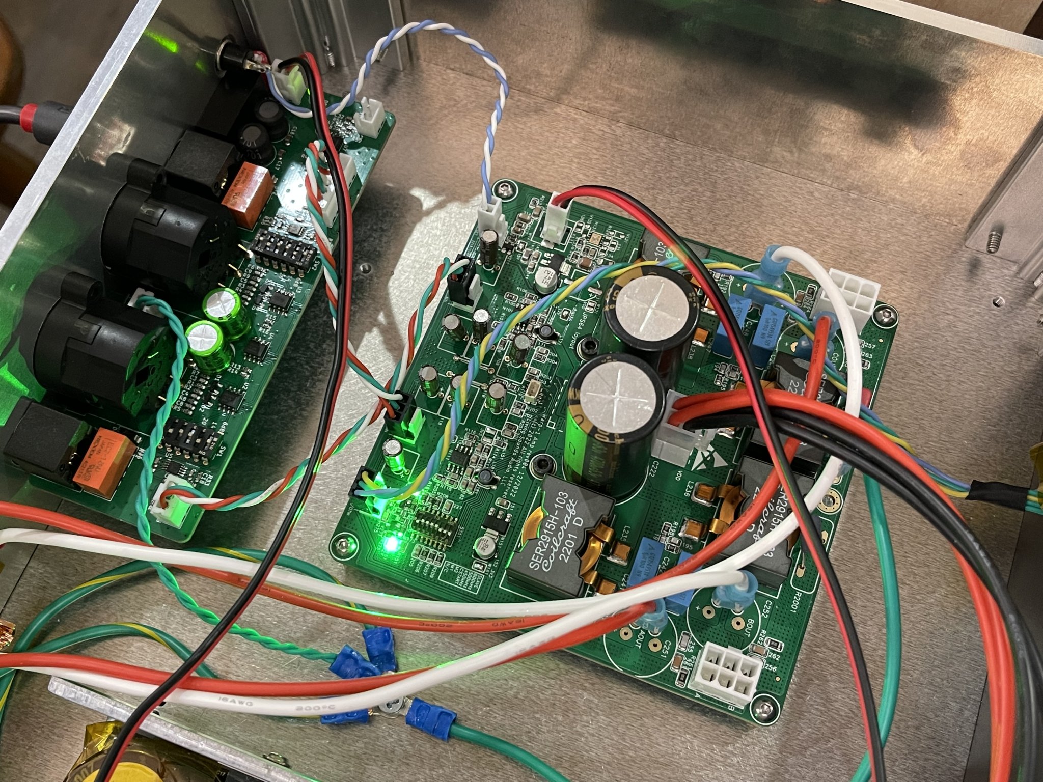

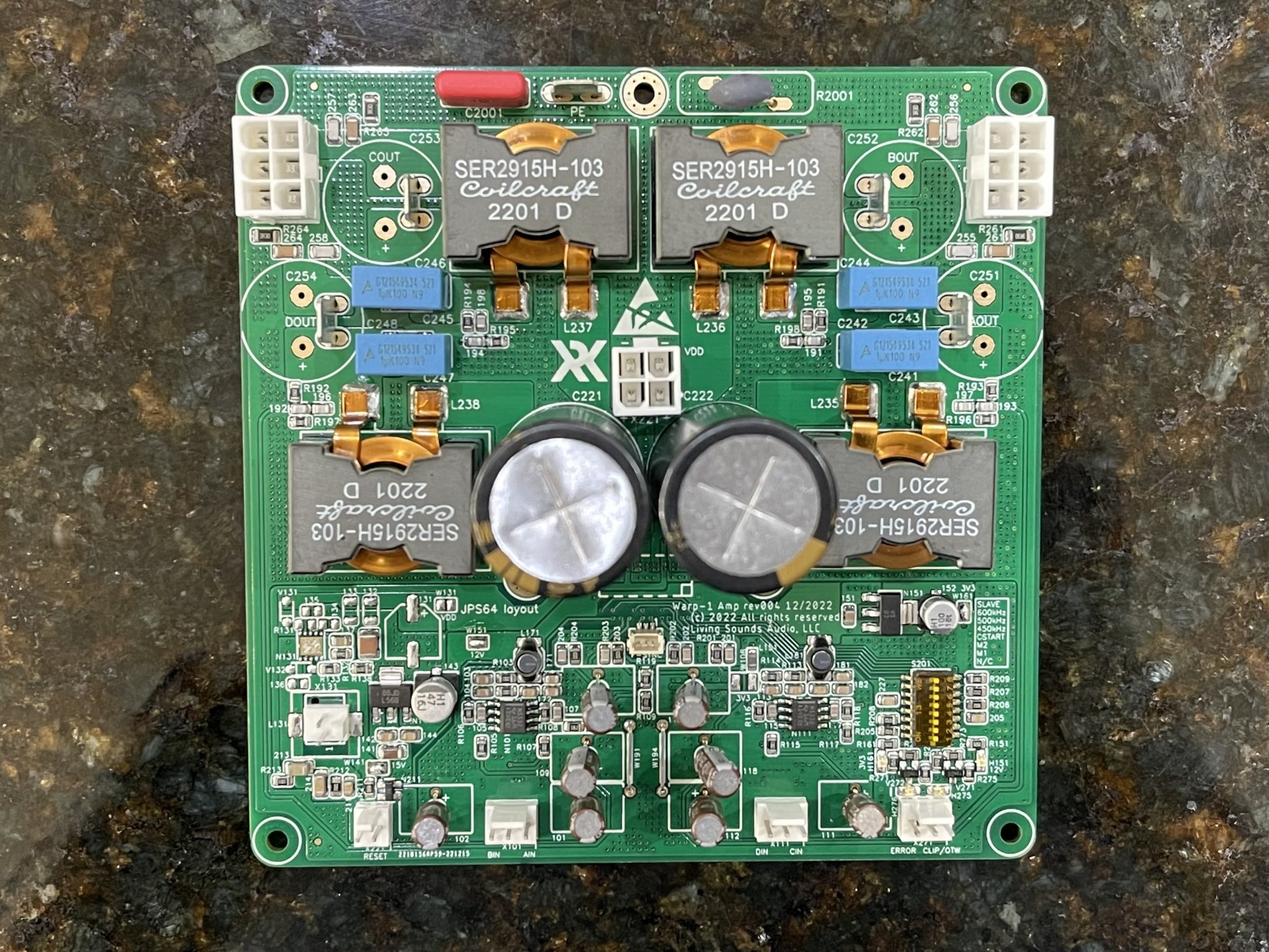

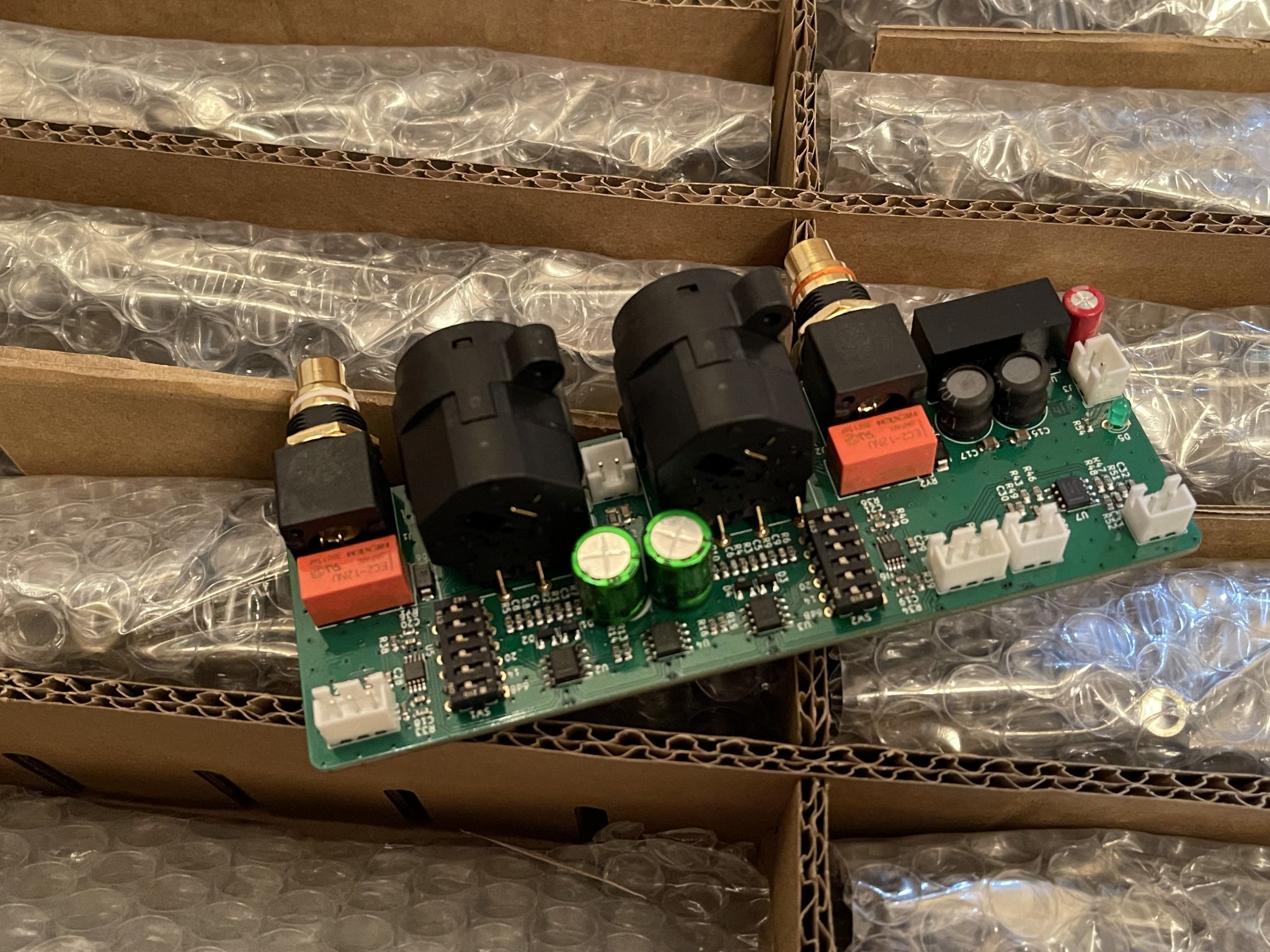

Here are the new boards:
You might consider getting the BTSB Buffer to go with it. Provides SE or Bal input and selectable gains. Uses top of the line OPA1656 opamp and OPA1637 balanced line drivers. All top quality components.

Hi X...1) are the cases used for Warp 1 available for purchase? and 2) I notice you didn't use any extra caps between the SMPS630-SO and the 3255. It's still advisable to do so to to avoid buss pumping, correct?
My apologies for posting my other questions in the other GB forum
Pete
Founder of XSA-Labs
Joined 2012
I didn’t see the need for extra caps given the two 4700uF ones on the amp already plus the two pretty big ones on the SMPS630SO output. I never had an issue with bus pumping.
Cases available? You mean like Warp-1 chassis?
Unfortunately, those are only available for LSA Warp-1. If you look at the costs of the amp, SMPS, the BTSB buffer, chassis, connectors and hardware, you will see it is less expensive to buy the Warp-1 premade.

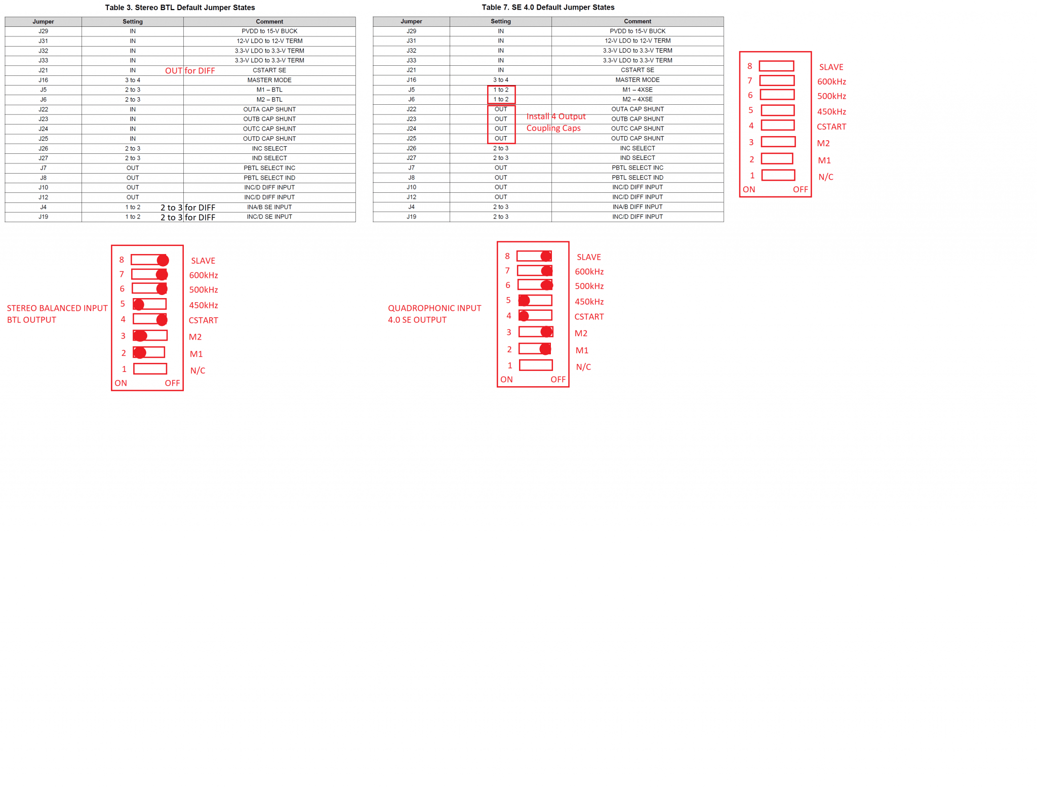

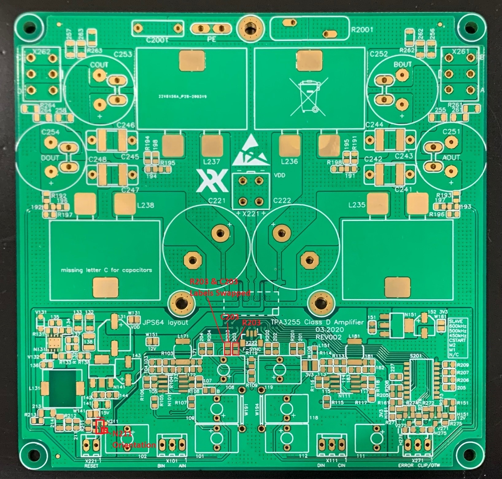

Here is a diagram showing how to setup the DIP switches in case you want a different mode of operation. Note that Cstart can work in either position for stereo BTL. For 4 Ch SE output you need to install DC blocking caps where the Faston output tabs are located.

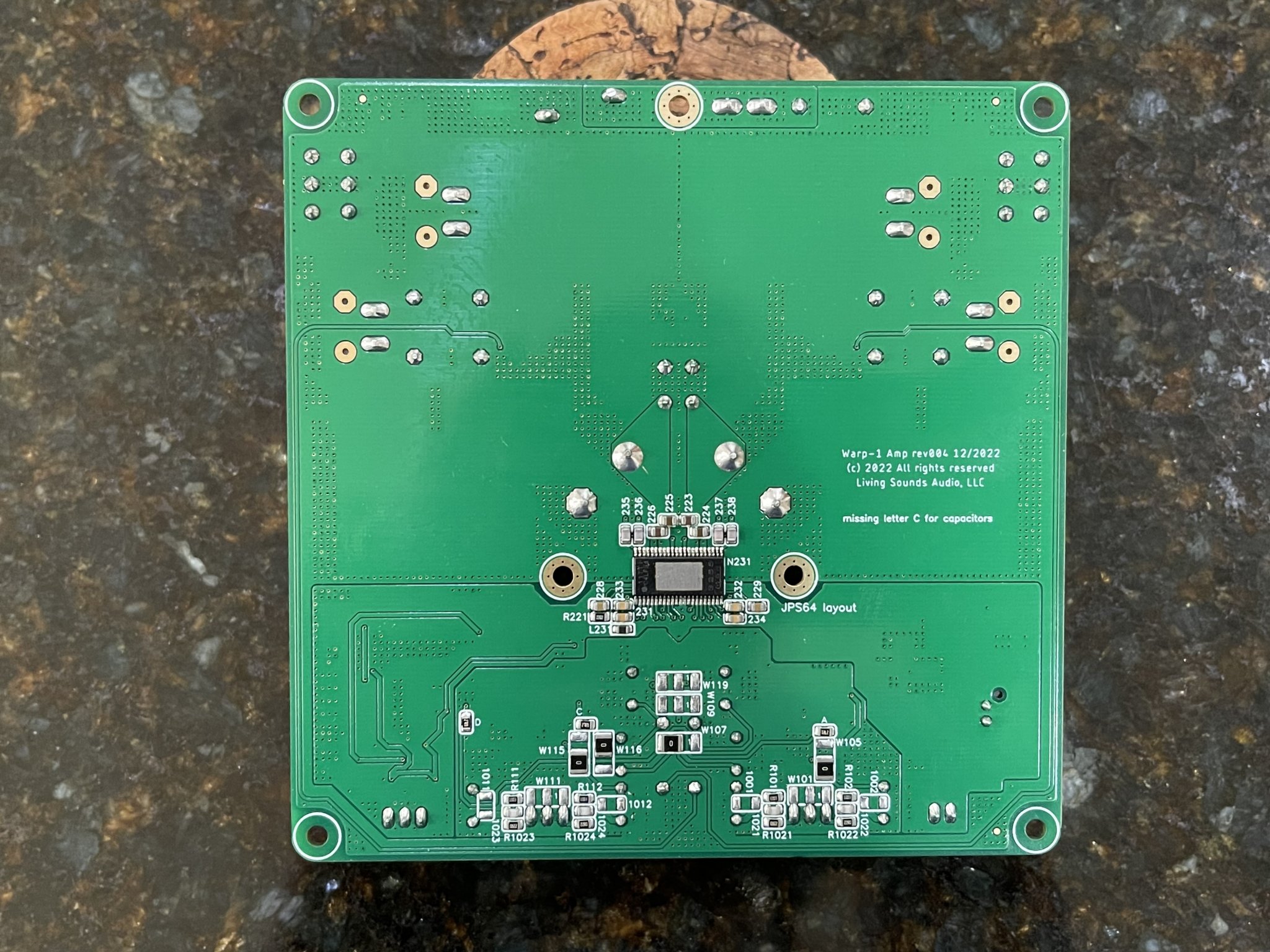

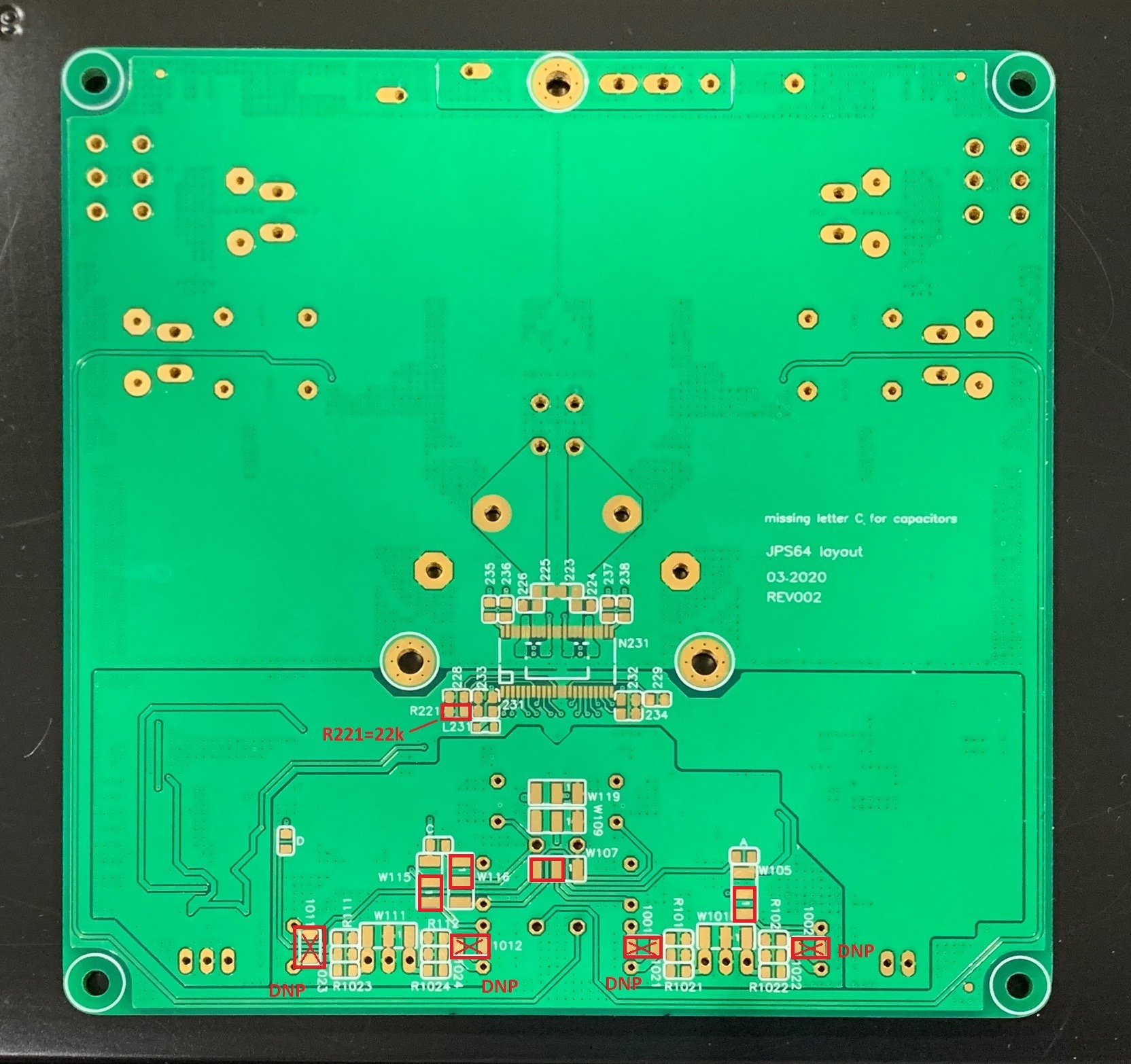

Here is a photo showing how to setup jumper resistors on the bottom and the small silkscreen error swap for R and C on the top side for those assembling the boards themselves:
