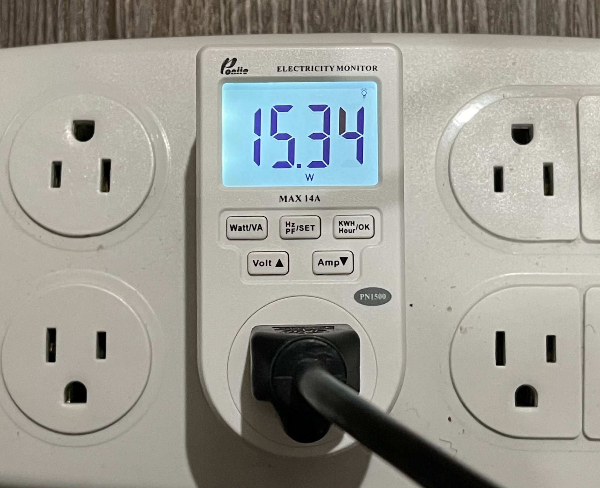

You all did an excellent job. It is late evening over here (well, actually early morning) and I am listening to Radio Paradise's mellow mix. It sounds outstanding. I really like the amp. A friend of mine ordered the amp as well and got it on Monday. He enjoys it very much as well, already, cold out of the box. He is testing it to maybe replace his tube amplifier.That’s wonderful to hear that you love the amp. Thanks for the kind words and the credit belongs to the whole team: JP, Jan, Darko, Sami, and Mark.
Two questions though:
1. I keep the Warp 1 on 24/7. I assume this should not cause any problems?
2. Did you measure the idle power usage? I can't find it anywhere in the specifications.
BR,
Richard
Excellent, thanks!I measured 140mA AC current at 120VAC or 17W quiescent power consumption. Bottom chassis panel where all heat transfer occurs is 28C in 20C ambient room.
This multiplication gives the apparent power, not the true rms power. Which will be about half that value.I measured 140mA AC current at 120VAC or 17W quiescent power consumption. Bottom chassis panel where all heat transfer occurs is 28C in 20C ambient room.
I think if rms voltage is used, power is simply Vrms x current multiplied with no power factor for a purely resistive load. I used a clamp on current probe on one of the AC main wires.
P = I x V
P = I x V
Do you think your smps is a resistive load?I think if rms voltage is used, power is simply Vrms x current multiplied with no power factor for a purely resistive load. I used a clamp on current probe on one of the AC main wires.
P = I x V
Anyway, I suggest using one of these cheapo wall-pluggable energy-meters to get valid numbers of power consumption.
The question of what power factor to use for a SMPS running at idle with three auxiliary outputs (+12, +/-15v) and the main output at 51v is sort of unknown.
Is a cheap wall mount watt-o-meter going to measure real time phase angle of voltage and current and apply corrections automatically?
Yes, nowadays they do, because they use the same chips as are in the smart meters. They old ones did not.The question of what power factor to use for a SMPS running at idle with three auxiliary outputs (+12, +/-15v) and the main output at 51v is sort of unknown.
I bought a digital wall plug power meter and this amp uses 3W in standby and 15.3W amp on at idle with no music playing. The clamp on current meter P=IV was close.
Resolution of 10mW - very nice!I bought a digital wall plug power meter and this amp uses 3W in standby and 15.3W amp on at idle with no music playing. The clamp on current meter P=IV was close.
