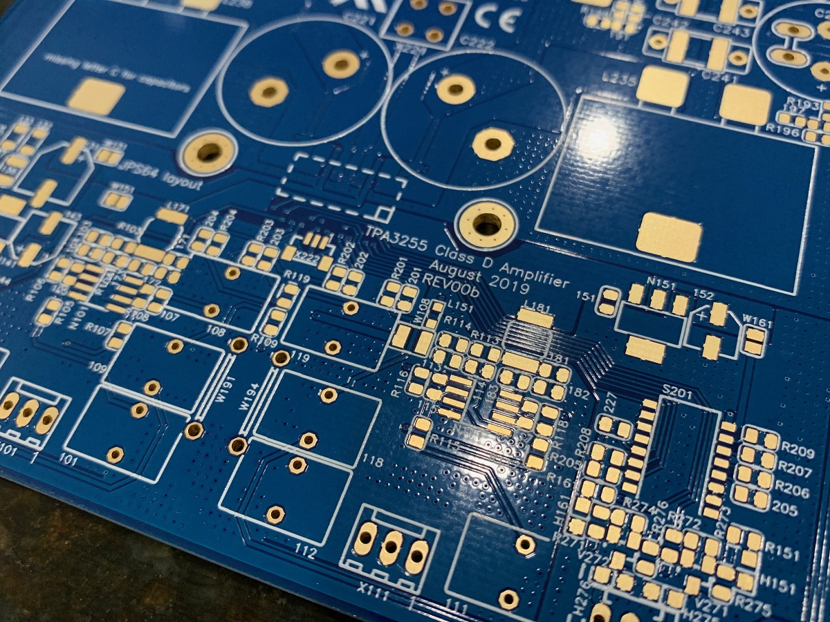

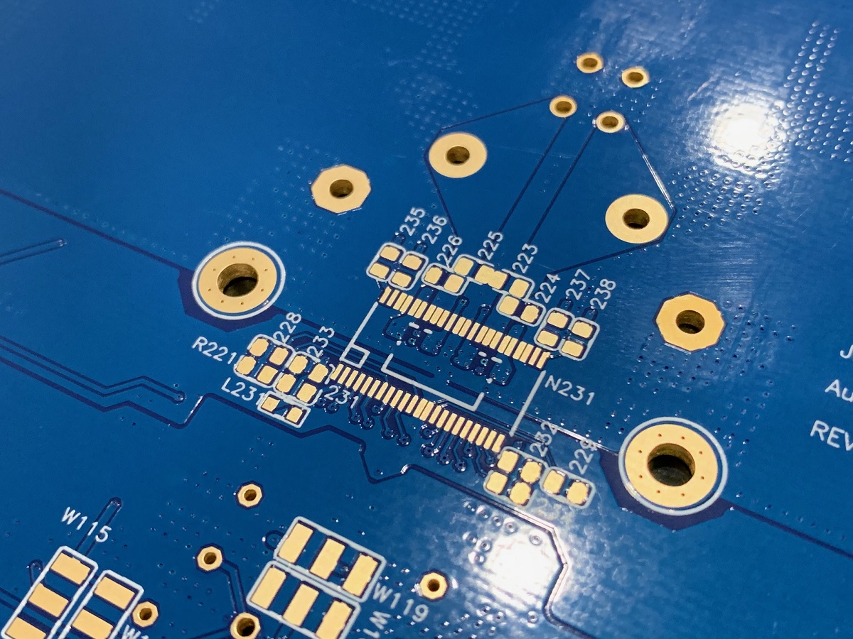

Assuming the beginner practices solder paste and hot air / hot plate soldering technique on test board first and can successfully solder 0603 parts and larger electrolytic SMT caps, maybe 4-6 hours. The self “training” on test boards is probably 2-3hrs.
You need a $40 hot air SMT rework tool. A $10 skillet, a $10 dorm room hot plate, $15 IR thermometer, $15 syringe of solder paste, $20 SMT tweezers, $10 magnifying flip up goggles, liquid flux $10, solder braid $3, and regular soldering iron. Those are the bare minimum tools and supplies needed to solder this yourself.

Hmm, soldering big inductors on 2mm 2oz. copper pcb might be a challenge with just using a hot air gun. You'd probably need to preheat the pcb as well. (Or solder them with an iron and leave out the mounting tab)

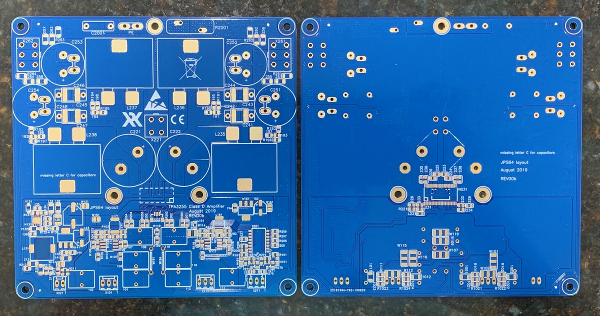

Btw. You have Conformité Européenne documents available, as indicated by "CE" on the PCB?

The large parts like inductors and electrolytics need a hot plate preheat from bottom and hot air from the top.

The CE label is just that, a label on the PCB. For the device to be CE certified for commercial sales, it has to go through CE testing of course.

CE is a self certification, you need to be able to provide a document that details how the product complies with relevant CE sections if challenged. The easiest way to do this would be to use a 3rd party company to do the testing and provide an analysis document, however, this isn't strictly necessary and if you can prove it was designed to comply with CE, this is enough.
Pretty sure the only relevant one for a PCB (particularly a bare PCB) that doesn't deal with AC is RoHS anyway.

For now, I can only offer a bare PCB. Price will be $37ea and pre-orders will be taken once we verify the circuit works. It’s not a bad project to learn SMT soldering skills on. Watch some YouTube videos on solder paste hot skillet and hot air soldering. Use skillet on bottom to preheat board to 130C. Apply hot air from above to region of interest to liquify the paste and effect the solder. Work section by section. The 130C heat from bottom won’t hurt the parts and you do the TPA last as it is on the bottom side. It has to be done with just hot air (or traditional solder iron) as the top side will already have been populated.

Nice to see you take a trip 'back' to where the hobby seem to have started. Groundplane looks much better to me in later design, I would however make the point connecting power and analog\input ground inside tpachip only, remove all connections on pcb. Multiple 'stars' do not function reference-like I think, although doctorm could probably tell you how it will show in measurements exactly.
