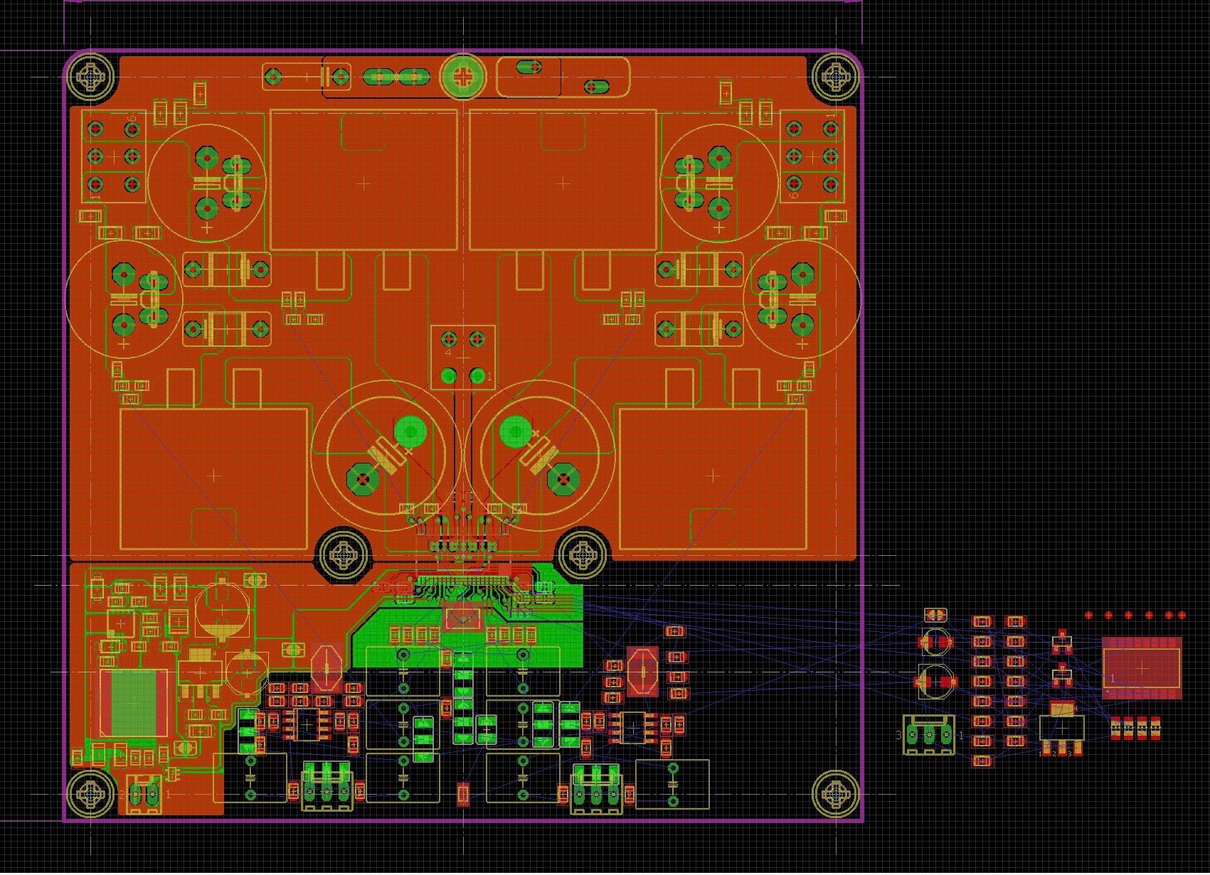

These boards have yet to be ordered or built, however, I have tried several boards - the the relatively-cheap $55 ones that are knock-offs of the TI evaluation boards on ebay and and Amazon (same ones apparently). The knockoff TI eval boards don't seem to work properly as the error/fault LEDs are lit upon startup (rather than lighting when there is a fault). I also tried to see what maximum output was and with a +52v 600w PSU feeding it, it could not put out anymore than 48Vpp - almost like it self-limited and resulting output started clipping. The knock-off boards also seem to be set up just for SE input and BTL output. It was my hope that we can have a general purpose board with all the features and options available and with a good layout and conveniences of locking connectors and thermal pad facing the mounting surface. The post filter feedback option is something we are looking into - it might not be possible to add without a major revision to the existing layout.
These are 2mm thick, 2oz boards with ENIG finish, hence the $32 price for just the bare PCB. If you want a professionally built PCB tested and ready to go, that will require substantial interest. Sorry about higher component prices in EU. You may look at Arrow, their shipping costs are very reasonable (not free anymore).
There is no way that you are going to beat the prices of the $55 Chinese-made TI knock-off boards with your DIY version (I think we all know that). This is an excercise to get the best performance and higher convenience and reliability. I would be using the cheap ones too if they did what I needed (I need 150w into 8ohms in BTL as an option on 1 board and I need a clean ~80w into 8ohms in SE output mode for 4 channels on another board).

JPS64 says he is adding the PFFB but it’s going to take a total redesign of the layout. Should have it by tomorrow.
PFFB and the ability to swap opamps would certainly make this board stand out. Otherwise, not sure it would be worth the effort vs a 3e-Audio board.

JPS64 is making progress. Note wide low impedance Vdd path from power input connector to the pins on the chip. Also relocating inductors for less crosstalk.
