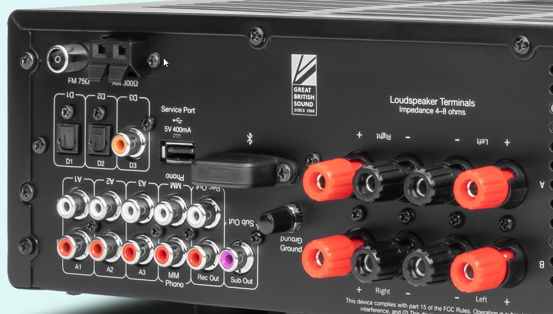

Awesome redjr, I really like the marking upside down. I’m not sure but I think it’s the first time I see that, clever!

Regarding the upside down labeling... Actually I first saw this on a Cambridge Audio piece of kit (see picture), and thought it was a neat idea. I've since seen it on the top labels, as well as bottom. I chose the bottom. The theory is.... we often find ourselves looking at the back of equipment from the front with our head upside down!
I had a similar experience, Aragon equipment does the same on their rear panels. I didn’t get it....until the first time I looked over the top with my head upside down

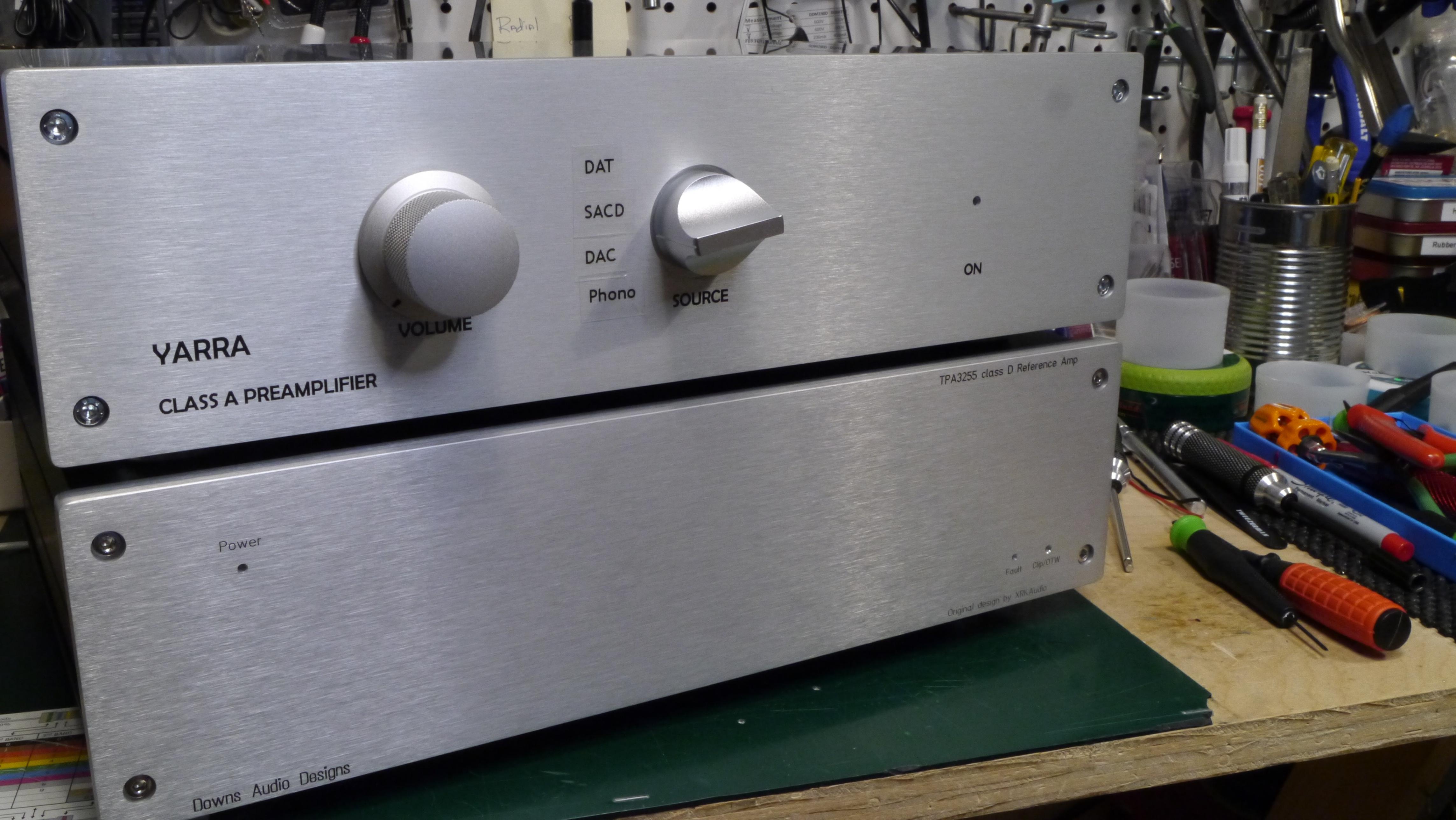

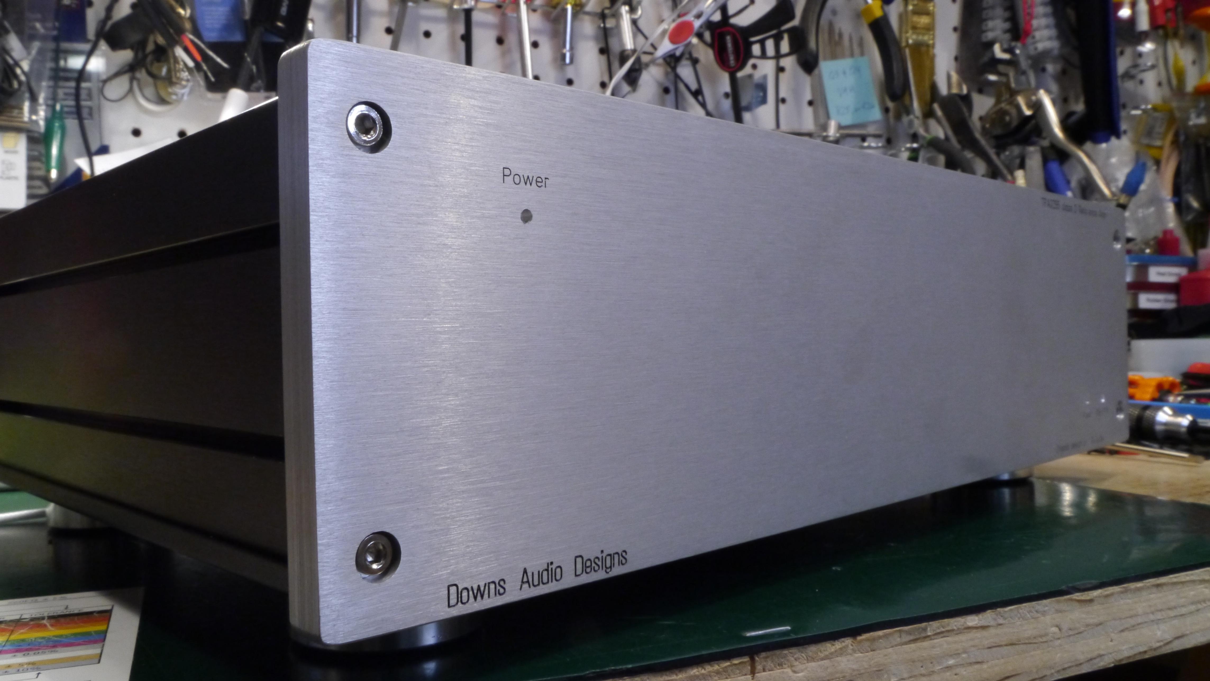

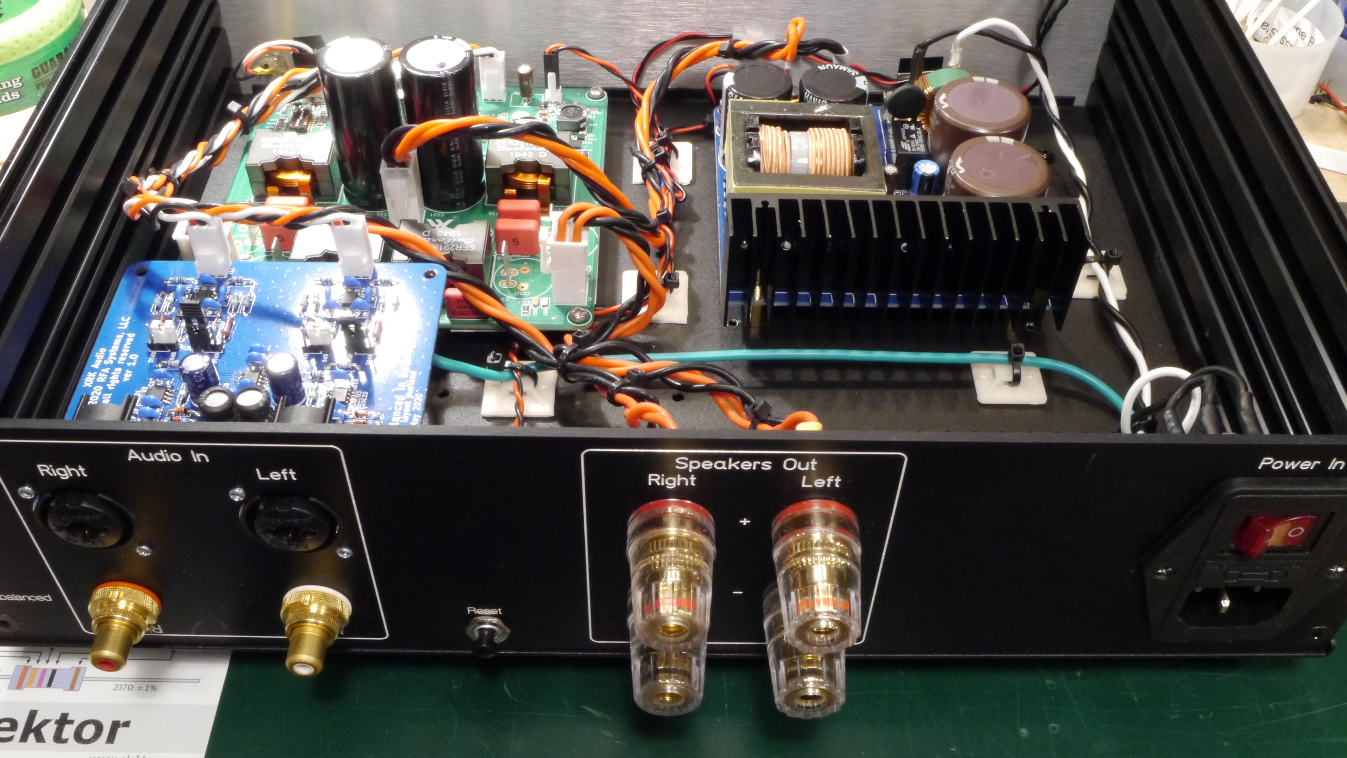

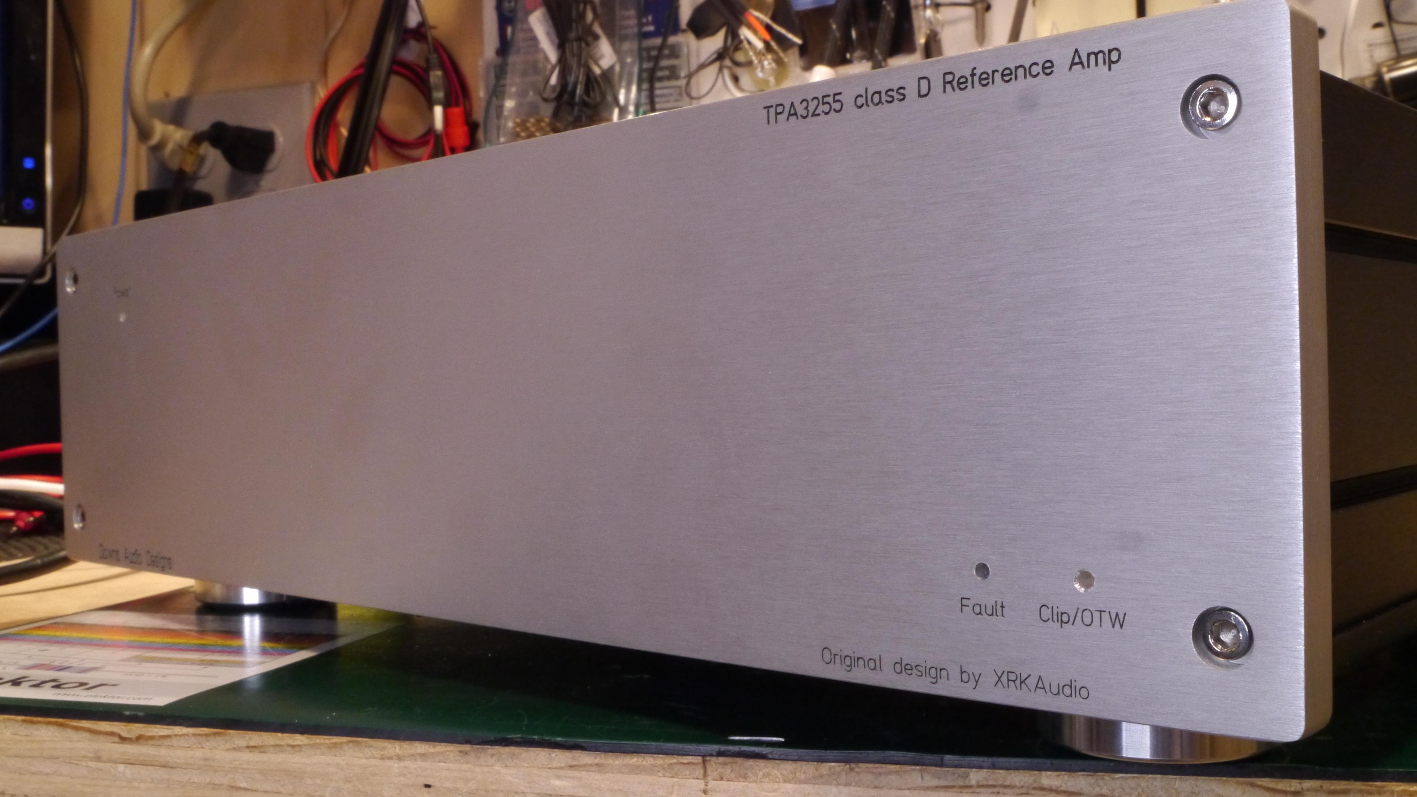

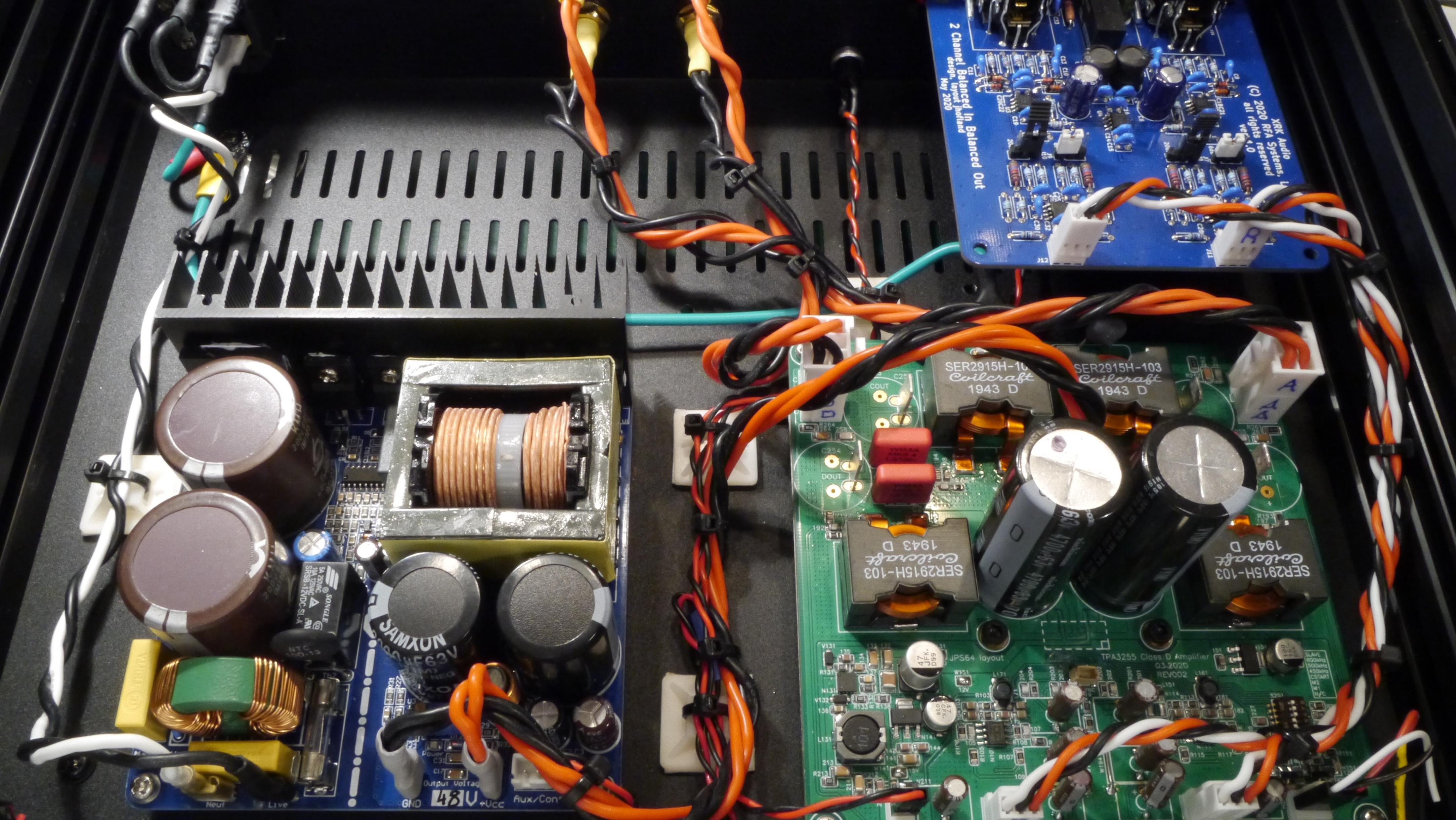

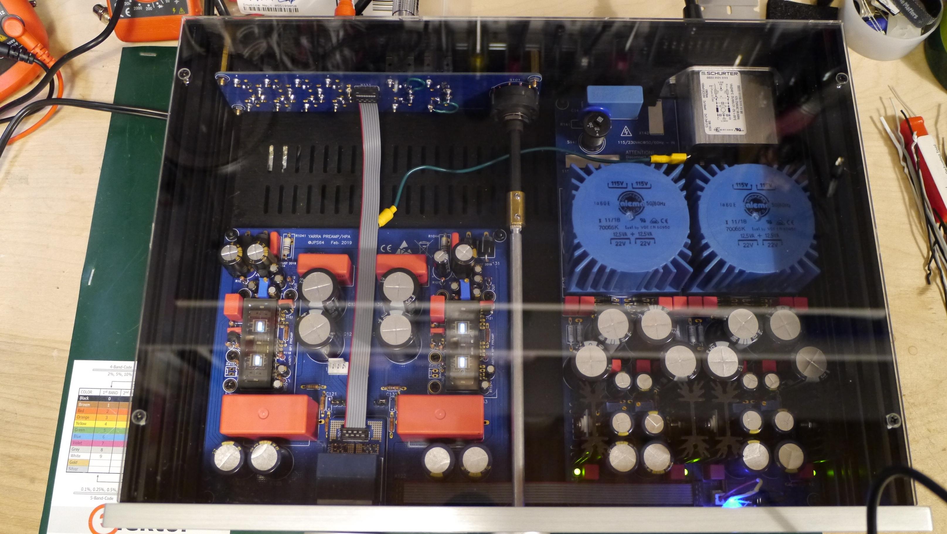

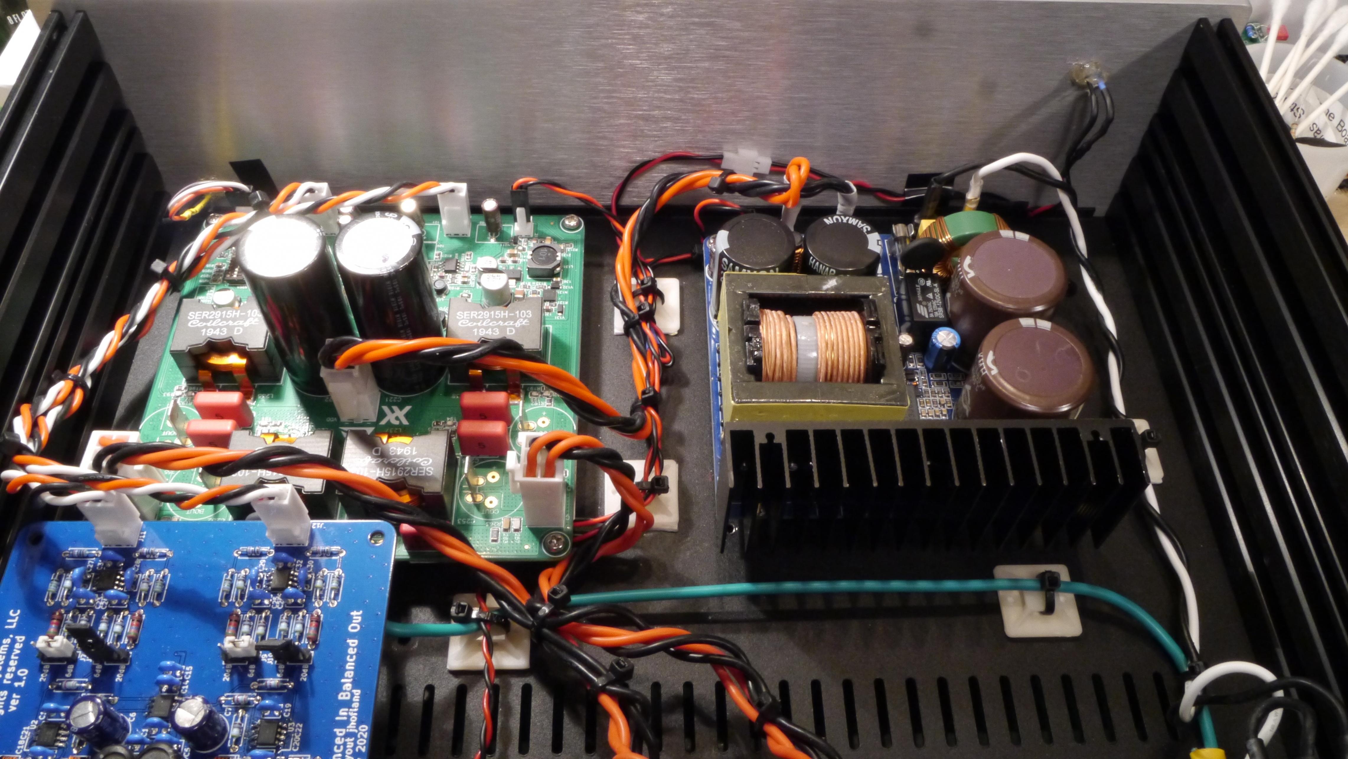

Final TPA3255 Reveal
I finally finished the X masterpiece, class D amp TPA3255. I have to say upfront, the noise floor on this thing is phenomenal. It is ultra quiet! I immediately paired it with my Yarra pre, with the installed Korg, Nutube 6P1 'tubes'. The sound simply blew me away. The dynamics, articulation and presence of every note across the spectrum was obvious. It was like having HDR for my ears! The combination of the Yarra and the 3255 brought my Elac Uni-Fi, UB5 speakers to a new level of performance. Can you tell I'm pleased? Even my son thought it sounded great, and said, "so does this mean you going to get rid of your Parasound amp?" And, I haven't even tried the full chain of balanced cables using my Doug Self pre yet either! I think there's still more goodness to come.
Below are a few more pictures of the amp and the 'impressive duo'. In the Yarra case, I had to use stick-on tape for my selection labels. The last image is an inside view of the Yarra with the Nutube 6P1 on.
Thanks to X and his design team for bringing such fun and well-executed audio projects to the DIY community. They are a pleasure to build, and with the help of others on the forum, make it an exciting place to experiment and learn. In the end, we are left with a very nice piece of kit that's a pleasure to listen to and use. And will bring a level of accuracy for years to come to the music we all love to listen to.
Back to more listening....

Wow, the perfect pair!! Very neat looking inside out. A real new school system: smps/class D/nutube. I must say I’m a bit jealous, I would love to have a Nutube preamp. Is it like the diy audio store Korg B1 nutube preamp with the feature that let you decide the amount of 2nd harmonics you want to mix in, a kind of a dry/wet nob for effects on a guitar amp.

Thanks for the kinds words everyone.

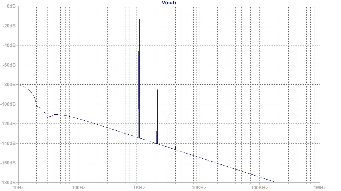

The relative H2/H3 is somewhat adjustable. However, the lowest overall THD and balance of H2/H3 puts it at about 0.024% THD for a certain recommended grid voltage of 12.0v. More info here:

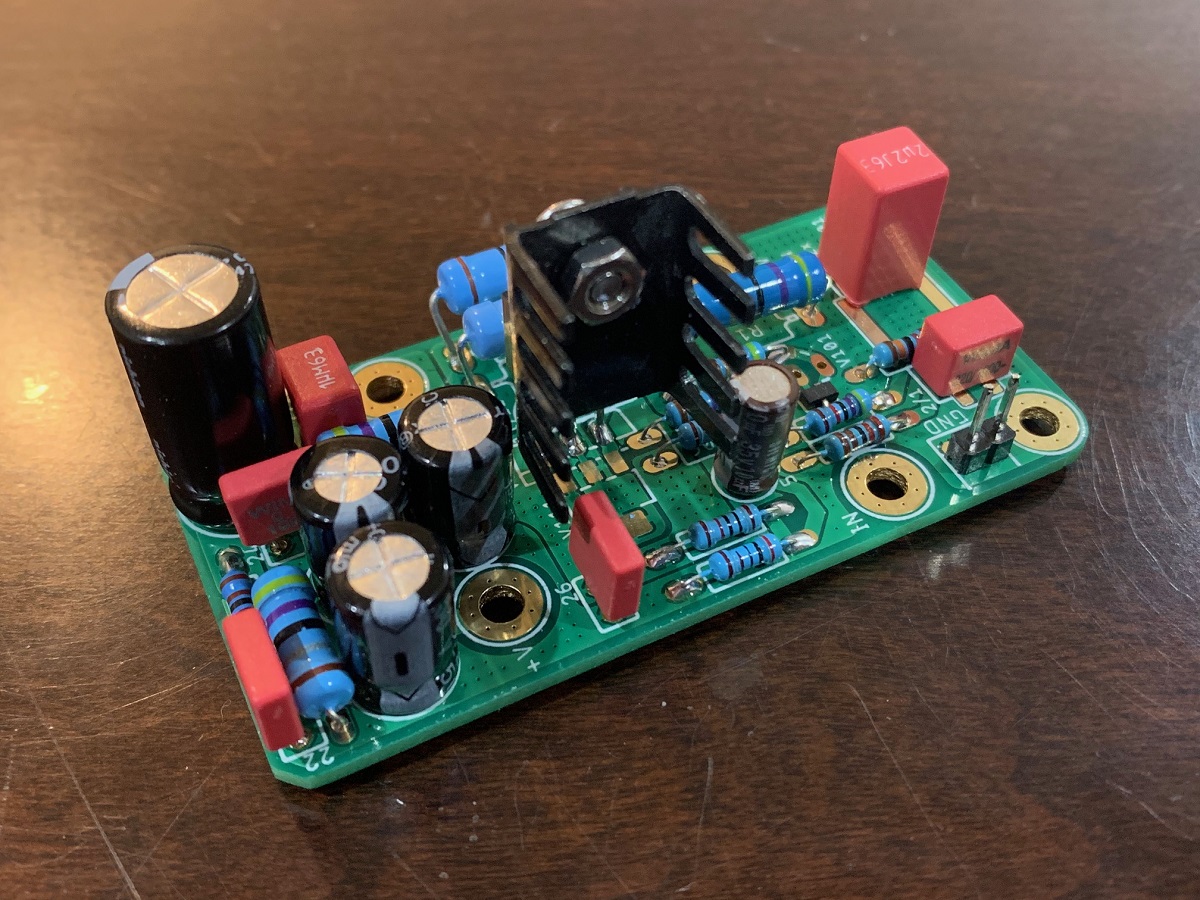

My personal choice would be to use a Hakuin or PCA daughterboard for the Yarra to do the same thing as they are even quieter than the Korg and more robust and less expensive.
Here is the Hakuin - one of the finest preamp modules I have heard.
Your choice of 2sk170 or 2sk209 (or even BF862):
Predicted 1Vpp into 250ohms:
