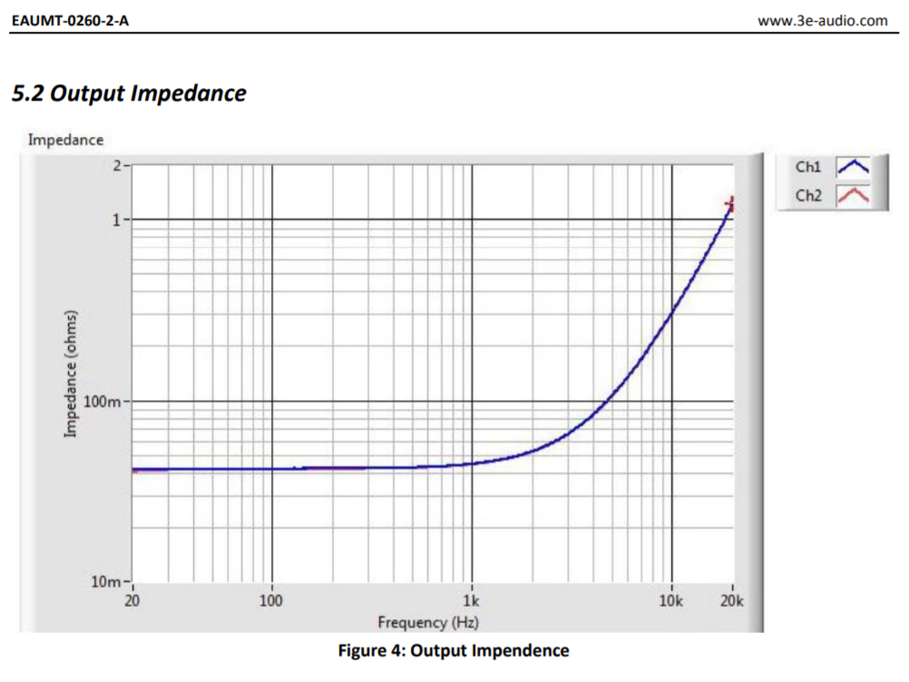

This is the output impedance graph for the 3e amp. Is that typical for all TPA3255 amps, or else asked in another way: what is the output impedance of the reference amp across the frequency spectrum?
Sorry, I never measured this - it is a lot of work to do that and I don’t think it will be different. It’s an intrinsic function of The TPA3255 and the output inductor. I use a much lower impedance high current inductor with rectangular copper wire (SER2918-103) which has 2.6mohm DCR. But ultimately, it may be limited by the IC.
The 3e measures 42mohm at bass frequencies, where this matters. That’s quite low. Maybe I can do a measurement at one point, say 100Hz and that will give representative figure.
I found a full suite of measurements of TI's TPA3255 EVM on the QuantAsylum forum including another graph of the output impedance that confirms the 3e-audio graph.
