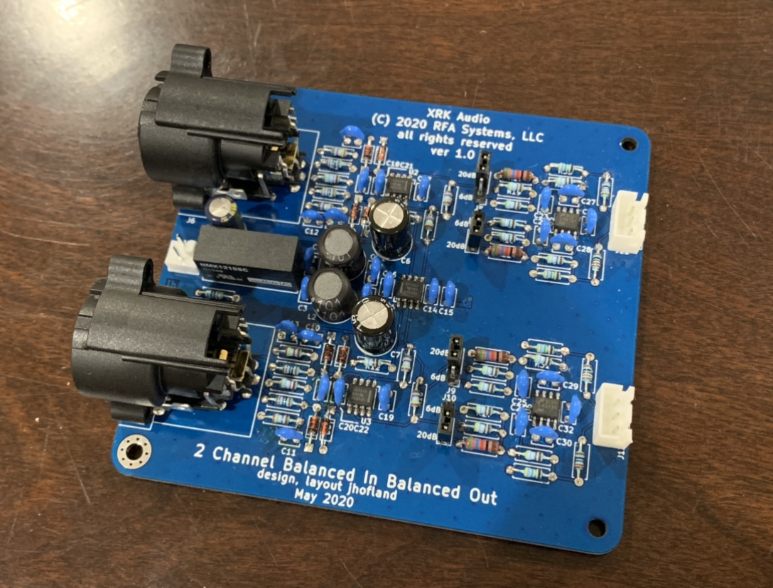

I just got the revised design for the verification build BTSB Buffer today. Will order boards now. However, if you are interested in the prototype version I can get you that. It has a pad error on XLR jack. Doesn’t fit perfectly. But if not using it then it’s fine.
Thanks X. I am going to use the onboard XLRs. How bad is the misalignment? Is it the mounting pins or the signal pins?
You have to bend the larger pins by 1mm not much. It still works and is quite secure as there are line 8 pins soldered. Both Redjr and I are doing it and ok with it. Just doesn’t look perfect.
As you can see, here is Redjr’s build:
The new board I have actually has SE output in addition to the balanced but the XLR pins are still off.
Ok happy to take an original board then thanks.
Just for clarification... I had to snip 2 of the leads that went to the inner sleeve of the jack - used for the TRS - to get it to seat properly on the PCB. Otherwise, there would have been obvious stress on both the jack and the PCB that I didn't like. Just couldn't bend those 2 pins into place. I have no intention of ever using the 1/4" part of this combi-XLR jack. If I did/use more with 1/4" balanced jacks/plugs, I may have made another decision. My OCB lost this time.Ok happy to take an original board then thanks.

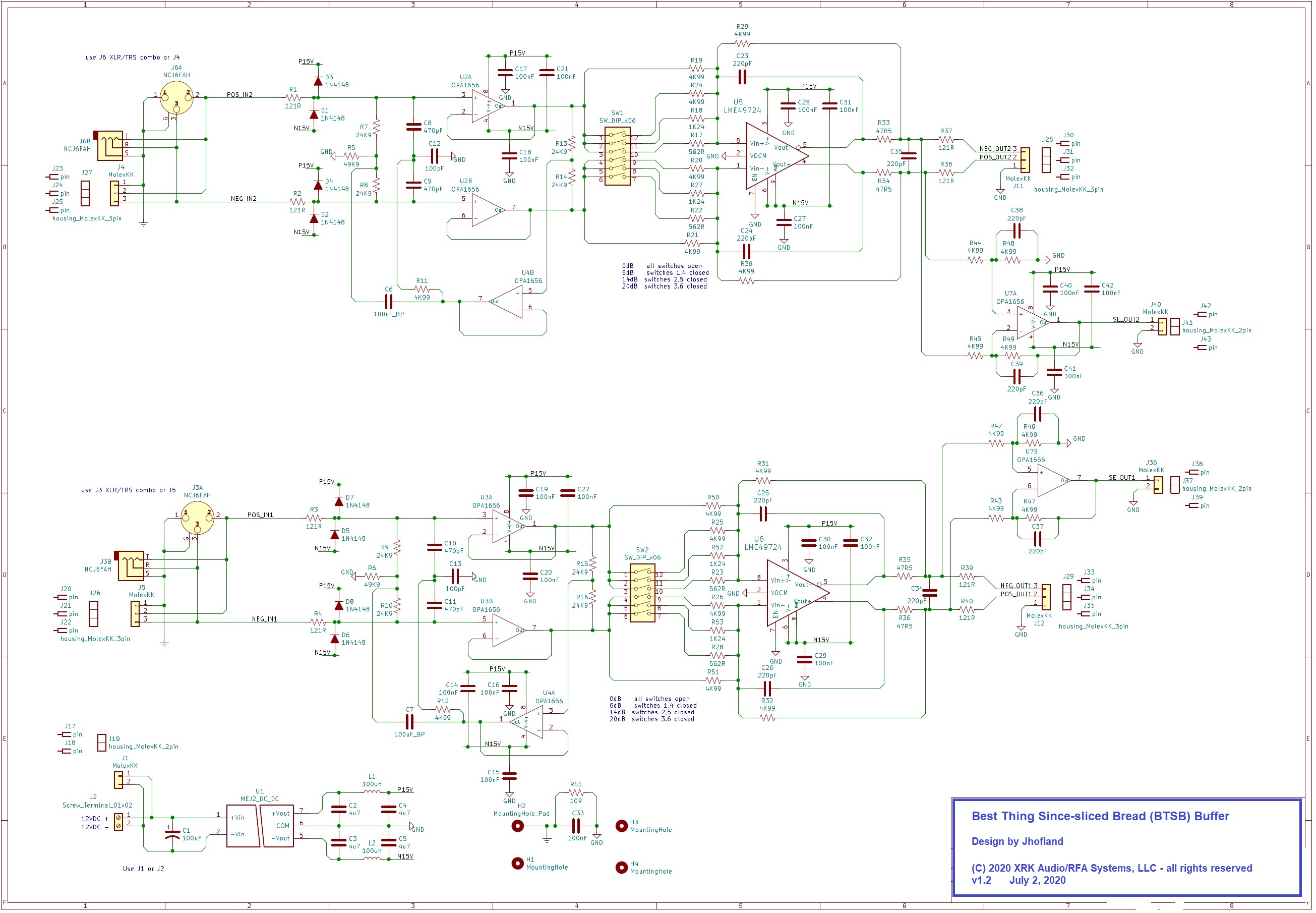

For freq_adj, are the resistors run in parallel? (for example, 500khz would be dip 5 + 6 ON?)
Not frequency adjustment but gain adjustment.
Here is the latest schematic of the BTSB Buffer. The gain resistor DIP switch is in parallel, however, individual ones (4-bits) provide 0dB, 6dB, 14dB, and 20dB. Certain parallel combinations of the above could produce finer scale changes by making the input resistor smaller via parallel equivalent.

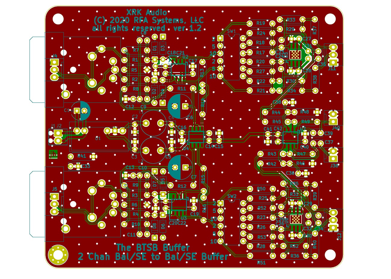

Layout:
