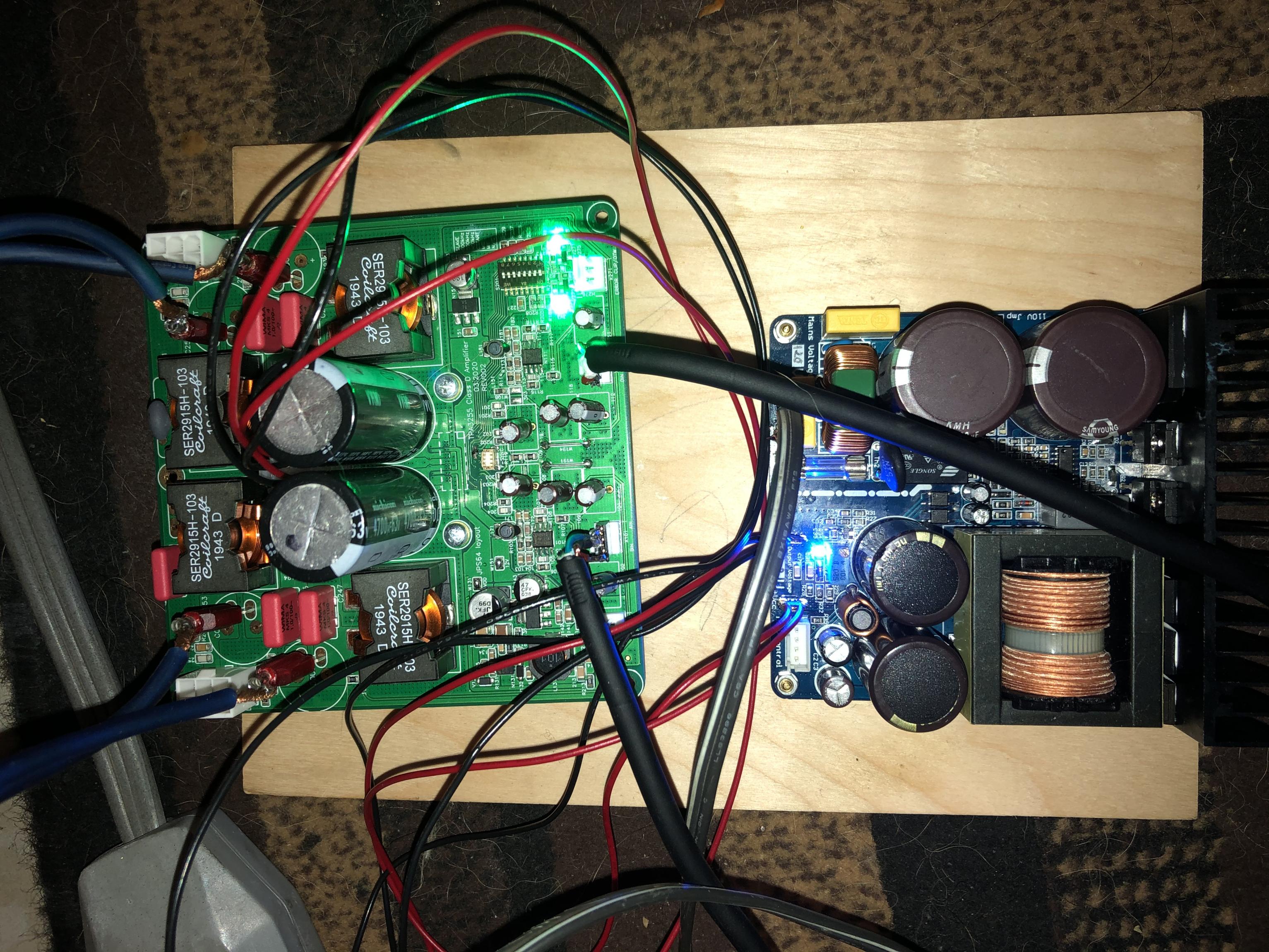

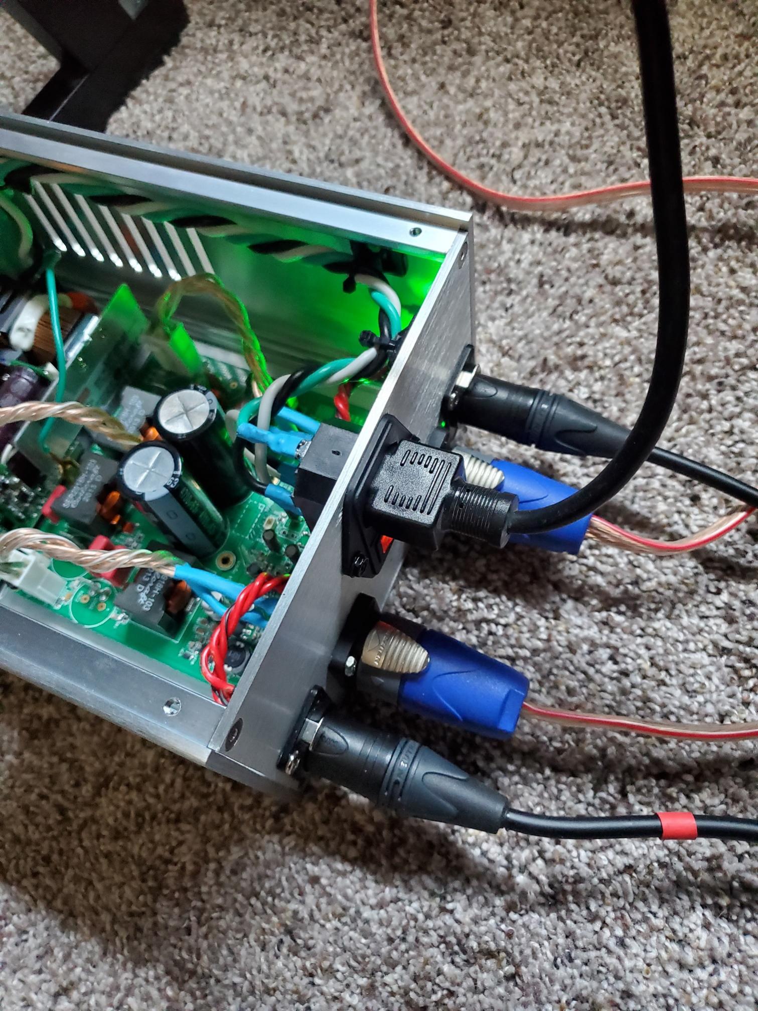

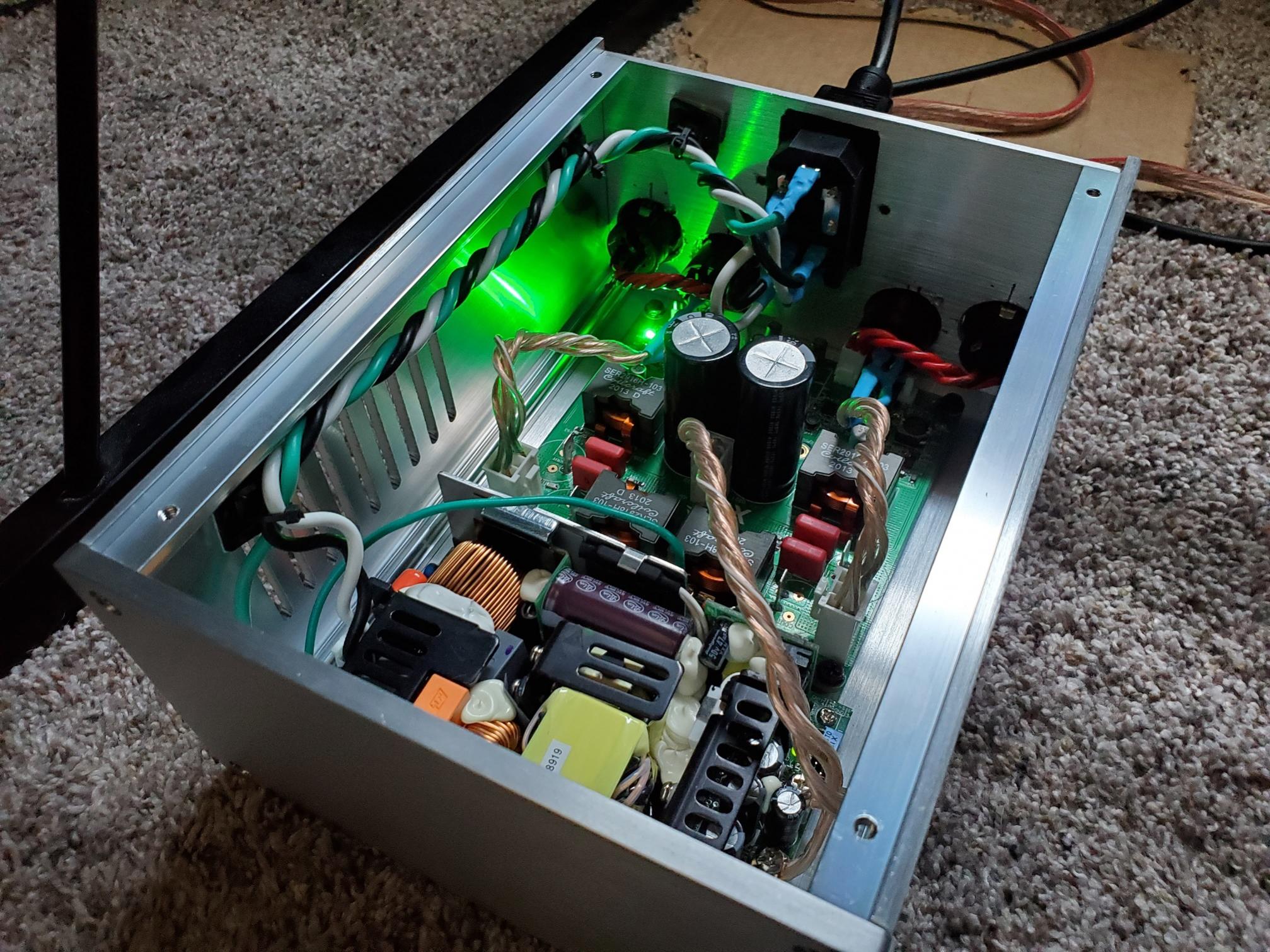

Pretty much done! Just some minor cleanup / finishing touches to do. Definitely like soldering more than finishing a case, heh.
Love the sound! I think my favorite part is how it does kicks / bass. Very punchy clean and deep on my elac dbr 62s. Since they are 6 ohm I'm running 53.5v. It definitely likes the extra juice. I can hear no hiss from my speakers sitting at 3 feet and have to put my ear right up to the tweeter to find the slightest hiss.
Thanks x, jps64 and jhofland!!
I'm just going straight from my topping dx3 pro DAC RCA -> RCA to XLR cable. The ones you see are star quad cables which actually eliminate my PC -> DAC -> amp ground loop. My listening space is very small so I don't really need all that much gain. Might upgrade to a XLR DAC in the future... or there's just enough room for the SMT BTSB board at the rear right wall which I still might do

Very nice, clean build nrabbit. What SMPS is that you're using?
I'm using the meanwell epp-500-54. I have a small / hot listening room I use this in so wasn't too big on power but more efficiency (not that I'm able to push this thing very hard without the BTSB buffer). The total draw of the amp while idle is only 10 watts (7 TPA / 3 SMPS). Even leaving it on all day it's just vaguely warm to the touch.
