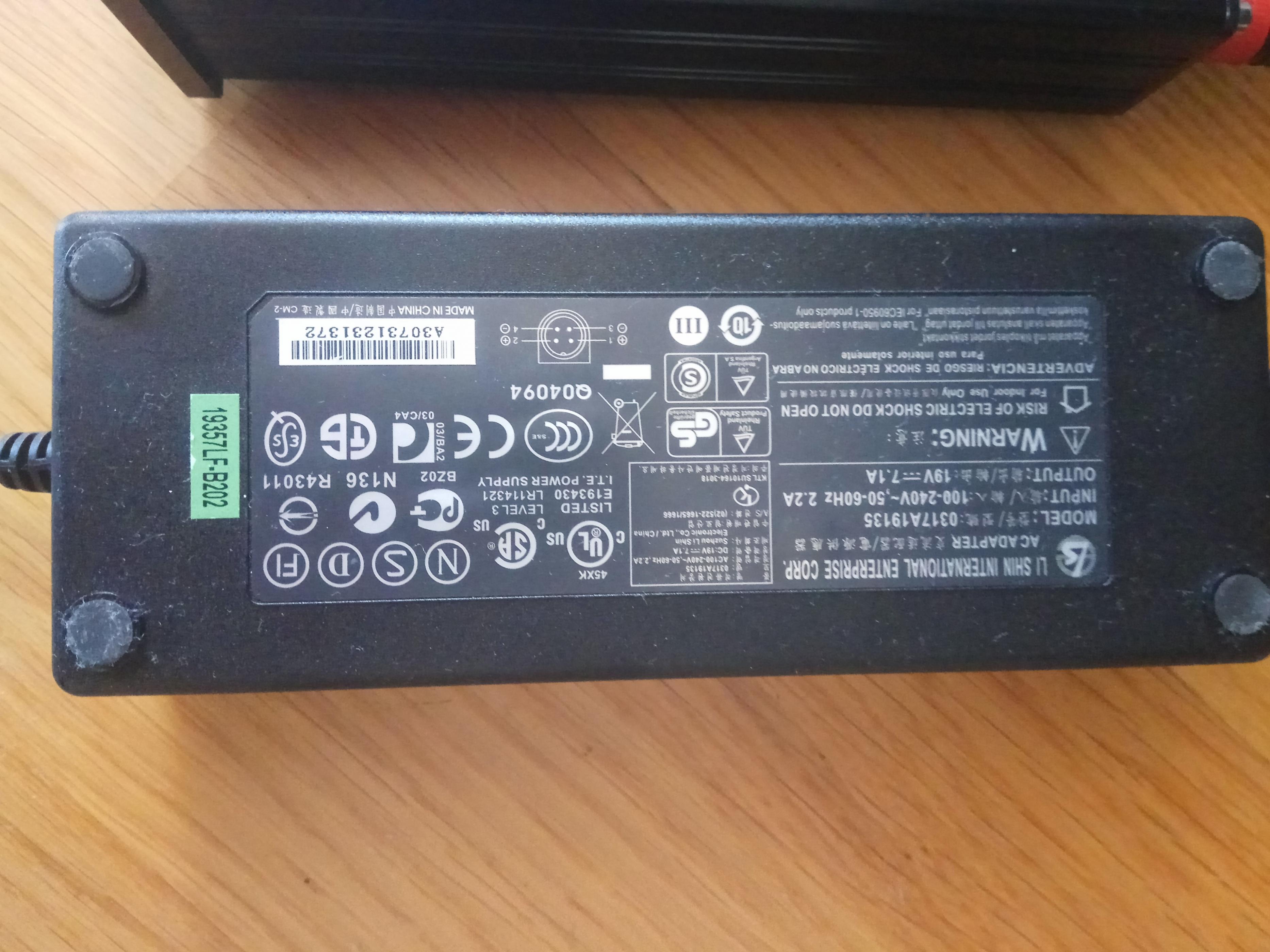

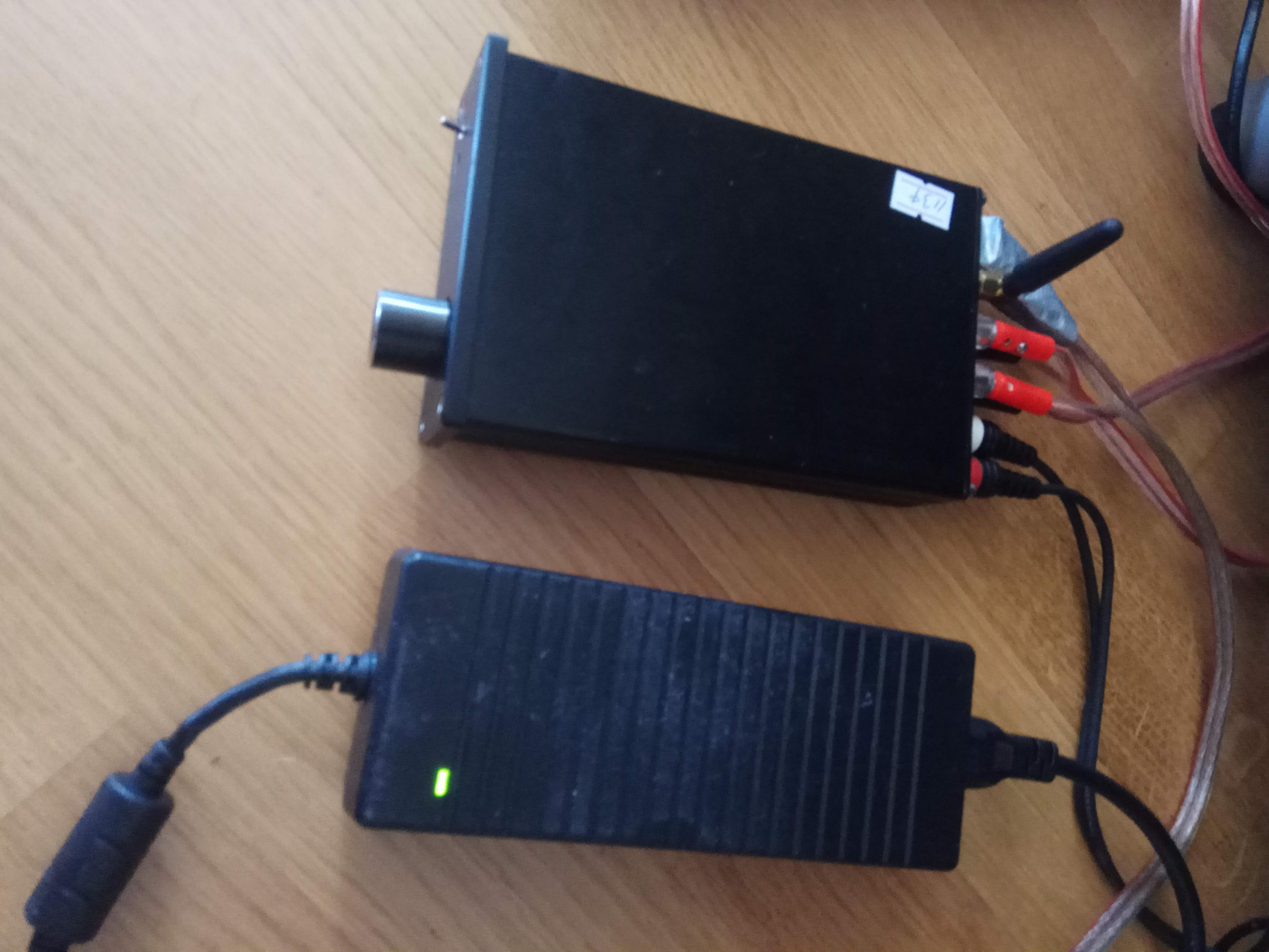

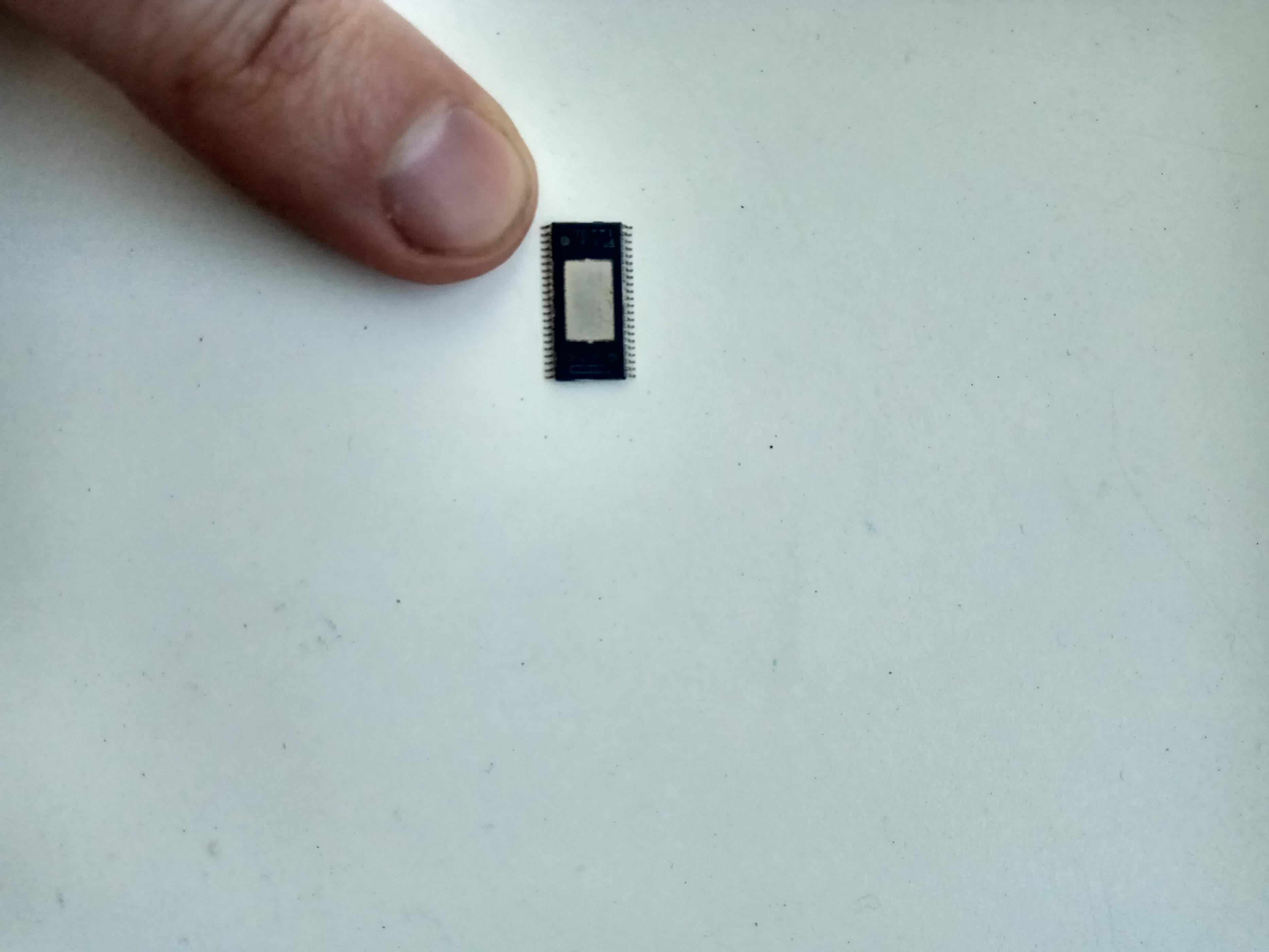

Hi, mates. It is me again from Ukraine. Just got back my tpa3255 from repair. It cost me 8$chip and extra 10$ for work, i wad lucky to find local guy who did it work again. He told me the most possible reason could be static thunder during switching due non isolated switch from the supply rails. He advised me first touch antenna metal before touch the item. Keep in mind this device engineering fault . He also found one channel was not damaged but due one of them was fault / master the second chanel wouldn't start.
Anyway I am listening amp now and it delivering rather tight sound level even with 19V/7 A power supply adaptor.

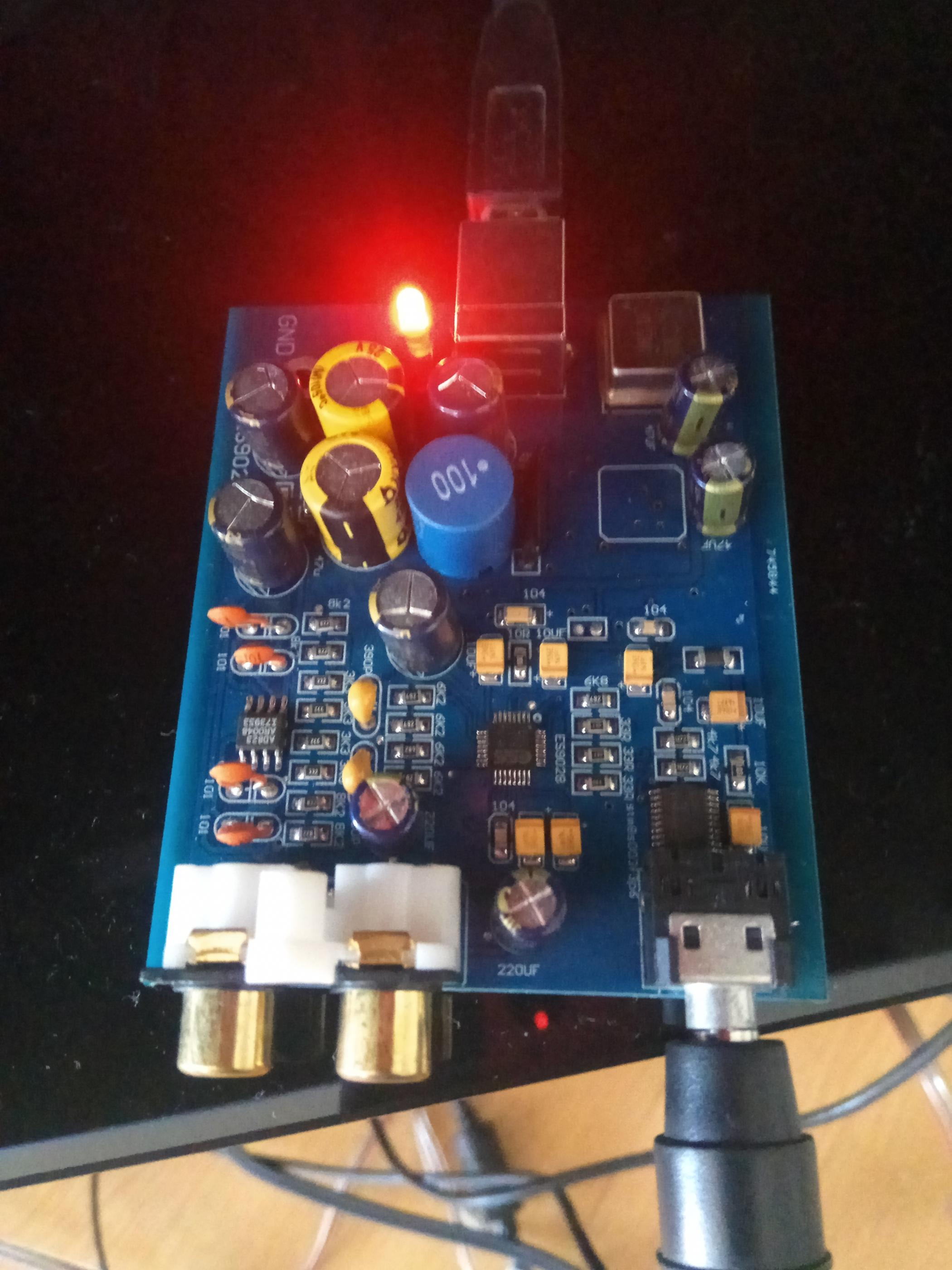

Just for your reference I now having double chip tpa3116 board, tda7499 and this tpa3255. They are listed in increasing order of terms of sound quality for my personal preferences. Without doubt tpa3255 even in my simple design board YIAMA deliver pleasant sounds. I also got MARANTZ SR6400 for a while to compare 110w/8hom 0,003%distortion and found tpa3255 almost equal in direct mode with no heating up like this 15 kg monster. And yes I would recommend DAC I am using now :AIYIMA HIFI аудио ES9028Q2M SA9023 USB worth 20$ and you will hear the difference after pcm2704 for sure. Good stuff with no drivers for Windows xp, android, even tv box xmini96 got it vis usb p- audible difference for youtube comparing with buildin dac.
