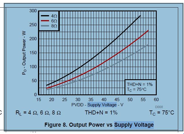

What is the best voltage for the yj boards. It states in the ebay description to use 50volts, most on here are using 40 volts, what do you think about going lower as i heard higher voltages can increase distortion, would lower voltages lower distortion and give better sound. 40 volts sounds like you are running the boards at the higher end of the rating
Thanks!
So is there an ideal voltage for the tpa3255 or does it vary with implementation?
And has anyone tested the distortion at various voltages?
I have a power supply that can be set over a fair voltage range. It would be handy to know the ideal voltage for 3e Audio's tpa3255 containing EAUMT-0260-2-A.
How would one go about testing this?
Often it seems to be a good idea to look at the data sheet of a certain D-chip.
There you can see distortion at different loads, supply voltage etc.
These firures should be achievable with any implementation that fits the circuit board the manufacturer designed.
yep....TPA3255 page 11 - - Figure 8😛ower-Voltage-THD for 1%
