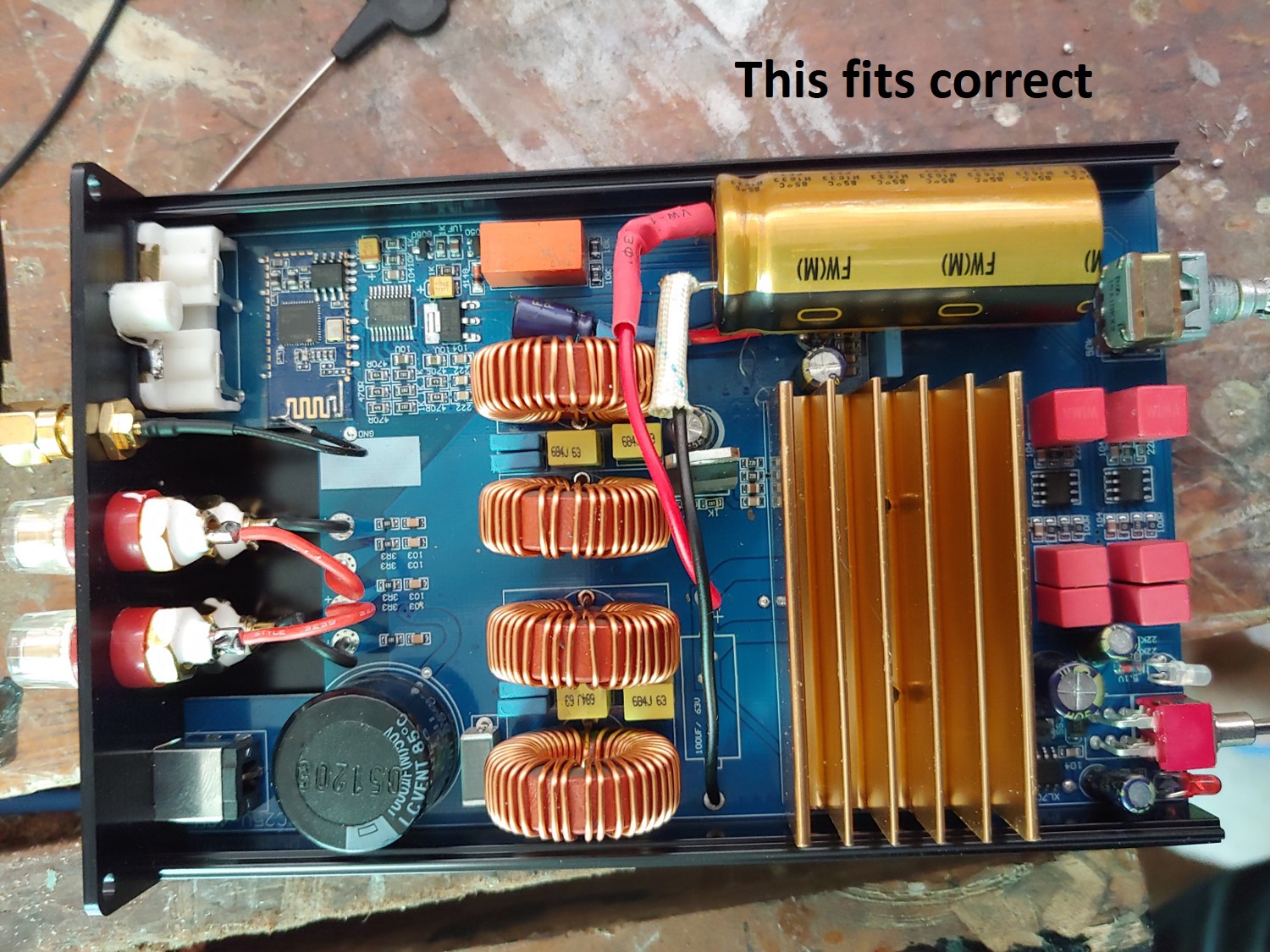

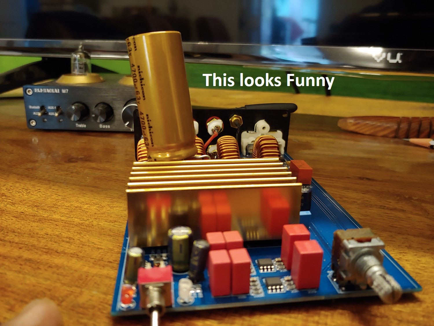

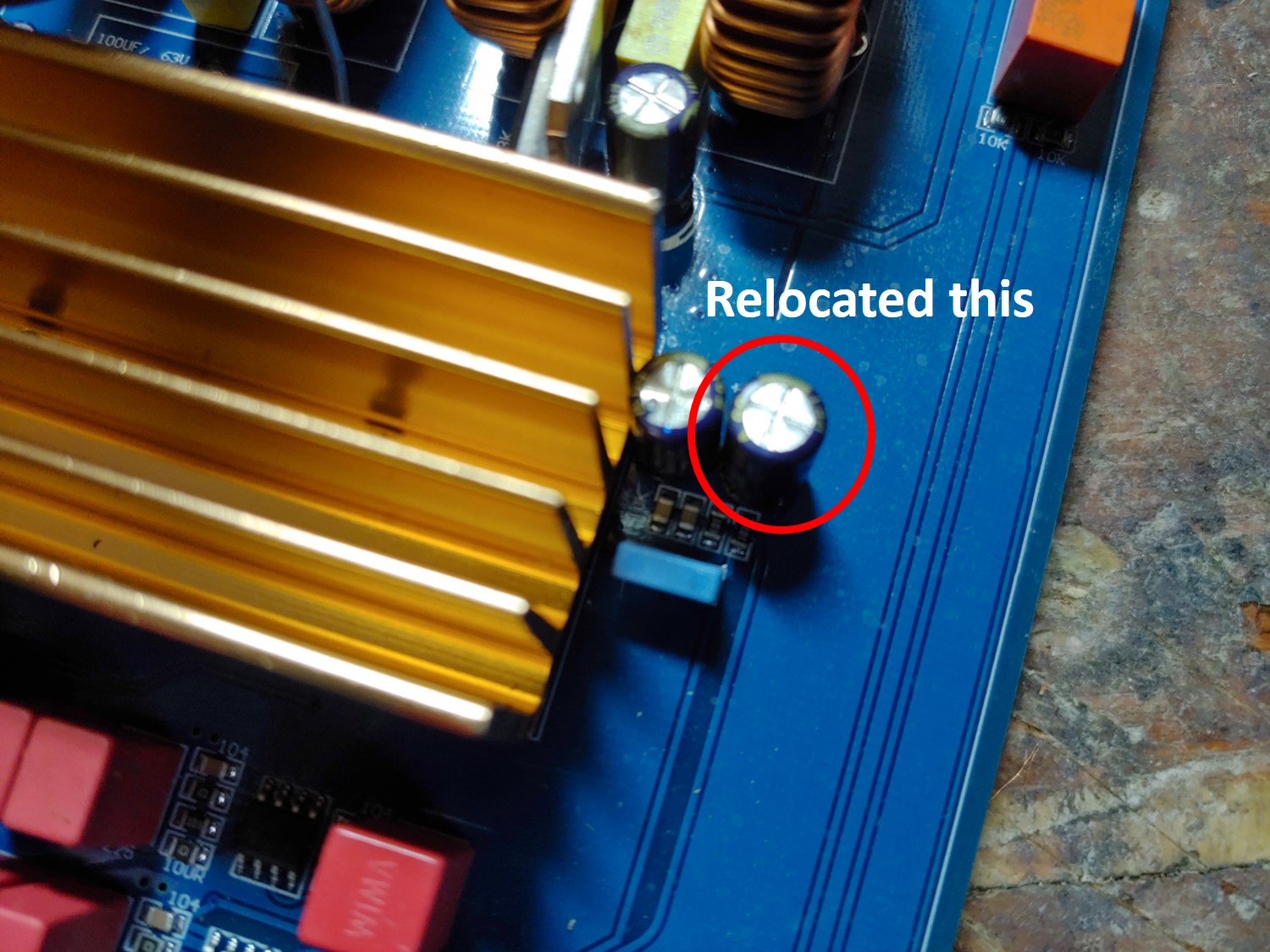

replaced the original 68uf nichicon capacitor that came with the amplifier with a 4700uf 63v Nichicon muse. this is the best i could procure. relocated a cap and gave the cap extra long legs. and hot glued in place.
The sound output has indeed improved. the bass sound less muddy. overall output is good

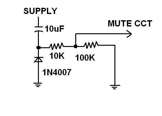

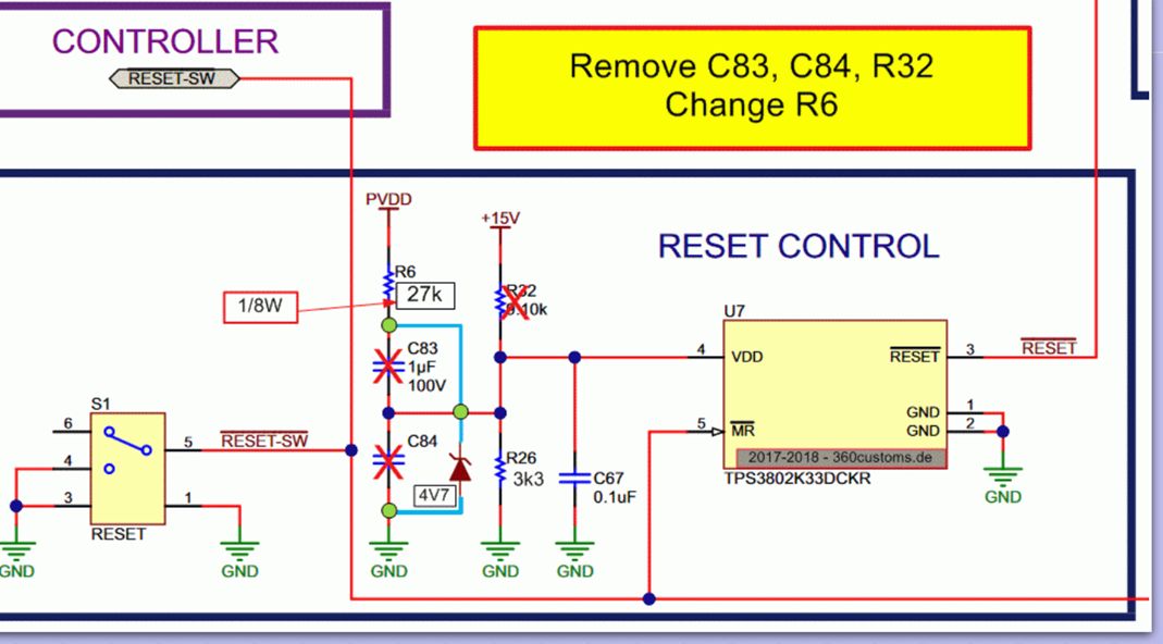

i guess turbowatch is mentioned a circuit to avoid a faster power up of the TPA chip. i mean : if you switch on the amp board the rail voltage starts to rise and the tpa chip wants to "switch on" and therefore you will here this pop on sound.
to avoid this there is a circuit at the mute pin to "hold" the tpa chip "mute" = quiet.
at the YJ tpa3255 board there is a voltage superviser chip on board to do that.
-->TPS3802...please read some posts...its not so easy😀
https://www.diyaudio.com/forums/class-d/309813-wrong-tpa3255-75.html#post5687215
doctor created this circuit....
this mute circuit can be done with some RC divider too..pic 2
chris
