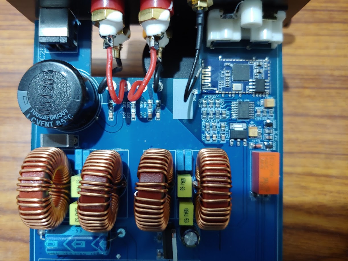

if iam right with reading the pcb traces then its a just a fat cap on the begining of the power supply socket and a too small cap on the TPA chip rails !!!and its just 1 cap. i mean the cap which is axial on the pcb.
its recommended here to use 4700µF low esr/esl about 20mohms..or lower
so change the 220µ to 2x 2200µF low esr in minimum.

Thanks. There will be no space for 2x2200uf caps unless i leave the top cover open. is one 4700uf enough/Ok?
cannot measure coils.
yes- the low esr/esl cap is at class D very important. you have to find a size which fits here and as big as possible but low esr/esl

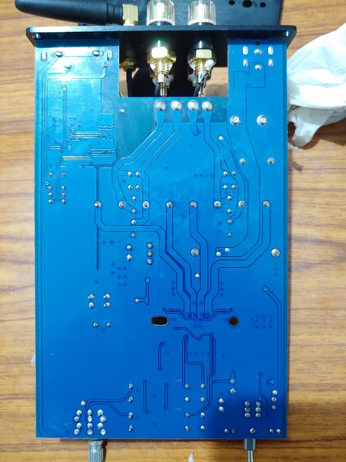

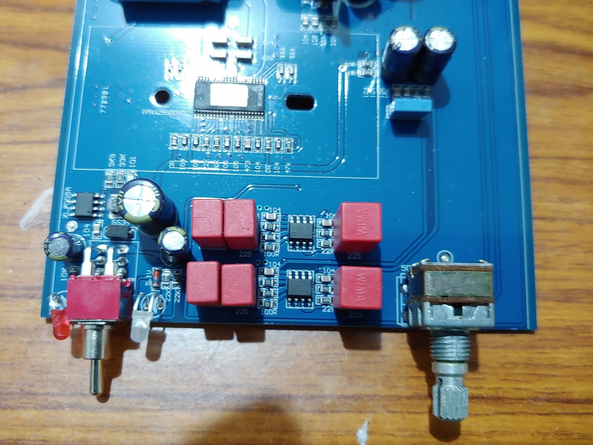

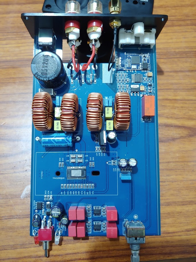

Hi, mates. My amp after worshop checking verdict: the tpa3255 is broken. All the i/o and power signals are ok, but no output. There are no visible damages on the chip. Any ideas? To replace chip would cost 10$ for chip and 10/20$ for work...seems like protection sometimes cant prevent overheat/overload . My guess it is due overheating.
Maybe you post a picture of your amp? This usual China stuff has a failure rate, as high as a Russian automobile... you might arrive or not.
But, unlike a Lada, in most cases repairing such an amp is, as you realized, not realistic, if replacement is the same cost.
What did you? wrong polarity at the psu? died the amp during listening?
chris

Yes, died during listening
i am sorry to read this...
i have 8x YJ TP3255 but no board died during listening.... if i had adead board it was my fault....e.g. destroyed traces, wrong polarity
chris
chris
same here. I am building with TPA3118 and TPA3255 for several years. Failures have been rare events, never spontaneous but due to some fault(s) from my side.
Not my case, if there was fault it couldnt play. Damage happen during regular listening on rather high level biamp tpa3255 for mid/high+ tpa3116 double chip board loaded 8 hom canton sc-l.
