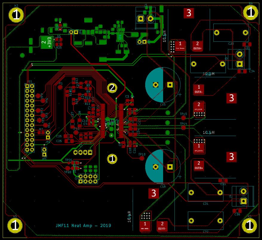

A lot of learning and trial and errors. And for sure I would need some advices of more experienced people:
- are there some ground loops ?
- GND copper plane on the top and bottom, or only on the bottom (currenltly there is one on both sides) ?
- other design flaws or checks to perform...
JMF

And Chermann, last to say: having a dedicated design compared to the TI EVM board is to implement all the community feedback. So if you have advices on improvements, thanks to share 🙂
The TA3251 is badically a DSP+TPA3251, so all your improvements should make sense.
JMF

No, I understand. It was more about which caps you used. Which changes provided benefits in your experiments, and which ones had no effect 🙂

Ahhhh. ok....now i feel better 😉
at the TPA3255 chinese YJ board i was most happy with the 2x green UHE 10µF muse caps directly at the input (before the opamp) + the 4 x ukz 10µ (unluckly i just had the 50V version) at the TPAchip inputs.
as i wrote..there was a discussion at The TI EVM board about using electrolytic cpas instead of SMD...because the sound of the ceramic/tantal are not nice...
output filter i am happy with the 8R configuration= 10µH Würth 74439370100, TDK Epcos caps B32652A3684J or 0,47µF...
opamp 1602
Rail caps = by Doctor = Chemicon EGPD630ELL242MM40H
or similar (high ripple at 100khz low ESR/ESL)
Important is to seperate the voltage regulation (low noise) for the TPA chip and the opamps . Faux French did a +/- double voltage for the opamps to provide a better THD....at the TI EVM its not realiszed like this. i personally havn´t tried this.
As i do not have THD measrument equipment i can just say that my result was listening test.
chris

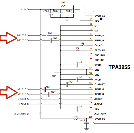

Did anybody try to bypass that opamp and feed signal directly to TPA3255 input pins via 10µF caps?...at the TPA3255 chinese YJ board i was most happy with the 2x green UHE 10µF muse caps directly at the input (before the opamp) ...
Whats the purpose of that opamp? buffer?
hi zek
if i remember right. if you use a single ended signal -rca connector --> the opamps are therefore to "build" a inverted signal for the TPAchips input Input A....input D.
for differential input you can go directly to the tpachip over the 10µF.
there are some ideas to use bipolar caps here instead of the polarized eleytrolytics...but now idea what happend if the TPAchip get some DC voltage there....
chris
