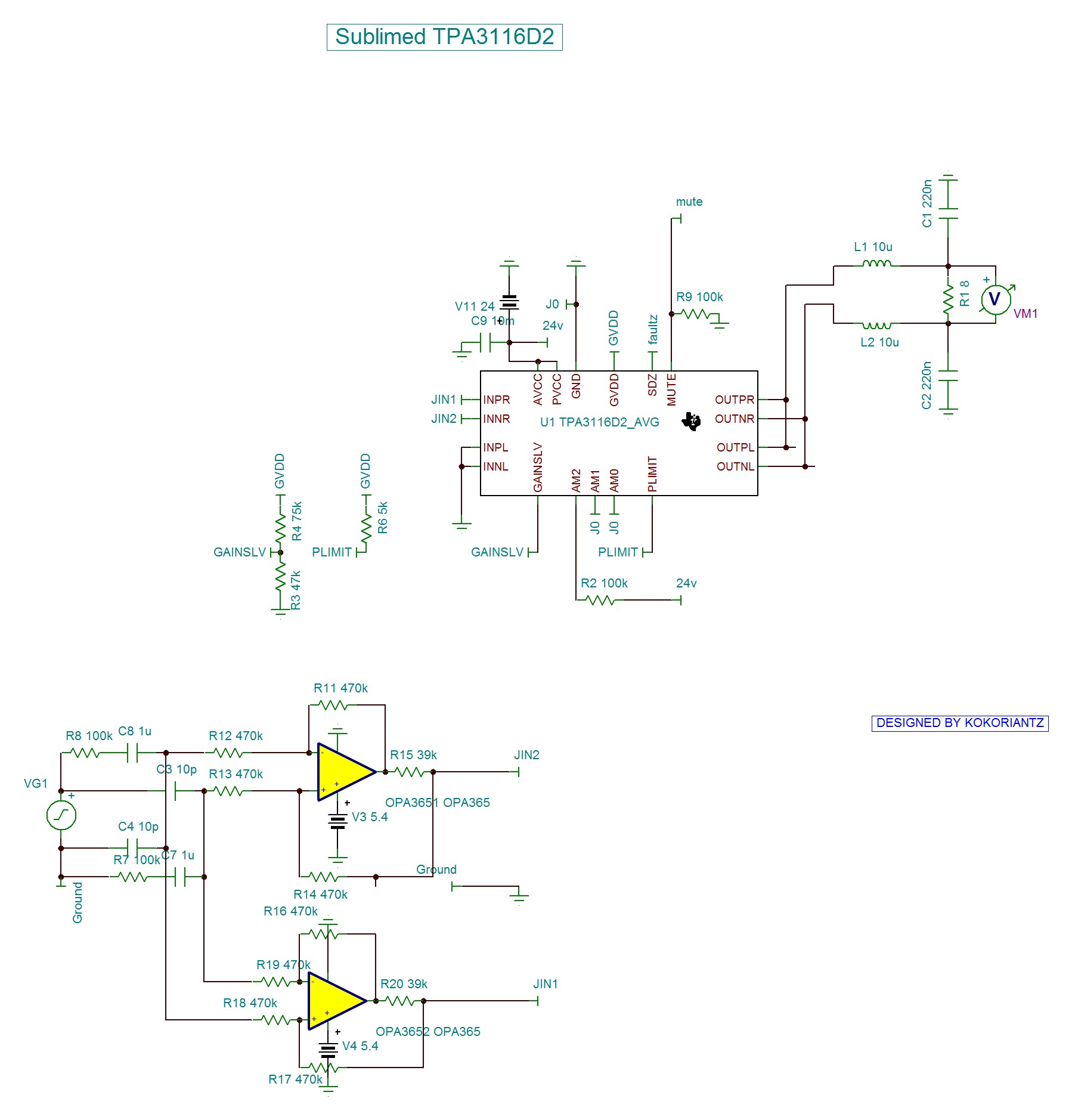

Reduce the distortion of TPA by 15 times .
The inputs lead to inverters with 20k ohm , with a gain of 21.5db . If you drive directly the inputs by high impedance 1M current amplifiers , the re injected error gets multiplied by 15 reducing the distortion by the ratio . I tried it on TPA 3116D2 see sublimed TPA3116D2 with great success specially in domain of dynamic . Bellow is the definitive circuit but the power supply need to be elaborated.
The input voltages must be identical 3-3.5v as indicated on datasheet to be 7v max pp .
What's the function of R15,R20 (39k) please? Just curious.
With TPA3116 running 1.2Mz is flat response if the output LC is adjusted . See Sublimed TPA3116D2 , you can even listen to .nice idea, provided the TPA is unity-gain stable😉
Some call this circuit Holloway others biphase . On this site is the famous My-ref of regretted Mauro Pansea . The 39k is the transconductance resistor transforms the input voltage into output current . It can be reduced to 18k if higher sensitivity is required without any serious drawback.What's the function of R15,R20 (39k) please? Just curious.

Just curious, how did you measure dynamic variation?

The only measuring instrument I use ,are my ears .Just curious, how did you measure dynamic variation?
