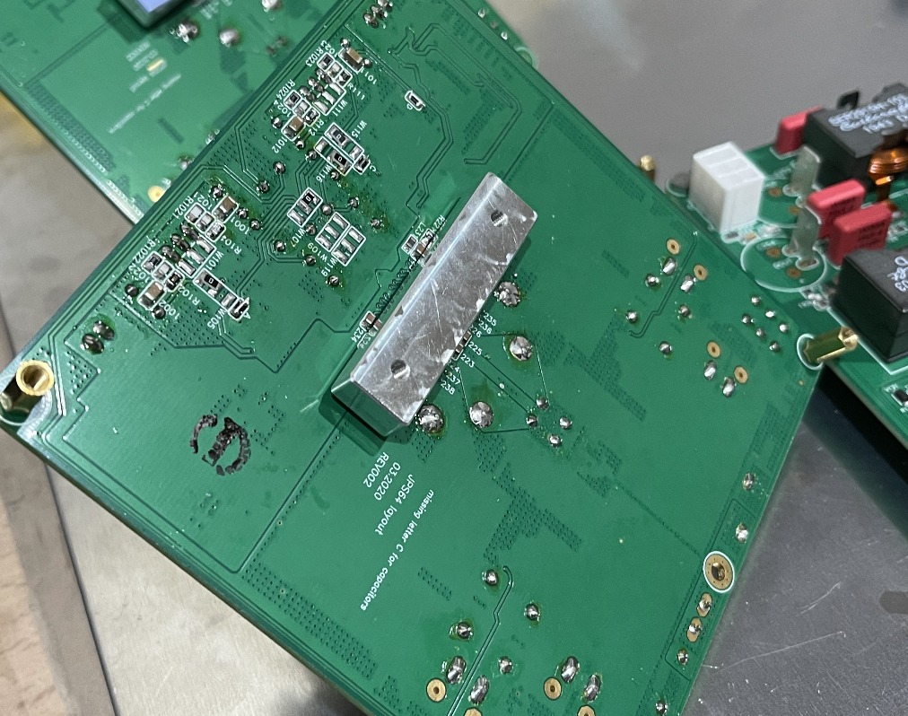

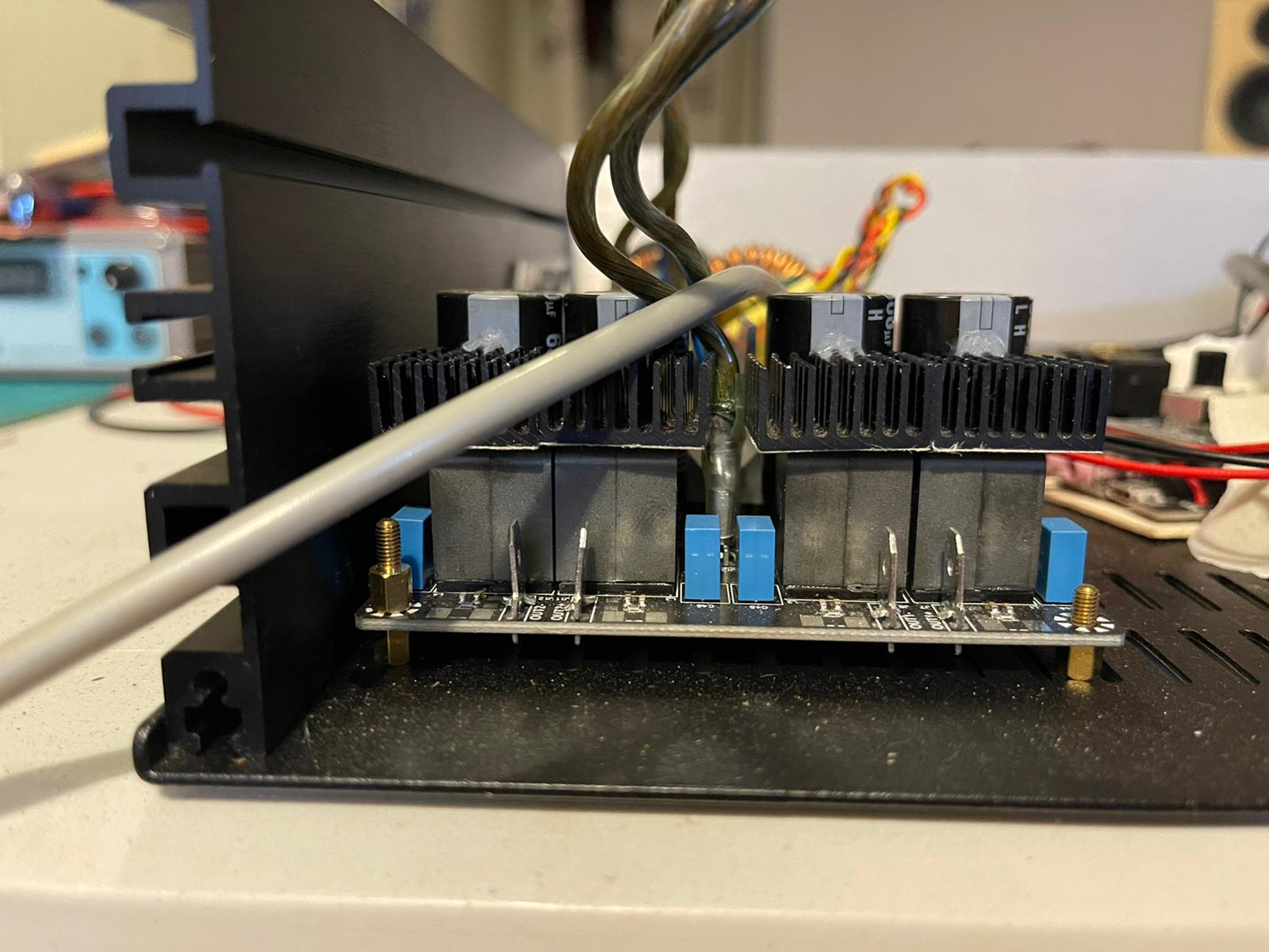

I've lurked about your designs some time ago, very well made. Typically I like to guide the heat to the side panels where I can mount serious heat sinks. Seems with integrated designs such as the 3255 it's not feasible to expose the device heat plate to a corner heatsink wall, need to get creative. Good point on the electrical isolation, Always should check resistance between the case an all the IOsI’ve been doing bottom mounted heatsink cooling for years. Simplifies heatsinking by using chassis floor panel. Here is a thermal transfer block I made as attached to the bottom side of amp PCB. Be sure to use an insulator thermal pad. You don’t want the amp’s power pad to touch chassis ground as that can lead to ground loops.
A side wall heatsink is not needed. TPA3255 is 90% efficient. At typical very loud music playing of 100w, that is 10W of dissipation. A large aluminum panel on floor of amp is quite sufficient for this level of heat output.
You could use a copper heat pipe and bend it to bring heat to the side wall. CPU coolers on laptops do this.

Familiar with laptop architecture, I've repaired more than a few with ali sourced heatpipe/fan combos 😛 Side heatsink lowers the internal case heat radiation through a better convection with ambient air (and I already got thick material for my case sidewalls), bottom heat sink spreads the heat across a large area yet some of it rebounds into the enclosure.A side wall heatsink is not needed. TPA3255 is 90% efficient. At typical very loud music playing of 100w, that is 10W of dissipation. A large aluminum panel on floor of amp is quite sufficient for this level of heat output.
https://a.aliexpress.com/_mMjOCmY
https://a.aliexpress.com/_mt6eBa4
I thought of machining the 3e heatsink, shave off the fins to a flat surface and enable the attach of copper pipes. Heat is bad for the long term; capacitors derate faster, Rds_on increases, ESR and parasitics increase, overall noise and distortion increases.
I've even tried to spread a bit of the coils heat away as the caps in a 3e design are getting gently broiled from both sides.
I'm reading 54~56C in Idle on the heatsink with case closed (no pun).

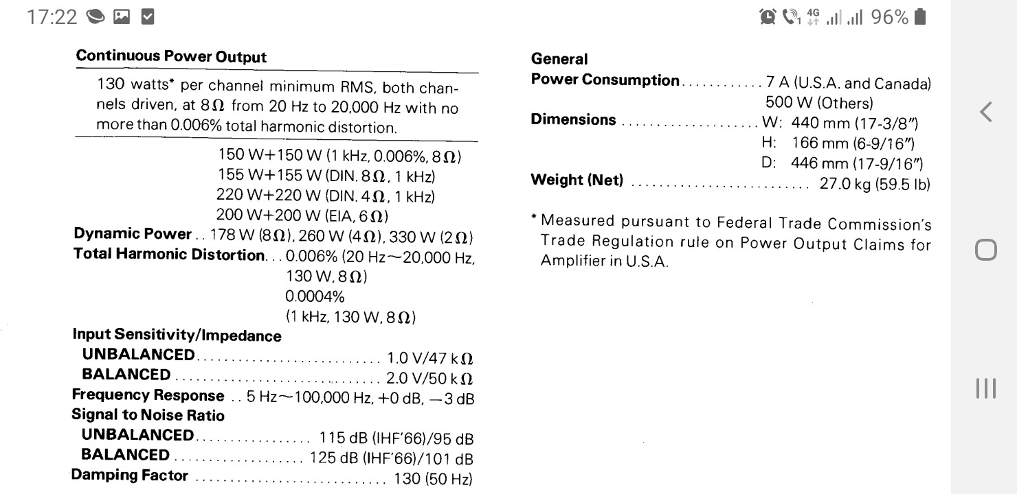

Studer used it to monitor and line out in A810...827.A lot of the 80's music you're listening to went through a BTL circuit for being monitored or transfered to vinyl , tape or cd...Theoretical electronics doesn't support your ideas. I see you have o lot of them and all of them are slightly wrong...

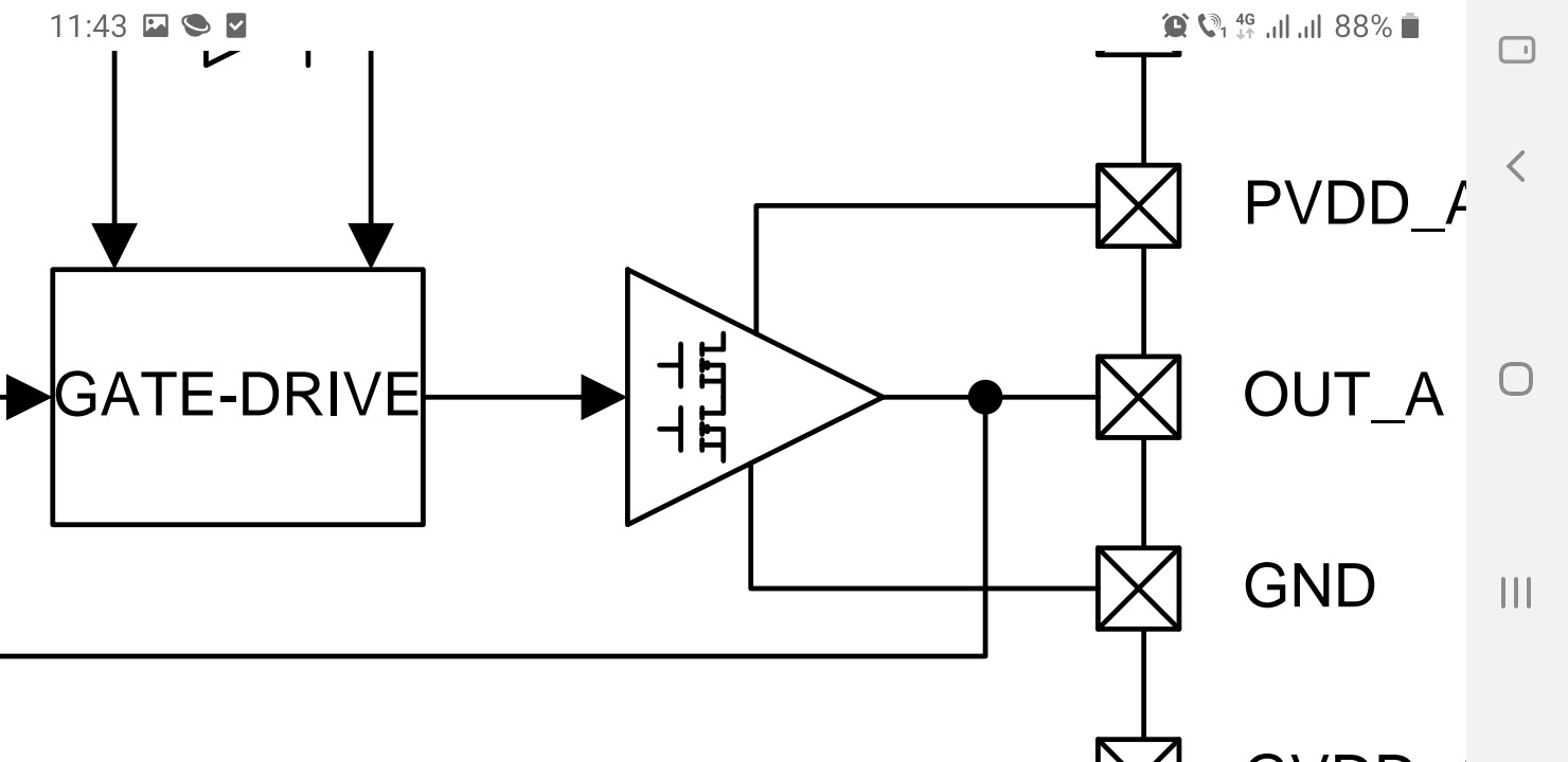

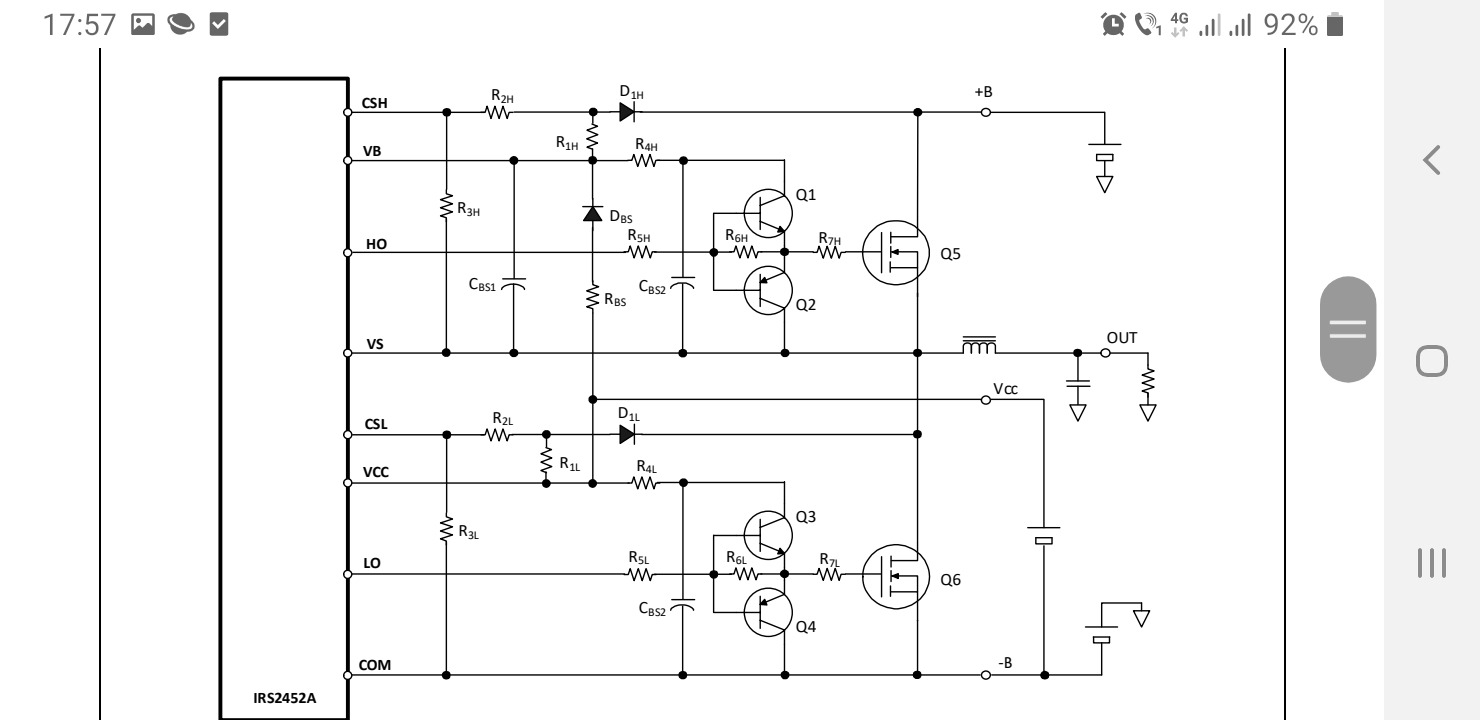

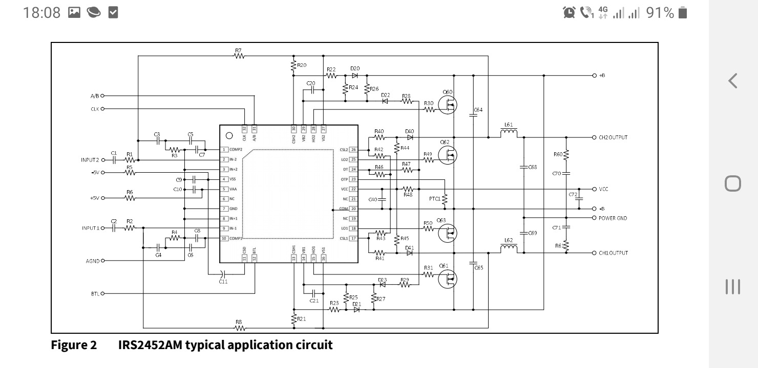

Have you heard of virtual ground? All single rail amplifiers use it to center the output between plus and ground creating an artificial ground and they do it for decades...they might choose to create also a power artificial ground like quad 405.Have you ever heard of it?
Didn't say anything on QSC cause they're not exactly home amplifiers and I don't know anyone using them at home, but older class AB versions were virtual ground designs too.

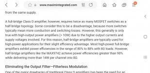

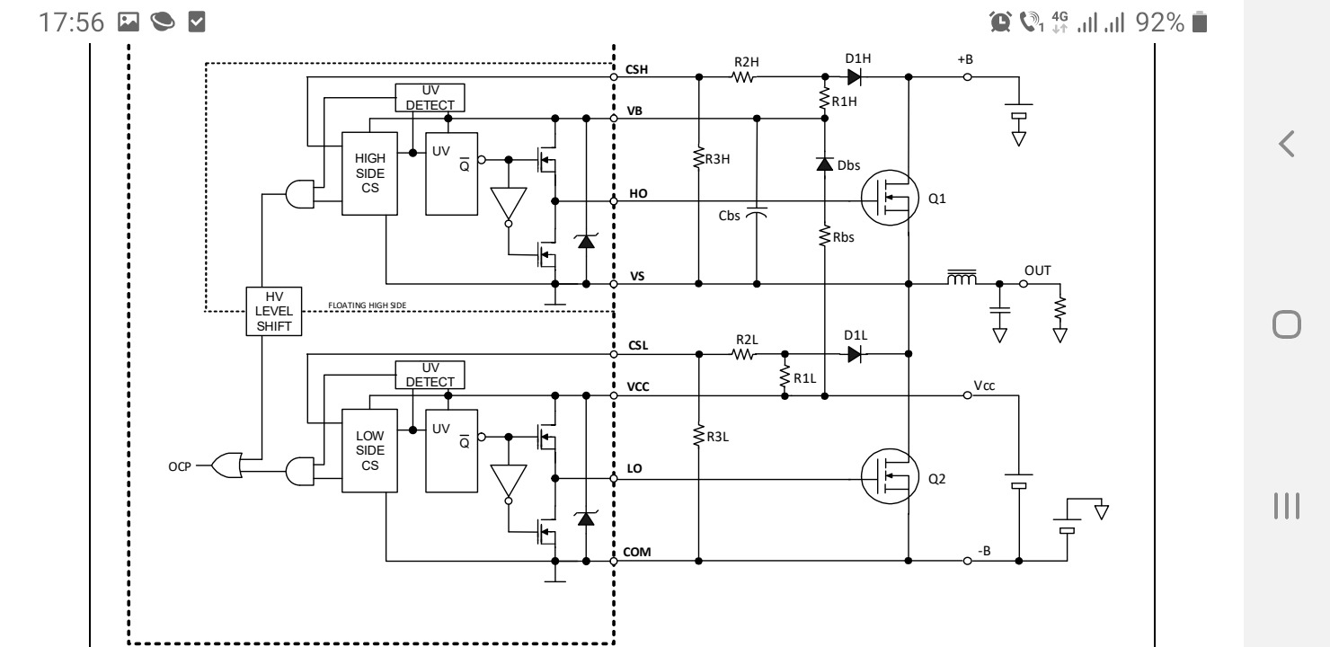

BTL is not economical in class a, b, ab discrete technology, but it's found in many symmetrical supply amplifiers of the past as an option for higher output.
There's some theoretical background for higher efficiency in higher power class d amplifiers when supplied by dual rails, but
before diving into channel length modulation in mosfets supplied at larger voltages , it seems to me that you, as a seller don't really know your products cause looking into some IRS chip datasheet I see that the driver chip operates as single supply with bootstrapped outputs using a level shifter internally.

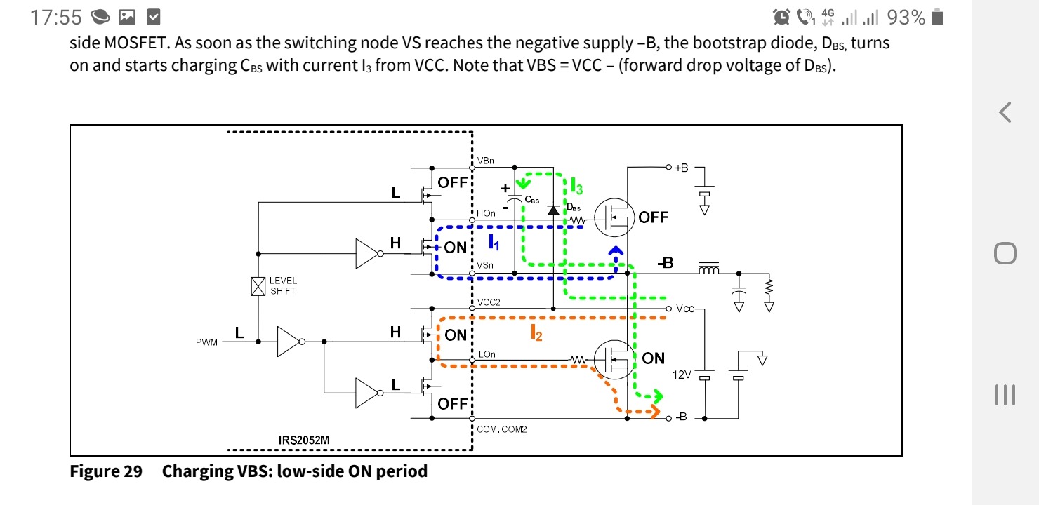

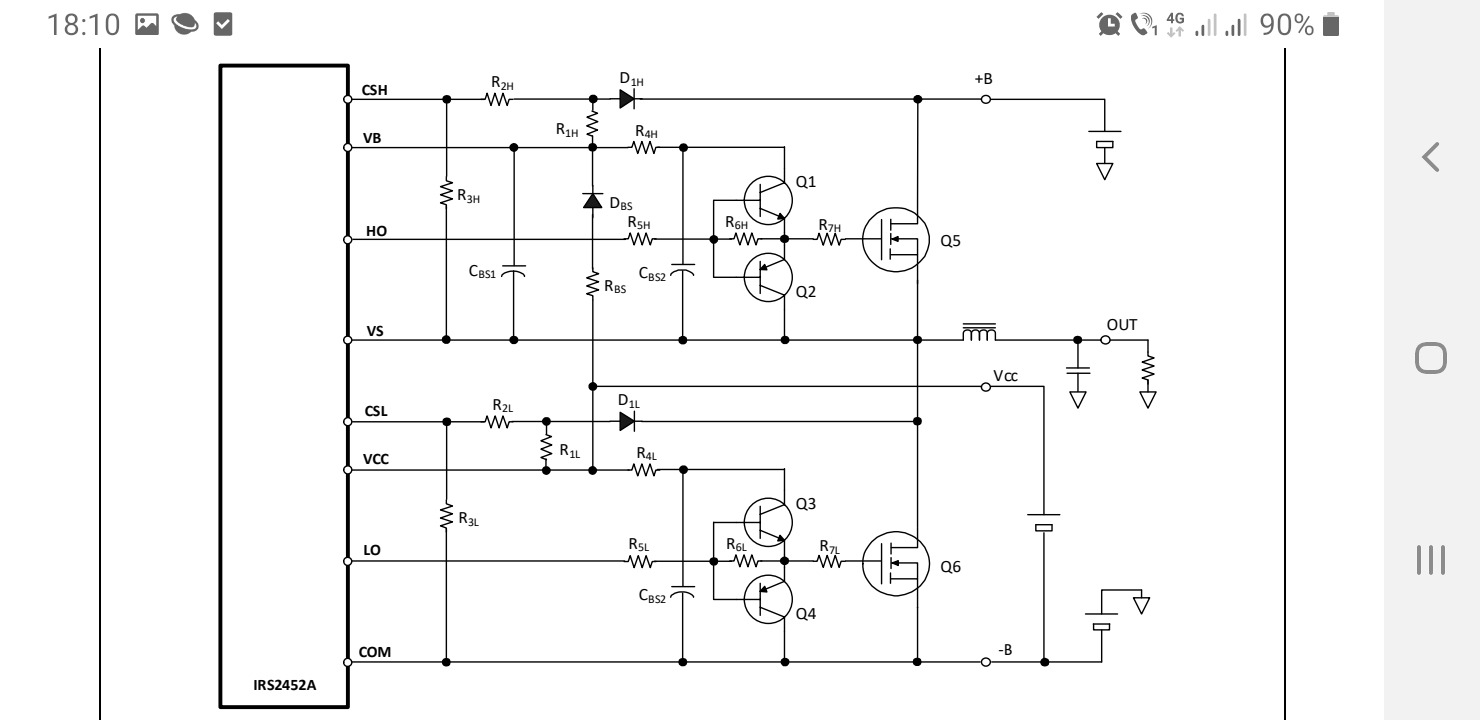

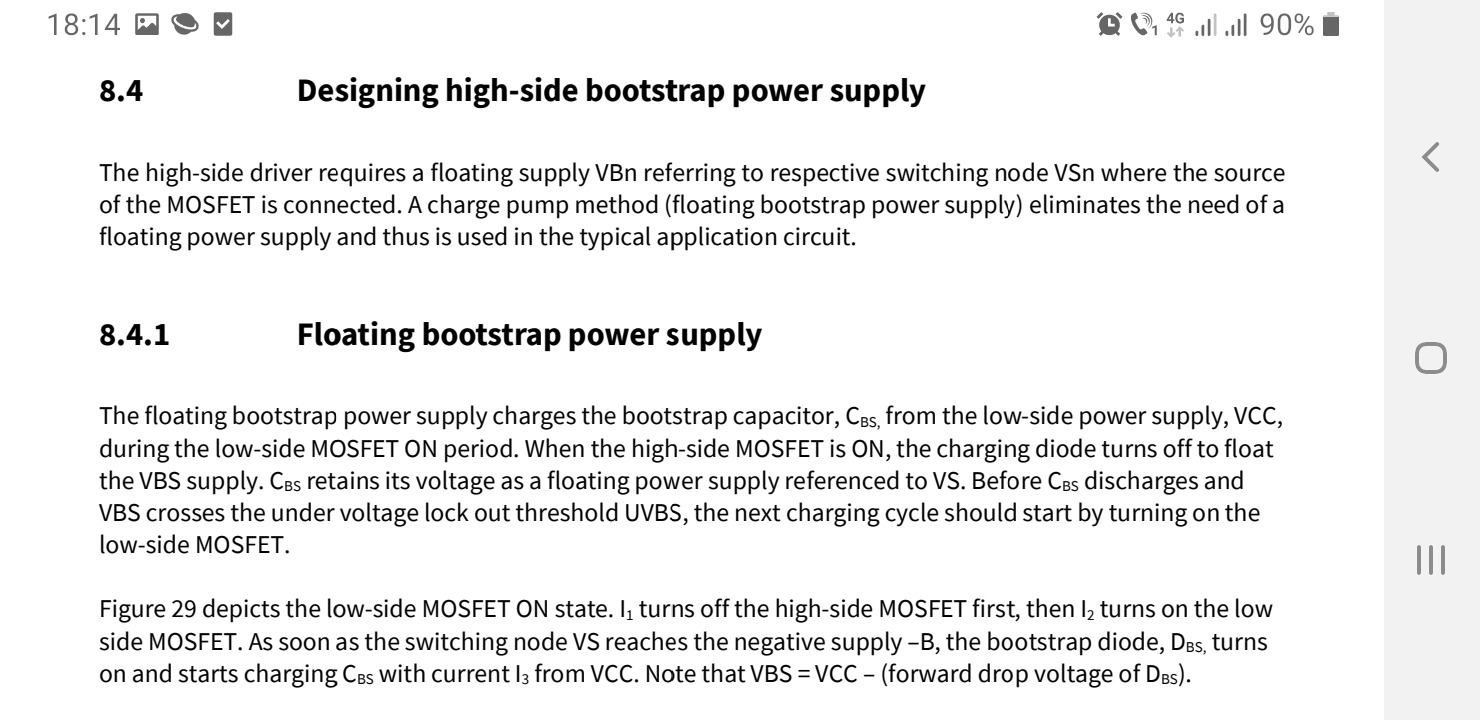

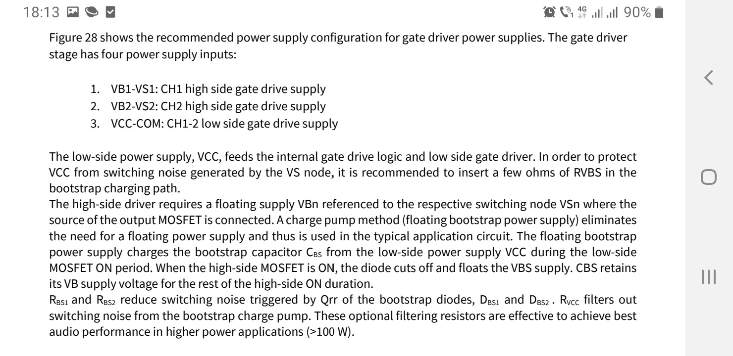

Now bootsrapped outputs are 60's class b/ab main way to reduce distortions in the output stage as much as it is today in class d amplifiers to avoid floating supplies...
Now honestly...I never dived into reading any of the class d IRS chips datasheet until today while you're selling them for years.
It's all economics my dear same as your margines I suppose!

Some have always something universal to say about everything and they know it for sure.It feels like debating ferociously with Stephen Hawking spirit about the parallel universes...That’s just not correct that there are NO commercial high end BTL amps out there.
You mean quad405.Have you heard of virtual ground? All single rail amplifiers use it to center the output between plus and ground creating an artificial ground and they do it for decades...they might choose to create also a power artificial ground like quad 405.Have you ever heard of it?

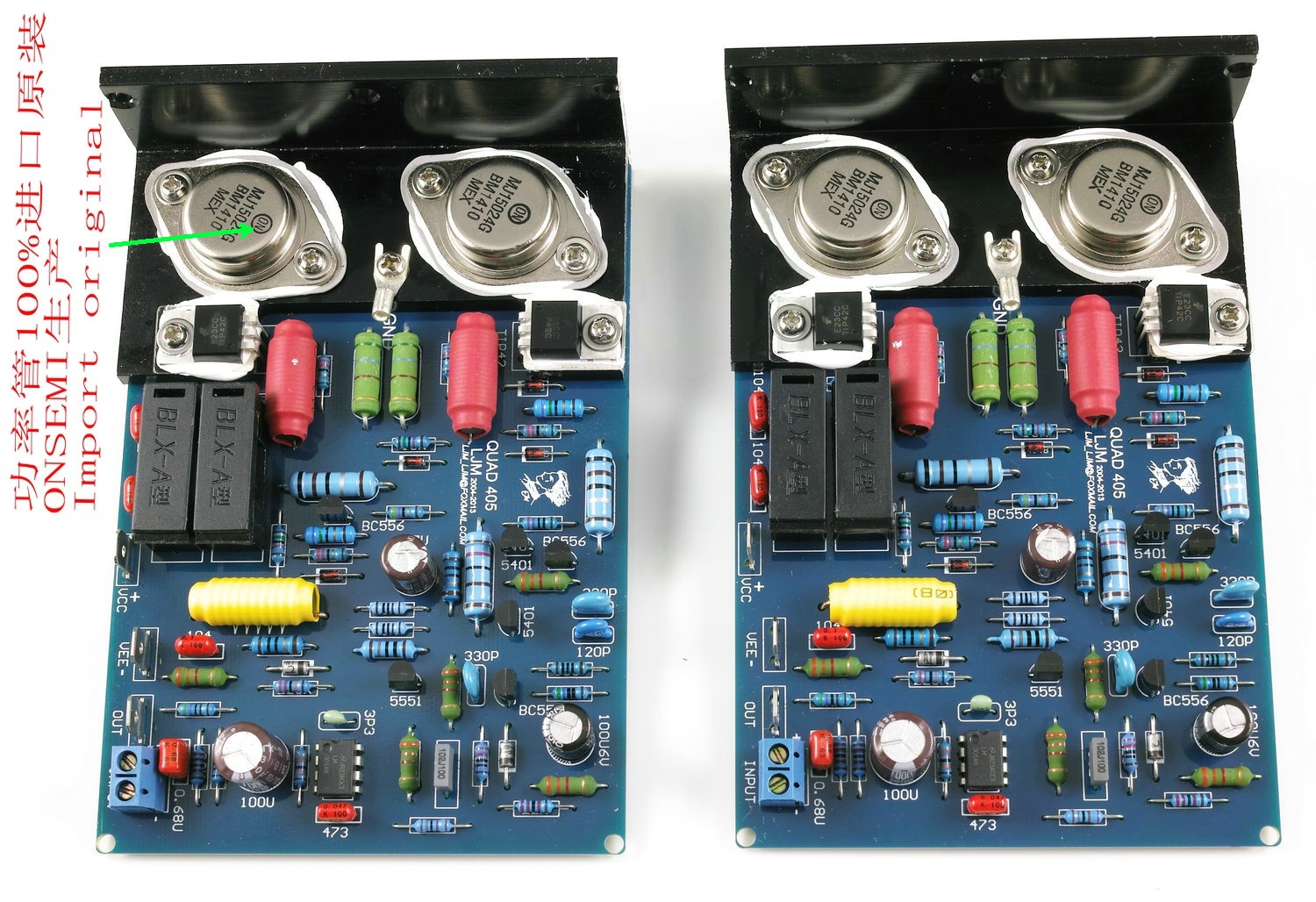

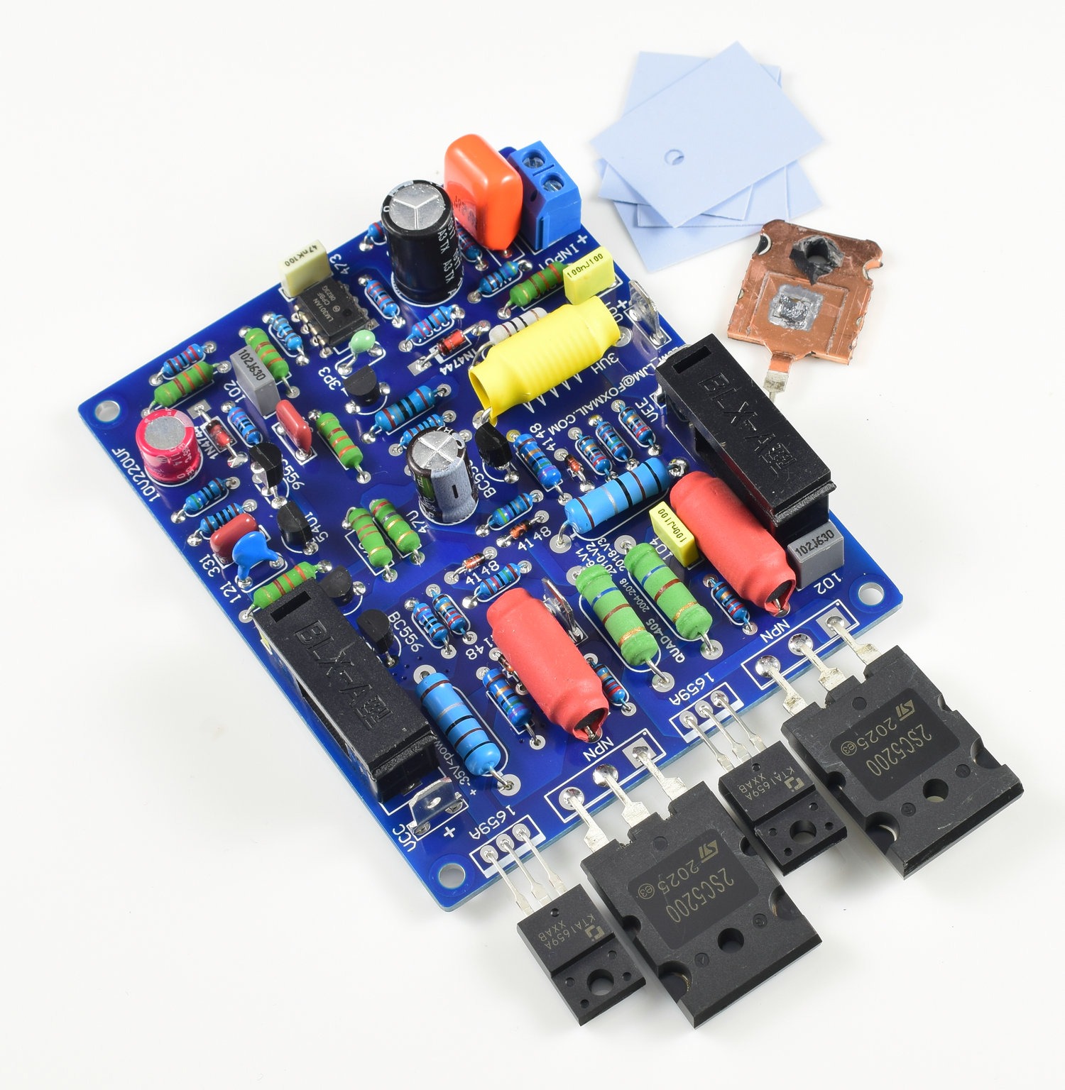

I made more than 1000 quad405s.
It also uses DC + - 50V DC.
Please look at the logo on the PCB. Producer: LJM

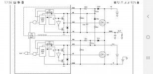

Do you read what other say? I posted the original quad 405 schematic in the previous post.The original quad 405 , the one for whichYou mean quad405.
Peter Walker was awarded by the Queen is a virtual ground design with single supply. There's no improved Quad 405 with "true symmetrical supplies"...just mambo jambo.
