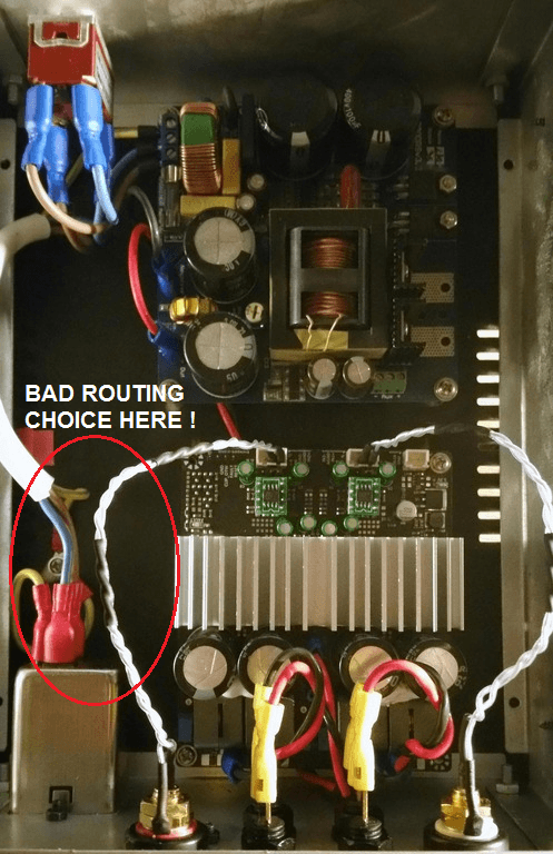

@LeRouge I noticed that you routed one of the input wire pairs right next to the AC mains where they come out of the switch/filter unit. That is probably not ideal, even with balanced connections. Maybe this is why you were having some issues previously?
In hindsight, it would have been better to arrange the input/output jacks (left to right) as mains, speaker out #1, speaker out #2, input #1, input #2. This keeps inputs away from current-carrying wires as much as possible. If you had the space (looks like not possible in this chassis) it would be still better to rotate the board 90 degrees clockwise (from the position in the photo) so that the speaker connections are next to the AC mains and the inputs are located all alone in the corner of the chassis, away from other wires and would be shorter inside the chassis itself. They would also not need to be run right above the output inductors, which probably generate some EM field under power.
Finally, you can use shielded microphone cable for balanced inputs and take advantage of some extra shielding on those runs.

It's the image that gives this feeling of close juxtaposition but in fact it's not a problem, you have to think in 3 dimensions, the connector is placed in height while that of the power supply is 8cm lower and shifted to the left by several cm. And then this type of socket is shielded with a covering connected to the ground and should therefore not be a significant source of emissions. As for the inductors, I have to think about it but I don't think that's problematic either.

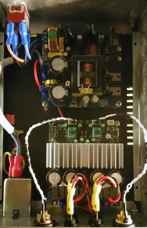

In any case, it was a provisional box that served me as a provisional test. I will soon receive 3 new boxes, slightly more spacious (I think they will be almost the same as the Fsatsil one) to make 3 identical amps based on this card for the active amplification of a DIY 3-way speaker. The assembly will be done differently there and indeed the RCA connectors will be placed opposite the power socket.

You should also change the interconnect cables.
Like you, I also initially used the cables provided by 3e audio, thinking that they were sufficient, but in the end, when I replaced them, the improvement was immediate. I used AWG 22 i2S cables for this, which I modified by removing the black plastic covering the socket, reducing the socket with pliers so that it fits the pins of the card, covering it with three layers of heat-shrinkable sheath so that once the cables are connected they are perfectly maintained by pressing against each other.
