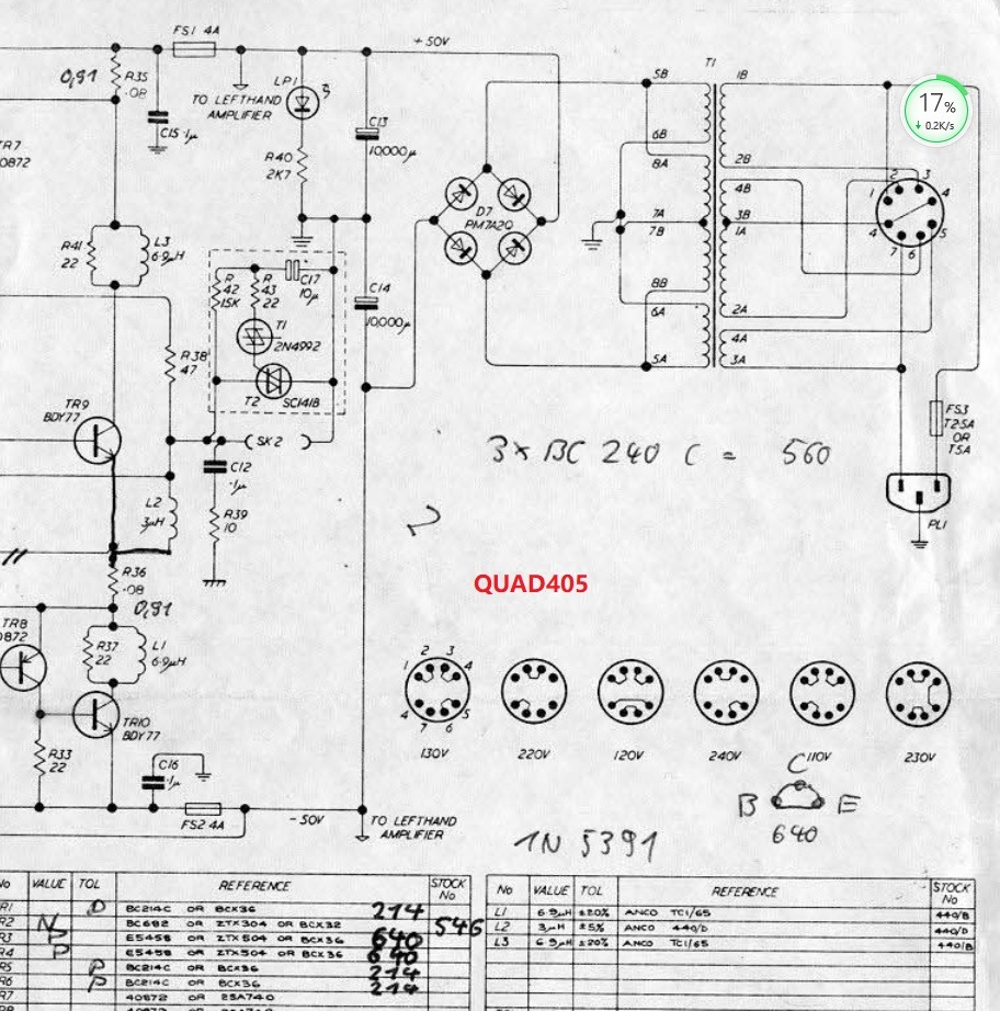

Do you read what other say? I posted the original quad 405 schematic in the previous post.The original quad 405 , the one for which
Peter Walker was awarded by the Queen is a virtual ground design with single supply. There's no improved Quad 405 with "true symmetrical supplies"...just mambo jambo.
I'm affraid I'm going to report your post for commercials cause it's very clear to me as for others what your intentions are.
I used the original quad405
It is also powered by + - 50V.
I don't want to mention quad405. You proposed it.
I happen to know it very well.
Quad707 is powered by a single set of AC 80. But it is rectified from the filter capacitor
+ -55v DC was still obtained.
Don't deceive others with false things.
If you think a single power supply is better than a dual power supply. Just say so.
Just like I think dual power is better. I don't need anything else to prove it.
This is your freedom.

I am sorry, YOU'RE RIGHT about it.My bad.Quad 405 is not a virtual ground design.I have read the wrong article which made me assume it's the same with QSC designs.
Yes, by all means I do , and capacitor output coupling of speakers where ever it is possible, even and especially in BTL where theoretically they aren't needed ! But your IRS high power driver chips are single supply with charged pump bootstrap and level shifter .Check out the datasheet printscreen I posted or the full datasheet.It's only the output mosfet stage that's dual supply.
Actually, I know what you mean.
Floating ground of quad405. There is indeed such a saying.
He refers to the signal ground SGND. And the power supply ground PGND. There is a resistance between them. 10 OHM。
So it is called a floating ground line. In fact, it is no different from ordinary amplifiers.
Irs2092s is a dual power amplifier. Its chip is driven by isolation.
It is similar to the tpa3255 single power supply. The mode of performing BTL is different in nature‘
The irs2092s is the same as the quad405 or other ordinary amplifiers.

I see 2.2 ohms in the shematic but 10 ohms is a more generic value for the same purpose .

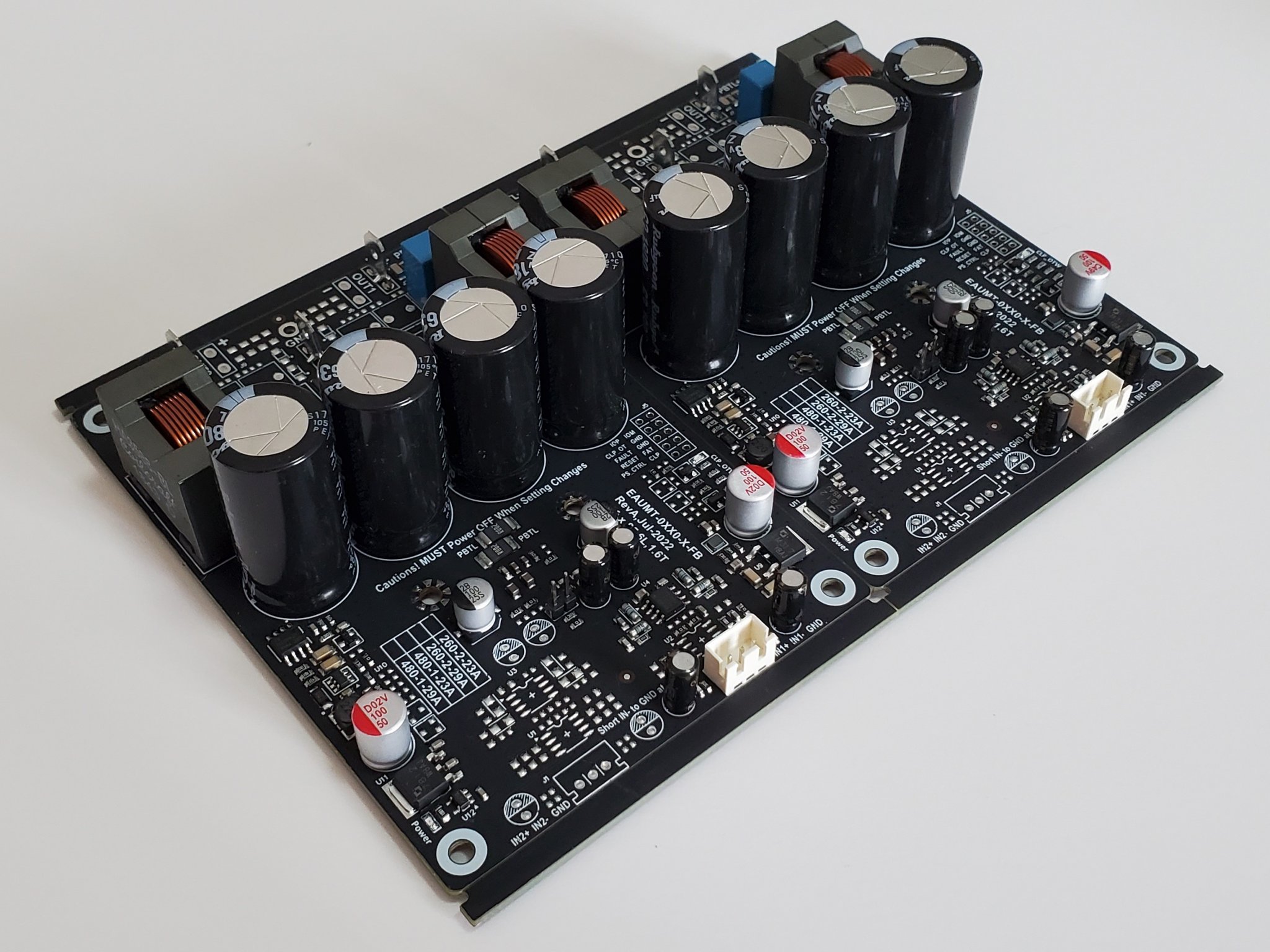

UPDATE: the 3e Audio board production is experiencing some delays. Latest ETA is end of September.
the board finally come out and looks good, i am planning to build heatsink panel and it take another few weeks.
if someone don't need heatsink then you can take it now.
@daniboun you may interesting on this version as you own lots of experience on TPA32xx and other high-end stuff.

Thank you for the update!
Heat sink is a flat plate right? with threads to hook it up to a large plate or housing?
No opamp sockets I see

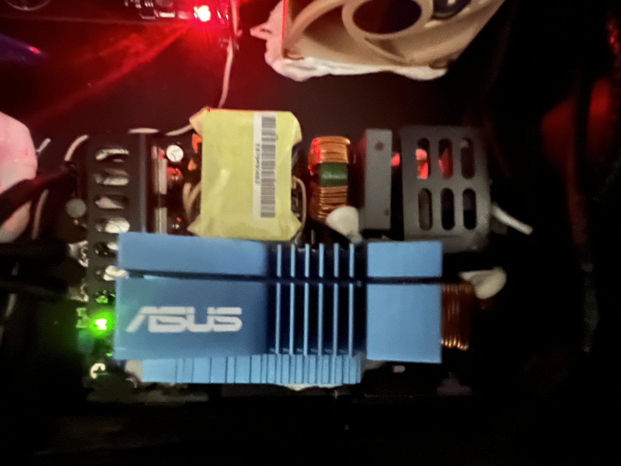

I’ve been experimenting with cooling for my 3e + Meanwell amp build and found that using thermal adhesive I could mount a decent heatsink on the Meanwell and it runs cool even without a fan. Im thinking my final solution will be a single 60mm Noctua mounted to the rear panel in low speed mode to keep some airflow in the case while still being very quiet.
