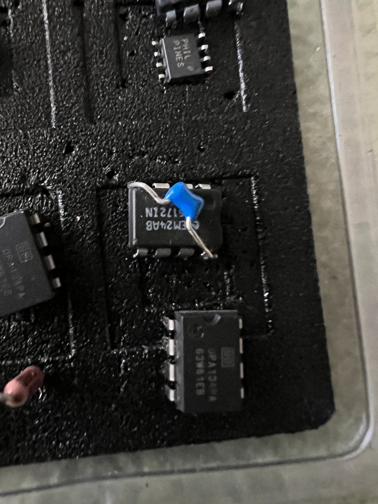

Something must be wrong if you are hearing a significant difference in the sound for better or worse. Maybe the opamp was damaged from soldering the capacitor? What opamp are you using? Any pics?
Opamp is a 1656. I cannot thing it is damaged because is mounted on the socket, Now cap is removed and amp sounds exactly as before cap was mounted. With cap mounted i can hear a very close sound.
I can’t imagine soldering to the pins of a thru-hole opamp is all that risky but a surface mount opamp like the opa1656 is a different story! Soldering the cap underneath the board also has other advantages like keeping the lead lengths super short. That being said I don’t think the capacitor across the power pins is even needed unless the opamp is unstable.
