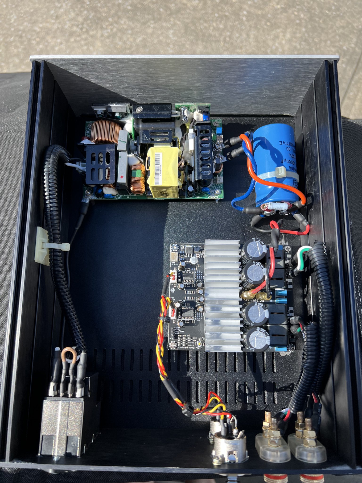

I just finished wiring up my 3e Audio/Meanwell build and I’m pretty happy with the results.
Reactions: Milo

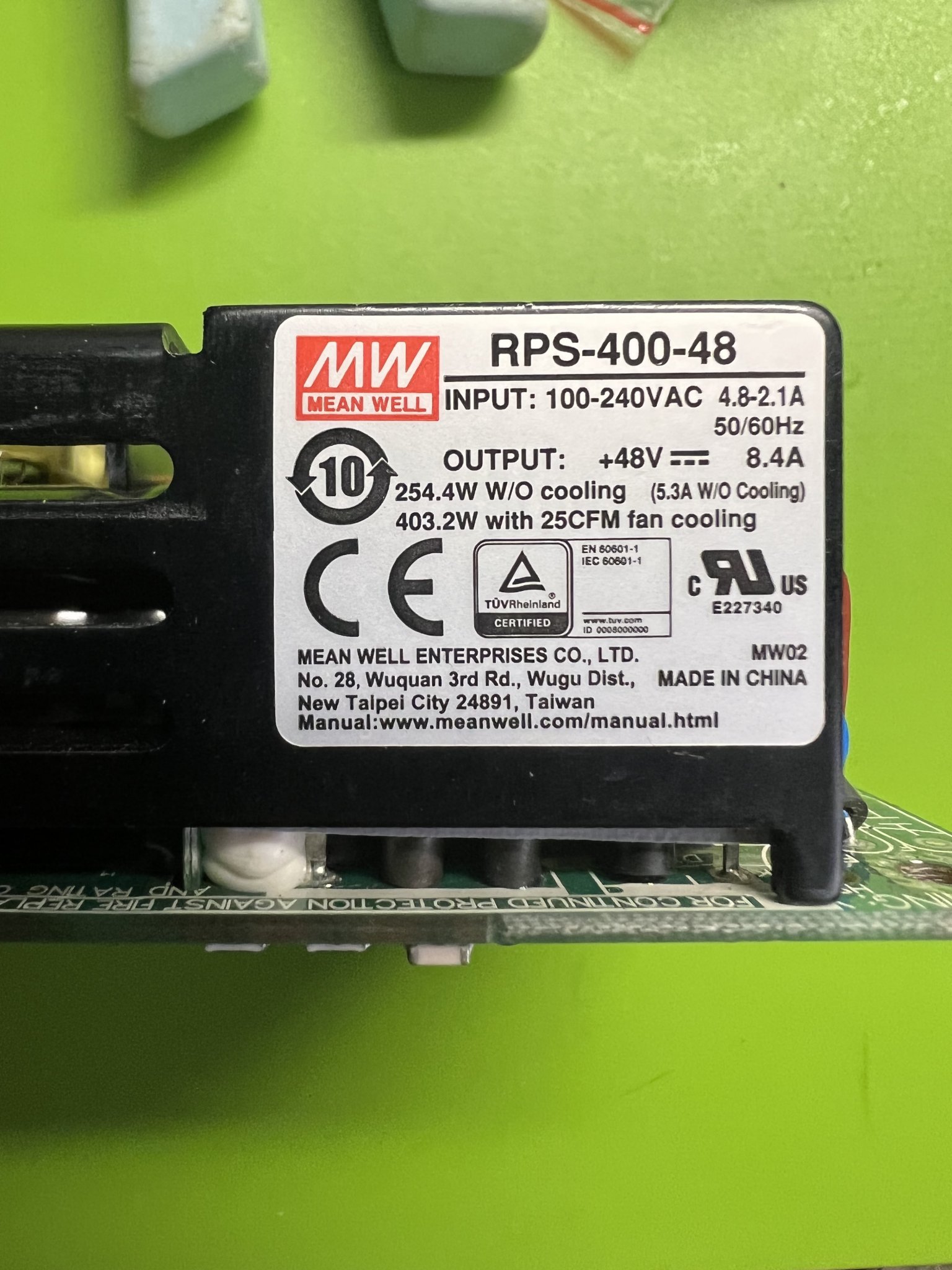

The amp is dead silent and sounds fantastic! I may need to add a small fan though since the power supply gets pretty hot when driving my big 4ohm floorstanders. I noticed the Meanwell rps400 is only good for 250w if no fan is used.
How's the temperature of your 3E? I cannot drive the 3E in a closed enclosure w/o forced air, not at 48V. The amp draws about 130mA in Idle, that's nearly 6W, which translates to ~52C for my ambient temp which is pretty hot right now ~25C. I had to drop to 32V to remain within 40~45C.
I have a similar housing but I'm using a Nobsound SMPS. These types of PSUs, housed in a "half a box" of aluminum, can thermally attach to the side panel which is a hefty heatsink and solve the PSU thermals. I still have a problem unsolved for the amp, the caps are getting very hot and its a bad recipe for the long run. Caps derate badly with temp and this is also bad news for the cap/coil ESR. I think you'll need forced air for the sake of the amplifier at least if no more than the PSU. I'm the same boat and the AC is broken 😎
