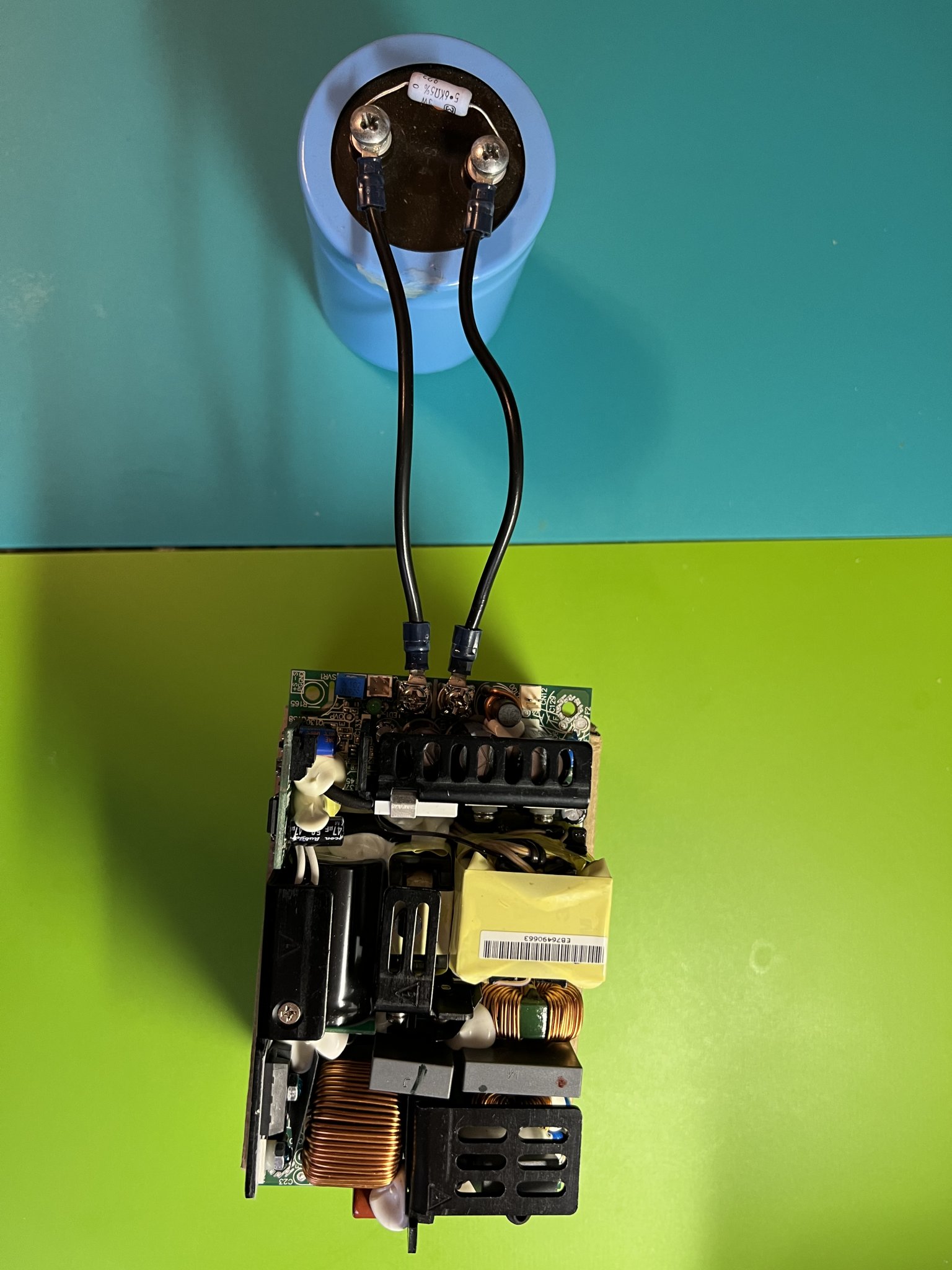

5.6k/2w is for discharge, right?I couldn’t find anything about it in the Meanwell Rps400 data sheet but the power supply seems to have no problem with a 10000uf/63uf cap on the output. Should I still add a 5.6k/2w or so resistor across the cap like I would in a linear supply?
that should be ok if you add 10000uF larger cap.
Yes for discharge. I may try a pair of 10000uf/63v caps and see if the power supply is happy.5.6k/2w is for discharge, right?
I'm still learning about DIY amps, what is the purpose of doing this (caps between PSU and amp)? How is this wired up?Yes for discharge. I may try a pair of 10000uf/63v caps and see if the power supply is happy.
You just wire the capacitor in parallel with the power supply. From the capacitor you run your wire to the amplifier board dc power input.I'm still learning about DIY amps, what is the purpose of doing this (caps between PSU and amp)? How is this wired up?
And for what reason?You just wire the capacitor in parallel with the power supply. From the capacitor you run your wire to the amplifier board dc power input. View attachment 1070541
The capacitor reduces ripple, works as energy storage, reduces bus pumping…etcAnd for what reason?
Not sure about its effectiveness at ripple reduction in this application, but it definitely checks off the other two you mentioned.The capacitor reduces ripple, works as energy storage, reduces bus pumping…etc

Thank you for that explanation. I won't see any real benefit to adding a DC filter with an SMPS. Having a capacitor(s) in parallel with the amp board and an SMPS would probably see some improvement to the amplifier?
