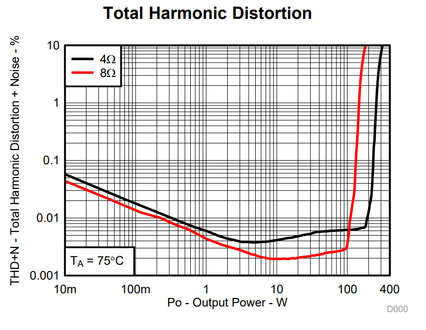

If you follow the trend of the THD curves for 1ohm, 2ohm, and 4ohm, the THD curves decrease in THD for an increase in load resistance. Hence as per the 8ohm THD curve front page, and page 10, i would expect that the 8ohm load has the better THD. You could ask on the TI Forum about this.

Hi everyone! I'm an electronics student from Umeå (Sweden) and I'm currently planning out a project in a PCB course that I'm taking. I'm really excited because I'm allowed to build an amplifier with the TPA3255!! The only downside is that (as you probalby know... ) they are not available on Digi-key, Mouser or anywhere else. So I was thinking, since I have access to a soldering lab, that I could buy a used amplifier and take the chip from there. Buuut, I can't find a used amplifier either...
So I'm wondering if anyone has any tips for me regarding finding a TPA3255 or a suitable replacement. I'm aiming for a stereo class D amplifier that could deliver ~100W into 8Ohms with a THD+N < 1% and an SNR > 115dB. I know these are some difficult goals to reach, but TI has two great papers that I've read on output LP-filters and PFFB for the TPA3255, which is why I choose this IC. It will probably still be difficult, but aim for the stars and land on the moon! An option could also be to find a less powerfull IC and build a dual monoblock amplifier with the IC in a PBTL configuration.
Shadders.
Good analysis! I will look in to it.

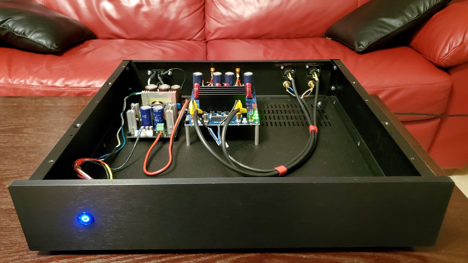

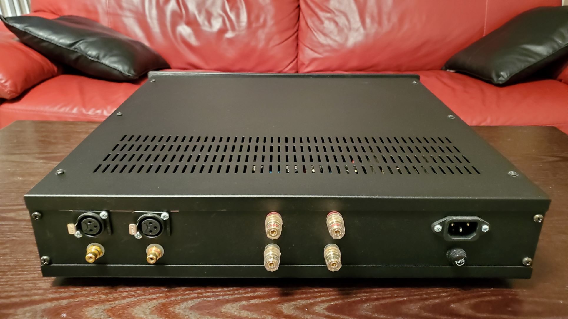

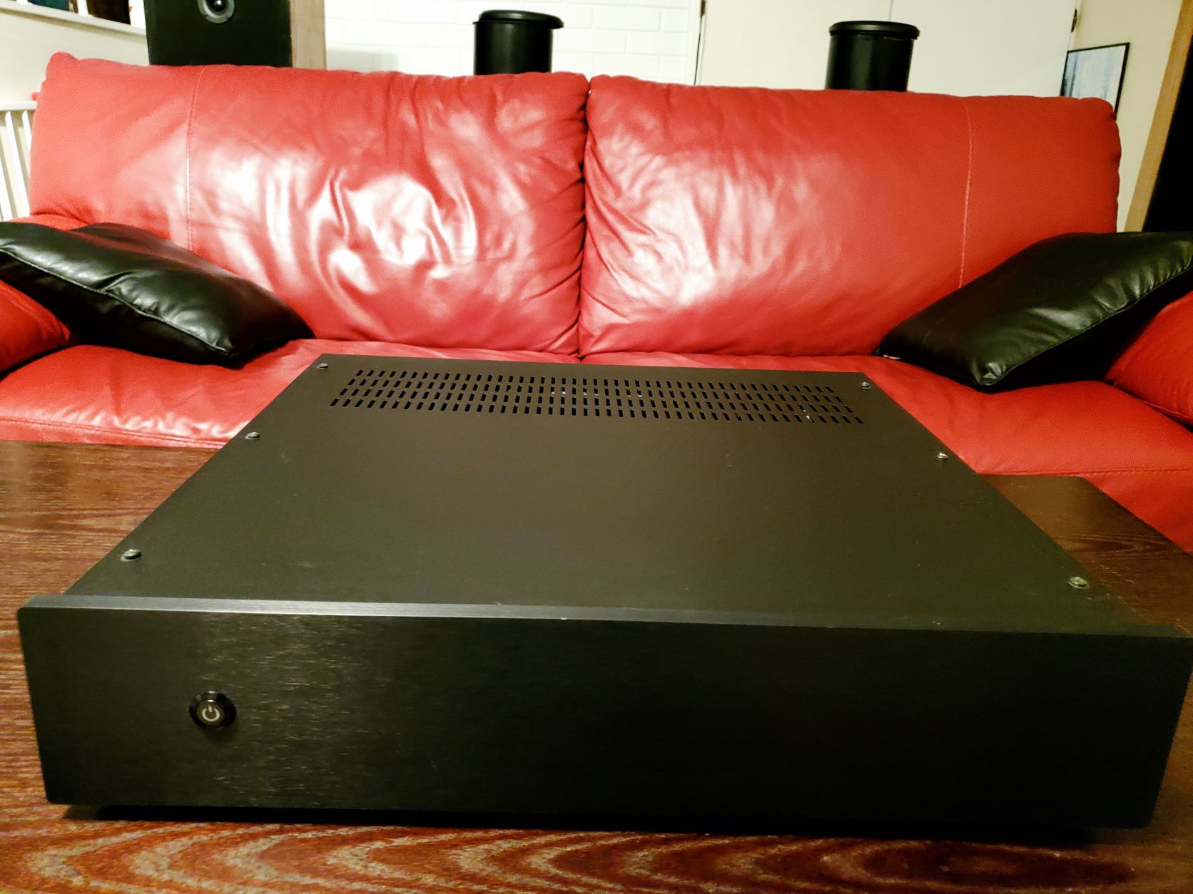

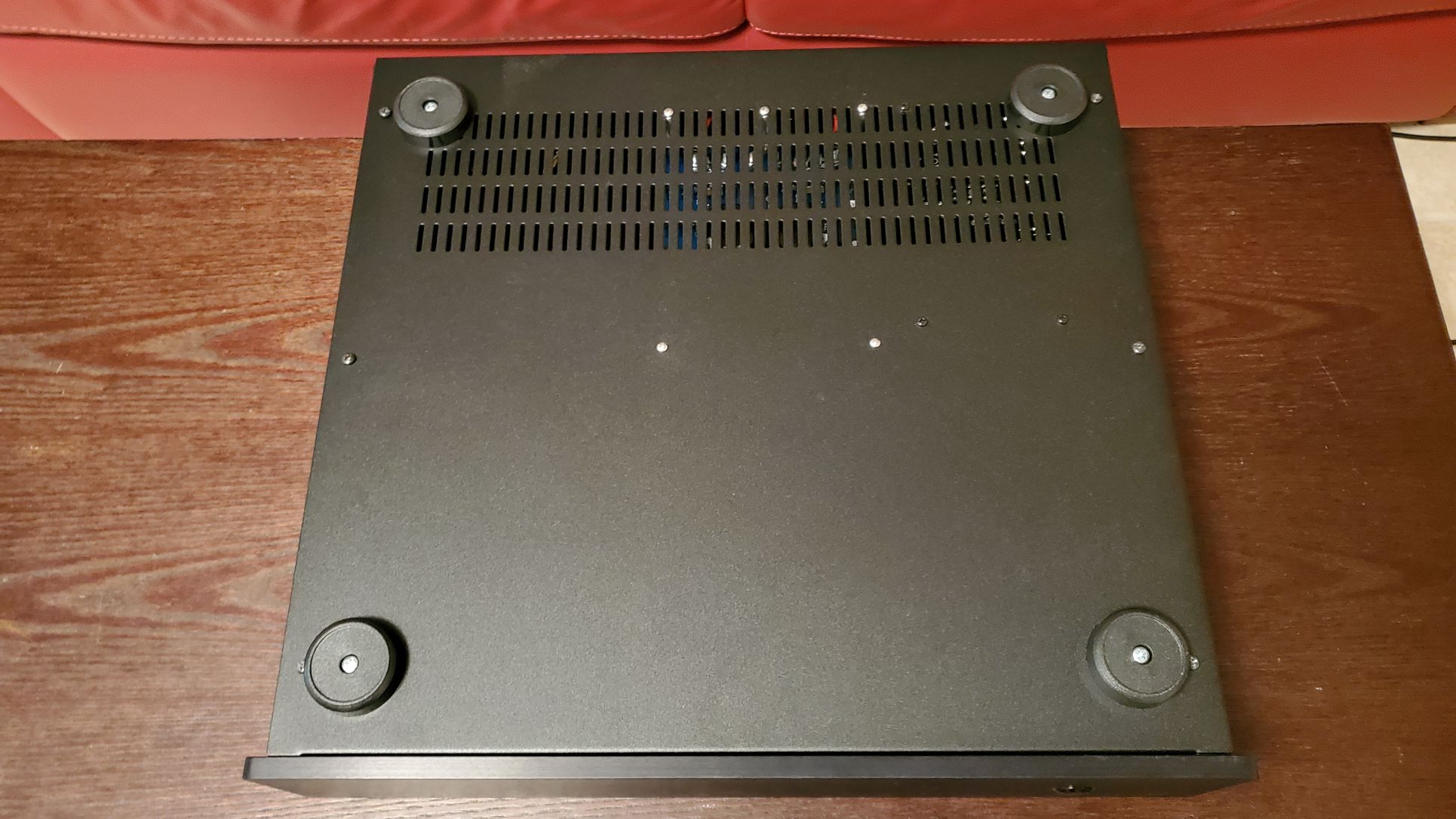

Reactions: ricyuyc
