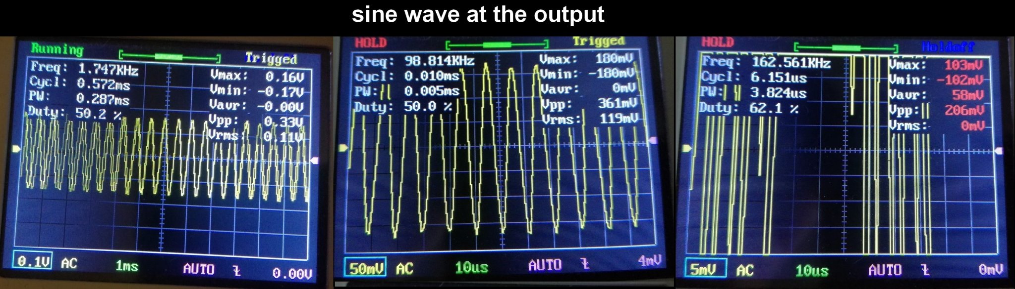

Hello everyone
I have a tpa3255 shui yuan audio board and something strange happened with it.
I will describe it chronologically, maybe it will be easier to diagnose or maybe someone had the same case.
I bought it on Amazon, when it arrived I connected the power from the 40V li-lon battery, connected the cheap test speakers, the signal from the DAC and left it for 100h checking and warming up.
After 100 hours without any failure or burning of the speakers, I connected it to my main listening speakers. It sounded surprisingly well for such a small thing.
I planned to upgrade capacitors, coils and an op-amp and raise the PWM frequency to 600kHz. When all the parts arrived, I started testing:

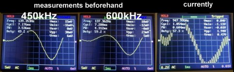

-I connected the oscilloscope and checked what noise is at the output and what the music signal looks like at the output.
Noise was absolutely minimal, the musical signal had visible steps.
-Then I soldered the Freq_adj resistor from 30k to 10k to get PWM 600kHz.
-I checked what came out on the oscilloscope - the noise is still low, the music signal has smaller steps - I think it's better.
-During the tests, I had a laptop connected as the signal source. Unfortunately, my laptop has a problem that sometimes when I click on a track to play it makes a loud pop when it starts up. Several times this happened, loud crackled loudspeakers (loudspeakers did not burn) and the shui yuan audio board entered fault mode several times and required a reset.

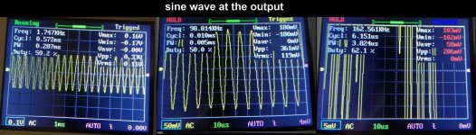

-After these few fault modes, a constant sine wave of about 100kHz and 300mV appeared at the amplifier output.
-When this sine wave appeared, the only modification of the board was the change of the PWM frequency from 450kHz to 600kHz and the replacement of some power capacitors.
I sit on it for a few days and I can't find the reason. Currently, I replaced the inverter XL7015E1 with a linear power supply for LT317 12V, replaced the 1uF SMD capacitors on PVDD_x gates, replaced the 1uF capacitors behind the coils, added 0.1uF on the op-amp power feet. The amplifier is powered by a 40V battery, so it is not a derivative of the power supply. Unfortunately, the sine wave at the output is still the same.
Is it possible that entering TPA3255 into Fault mode causes some damage to it and therefore I have a sinusoide on the output ???
Theoretically, the TPA3255 chip has implemented security measures that prevent it from being damaged.
I read on other forums that these amplifiers have noise and PWM residues on the output, but my board did not have it, it only happened after the unfortunate connection of the laptop, clicks and the Fault mode
Maybe other elements have been damaged? Eg BST_x gate charging capacitors 33nF? I don't know how to check them. I checked with the meter and there are strange voltages, e.g. 83V, 93V, 100V.
Or 10uH coils? Is it possible?
Generally the amplifier works, plays music normally. Despite this sine wave at the output visible on the oscilloscope, I do not hear any distortions or noise in the speakers.
Voltage:
PVDD 40V,
GVDD and Vdd 12V,
DVDD 3.29V,
AVDD 7.76V (when reset: 0V),
VBG 1.2V,
Freq_adj 0.81V (10k resistor).
on the speaker terminals is 19V measured to power ground.
I will be grateful for any hints.
