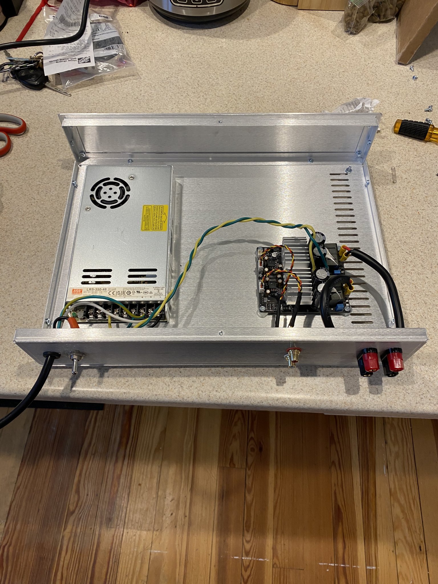

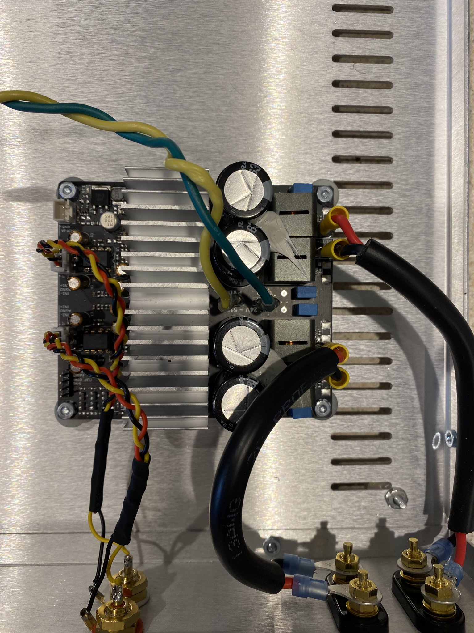

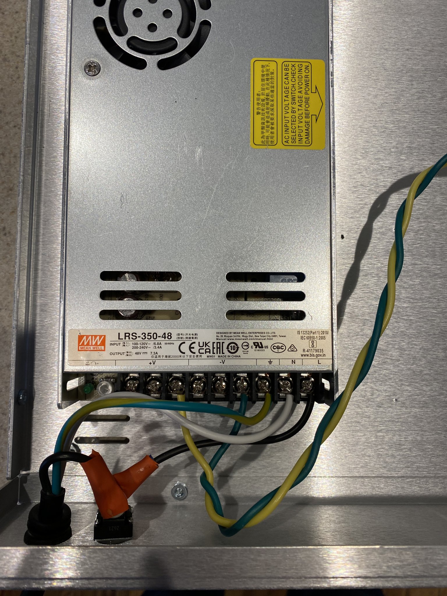

Hi everyone! First post here, but I’m active on Reddit and Audiokarma. I assembled this amp with a 3e TPA3255 board and a Meanwelll lrs-350-48 power supply. So far it sound great, but I’m getting 2 quick popping noises on power up. It’s not crazy loud, but enough to startle my dogs. Just wondering if this is normal or not. Thanks!
Should not Pop... this is a 3E Audio module as I we can see.
Give a try @ 36 / 38V very max and keep us posted...
