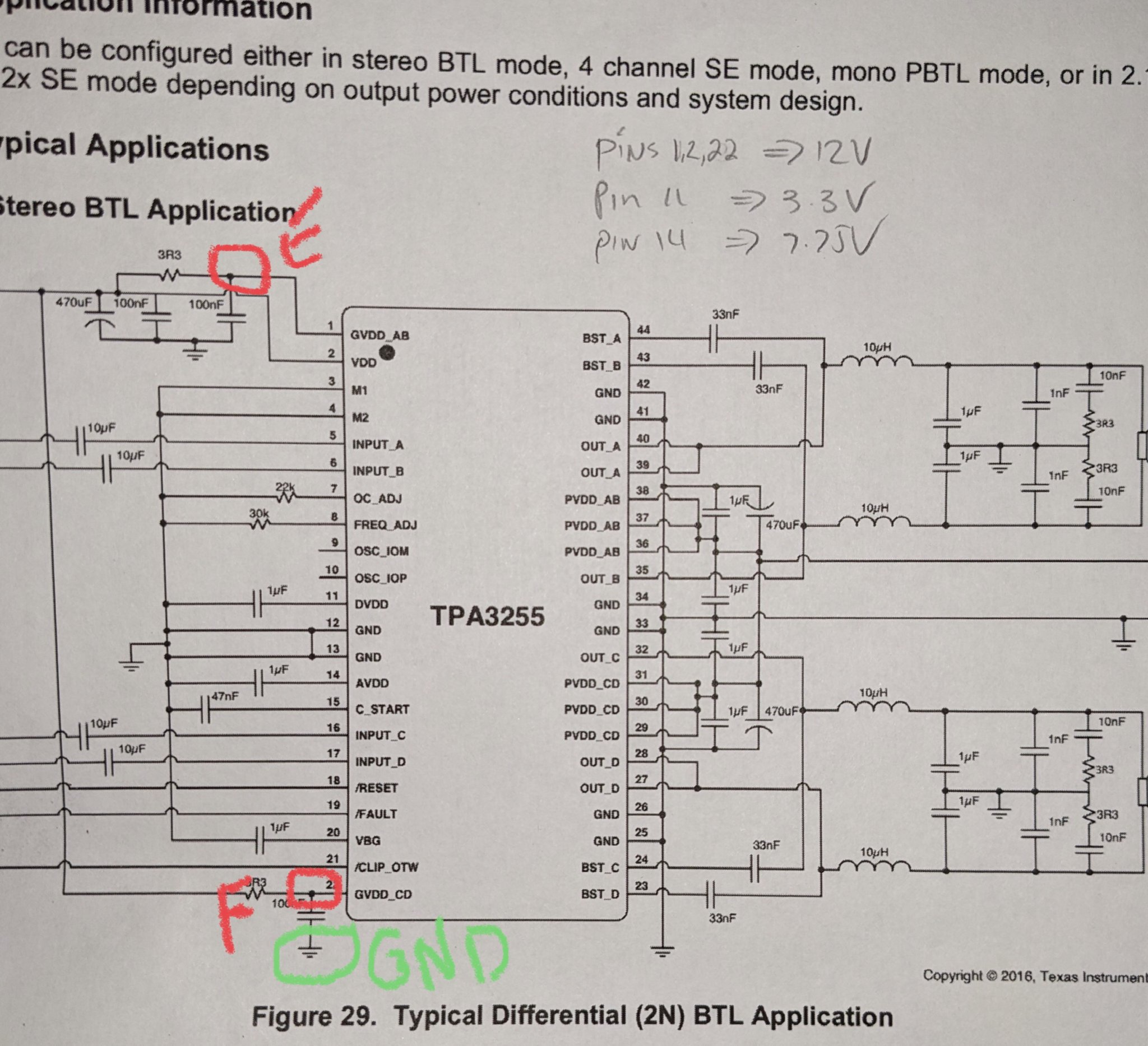

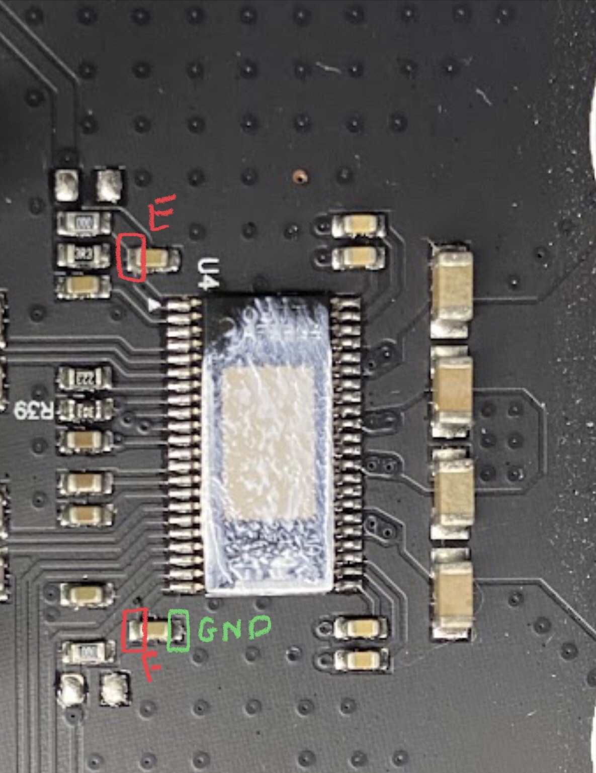

I'm not sure why "C" is not showing any voltage. I believe the voltages measured at "B" & "C" are generated by a regulator circuitry internal to the chip while "A" & "D or E" have to be supplied external to the chip. I'll have to read the 3255 datasheet in more depth. Let's try something simple. If you haven't tried a RESET of the amp let's try that. All you should need is a SPST momentary push button between the reset pin and ground pins on the board (if you've got steady hands you could just use a piece of wire as a jumper). The board must be powered up when doing the reset.
Thank you turion64 for your help so far.
I had already tried resetting the amp by grounding the RESET pins. I did it once again by holding the RESET ping while powering up the board before retaking the measures. The measures show the same as read previously and there is still no sound.
Also, C - GND is actually not 0 but more like ~5mV.
The TI datasheet says the reset + ground only has to be held for 1/4 sec past power on and then disconnect the reset + gnd connection.. This is what you did, correct? If yes, try again anyway. If still don't get approx 7vdc out of "C" it sounds like the chips internal regulator for its analog circuitry (AVDD) is bad.
Yes, did exactly as you described for the RESET pin. Remeasured again, still ~5mV out of C.
At this point, unless any of the other forum members have any insights, you may to to contemplate replacing the 3255 chip, if you have the ability to do so. I guess you can try contacting 3e Audio's technical/customer service via email but I heard frustrating stories from other folks. Sorry we couldn't get the amp going for you.
Pete
If you just wanted to see (just because ) you could measure "E & F" points (GVDD AB/CD) to make sure they are receiving ~12V as well. I think I marked the ground correctly this time.
