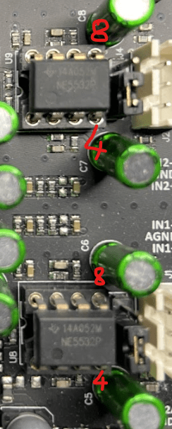

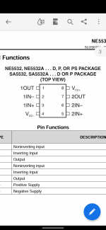

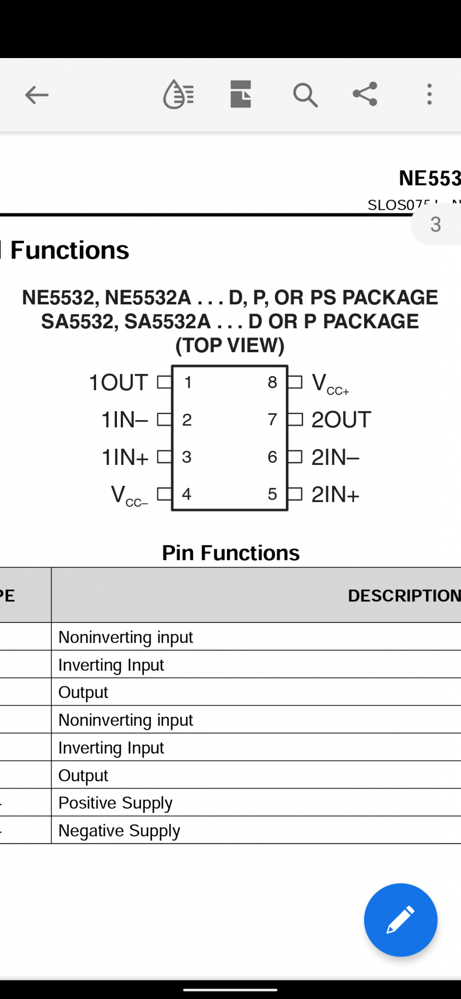

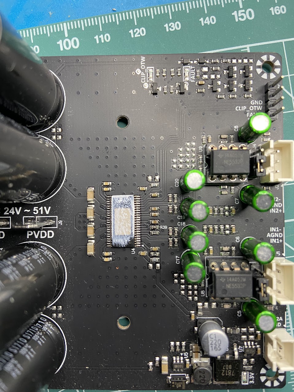

Are there any opamps in their respective sockets?
These ones you mean. They are the stock ones.

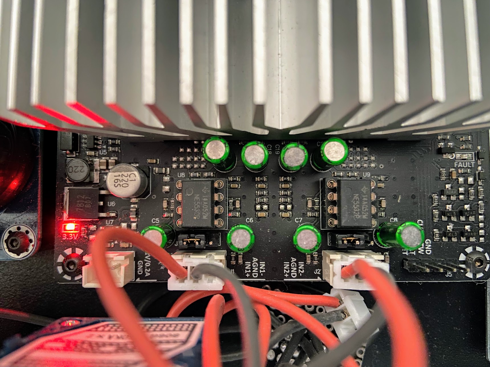

Sure you have power in?Don't see the power led light.
The mains switch was off while fiddling with the cables on the first pictures. See on the above picture the power led light does switch on.

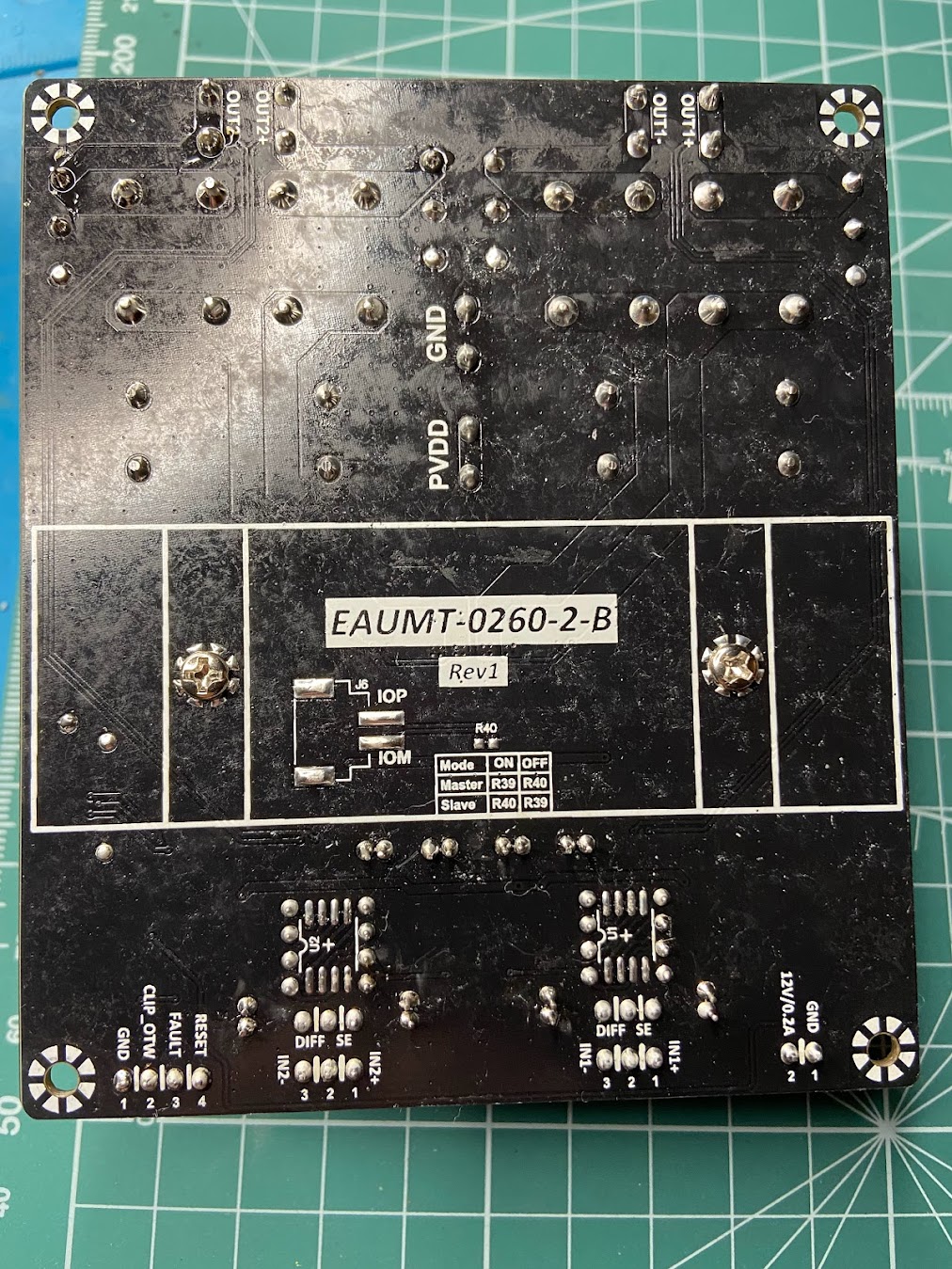

Take the board out and take a good picture of the under side. Let's see if some bad solder joint can be spotted. Then take the heatsink off and see if anything glares out at you.
Any luck teubell?
I removed the board from the chassis and unscrewed the metallic risers as Solve was suggesting. The board is now literally floating. Still no luck unfortunately, absolutely no sound coming out from the board.
I flipped the board around as you suggested but I don't really see anything shocking here.
Everything seem to look good underneath the heatsink doesn't it

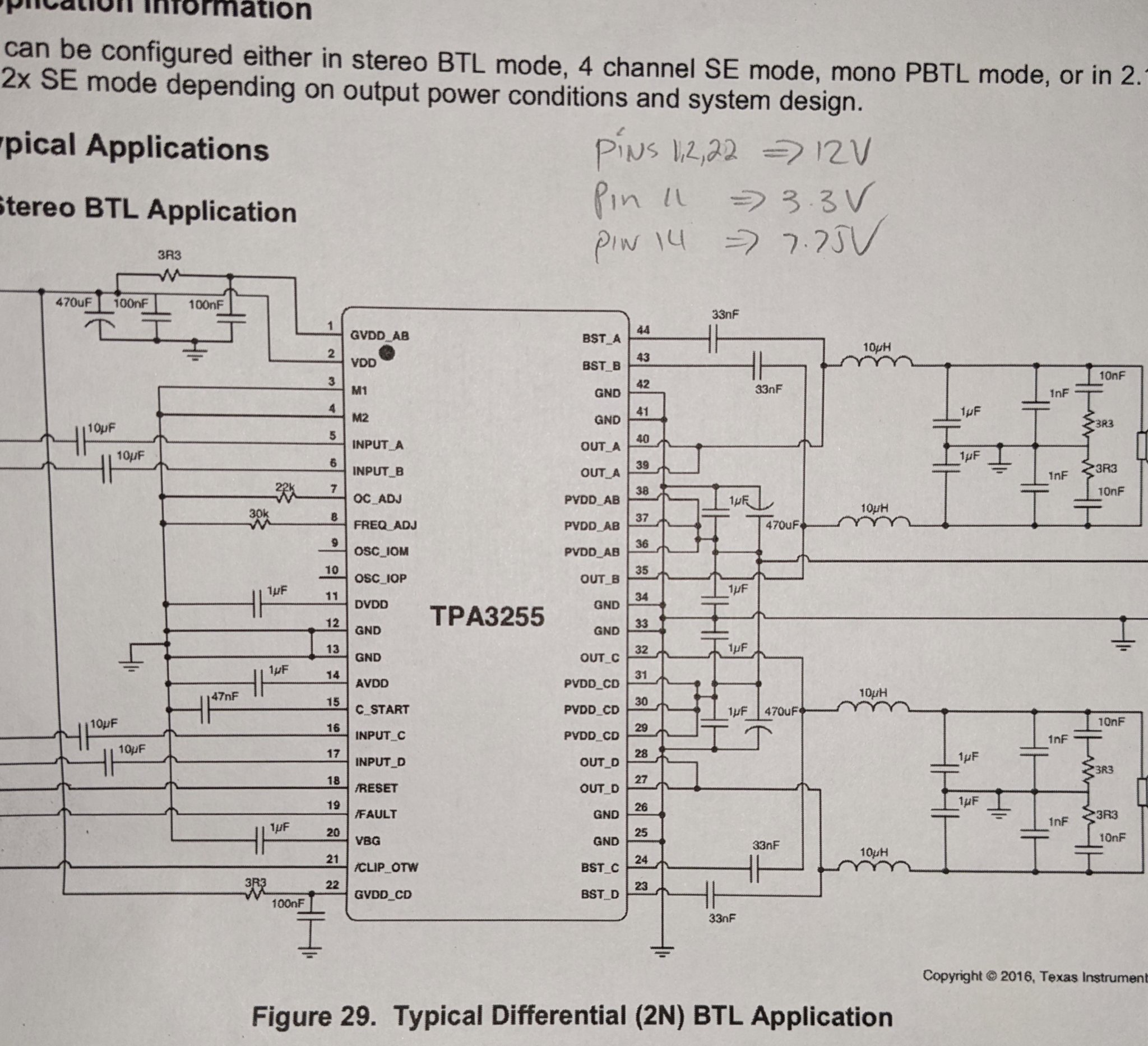

teubell, do you have a volt-ohm meter to check voltages going into the opamps (pins 4 &8) & into the 3255 (pin 2 & 12or13) chip? Be very careful on the 3255 chip not to short other pins. Someone check my 3255 pin choices..

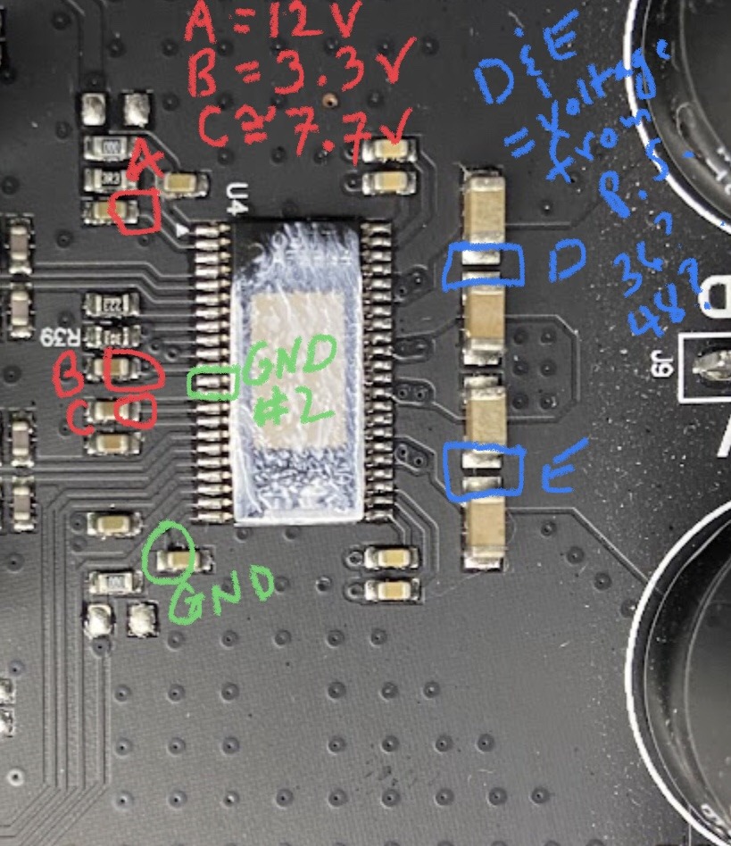

Ok, I tested voltages on another 3255 amp (w/o the heatsink on) and highlight testing points that should be on the 3e board. I was using a 48V PS to powered the board. If the 3255 chip is working it should get it should get very warm to the touch (I tested with no signal in and no load on the speaker outputs). If it doesn't get really warm it may be dead.

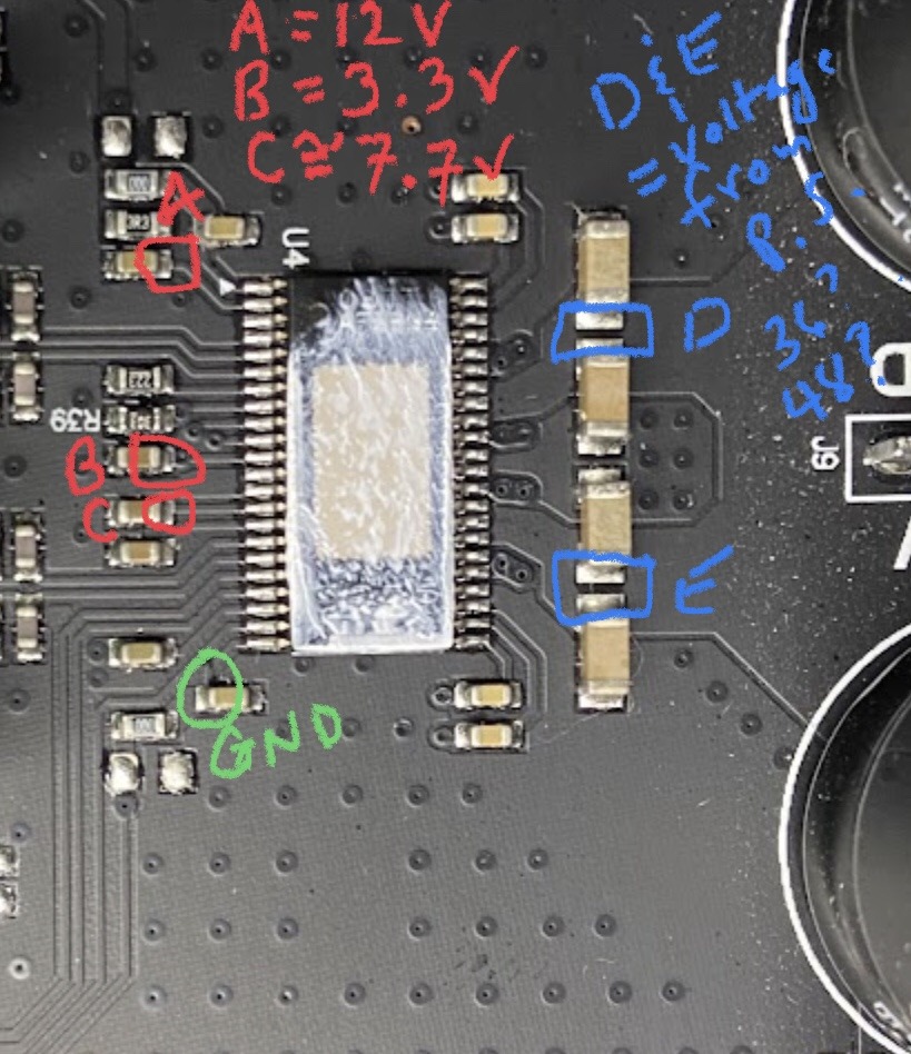

We might have something here, below are my measure readings according to your notes:
A - GND: 0V
B - GND: -12V
C - GND: -12V
D - GND: 24V
E - GND: 24V
My power supply is 36V. Measured between PVDD and GND on the board we actually read 36V.
Everything was measured with all inputs and outputs disconnected.

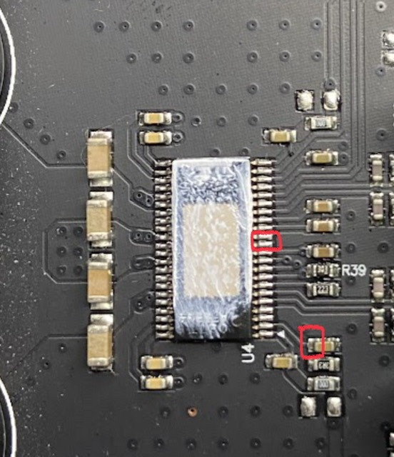

Ok, let me actually measure my 3e audio board's voltages just as a check. I'll check backwards and see where the 12V source is soldered on the board and where it's possible to check it with normal probes. This will a day or two. But, using GND#2 this time (as my as the capacitor coming off pin #22 is oriented differently) check for which side of the cap (off pin 22) is going to ground. With the power off, use your continuity setting on your meter and check for continuity between pins 12&13 and both sides of the capacitor (original GND in green). Whichever side of the cap gives you a signal with pins 12&13 use that side as ground and remeasure all the other points against it. The alternative is just to use GND#2 and re-do all your voltage measurements. I was just trying to keep you away from the 3255 chip with power flowing in. The original GND may have been the wrong side of the cap. Apologies
The continuity measure shows indeed that GND #2 and actually the other end of the cap off pin 22 are connected.
Using the other end of the cap as GND the measures now show:
A - GND: 12V
B - GND: 3.3V
C - GND: 0V
D - GND: 36V
E - GND: 36V
I'm not sure why "C" is not showing any voltage. I believe the voltages measured at "B" & "C" are generated by a regulator circuitry internal to the chip while "A" & "D or E" have to be supplied external to the chip. I'll have to read the 3255 datasheet in more depth. Let's try something simple. If you haven't tried a RESET of the amp let's try that. All you should need is a SPST momentary push button between the reset pin and ground pins on the board (if you've got steady hands you could just use a piece of wire as a jumper). The board must be powered up when doing the reset.
