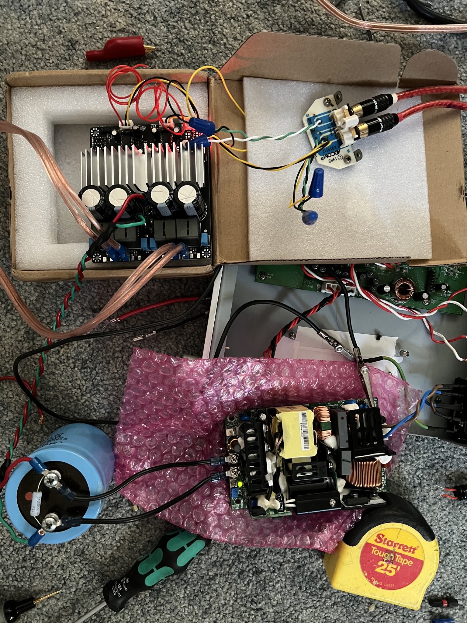

My 3e Audio Tpa3255 board was waiting for me when I got home from work today:giggle: Please excuse the messy temporary setup but I just had to hook it up and see how it sounds and must say I’m pretty impressed with how powerful this little amp is! Just for shots and giggles I decided to try a big 23000uf/100v cap on the output of the Meanwell Rps400 and it starts up, works just fine, and sounds great!
pitbul
2011-07-29 9:34 am
Ok, be careful with capacitors on dc side, there are lot of explanation about that on this forum.
Sometimes it is not so good to add extra cap, switchers are fast response device and it will better regulate output voltage with capacitors placed with design. Energy flaw is also satisfied with good voltage on dc side...
