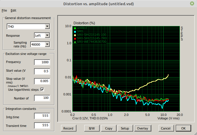

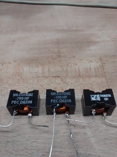

Do you mean Wurth's inductor?
Meanwhile I measured THD @1kHz of WE7443630700 and its ferrocore counterpart. It can be seen that both 7uH inductors are quite similar and excellent, they will not degrade THD of TPA325x significantly. Max current excitation was in the ballpark of +-4Apeak. But the 10uH version shows significantly increased THD level. Measurements were carried out with EMU-PreTracker USB-soundcard, my personal reference latFET-class-AB amp and a low inductive dummy.
