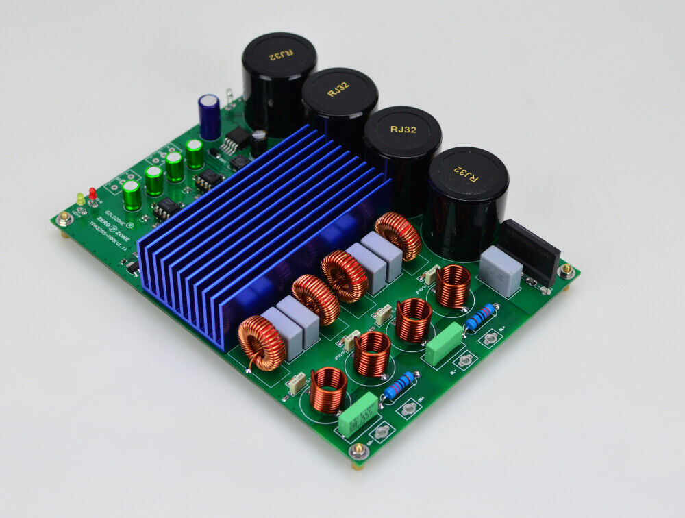

Danny (on this forum) has experience of this board !! The first time it was plugged in the 12volt regulator burnt out. Manufacturer only used 40volt regulator components on a 48 volt board. Also inductor values in the Power Supply appear to be wrong and hence overloading the regulator !
So if you buy this board expect to do some reworking before you attach to Power !!
Danny has it working now after replacing some components so can probably tell us what it sounds like.

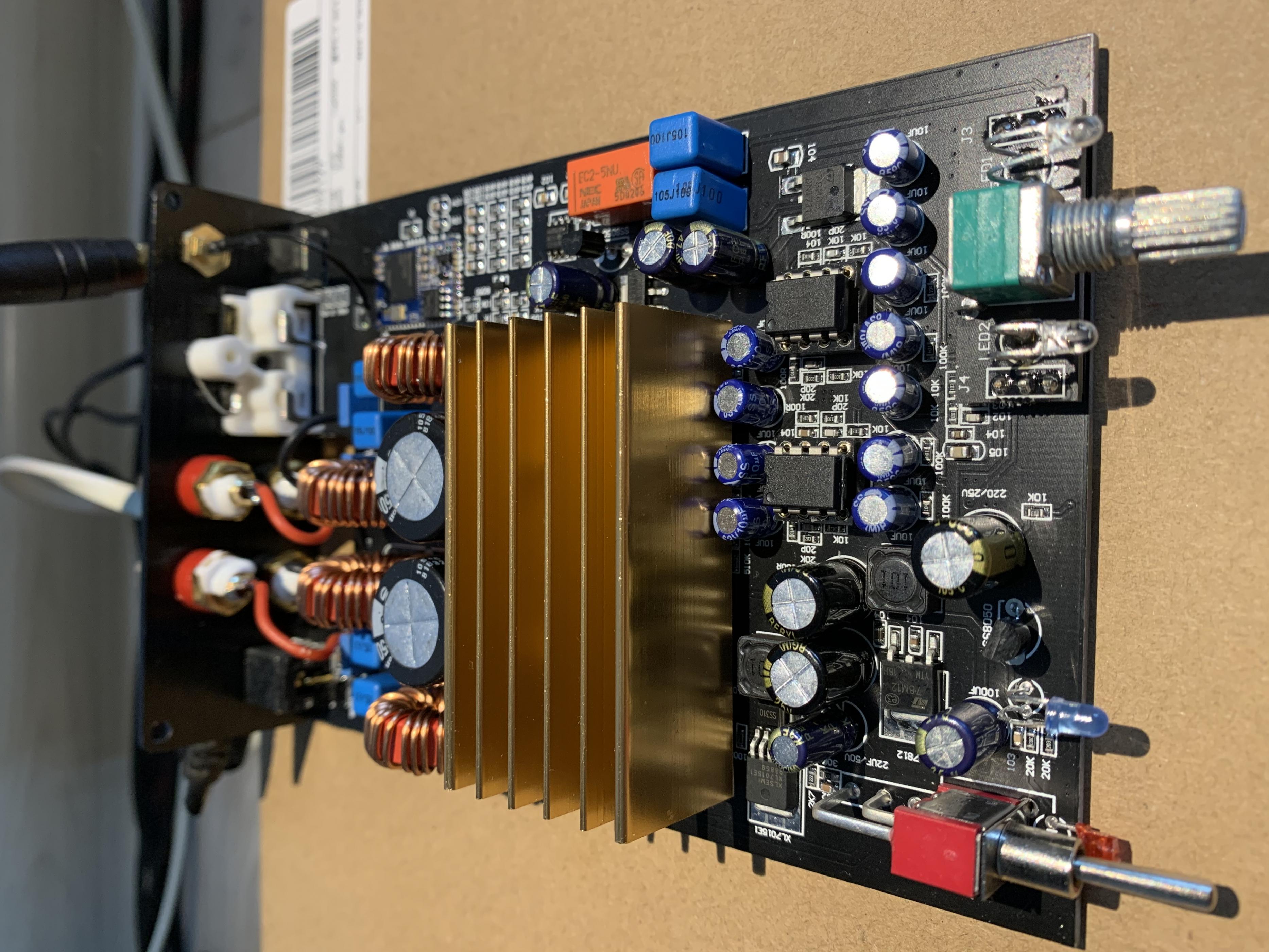

On the Aiyima A09 TPA3255 unit, I have this same unit without the Anti-Pop circuit and yes it makes a big noise when turning on and off with the front switch ! If you turn the power off and on to the power supply there is almost no noise. The latest release of the PCB In this model now appears to include the Anti-Pop circuit and is identical to the Tilear Aiyima A04 TPA3251 model.

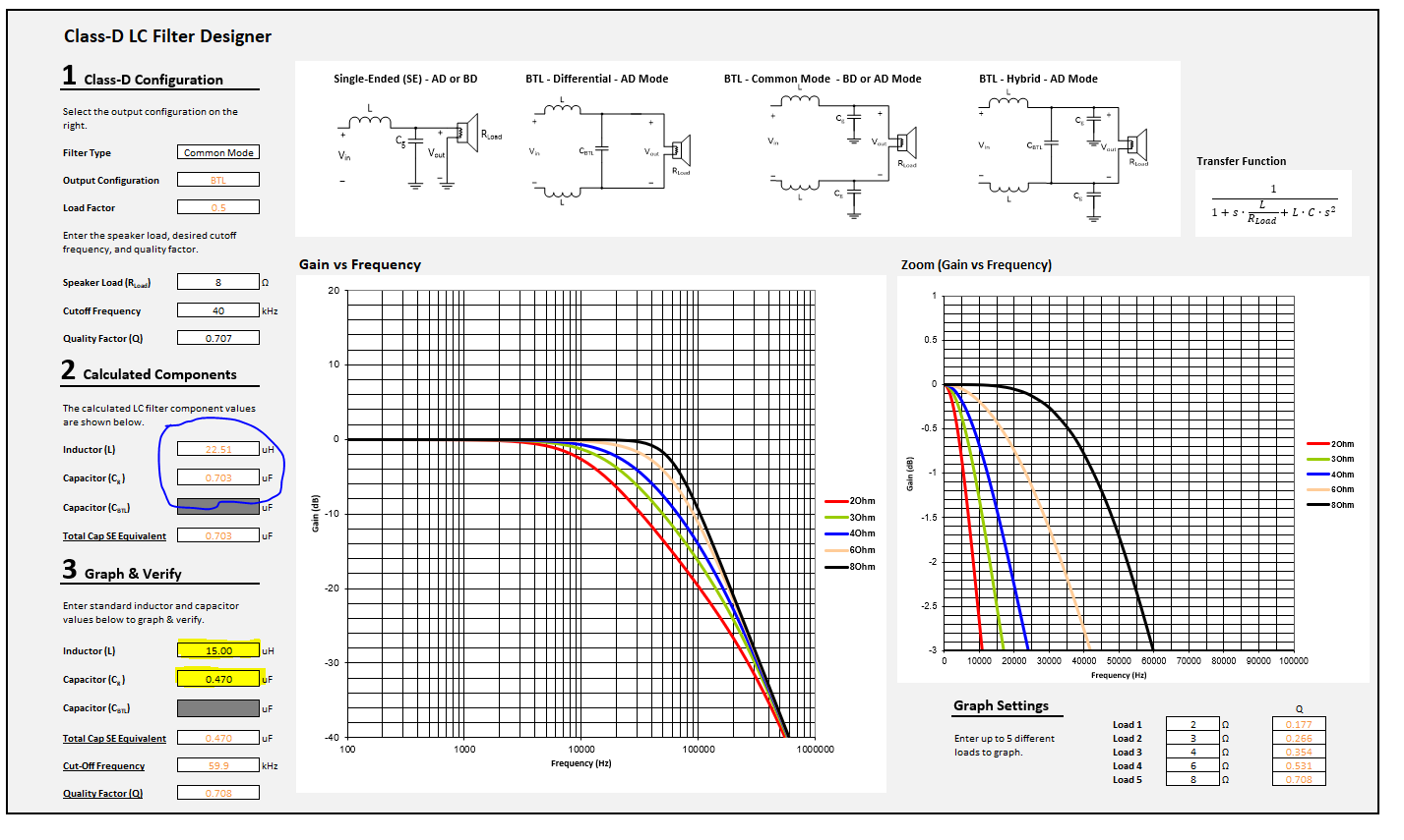

Is there anyone that replaced the inductors on Aiyima TPA3255 with some fitting alternatives and what was the selected models. I read all the 220 pages but couldn't find much for 8-Ohm cases except for the values.
According to the posts for 8-Ohm speaker i should use 15uH and according to the Ti calculator 22uH with different caps (0.47uF or respectively 0.68uF) assuming that i chose the right filter type.
Both options seems to work fine but i was wondering if anyone can share their experience will be much appreciated.

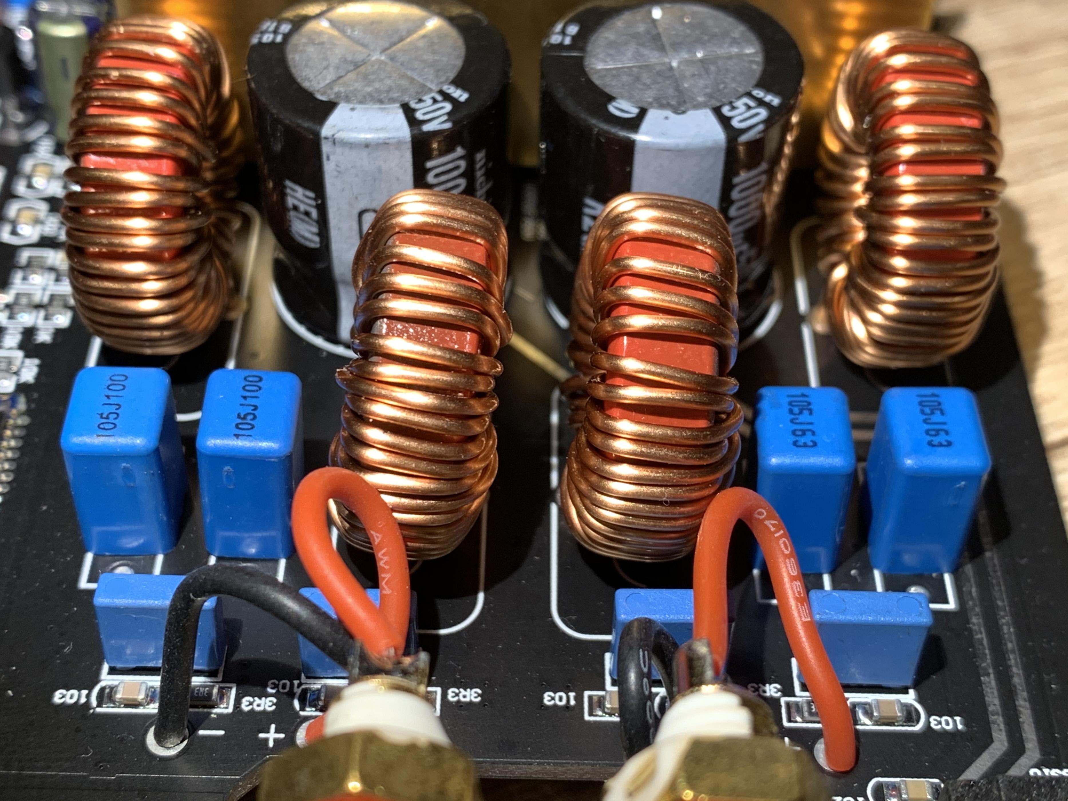

I have both the Aiyima TPA3255 and TPA3251 based amplifiers.
I believe the standard inductors are 12.5uH and the output Caps are 1uF.
I drive some KEF UniQ speakers that have a nominal 6 Ohm impedance. Seems to work OK with these but then I have not tried any output Filter modifications - There is so little space to play with. That said there is one guy who created a new piggyback board to replace the whole of the output filter and Power Supply Caps side of the TPA3255 board. There are pictures earlier in this thread.

I changed the values of the inductors to match my speaker impedance as I know I won't be using any speakers with lower impedance in the future. You could change those inductors for a higher one if you are sure about that too. Using any speakers with lower impedance than that will trim part of the audible range which is something you do not want.
Does your speaker have any impedance curve chart? You could see what the impedance is above 1kHz if it's above 8ohms for the entire range then you are good to go. Make sure that you get inductors with a sufficiently high saturation current.
