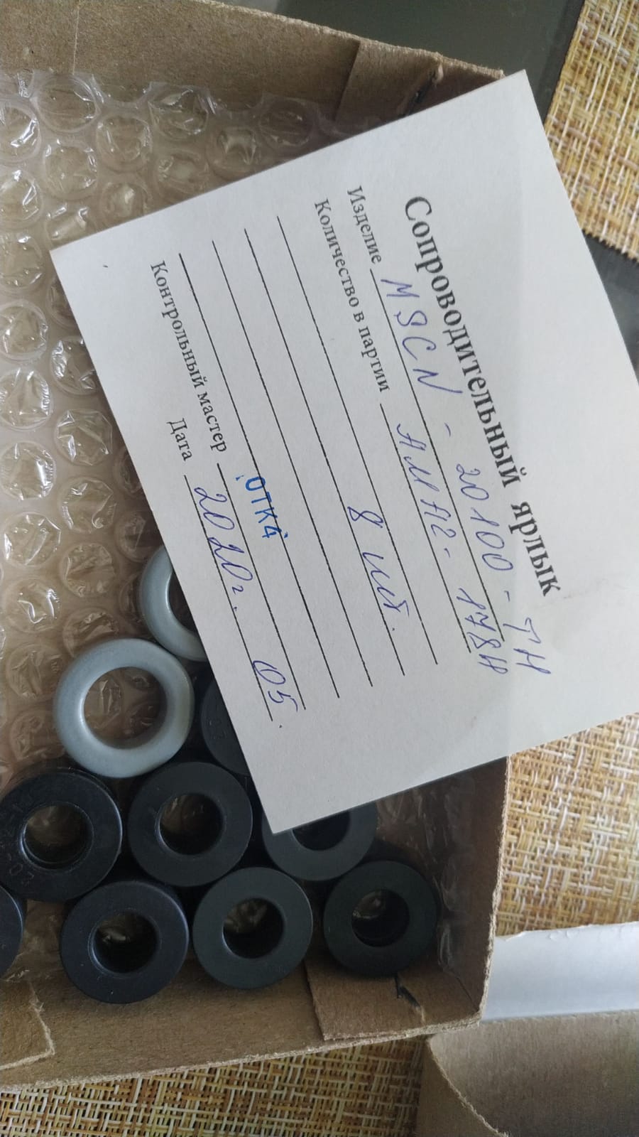

I bought nanocrystalline cores, I'll try in the next amplifier. Wurth experts say they are better than ferrite
I know nanocrystalline toroids from Vakuumschmelze. With their ultra high permeability these are excellent wideband transformers and common mode chokes. On the other hand the closed magnetic circuit makes them useless for storage chokes, which is our focus here. Or are there gapped nanocrystalline cores available now?

Thank you for that link. Gapped nanocrystalline is really new to me and looks quite promising. This may be the superior material actually.😎Black, Al 250
Manufacturer Welcome! | ПАО <<МСТАТОР>>
