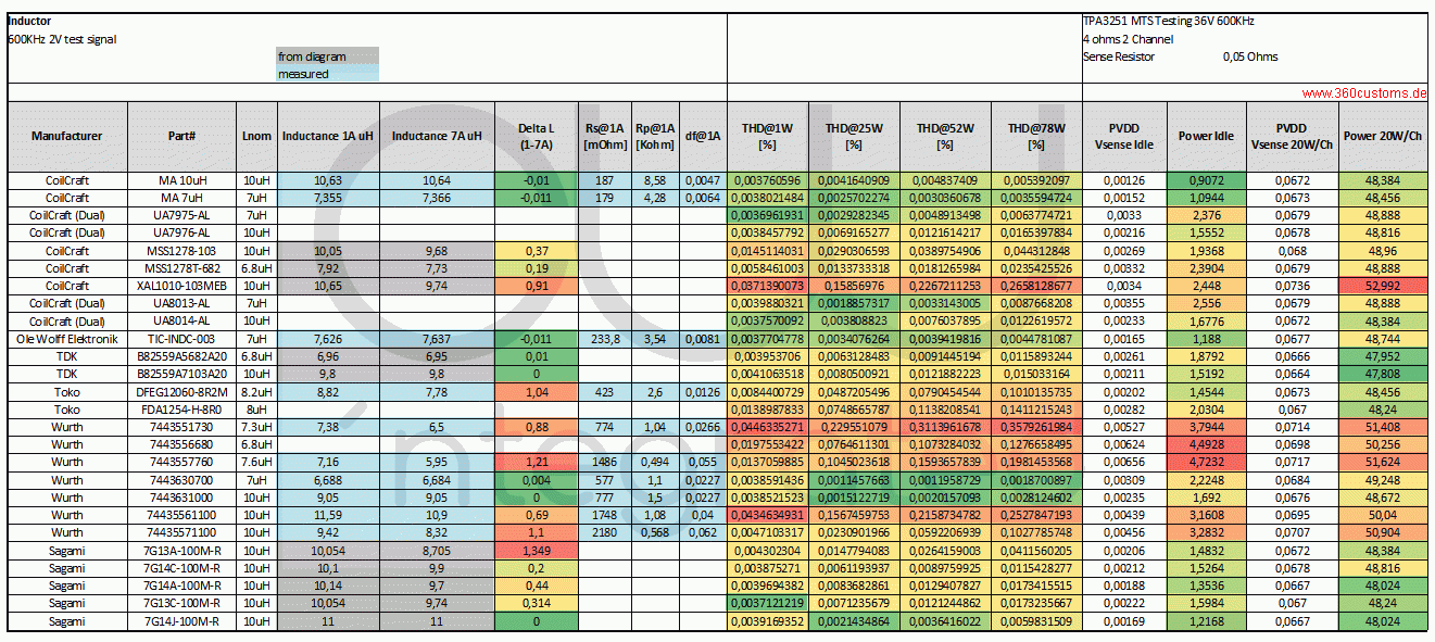

Did similar measurements with readily wound inductors and ended up with gapped ferrite pot cores like WE744363xxxx
Customs 360 has compared below a few inductors with TPA32XX chip.
As you can see, inductors with "flat wire" perform better.

All in all we can conclude that distortion of TPA325x designs is dominated by the output inductors so it is a good idea to look for the best ones. There exists a TI appnote comparing measured THD of different chokes confirming this.
Yes correct. Logically only one solution. Inductor is the key, we need to custom make instead of waiting for big companies to care about SQ

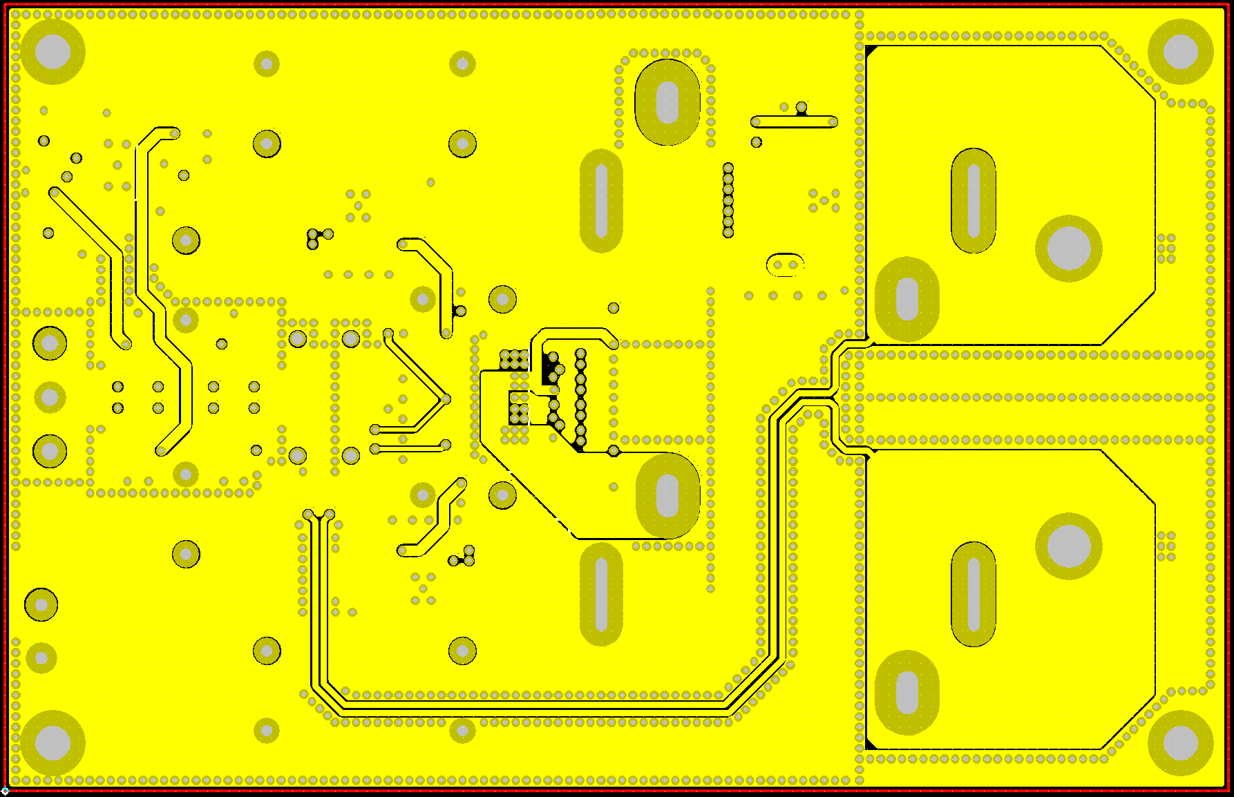

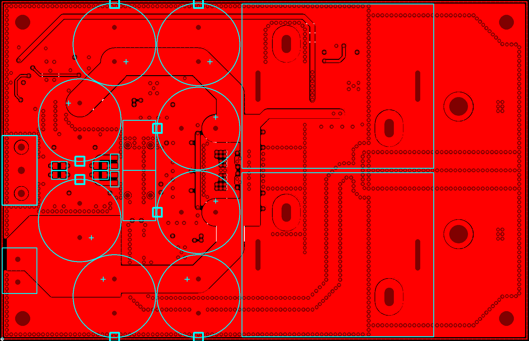

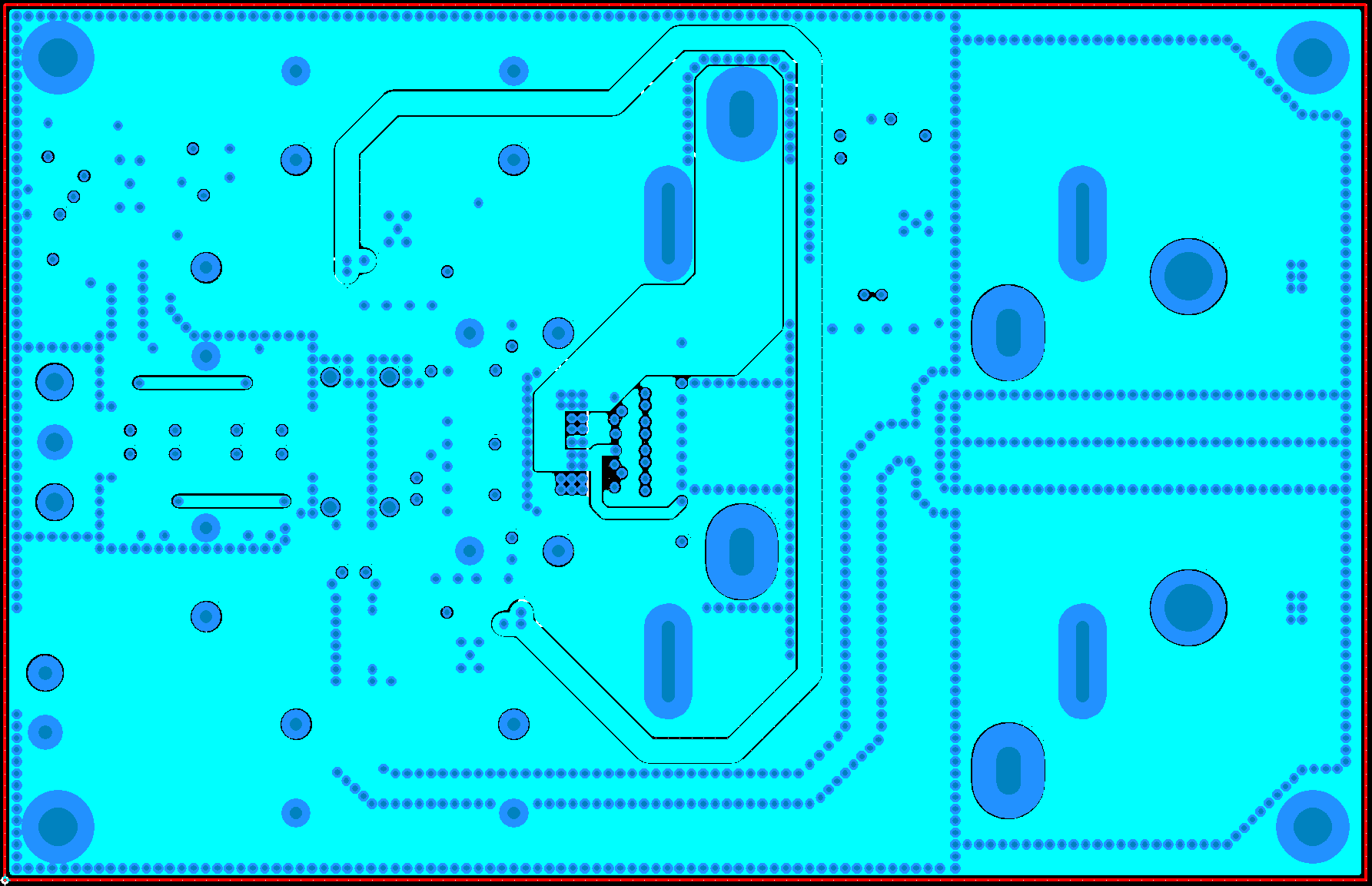

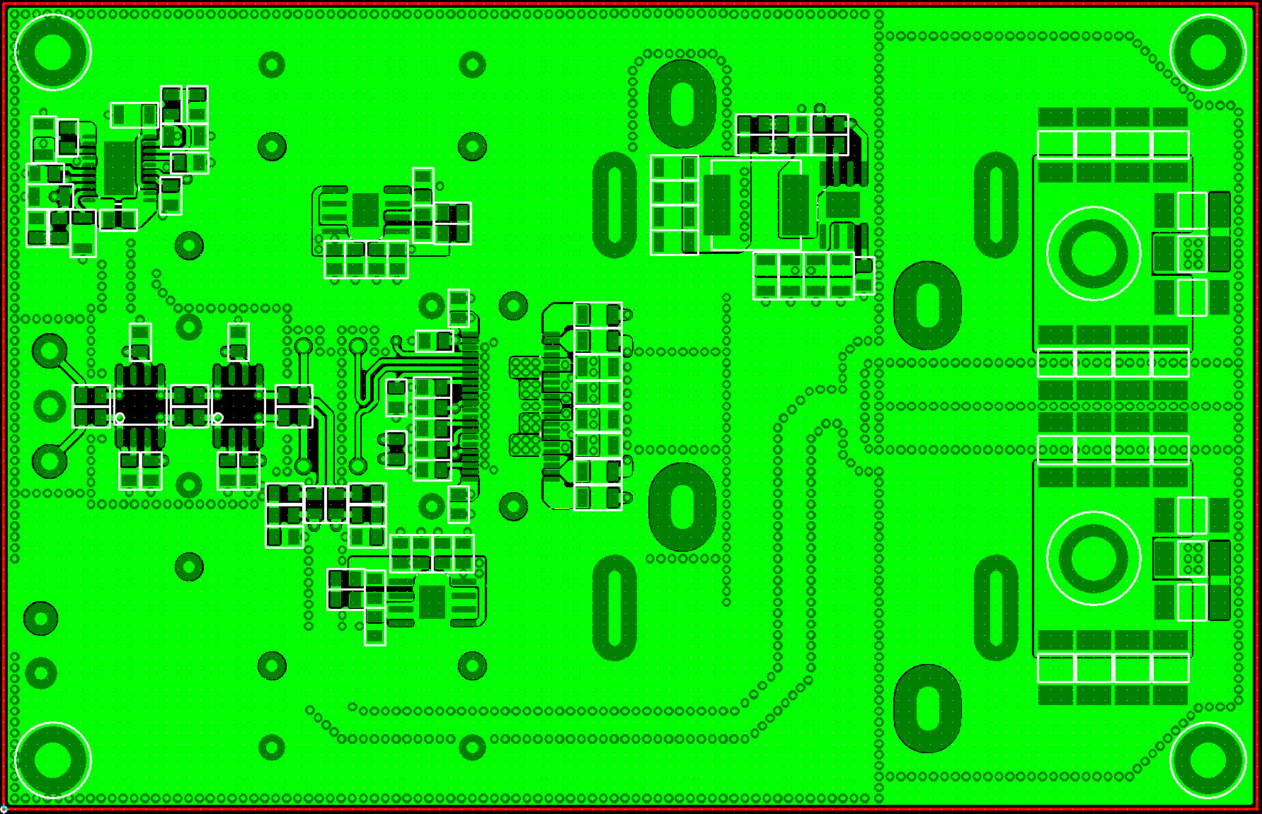

Hi cdsgames,
Yes, there is a full GND pour on all 4 layers that covers the entire PCB. These GND planes are via stitched together around the entire perimeter, and there are also local via perimeters around noise-prone nets like the pre-filter amplifier outputs, and the post inductor outputs prior to hitting the final output filter caps.
All of these traces have GND planes both above and below them, and the aforementioned perimeter stitching.
I will attach images of each layer with the GND pours on and hopefully they will make it a little more clear how everything is connected and placed.

Thank you for the kind words! I appreciate you taking a look at the layouts. To answer your questions above:
1. Yes, it is 2 OZ copper. Small cost increase but worth the added current/thermal capacity.
2. I also don't love the overall distortion levels, even though they are lower than anything else I've seen from a TPA3255. I'd be more than happy to look at any specific suggestions you might have to improve here. I still have not tried the Coilcraft variant of the inductors, and that may help somewhat. I also have a variety of other inductors in-house I will try to see if any improvements can be made. Let me know if you have any input here.

Hi cdsgames,
