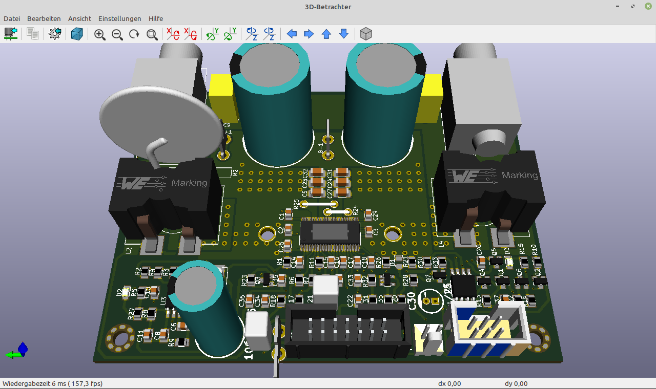

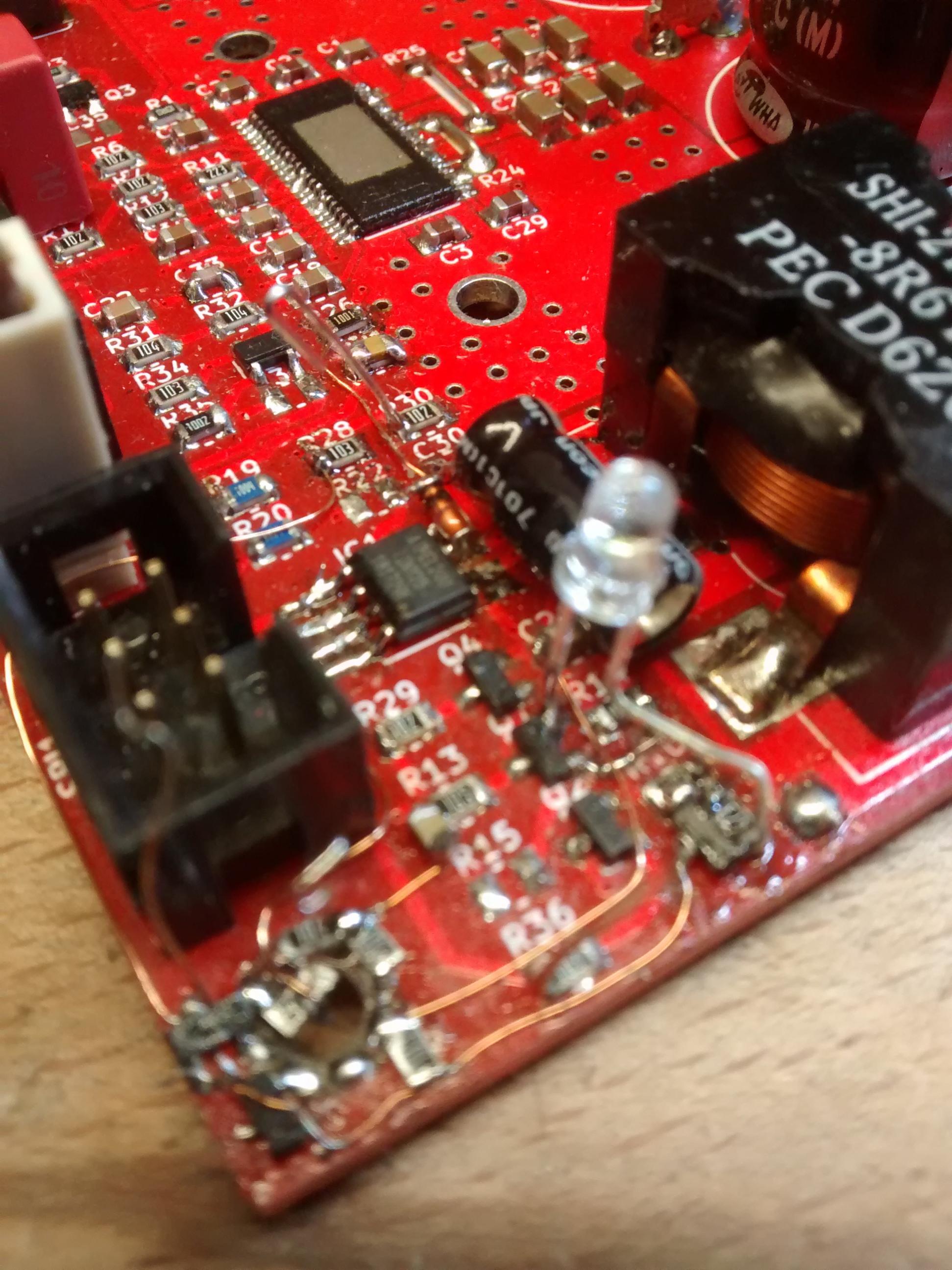

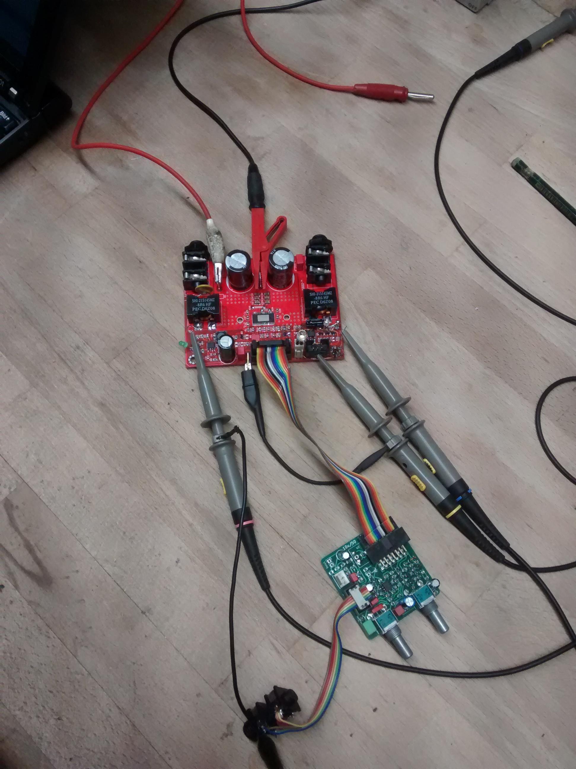

It was a long journey to suppress plopping noise under all operational circumstances. Now that this seems to work I revised the pcb layout accordingly adding even more control circuitry.
What is the main interest to use IDC connectors ?
This amp is without any audio-front-end on board. For maximum flexibility AFE should be a separate board that can be taylored to specific application. It is connected via a IDC ribbon cable like that one
OK got it amigo
