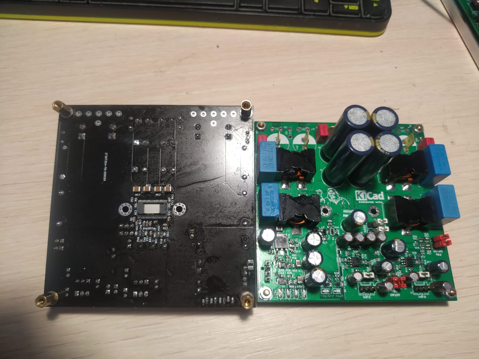

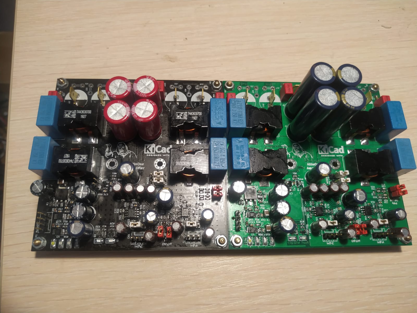

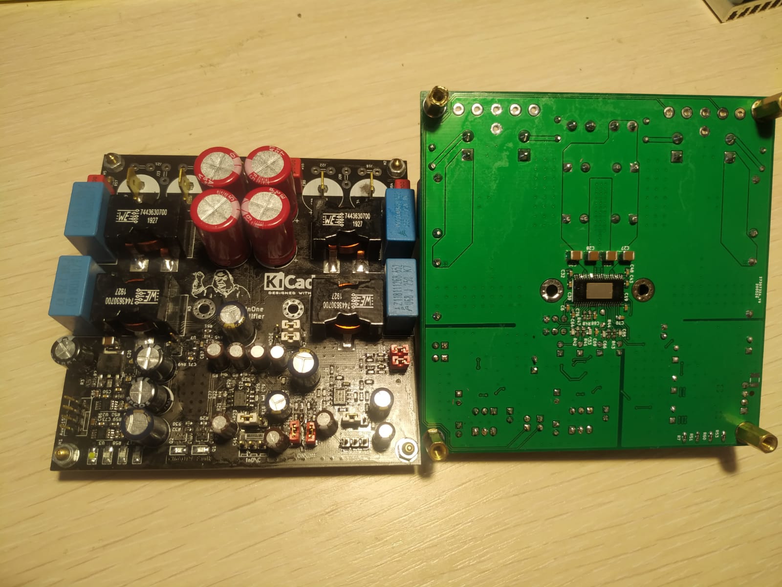

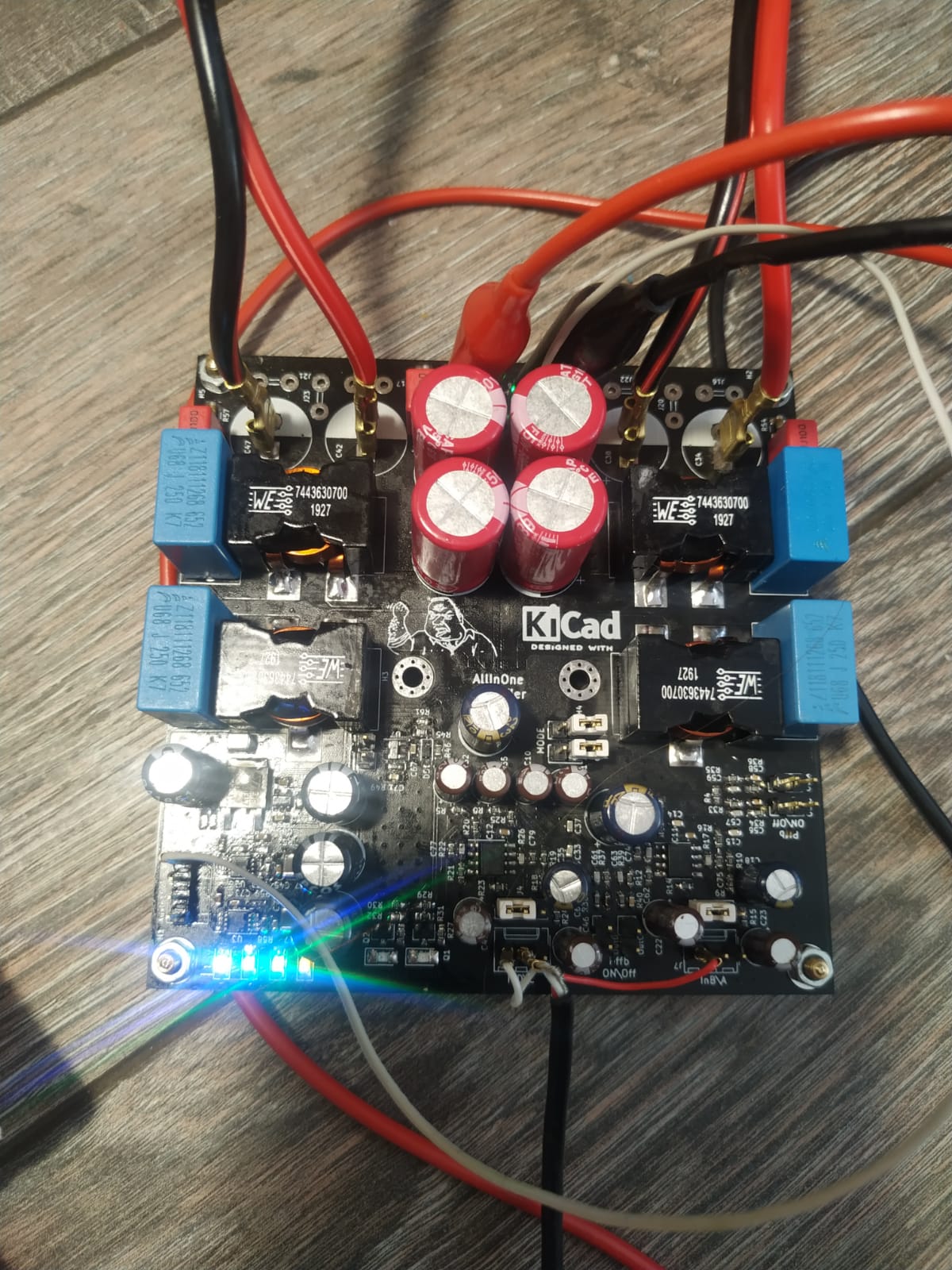

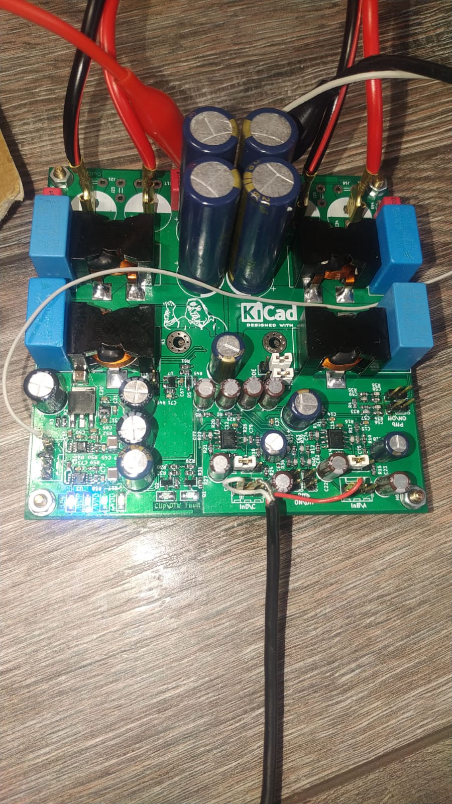

It was a long journey to suppress plopping noise under all operational circumstances. Now that this seems to work I revised the pcb layout accordingly adding even more control circuitry.
My pcb

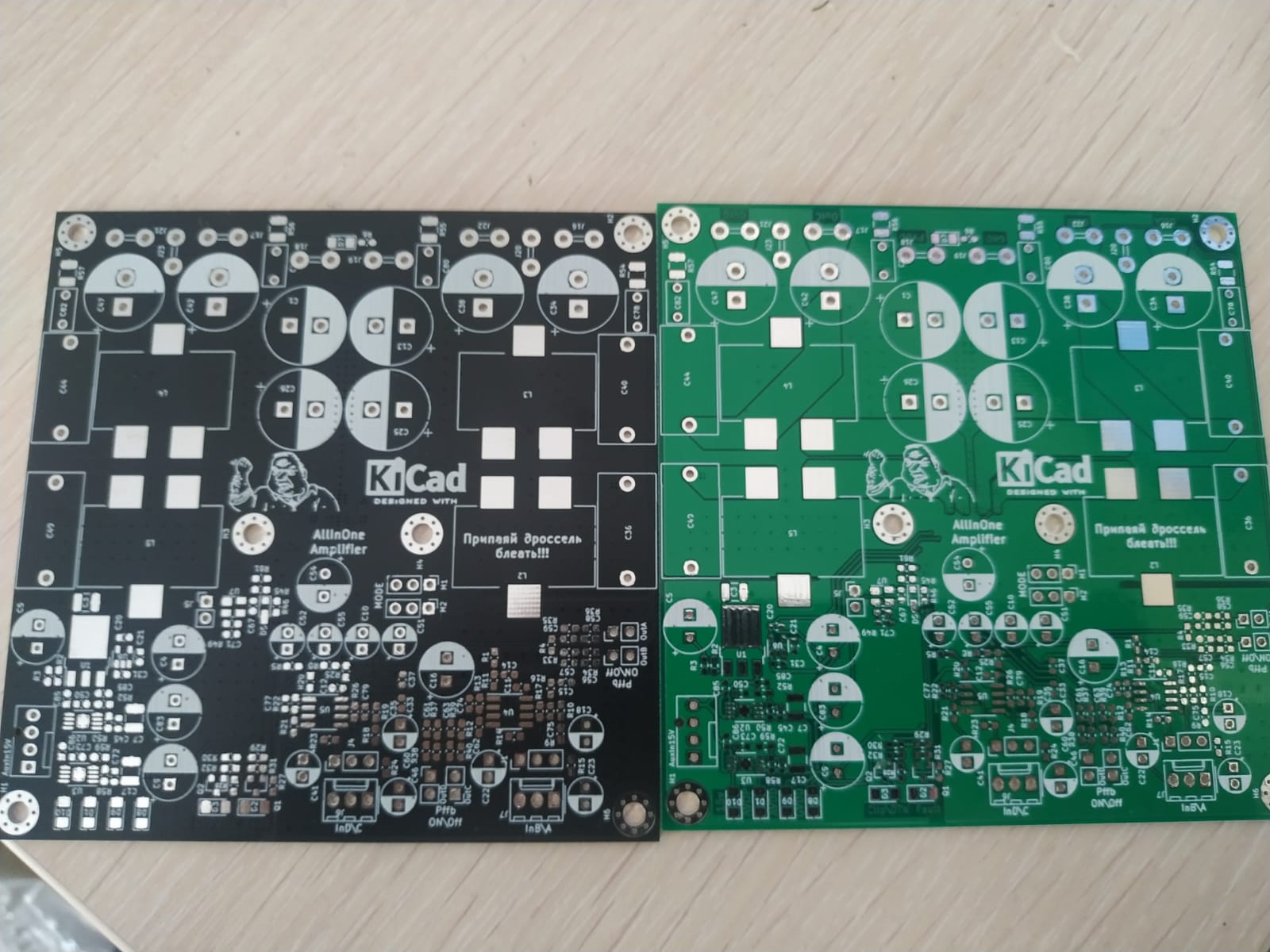

Nice! Meanwhile my next revision has left production at JLCPCB. With some luck the next batch arrives during the following week. The last days I revisited the controller program code. After fixing some bugs it seems to work basically but is not tested in all scenarios until now.
My actual pcb batch from JLCPCB just arrived at my house door. I uploaded the gerbers at June 17th in the evening. I would call this service unbeatable.

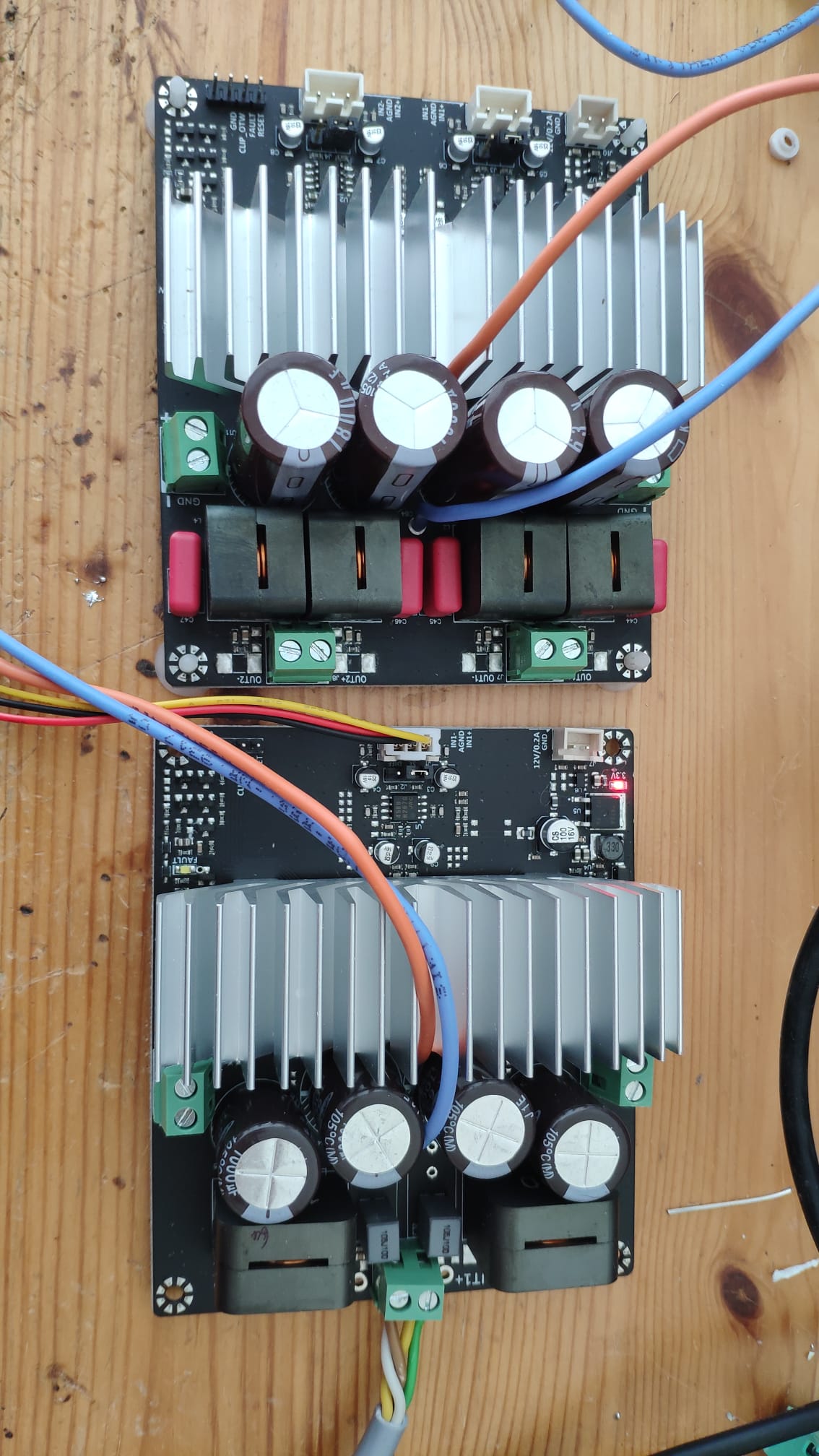

Hei guys

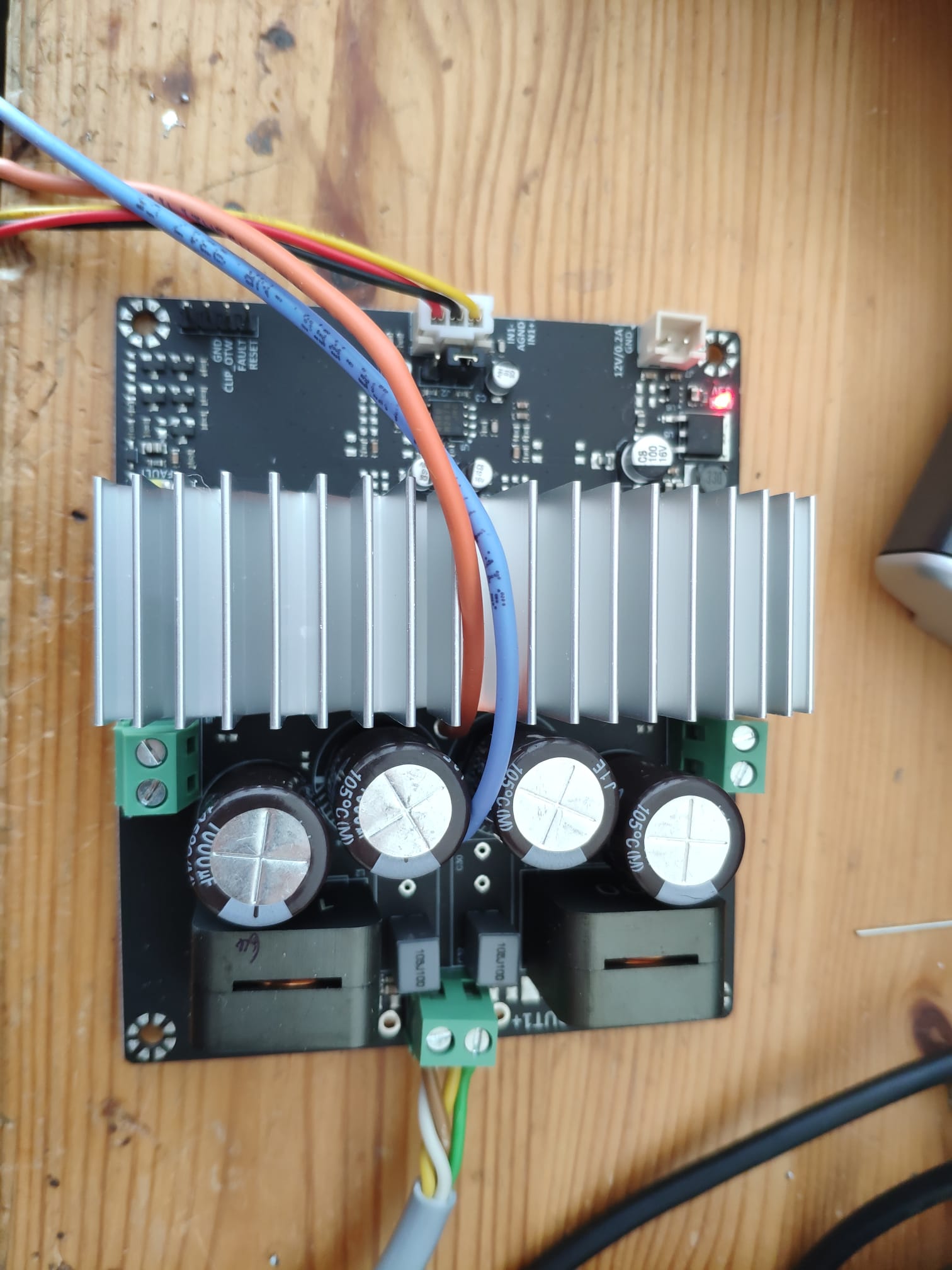

Really happy. Got my 2nd TPA3255 board yesterday. Its the mono version of 3e Audios TPA3255. Works good. Unfortunately I am still waiting for my ADAU1701 DSP.
So no Subwoofer crossover....
Caps are stock... will be changed later.

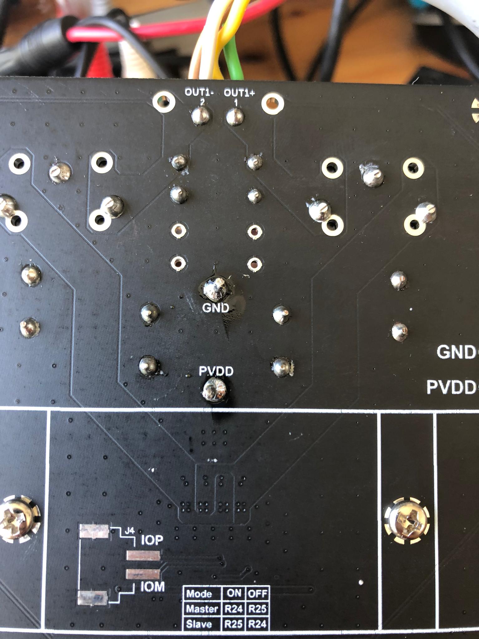

Where are you feeding the power to?
The 3e Amp has soldering hole for power wires.

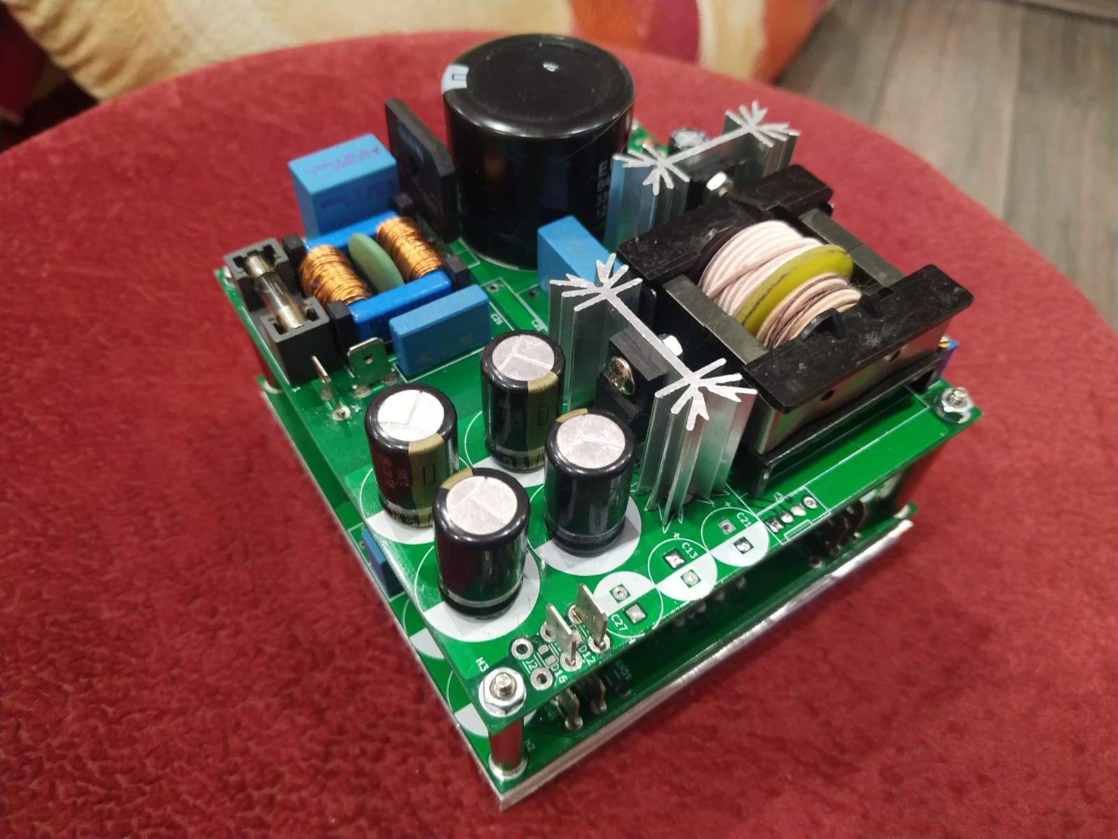

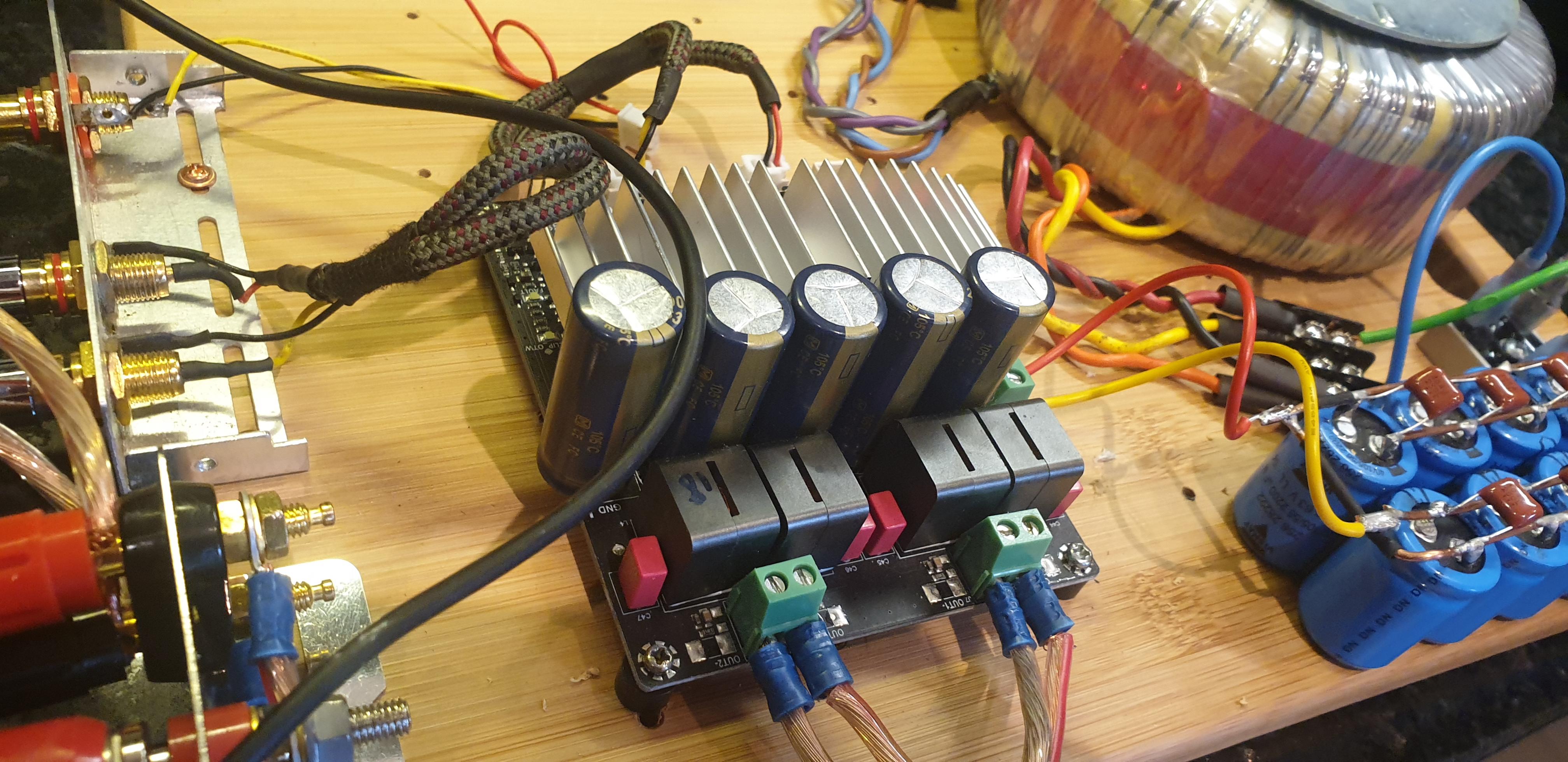

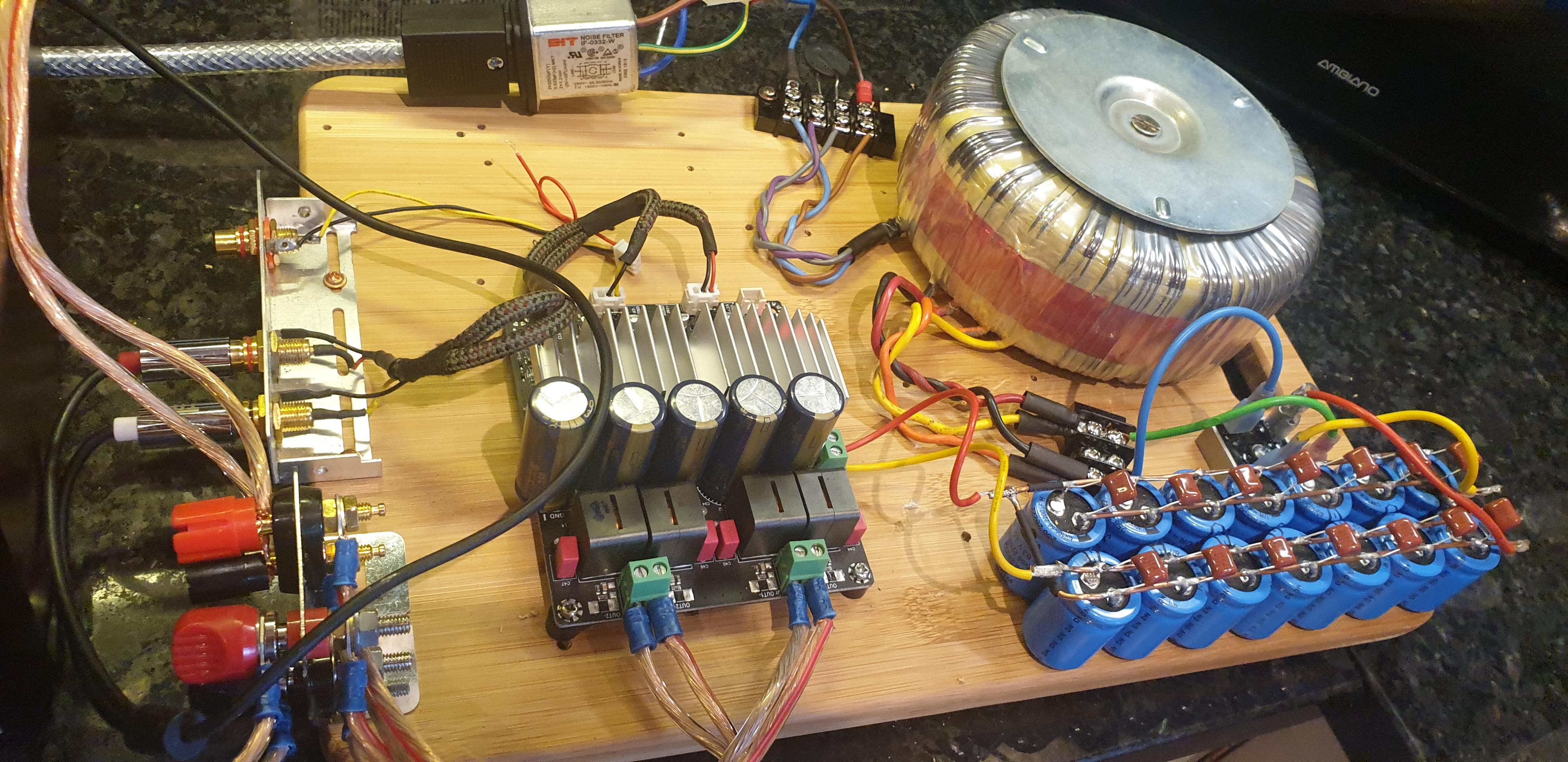

My second setup up with better psu. 3e 2 channel 3255.
35volt 500VA transformer into monolithic rectifier. Bank of 14 2200uF and 0.1uf film.
Runs at just under 50V.
Sounding very nice...lots more gain than the Teac tripath that I was listening to before.
I feed it into a Salas Dcg3 preamp.
I am monitoring the amp temps as the heatsink on the chip and inductors are pprox 37 to 40 degrees....(measured on a hot day here...28 ambient).
See if the additional voltage has changed the SQ in any way. Was running this amp at 40V previously.

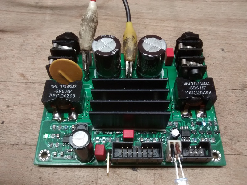

This morning the missing parts arrived so I could finish the actual prototype. I assembled a TPA3251 that I had removed once or twice from former prototypes. There was no problem recycling these so far. Powered up: It lives
Sounds good ! Can you share some measures of your prototype ?
Thx
I can do so later. But do not expect any really news - my prototypes perform similar to the TI-EVM and there is not so much I can do about that. Instead of squeezing the last zero out of THD numbers I focus on an extra power management that enable battery operation and suppresses popping sound on power up / down using a microprocessor. I can add some postfilterfeedback also - but in a different way than TI do propose. This will be my power building block of high-efficient mobile instrument amps in the ballpark of 30~100W mono.Sounds good ! Can you share some measures of your prototype ?
Thx
